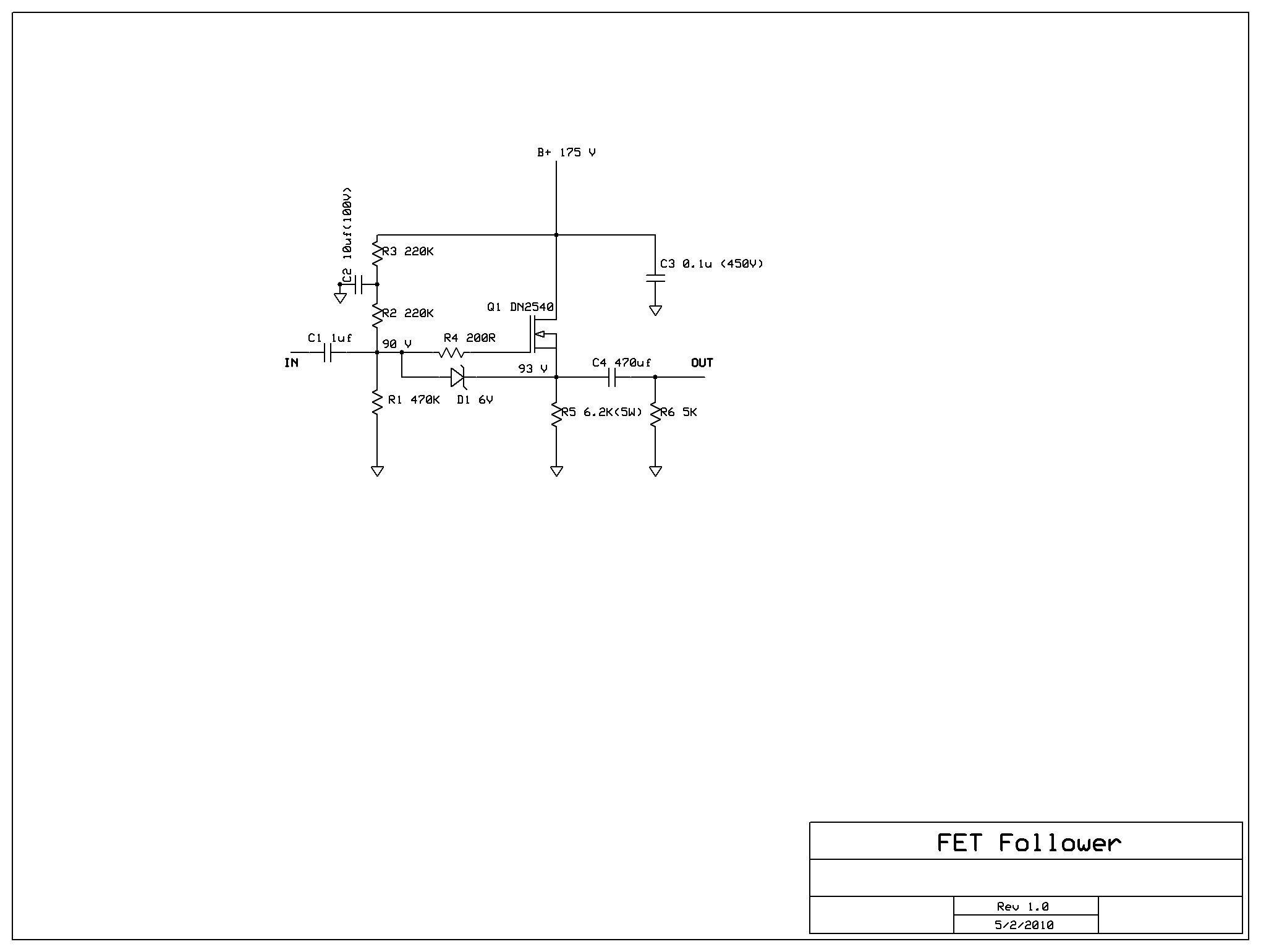

Thanks Sheldon/mach1. BTW, I have few questions. What would be the most suitable type of FET sound wise? Dep. mode or Enhance mode? Is there any real difference? Will this type of addition/change to my 26 tube pre do any harm to the nice 26 tube sound? What are the pros and cons?
I found the attached schematic on one of the articles. Will the same work if I replace the FET with IRF840 or DN2540 (Both I have on hand)? What should be the Zener to use for protection in this case? Still learning to understand the math behind all this hence appreciate your advice.
Either device will work. An FET follower such as this will be one of the most transparent active circuits you will find. The signal from the 26 plate will be very accurately followed. The DN250 has lower capacitance, the IRF device has higher transconductance. I'd lean toward the DN250 for low current applications such as this. But I don't know if you would hear a difference.
This circuit will work fine with one change. The source resistor will need to be larger (R5). Let's say that you want bias to 15mA, and you adjust the divider so that the gate is at 100V. The source voltage will be about 3V higher than the gate for the depletion mode device, and about 3V lower for the enhancement mode device. The difference is small compared to 100 volts, so let's ignore it and just say the source will be at the gate voltage for our purposes here. At 100V, a source resistor of about 6.8k will be required to set the current at about 15mA.
Remember that the 26 plate will see the load of the divider resistors in parallel. Not required, but I'd probably double those.
The 2540 gate will tolerate about a 20V swing either side of the source. The IRF FET will be similar. So any zener from 5-15V will work. The zener is connected from gate to source. For the depletion mode device, the zener cathode is on the source side. For the enhancemode device, the cathode is on the drain side.

BTW, if you bias with a divider, you probably cannot connect it directly to the B+ supply. The PS ripple will be divided and applied to the gate too.
There is really no need for a pot here, unless you want to fiddle with bias current. So, for example, use a string of three resistors, 100k, 100k, 200k from B+ to common (100k to B+, 200k to common). Connect the gate between the bottom 100k and the 200k resistor. This will set your source at about half the B+ voltage. Connect 5-10uF capacitance from the middle of the two 100k resistors to common. This cap will filter away the PS ripple to the gate.

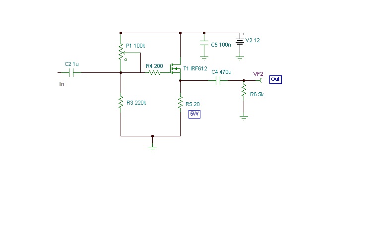

Greatly appreciate your support over this Sheldon. This is very informative and educational. I have redraw the schematic according to the points you have given and attached if you could verify. BTW, what wattage should be the Zener? And the FET's require heat sinks?
That's the general idea. Couple of comments:
1. C3 is unnecessary
2. You can double your divider resistors. This will allow a smaller C1 (and C2, although 10uf is fine if you've got it). When you calculate the low frequency corner for C1, R1//R2 for the RC calculation.
3. You have plenty of voltage across the FET. You can decrease this if you want to lower the dissipation for that part and burn off the power in the source resistor. Just keep the drain to source at about 20V or better. So you can adjust your divider accordingly. At 15mA and 25V, you would dissipate about 0.4W over the FET. If you have T220 device you can use just a small sink. You'd need to resize R5 to keep your current where you want it.
4. C4 is way overkill. Even with a 5k load, 4.7uF would give you a corner at about 6Hz.
5. Zener will never carry much current, as it will be in series with R3. A 1/4 watt device would be more than enough, though you can use larger if that's what available.

I tried just a simple en. mode FET follower (similar to the schematic you provide). But results were not that impressive to me. Certainly it reduces the distortion but I felt that it reduces the liveliness of the music as well. The instruments I could hear before seems diminished or sound thin. Not sure this is because I had set the FET to run in low current (7ma). Any suggestions you could give?

If you are comparing it to a heavily loaded 26, then it will have much less distortion, and probably reduced top end. A lot of second and third harmonics will make the sound seem full. You can try higher current, no harm there. Listen for a few sessions before you decide. Make sure you can listed for a long time without tiring.

Hmm..what I felt was bit confirmed. Top end had lost it's strength Which I didn't like. I personally felt it is one of the strength of 26 tube of having the smoothest and live top end. However FET follower improves the low end a bit. Anyway, I will try with higher current and also the dep. mode FET follower as well. I will post my findings as it progress.
