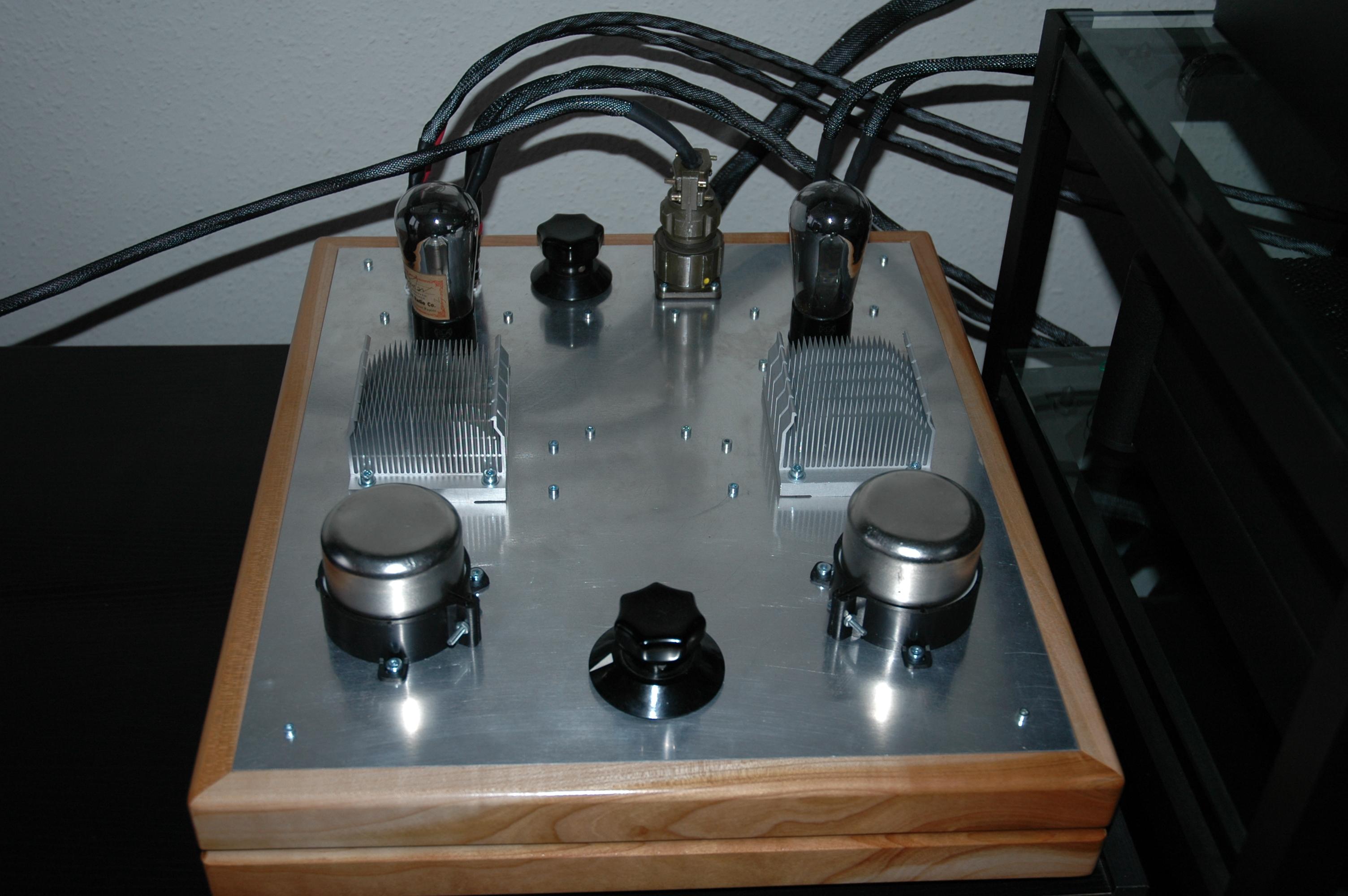

My Pre UX-226
Line Stage
Power Supply

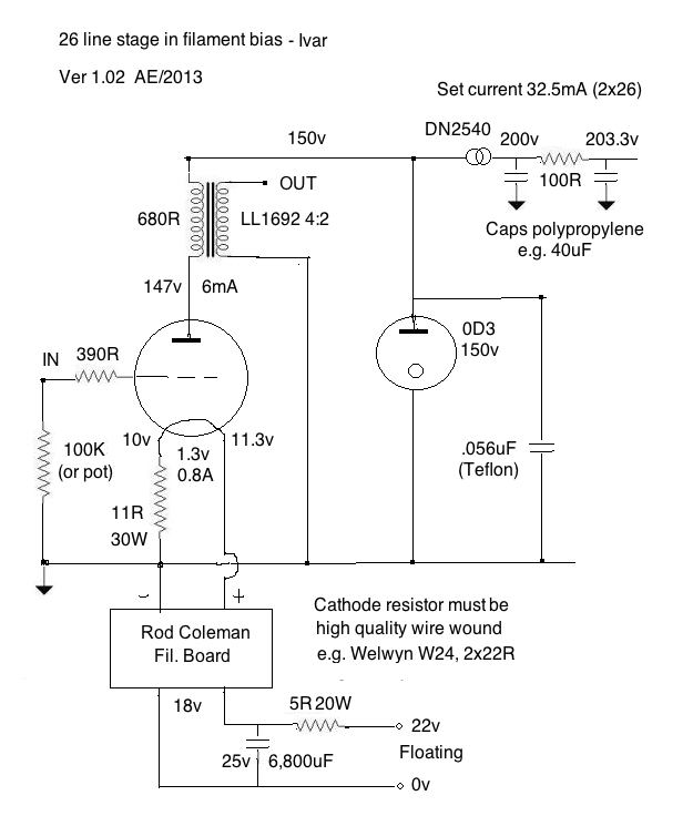

My #26 tube preamp is -almost- cost no object (TVC, Elma swithes, V-Cap capacitor, Shinkoh and Riken resistors etc.) project, but the total cost is below 1500 USD (about 1000-1100).
Most effective parts:
- TX-102 TVC (it's unnecessary if you use good -for example TKD, Noble- potentiometer, or leave it);
- Elma 24x switch (it's unnecessary if you don't use TVC);
- Elma input switch;
- 100nF V-Cap teflon capacitor (use cheaper ones -for example russian FT-3-);
- AZ1 mesh rectifier tube (use good solid plate rectifier tube);

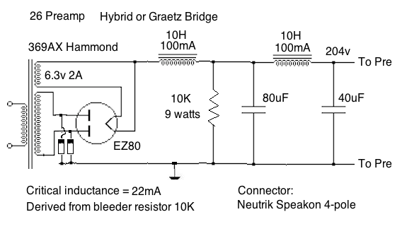

- Power supplies -HT and LT-;
- teflon tube sockets, silver connectors;
- Good -I prefer globe tubes- #26 tubes. ST tubes are cheaper.

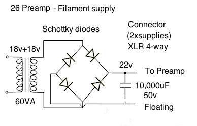

As you can see it's a two box design (HT and LT supply, preamp).

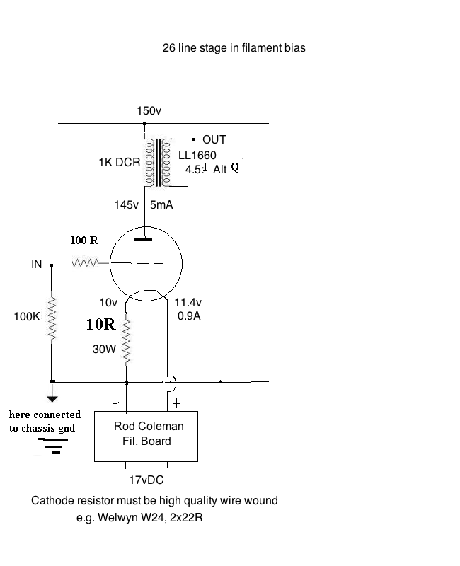

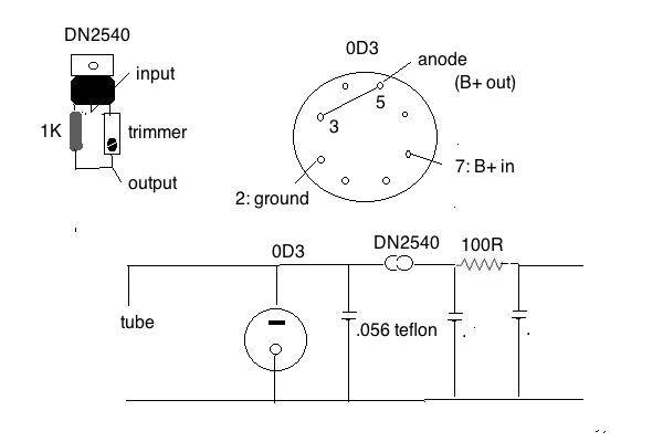

I use regulated HT (Salas SSHV2 regulator) and Rod Coleman's V4 heater regulator in the preamp box (medium sized heat sinks needed).

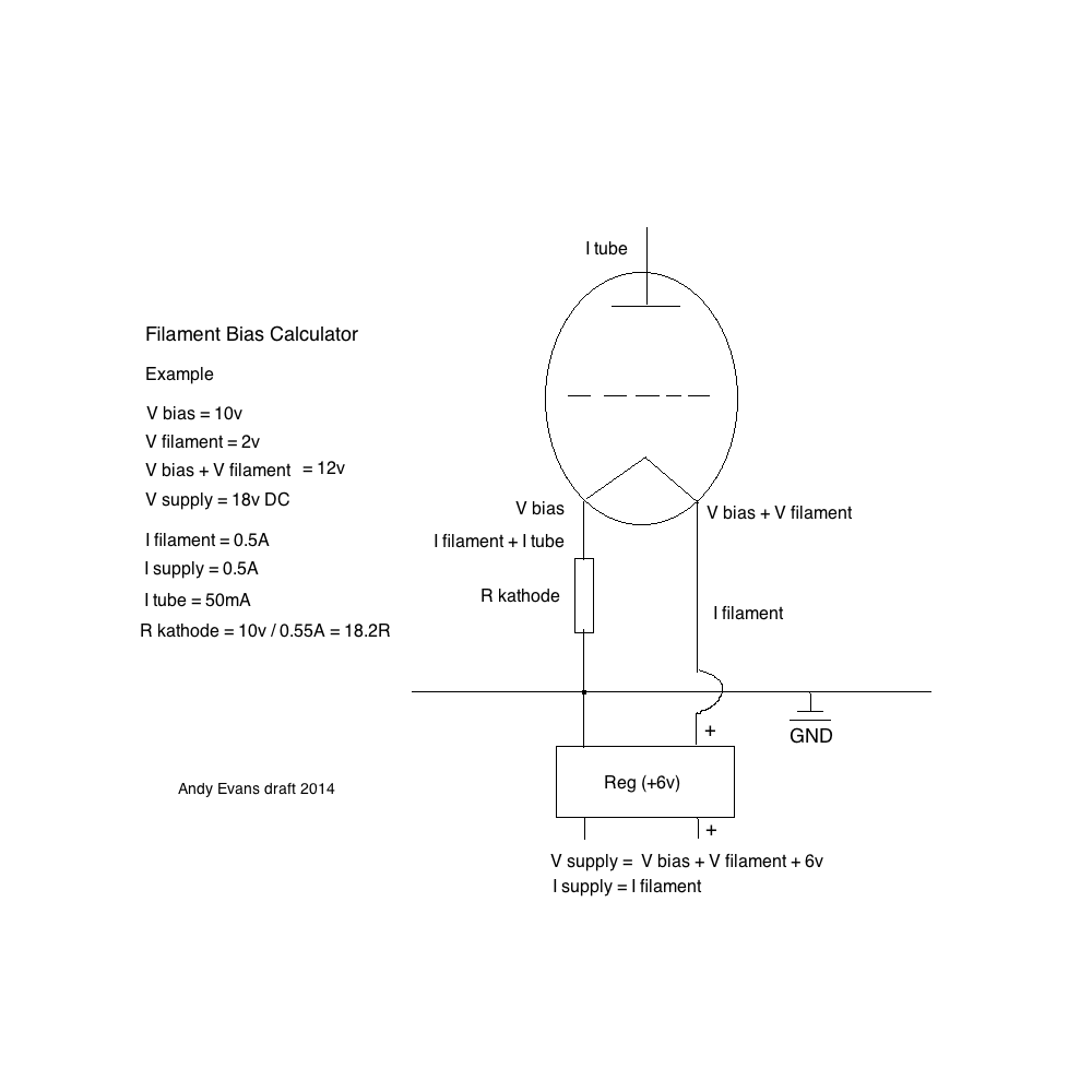

Tube is heater biased, anode load is CCS (cascode DN2540 FETs). Heater bias resistor (10R 50W DALE non inductive 10W dissipation) large heat sinks is old computer CPU passive ones.

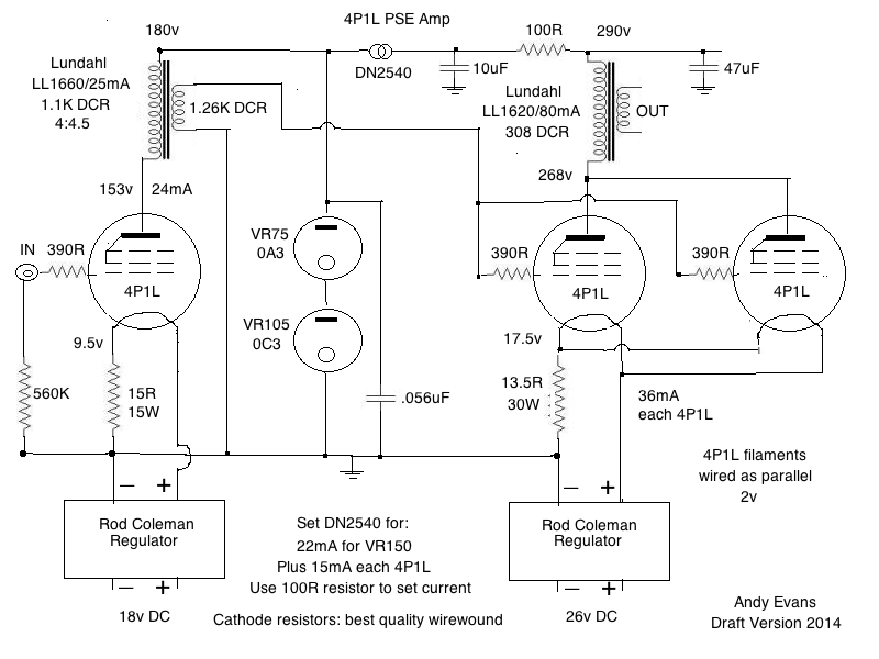

But I would use the 4P1L. I built my first 26 preamp in 2008 and it lasted until about 2011 in many different versions. I then went over to the 4P1L - more dynamic, better treble. And I stopped using line stages and just used a 2-stage amp. Simple as that. The first stage can be used as a line stage, of course. But the output stage is better than any 2a3 or 300b design I built, and there were several of them. With its generous mu of 10 the 4P1L can be used in a 2-stage amp, and that solves a lot of issues.
