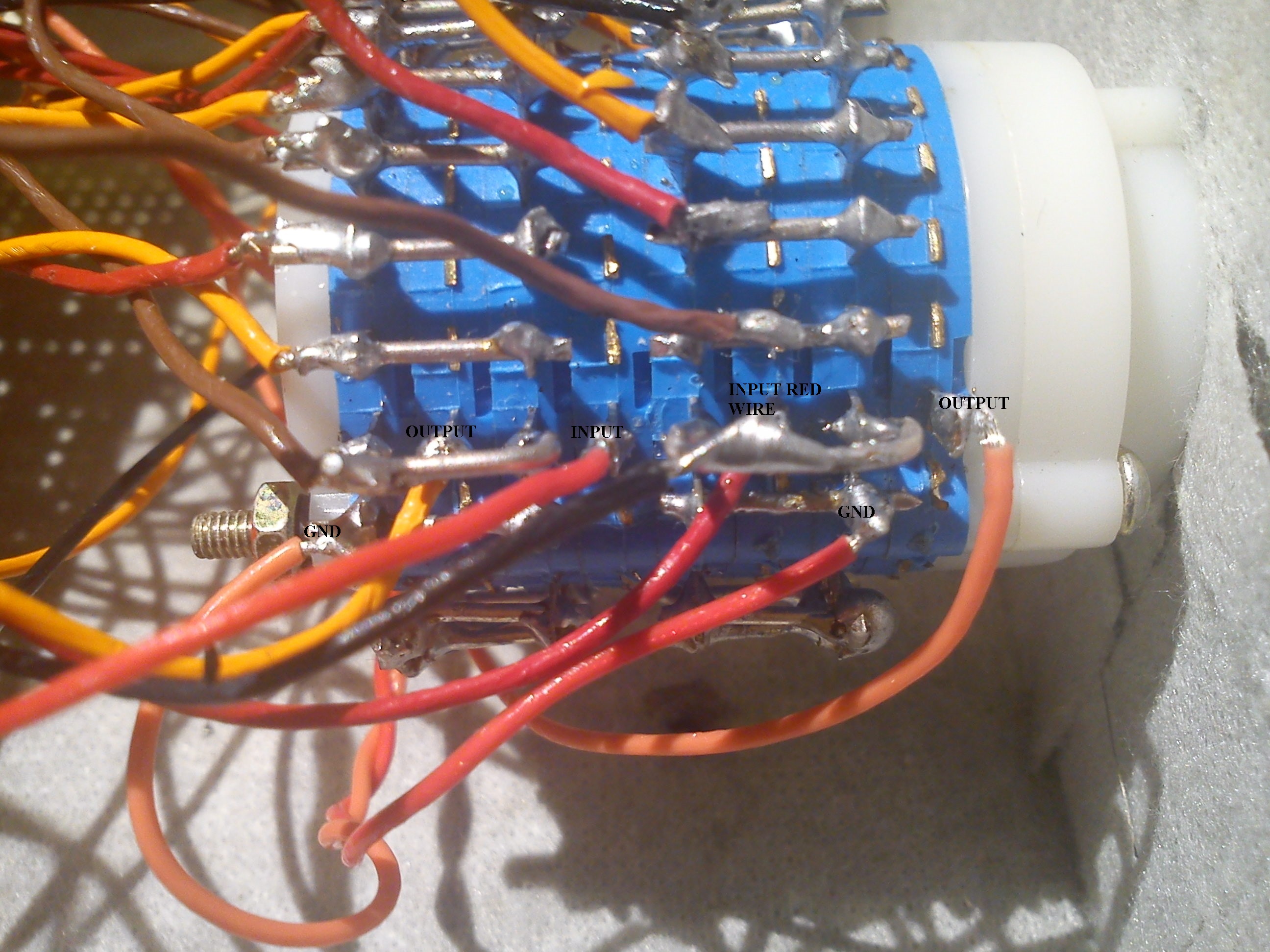

Those pics and partial diagrams don't really help. Can you post a schematic as it is actually built and connected? Also doing the measurements as suggested would be useful to narrow down the problem.
Also good point from vgeorge. Check your circuit and draw the schematic as is.
Don't forget all ground connections and connections to chassis/safety earth

Attenuator inputs/outputs

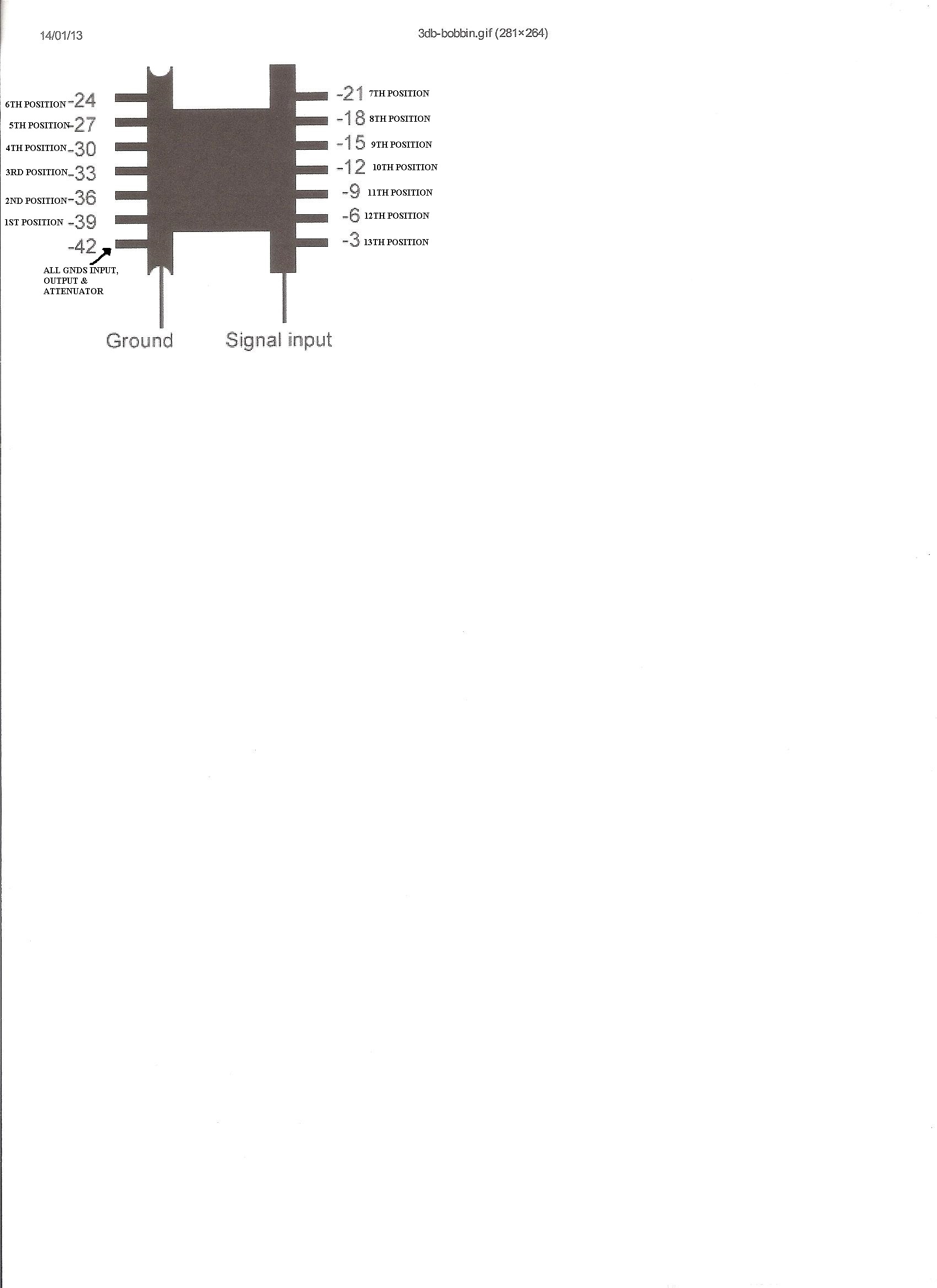

Exact schematic
Hi Felipe,
sorry but the latest schematic you posted again did not show how the TVC is wired.
You posted two diagrams of TVC wiring which are different from each other. One of them you got from me. The photo of the switch shows a different wiring than the diagram I sent you.
Best would be if you check all your wiring and draw a diagram which reflects the circuit *as you built it*
Thomas

Now?
Hi Felipe,
I assume these are the AVCs you got from me? I did send a schematic and detailed description how to wire them.
Note that these have 4dB steps except the first two. So if you wire them as you attempted on your pics, you will get 0,-2,-6,-10,-14dB steps.
If you want 2dB steps you need to wire as per my instructions, that's also why you got a switch with 4 tiers.
Wire the AVCs first and then test the AVC alone (with signal gen and scope) before testing with the preamp
Best regards
Thomas
