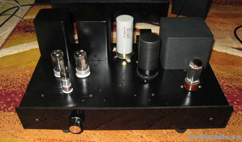

My 4P1L SE amp sounds very good, sweeter than my 300B on the midrange. Noise is minimum, 0.4mVac. I plan building pre amp 4P1L or 5A6 or 26 to compare to current 71A preamp.
Could you post your schematic? There are very few 4P1L amps in circulation, so it's very interesting to see how they are being designed.
Very cheap, very simple Formula: Mullard E180CC- 4P1L with G3 to anode, G2 running in separate winding, C-core OPT 3.5K - 8 Ohms. 5Y3 is rectified. It beats 300B on midrange. Schema is not available and I will try to draw it as detailed as possible.
