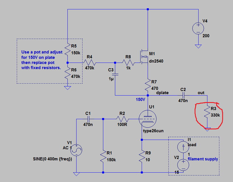

What resistor value when used output cap, Iko use 330K & Andy use 1Meg?

No, without OPT as Iko did.

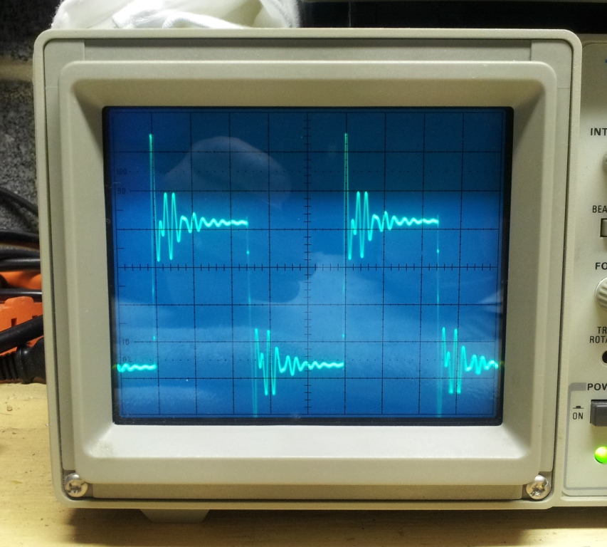

I don't know about you guys, but I can clearly hear transformer ringing. It gives a harshness to the highs.

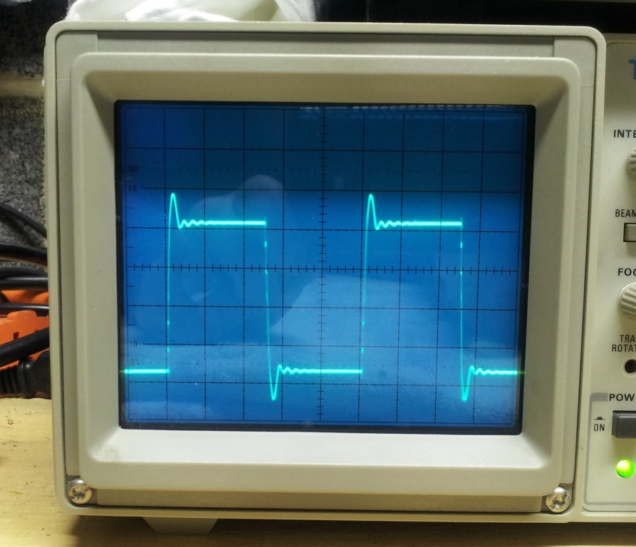

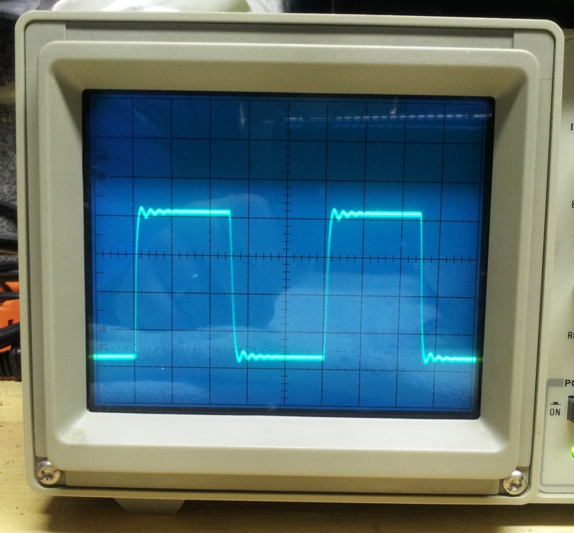

Here's an example of ringing on the input transformer of my 26 preamp (pic #1), which was cleaned up with an RC network on the secondary (pic #2) and series resistance on the primary (pic #3). The sound went from very harsh, to a little harsh, to smooth and clean going from picture 1 to picture 3. Ended up with 2nF and 850 ohms across secondary, and 800 ohms on primary.
Note that using a resistor across the secondary will drastically lower your gain, while using an RC will not.
I had a similar experience with the output transformer of my 2C22 preamp.
Note: these pictures are 10kHz square waves.

Could you draw or explain this. Is it a classic RC or a zobel?
Best regards
Staffan
Simple. R+C across transformer secondary. The best way to figure out the values (which are different for every transformer and circuit) is to use a small cap such as 1nF and a 5K or so pot in series across the secondary. Adjust the pot to get the best looking square wave. Then go up in capacitance to 2nF and do the same, then go to 3nF, etc. You want to choose the combination that has an acceptable square wave using the lowest C and the highest R. Once you have those values, substitute a fixed resistor for the pot. I like to use TX2575 resistors from Texas components for this, since they will custom make the resistors to whatever exact value you need; a little pricey but really, really nice low noise resistors.
I usually split the resistor value in two and use an RCR network, just so the resistors isolate the transformer from the cap somewhat.
In the case above, I found that the input impedance to the transformer was crucial to achieving the best performace, so I put a pot in series with the primary and adjusted that to get the best square wave after I optimized the secondary, then replaced the pot with a fixed resistor.
