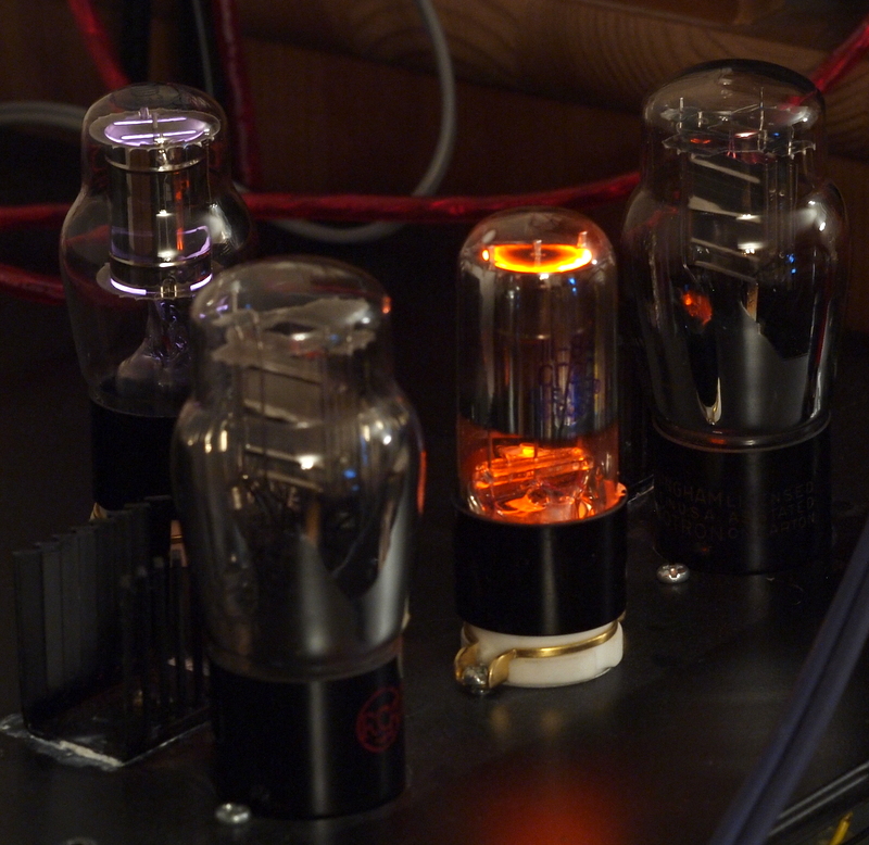

All this activity in this thread made my solder gun itchy, hence my glow tubes are back in as of yesterday. Chose a sample VR150 and VR75 each, in series, such that I get about 220V DC on the top of the gyrator, which is adjusted then for 150V DC on the plate of the 26. I chose the two on purpose because I like both the purple and the orange glow. Shallow, I know. 😀
And all this thanks to Andy! -- who stirred the waters about DHTs on this planet. He'll go down in history as 26-Andy!

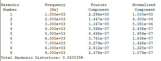

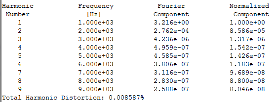

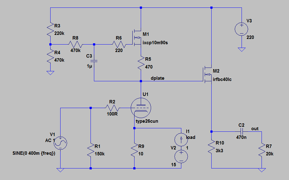

Hey guys, has anyone tried a mosfet buffer in the 26 preamp? I get lower thd in simulation. I might just try it one of these days.
The second image is the thd values for the one with the buffer, the third image for the circuits without a buffer. I guess this could be the poor man's alternative to an output transformer when the next stage has a lowish input impedance.
