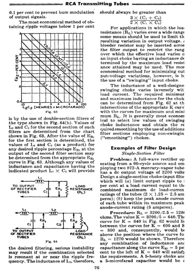

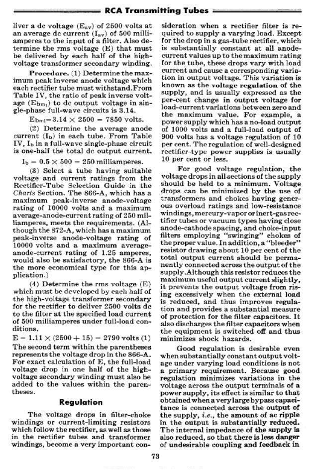

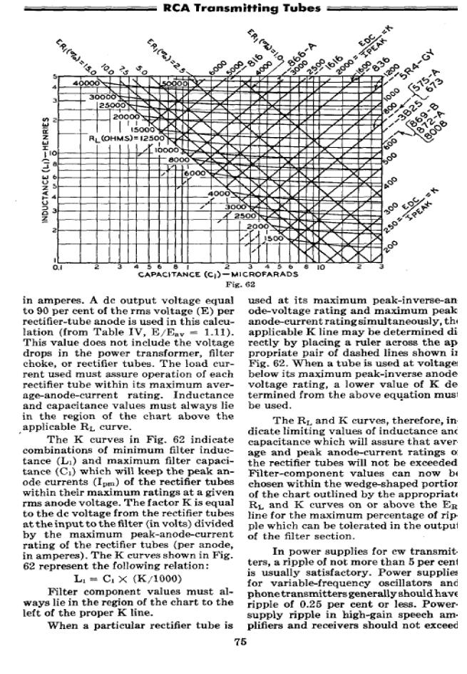

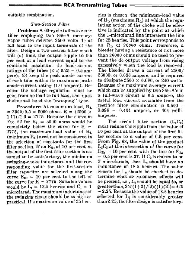

Abe, I can't send you the whole book as its 13 megabytes, However I am sending you here the relevant pages as an extract (5 pages) covering Choke/Capacitor relationships in power supplies. As I said it may point you in a different direction
Hello,
Thanks for this! I tried understanding it but I am afraid I do not have a grasp of what it means.
My circuit is a AZ1 tube(I have 4Vac for filament). From spec sheet, I assume I am operating at about 2x300 V (Va max) and 100mA (Ia max). I am using a Hammond 250-0-250 power transformer.
After the tube, I have 20H then 47uF, then 10H, then 47uF, then 0.36H, then 47uF. Do you think there's something wrong as far as the L and C values according to the excerpts that you sent me?
Thanks,
Abe
