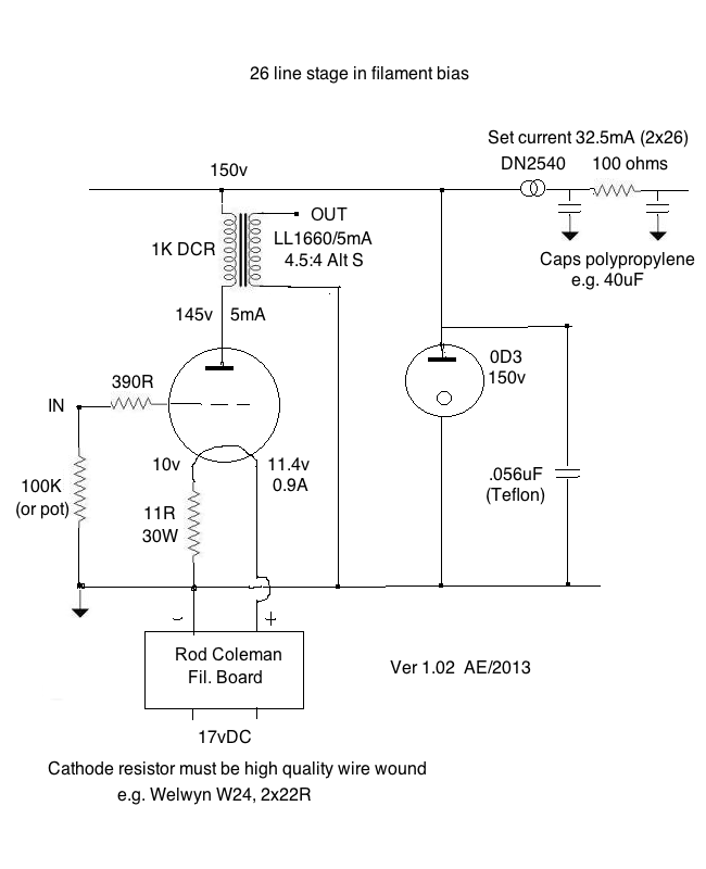

For instance, if you want to use your output transformer, this is what you can do. Use a VR150 tube to get 150V at the transformer. Feed the VR150 tube with a DN2540 as a CCS set on 35mA max. Feed the DN2540 CCS with filtered 200V DC.

Look in this thread for Andy's schematic. It is a really good solution, tried and true. Two VR75 tubes in series also work great, not to mention their glow is beautiful. I know it's frustrating because you're so close, but don't rush.

Iko wrote exactly what I was going to write - here's the schematic. I don't know if you need a grid stopper.
