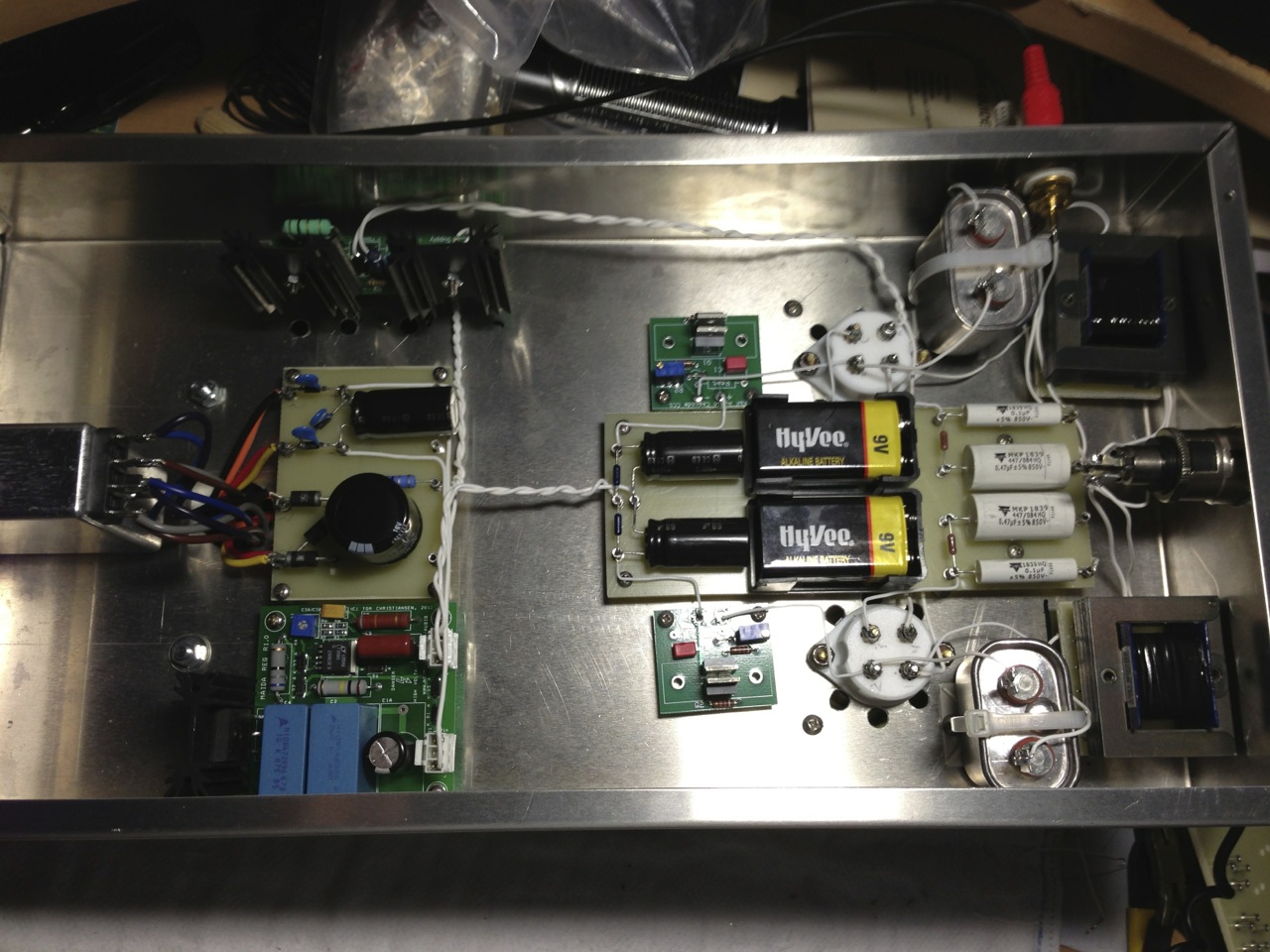

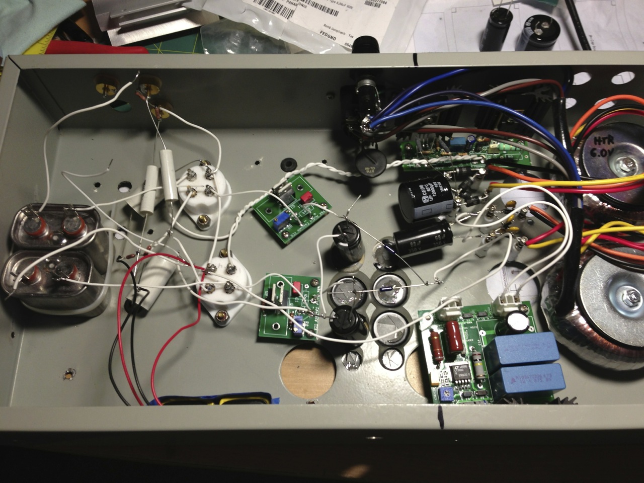

I finally finished my flea-powered 26 headphone amplifier. I just had to wait 6 weeks for the Edcor OPTs. Unfortunately those nice looking tube shields I made induce hum 😡. It's a good thing they can be unscrewed easily. It's the exact opposite of my experience with the 26 linestage I built over 10 years ago using Ronan regulators where I had to use shields to reduce hum. Without the shields, it's as quiet as death. I can't hear anything with my efficient Sony 7506s...at least until I play music. With 1Vrms in I get about 3mW out which is louder than my comfort level. The sound character is what you'd expect from a 26 😉. Pictured below are the test circuit and the final build. Would you believe the test circuit was also quiet as death?

Could you tell us what pcb's you used? I noticed the K&K CCS board and Rod Coleman's regs. But the other one I'm curious about. Is that the K&K version of Salas's shunt reg?
That's tomchr's (Neurochrome audio) version of a Maida regulator on the lower left. I enjoyed doing the surface mount assembly work...a little.
Thanks Thomas!
Edit: The tube shields work after all. I had just forgotten to tie my circuit ground to chassis with a resistor.

Very nice and clean construction! So, all is in one box and is quiet?!?
Yep, two tubes, one box. I think all these wonderful modules that are available (Rod's filament boards, Tomchr's regulator, K&K CCS boards, Salas, Tentlabs, etc.) have made it so much easier to get great performance without resorting to ponderous construction projects.

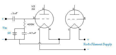

How did you wire Rod's boards to the 26? It looks like they are in series. But how do you bias them in that case?
I used battery bias on the grids with Rod's filament supply floating. I hacked up Kevin's schematic a little for this drawing:
Edit: I have the battery drawn backwards, oops.

O, that's interesting. I would expect that a 1.5V alkaline cell would suffice to balance them approximately, since the shift in bias equals 1x Vf (filament voltage). In case of #26 this is 1.5V..
Of course, this assumes that the 26s draw the same current at equal bias, which may not be so.
There's no imbalance, I just didn't draw the input circuitry for the other channel's tube. Each tube has its own battery. I lucked out with heater resistance matching since each tube develops 1.52-1.54V across its own filament. While there is a 1.5V difference in voltage referenced from the grid to each end of the cathode, isn't the effective bias voltage the lower potential in this case?
