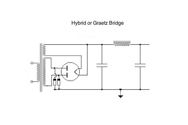

One more question, for the AZ1 filament, can I just use 5VCT tap(eg. power transformer) and calculate the dropping resistor to drop 1V at the rectifier current draw? What do you use for your AZ1 filament?
I use AZ1 mesh from 5.6V (220V transformer at 230V), with 1R and 0.5R dropping resistors.
AZ1 filament current varies 1A-1.15A, depends of the manufacturer.
Try 0.5R (5W) on both sides of 5VCT (about 2*0.5V drop), but current must be measured.
As euro21 says - you can use a 5v winding with two equal resistors on each leg. Start with Ohms Law for measuring the resistor values and then try it out and make whatever changes you need to get exactly 4v. Make sure the resistors are large enough in wattage (again Ohms Law) by sizing them for 3x what they pass. You probably need to parallel a couple of resistors on each leg to get the exact value.
Oh - I should add that if your mains transformer doesn't have a centre tap you need to use a hybrid or Graetz bridge. Diodes can be UF4007 or whatever you fancy.

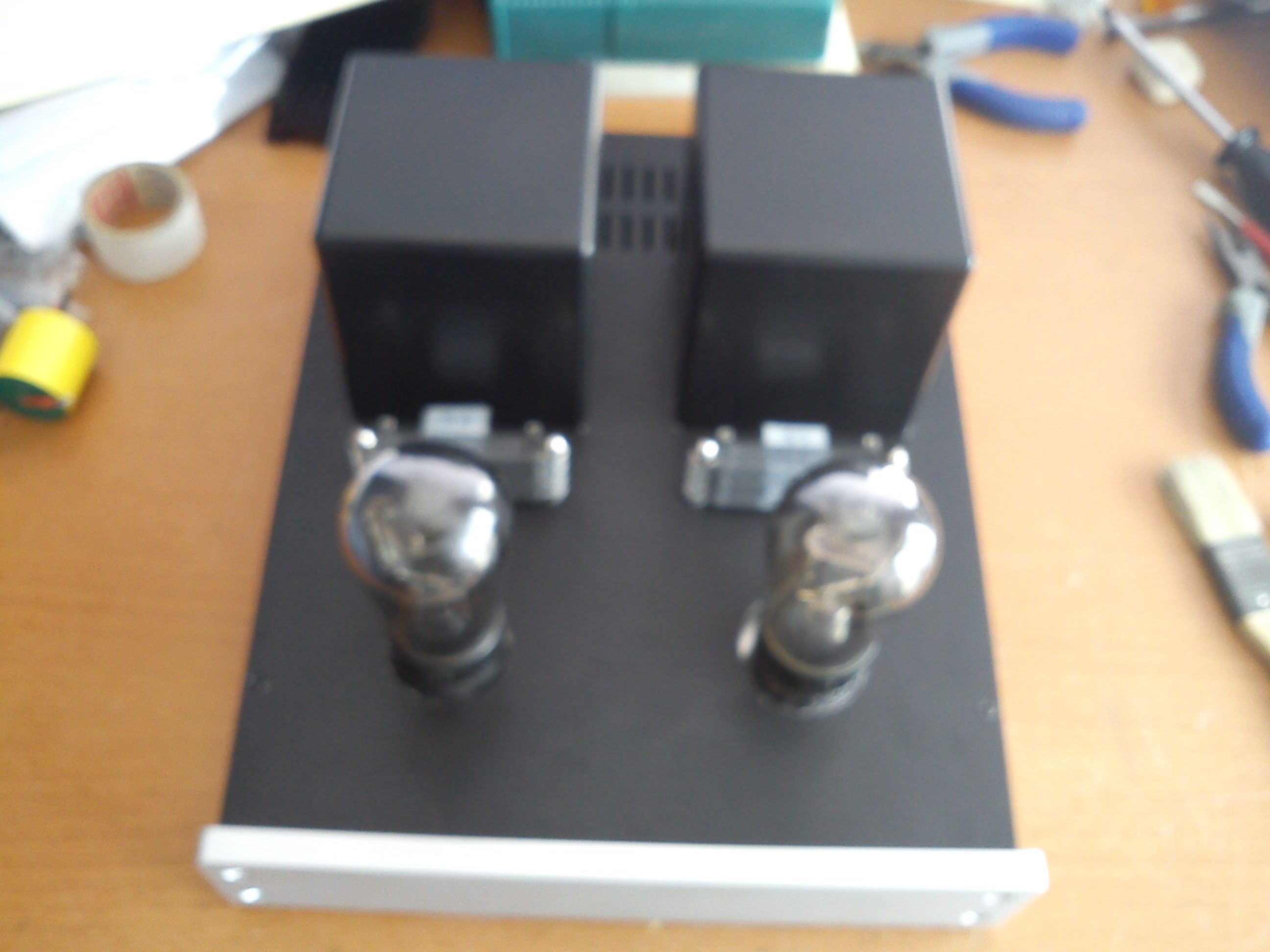

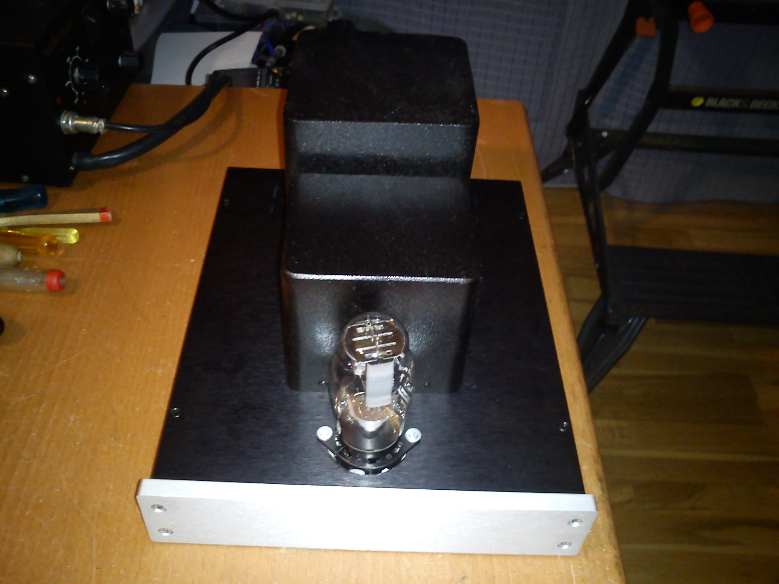

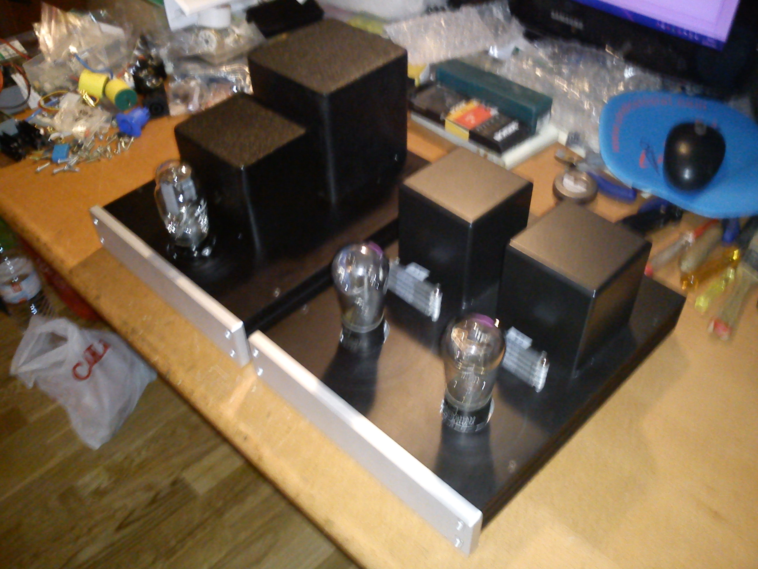

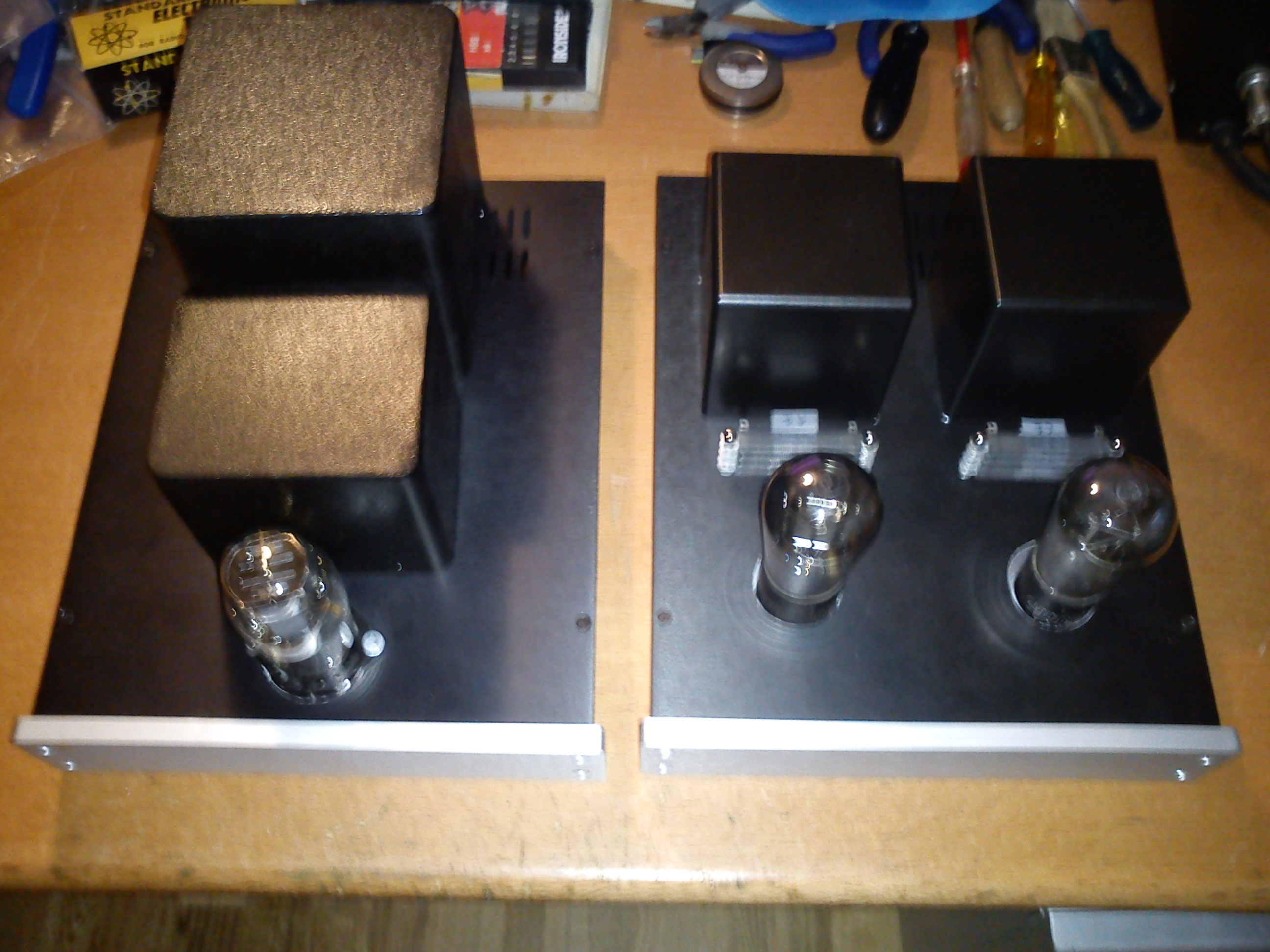

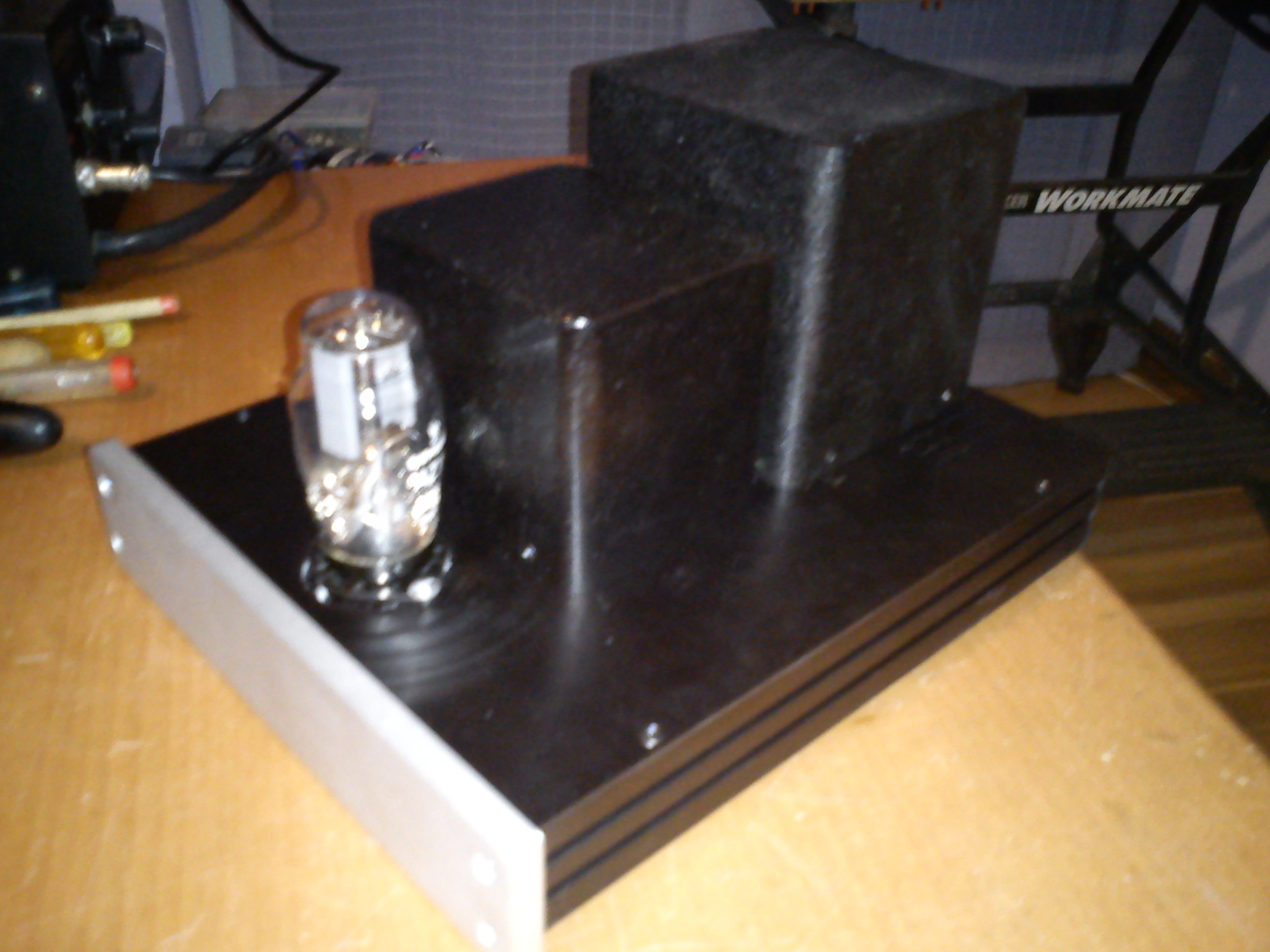

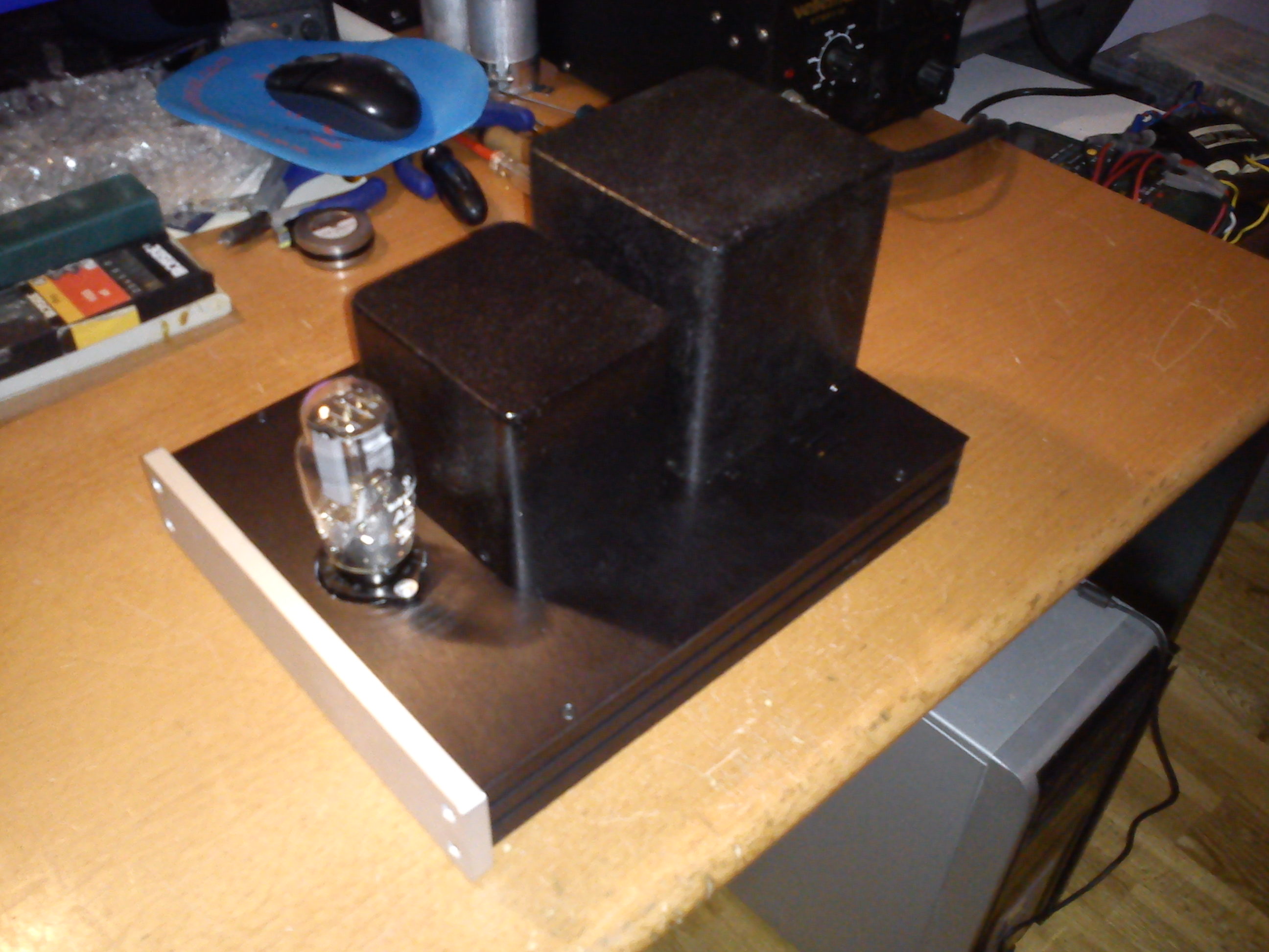

My #26 is undergoing

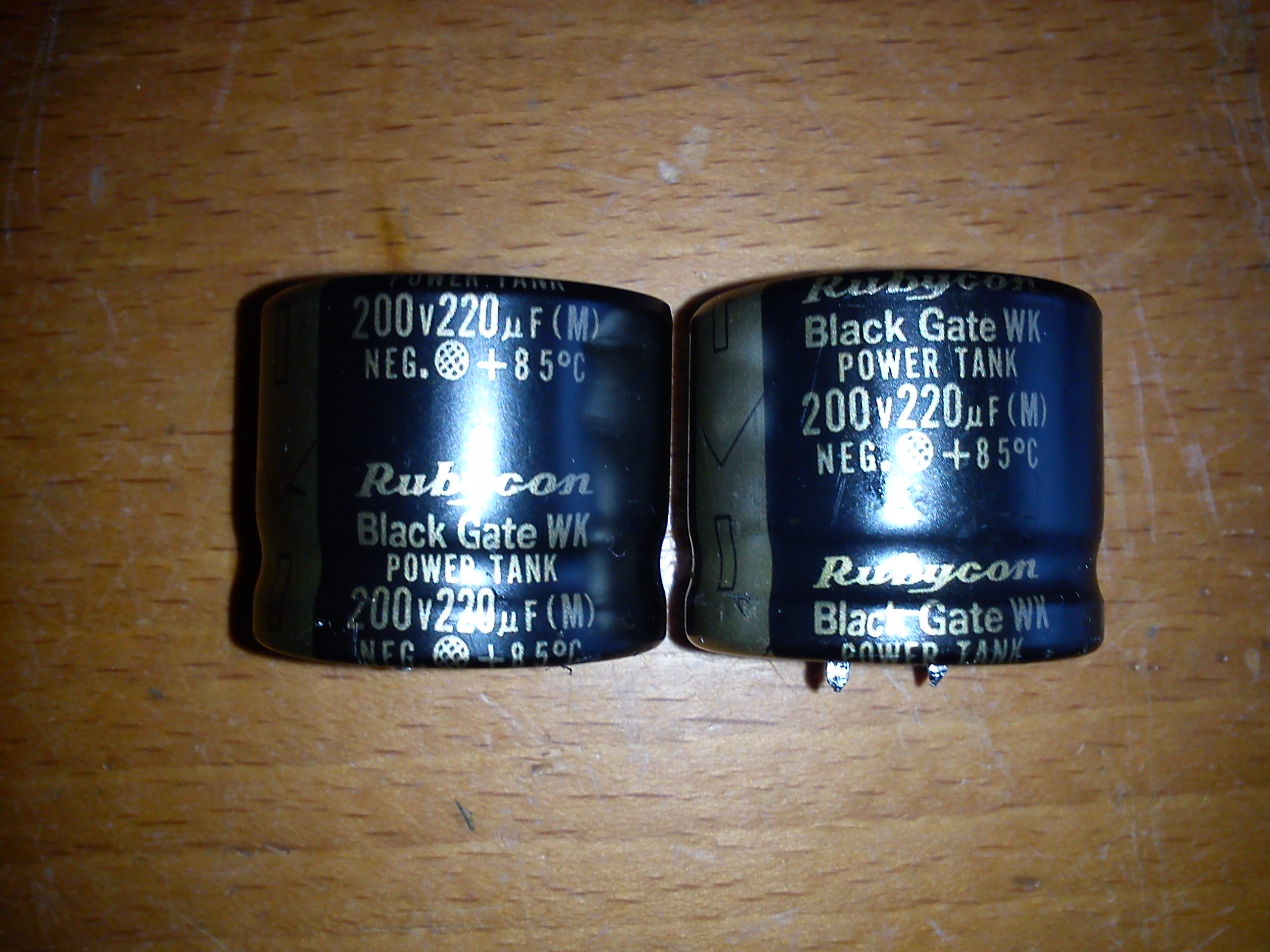

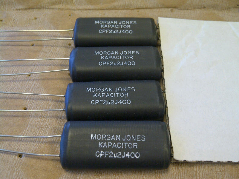

Just received these beauties, more photos of the construction will be posted afterwards.
Thanks Thomas for the Iron (Vinyl Savor)
Thanks Campbell Barker for the custom made Morgan Jones capacitors (Supression Devices UK)

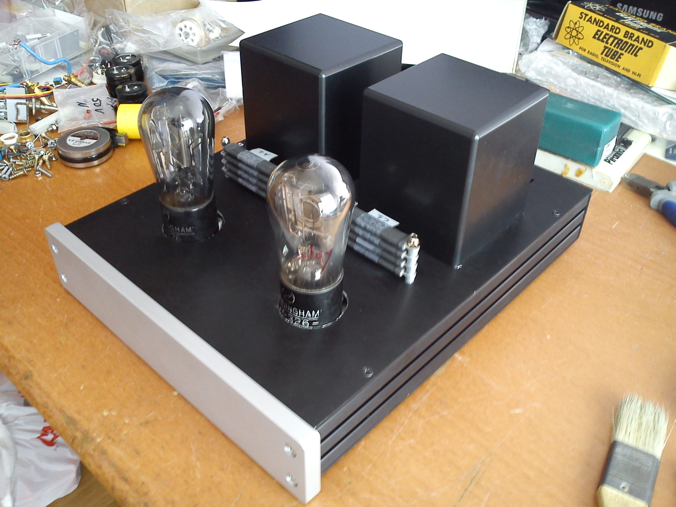

Great work Felipe, looking really good!
As a suggestion, you may want to consider increasing the space between individual resistors of each stack as they will get hot. Not the most efficient way to dissipate the heat by stacking them up vertically. I have them just like you buy added some metal separators between them an longer screws...
Ale
