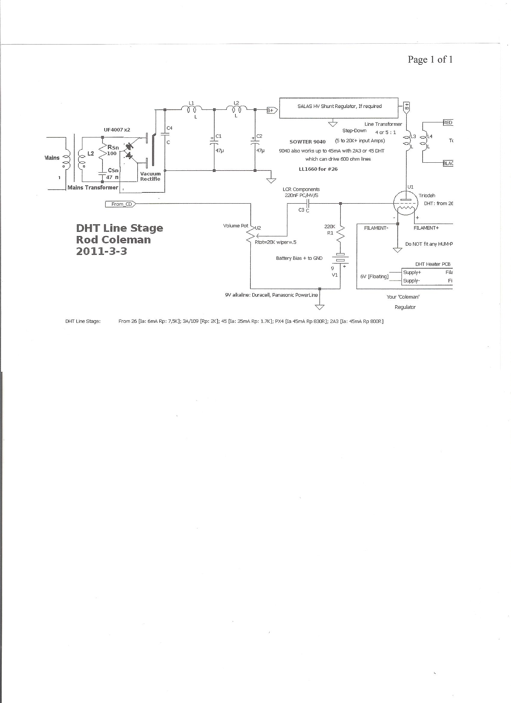

Hi Magz,
Any advantage with using Music rails on the filament supply before Rod's regulator? Any difference in sound without it?
Cheers!
Ravi
I did not check with/without. I've used them before in an EQ and another preamp and they provided measurable noise reduction, so I just put them in this time without measurement. There is a thread on the "everything else" forum here with some results and measurements.
Bybee stuff is controversial but the music rails at least have been shown to do something measurable.

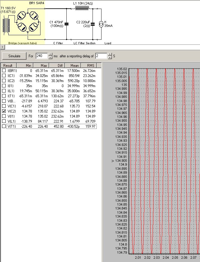

Hi Felipe,
With a genuine choke-input filter, the rms current in the secondary will only be a little higher than the dc current.
But it is best to have a good margin, so that the transformer runs cool, and so that you can experiment with higher anode current, or different DHT, etc.
E.g. For a Line amp with 100V on the anode, and (say) 35mA dc draw maximum in total (anode current, plus an allowance for divider or bleeder, or gas-discharge regulator tube) -
choose Choke-input filter, 160V rms trafo to get about 135V with the attached circuit.
The rms current in the secondary is about 37mA. Total Trafo VA is about 6VA. It would be better to choose something like 50VA to keep the regulation reasonable (ie loaded voltage versus unloaded voltage).
choose a transformer with an electrostatic shield, or a "split-bobbin" (dual-bobbin) EI construction. Cheap Toroidal not recommended, they will let the noise in to your amp.
With 135V dc unregulated, You can use a Shunt Regulator (eg SSHV) to regulate to 105V to 115Vdc.
Or you can use RC or (better) LC filter stages to get the target ripple-level.
Please use PSUD2 to adjust the transformer voltage, rectifier type etc to suit your goals.
160V 50VA is not a typical catalogue transformer (eg off-the-shelf Hammond), so a custom wound version is usually needed.

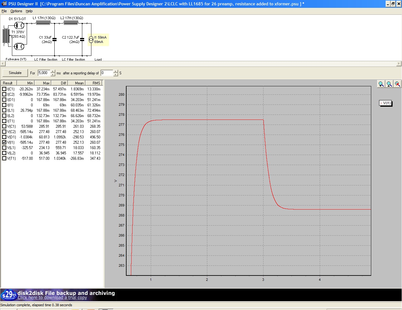

I'm using a Hammond 374AXP for my B+ supply (just call me Mr Overkill). Very nice potted, steel-cased transformer, dead quiet. PSUD is attached. Choke input supply with two Lundahl LL1685 17H.
The 122.7uF final cap takes into account 100uF plus 2.7uF bypass plus 10uF per channel in the preamp box. I have what's in the PSUD in the PSU box going to the preamp box and splitting per channel to a 10uF cap, CCS at 29.5mA, VR150-VR75 bypassed with .047 Jensen copper foil, plate CCS at 7mA (runs about 132V on the plate). Sounds nice...
