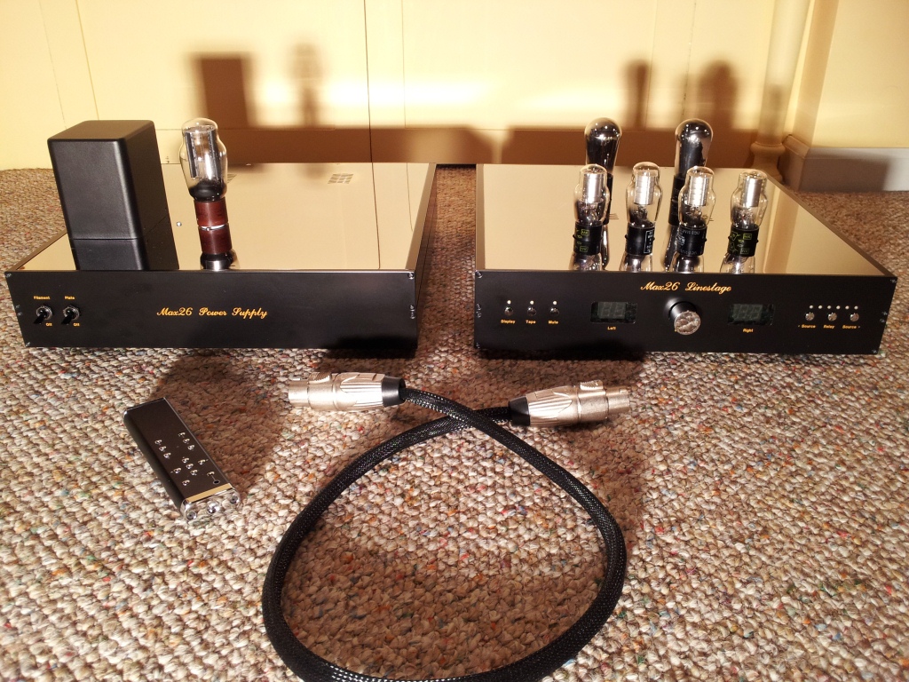

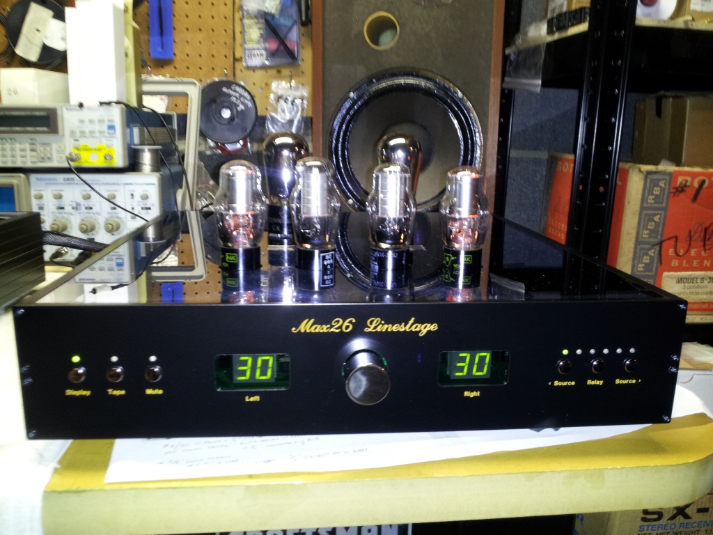

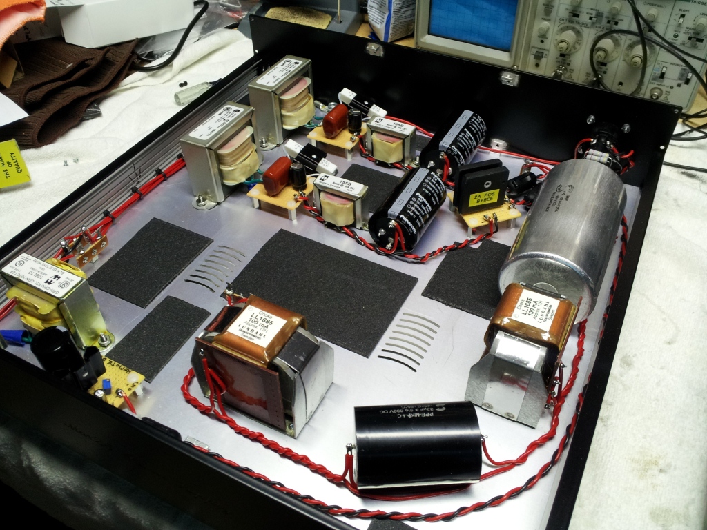

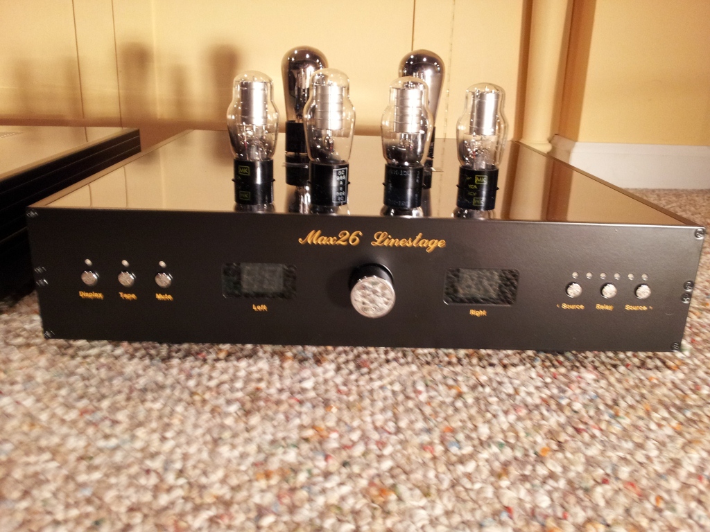

OK, here are some pics of my completed 26 linestage. First the whole package of PS, linestage, umbilical and remote, then a closeup of the linestage, then the linestage in operation on my workbench.

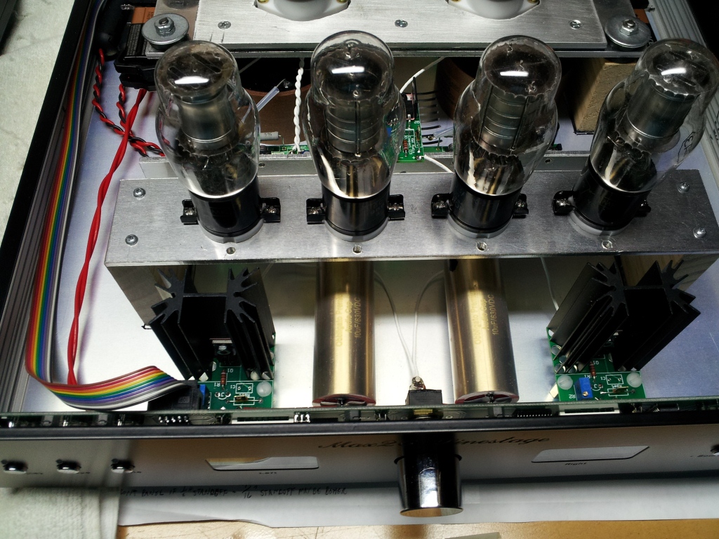

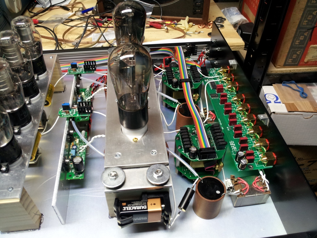

Now for some nudies:
First is the Power Supply Internals, then two shots of the linestage internals.
Hi Magz,
Superb job, well done! Very neat! I wish mine could look like that.

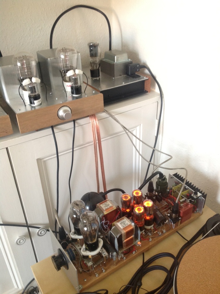

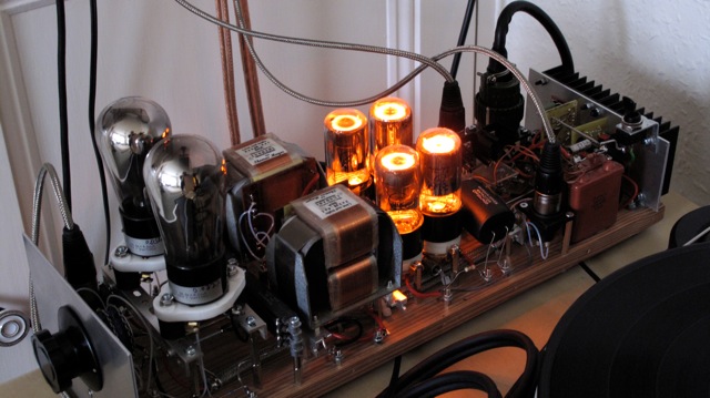

Here is my current 26 preamp incarnation with LL2745 and HT using russian glow tubes and dn2540 CCS "a la Gary Pimm"....
Ale

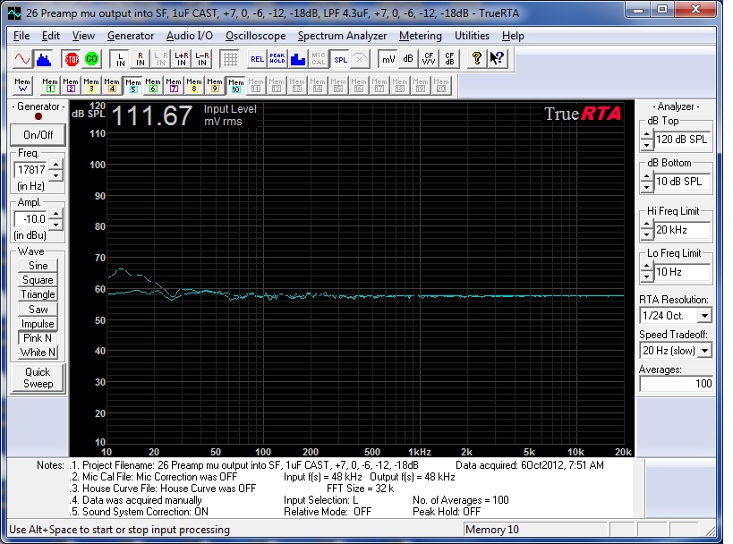

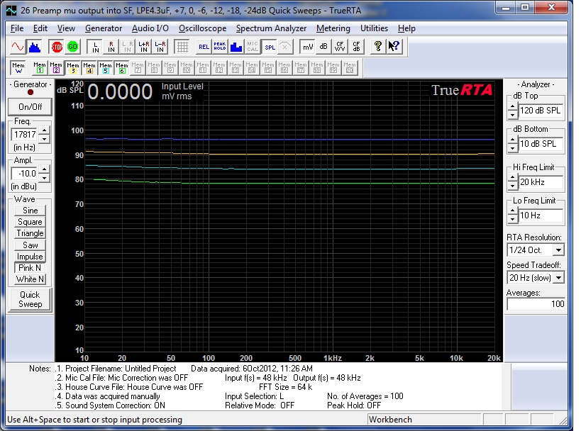

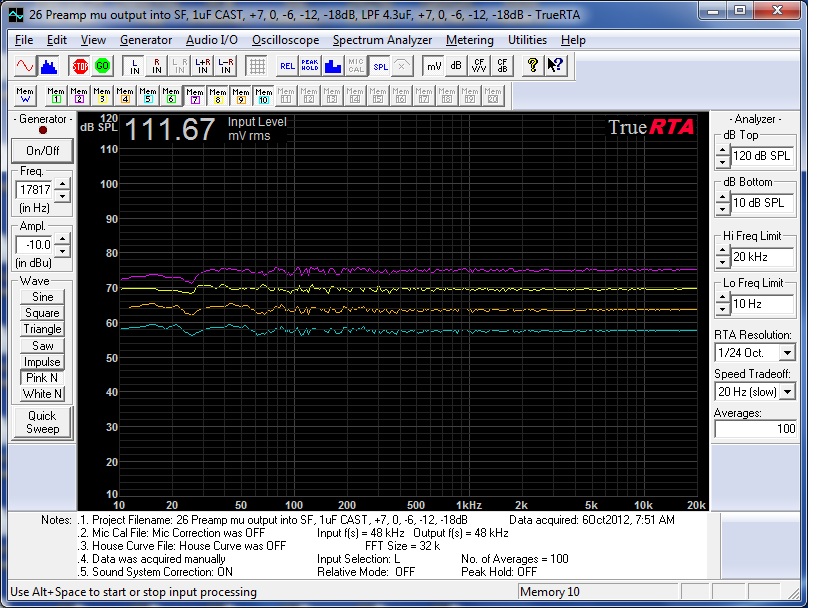

Now some Frequency Response Plots.
First is pink noise, at 0dB, -6dB, -12dB and -18dB attenuation at 1/24th octave resolution.
Second shows the impact of the lossy parafeed cap + resistor on the frequency response at -18dB. The plot with the 10dB hump at ~13Hz is using only a 1uF parafeed cap, while the flat plot also has a 3.3uF + 8,080ohm resistor in series added to the parafeed cap. The lossy parafeed (also known as DrP or damped resonance parafeed) really flattens out the hump and extends the FR much lower - my sims say 4.8Hz for the -3dB point.

So the B+ power supply is Hammond 374AXP - 5R4GY - LCLC followed by (for each channel) a 10uF cap - cascoded CCS + VR150-VR75 - cascoded CCS - 26 tube.
Filament supply (for each channel) is Hammond 10V 50VA split bobbin transformer - schottky bridge - 6mH, 2A Hammond choke - 33,000uF THSA Cap - Bybee Music Rail - 1000uF cap - Coleman regulator. Set at 1.5V.
The other small transformer at the front of the PS is a 10V 20VA Hammond for the control circuit power supply 9VDC.
Signal path is input - LL1676 transformer wired 2:1 (both sides in parallel) - 0.22uF Duelund CAST cap - 26 tube - 1uF Duelund CAST cap with 3.3uF Mundorf Supreme and 8080ohm TX2575 resistor in parallel - Bent Audio TAP autoformer volume control (~150H) - output.
Listening tests so far (~4 hours total). Very detailed, very warm, rock solid bass.
I LIKE IT!
My listening is typically in the range of -24 to -6dB on the volume control, with -6db being LOUD. My amp has selectable gain of 20 or 27db - I'm using the 20dB setting.

Oooops. Forgot a stage in the Filament supply. It's
Filament supply (for each channel) is Hammond 10V 50VA split bobbin transformer - schottky bridge - 2.2uF 10W resistor - 680uF cap - 6mH, 2A Hammond choke - 33,000uF THSA Cap - Bybee Music Rail - 1000uF cap - Coleman regulator.
Based on Rod's design, with a few minor deviations.
More details.
The filament transformers and HT transformer are all snubbed with .022uF caps and 330ohm resistors, the HT from each side of the secondary to center tap and the filaments across the secondary.
Power switch is wired so that the HT cannot be applied unless the Filament is on.
