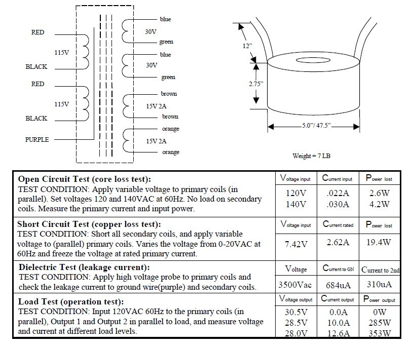

Hi Adrian,
The CL-60 is good.
Your diagram of the transformer 30VAC secondary wiring is incorrect. The two blue secondary wires should connect to one AC lead of the bridge rectifier and two green secondary wires should connect to the other AC lead of the bridge rectifier. For the 15VAC secondaries, use only on secondary winding. Connect one brown secondary wire to one AC lead of the bridge rectifier and the other brown secondary to the other AC lead of the bridge rectifier. The other 15VAC winding is not used.
The transformer purple wire for the shielding connects to chassis ground.
For the snubbers, both have the same capacitor values. Only the resistor value is different. As noted in my previous post, use 33R for the paralleled 30VAC and 29R for the 15VAC.

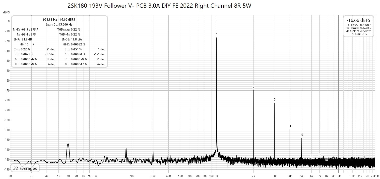

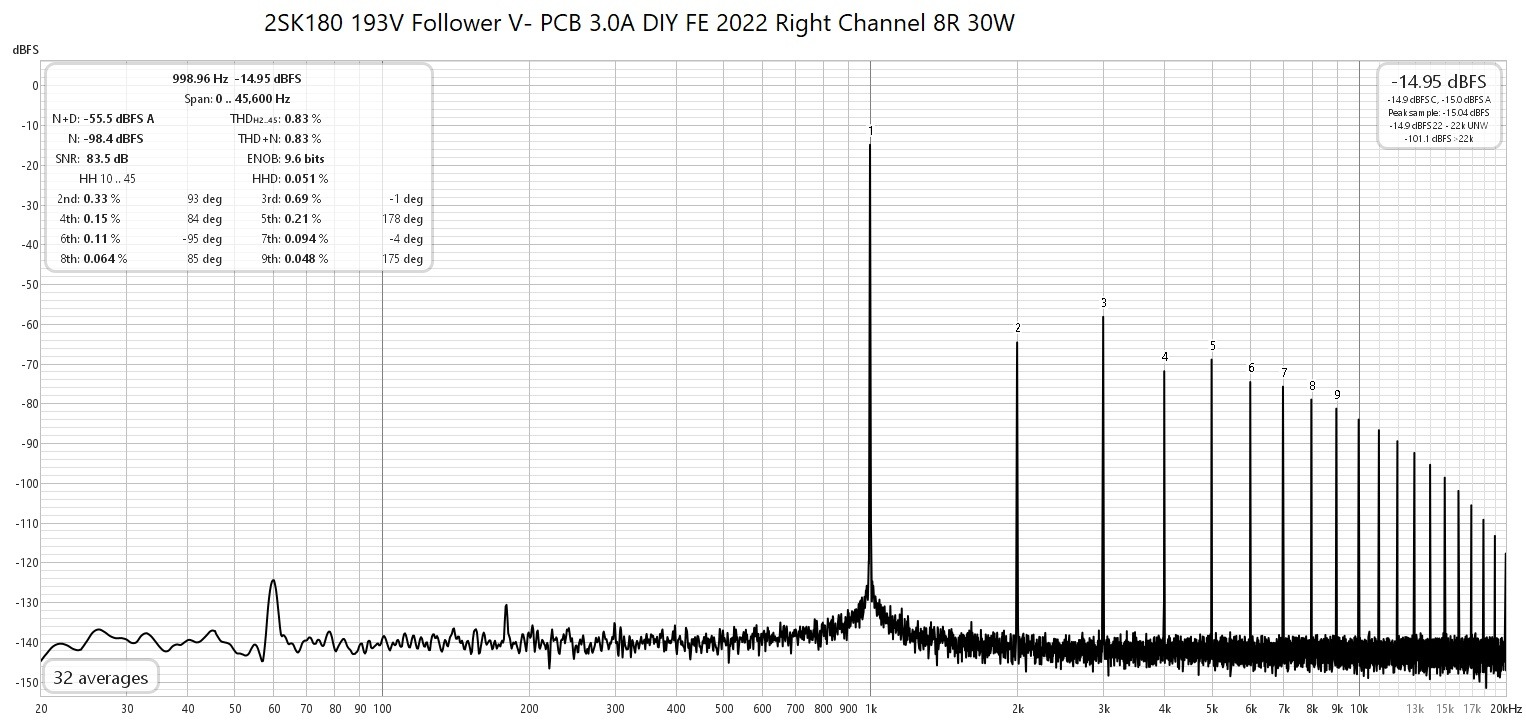

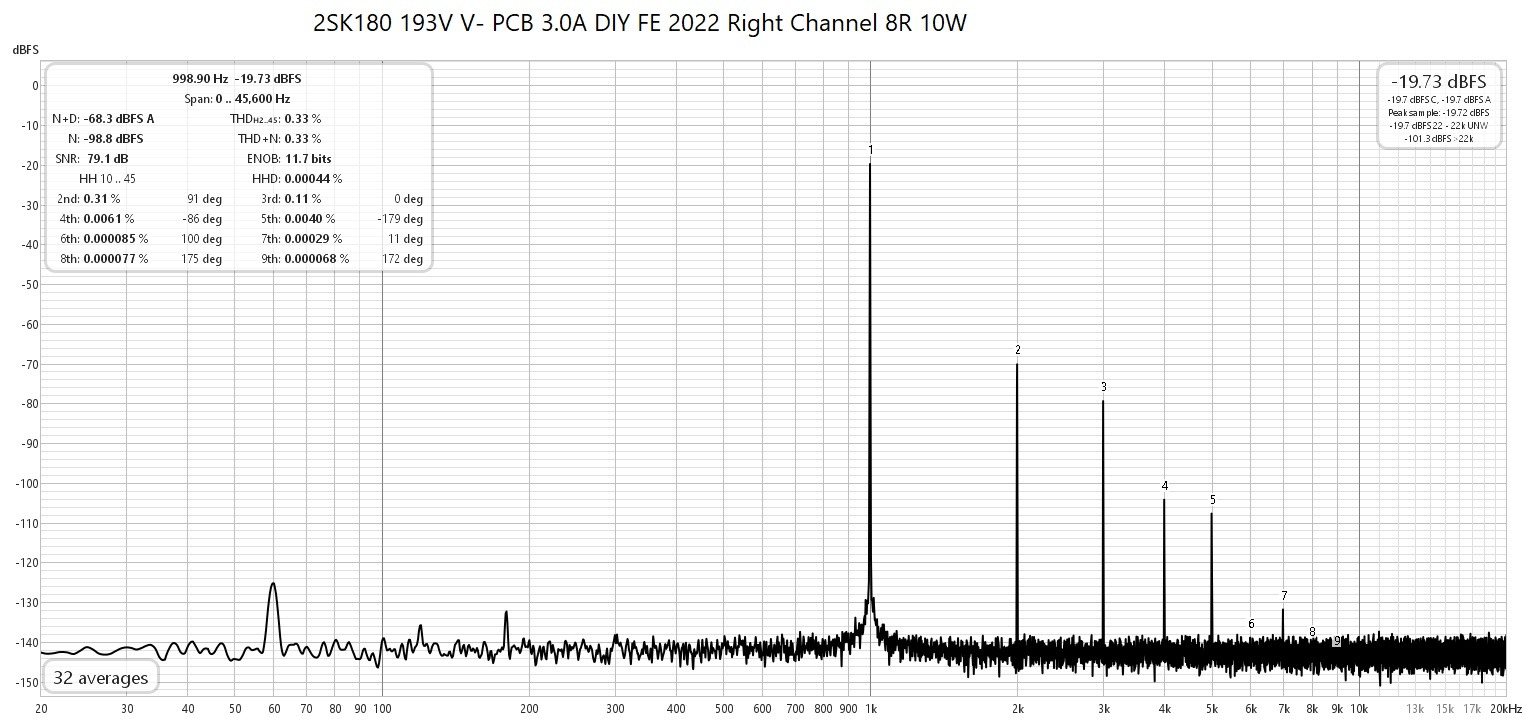

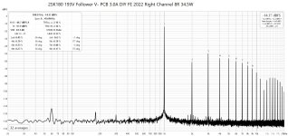

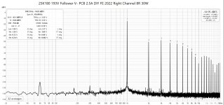

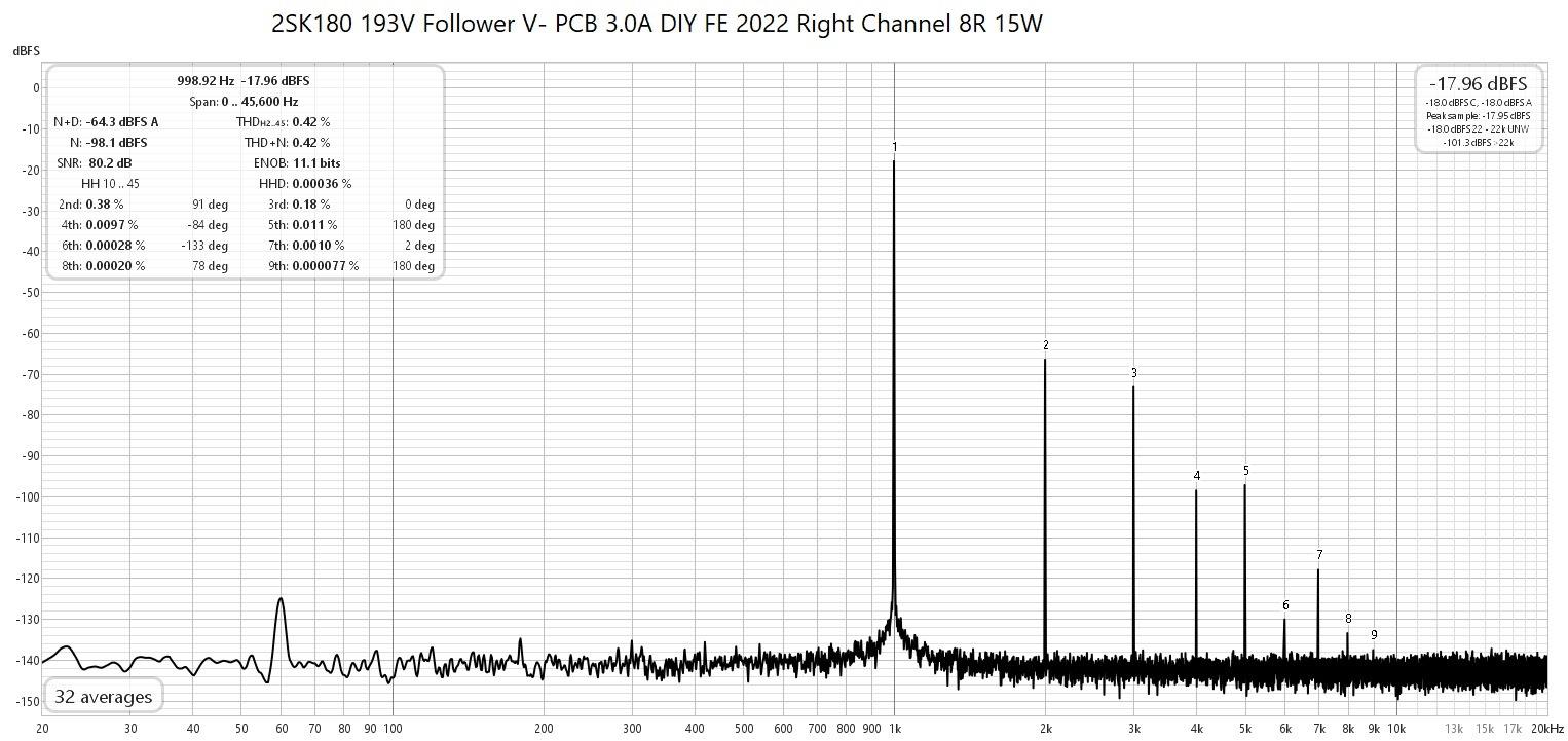

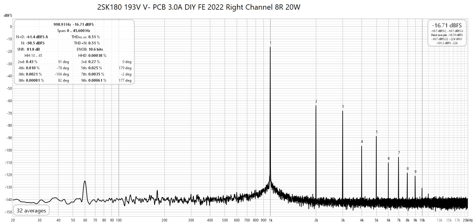

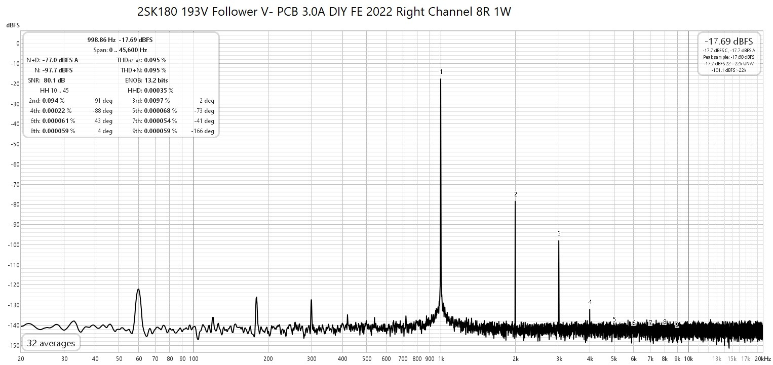

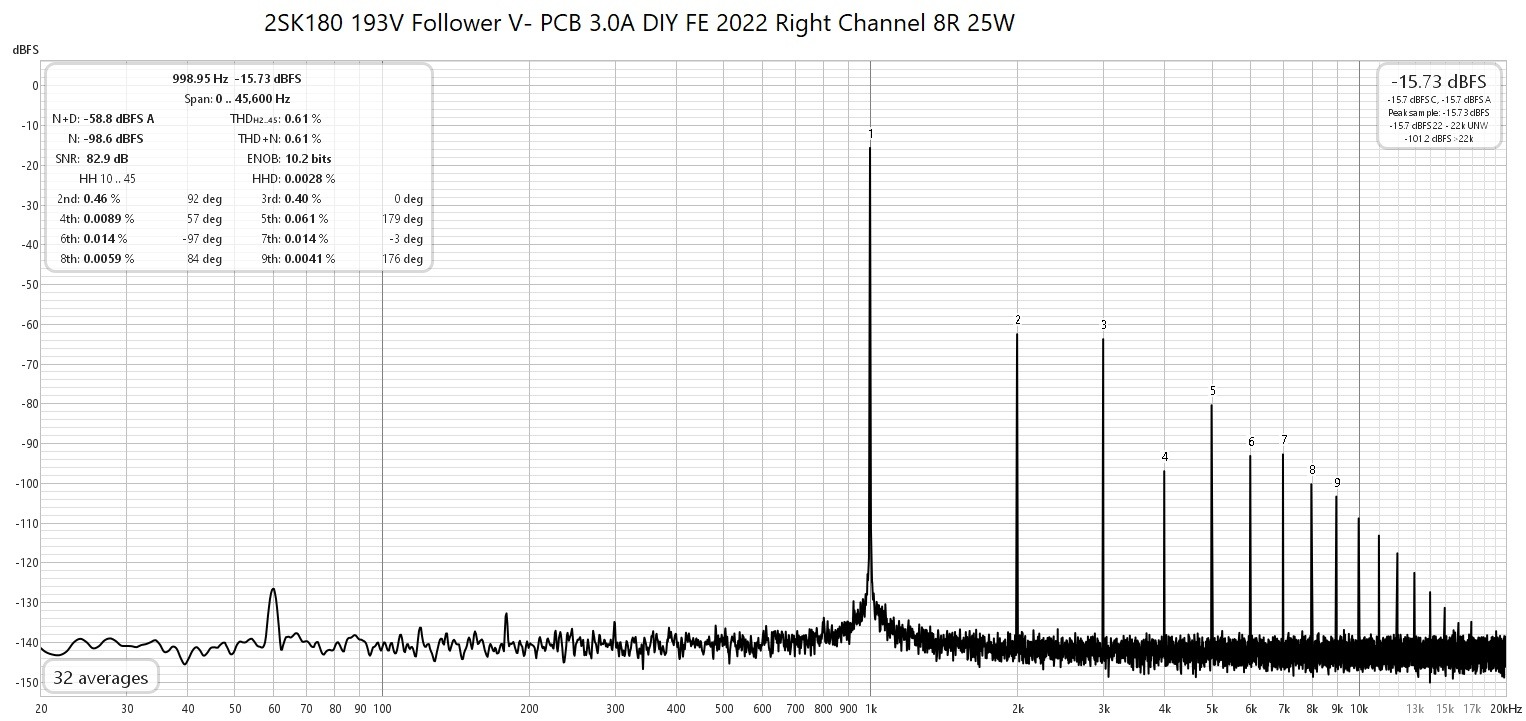

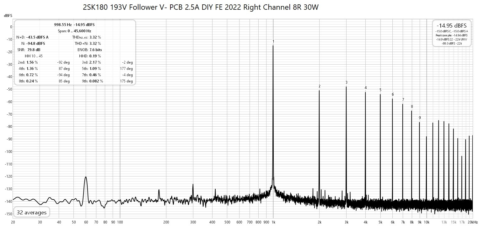

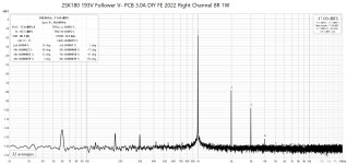

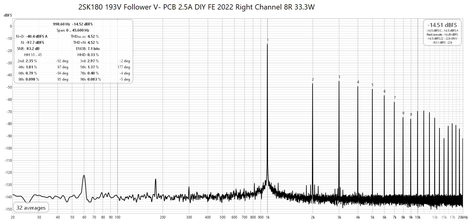

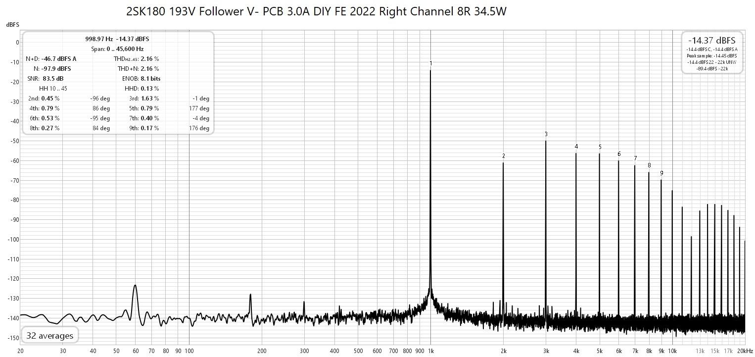

Since Adrian is building this choke loaded follower with a THF-51S in place of the 2SK180, I decided to see what this amp can do with higher Iq. I also realized that since I changed the amp from common source to common drain, I did not try to see how much power it can actually put out. So with Iq set at 2.5A, I pushed the power as far as my Victor oscillator and 62.5V PS DIY FE 2022 could go. At maximum oscillator and DIY FE voltage output, I measured 33.3W at 8 Ohm and 4.52% THD. For distortion figures at lower power output, see https://www.diyaudio.com/community/...-choke-loaded-2sk180-lamp.366312/post-7420685.
So then I upped the Iq to 3.0A. That put the dissipation at 104W. The 2SK180 is a 300W device so 104W was 35% of that. I think that is doable as long as the heatsink is big enough to keep the SIT at a comfortable temperature. The THF-51S is a 400W device so there is a much larger comfort level.
The higher Iq resulted in slightly higher distortion at low output levels but much improved distortion performance at higher power output.
35W at 8 Ohm looked good with an Iq of 3.0A. So I would call this choke loaded Tokin follower a 35W amp.
2SK180 193V Follower V- Right Channel 3.0A DIY FE 2022 8R 1W.jpg240.4 KB · Views: 118
2SK180 193V Follower V- Right Channel 3.0A DIY FE 2022 8R 5W.jpg240.1 KB · Views: 128
2SK180 193V Follower V- Right Channel 3.0A DIY FE 2022 8R 10W.jpg238.9 KB · Views: 100
2SK180 193V Follower V- Right Channel 3.0A DIY FE 2022 8R 15W.jpg240.7 KB · Views: 102
2SK180 193V Follower V- Right Channel 3.0A DIY FE 2022 8R 20W.jpg238.8 KB · Views: 105
2SK180 193V Follower V- Right Channel 3.0A DIY FE 2022 8R 25W.jpg241.3 KB · Views: 103
2SK180 193V Follower V- Right Channel 3.0A DIY FE 2022 8R 30W.jpg243.2 KB · Views: 105
2SK180 193V Follower V- Right Channel 3.0A DIY FE 2022 8R 34.5W.jpg243.9 KB · Views: 125
