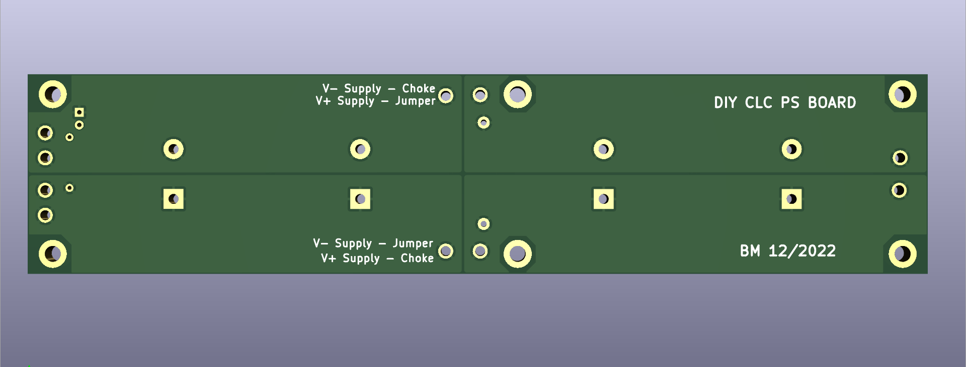

ahh, so my eyes did deceive me, carry on. Maybe a bit more space around those, as some people may get carried away with the lockwashers.

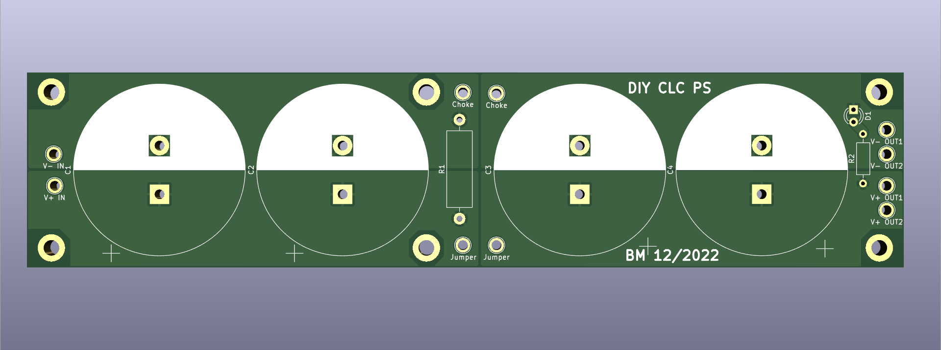

To Monk55, mgb1965, and everyone who may be interested in the PS boards, the amplifier boards are about to leave JLCPCB and make their way to me. I will hopefully be able to have the amplifier board tested in a couple of weeks. If you intend to order the amplifier board and PS board together, then I will send both files to you after the amplifier board is tested.
+1ahh, so my eyes did deceive me, carry on. Maybe a bit more space around those, as some people may get carried away with the lockwashers.
I did change it to provide a bit more space but I hadn't posted the images. So here they are (for the lockwasher people), not that I see a need for lockwashers to fasten a pcb:

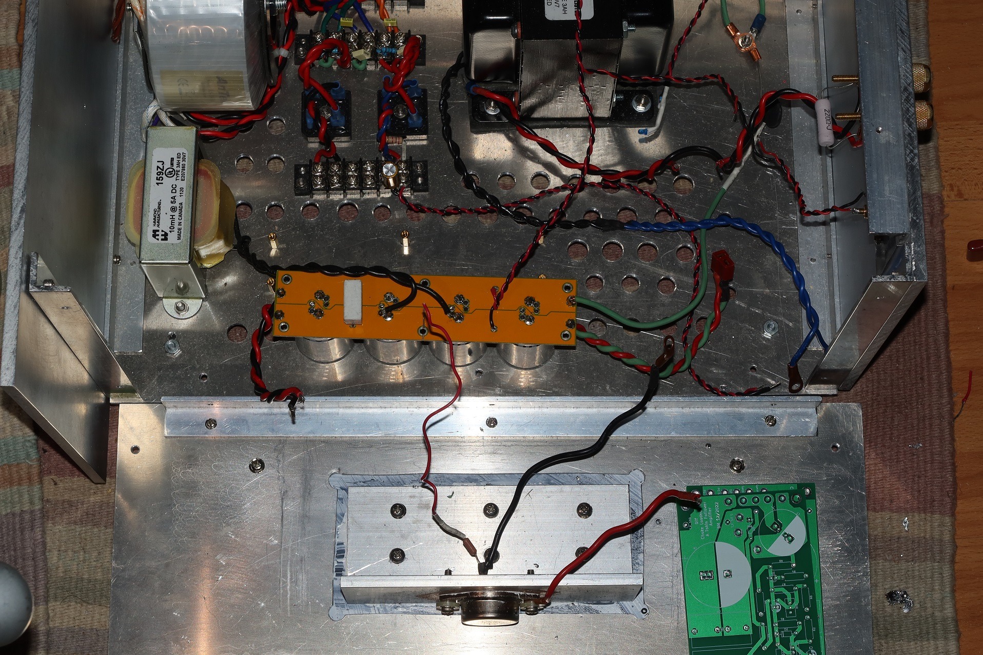

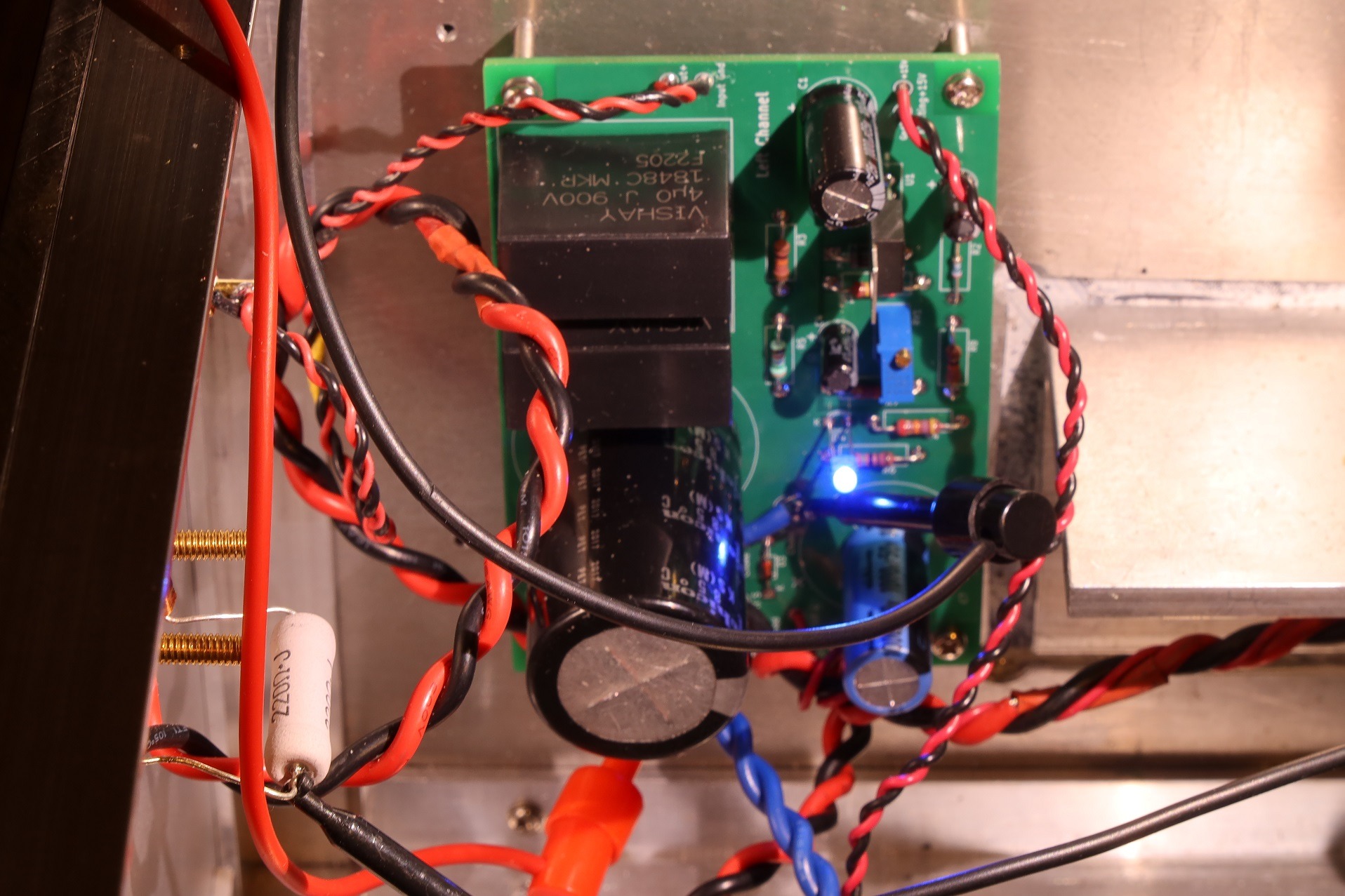

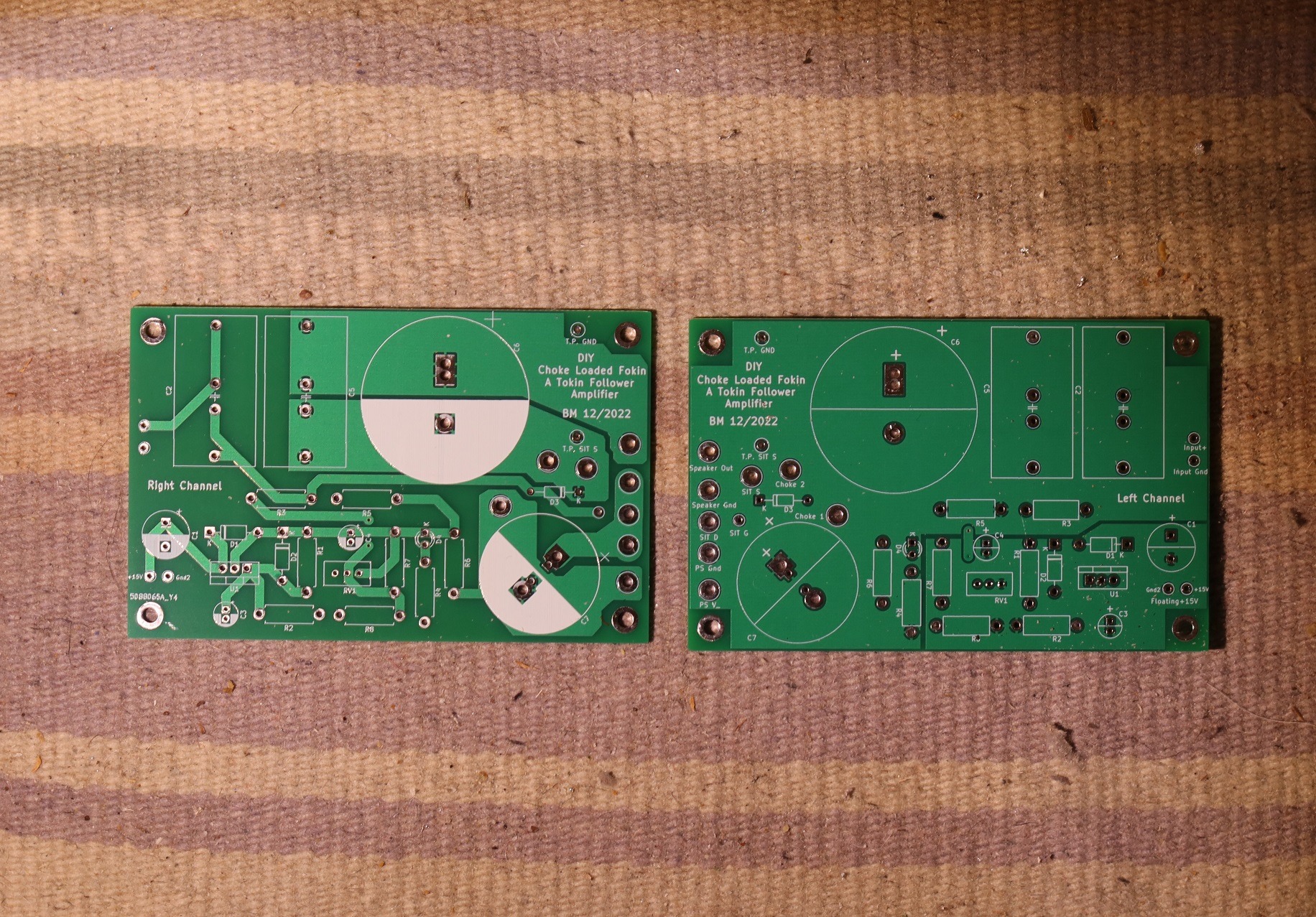

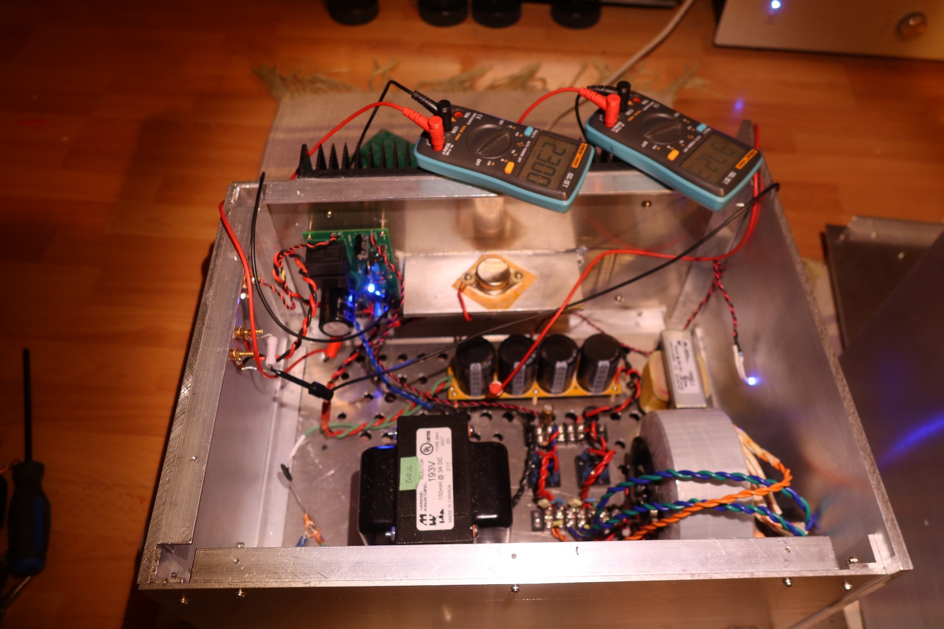

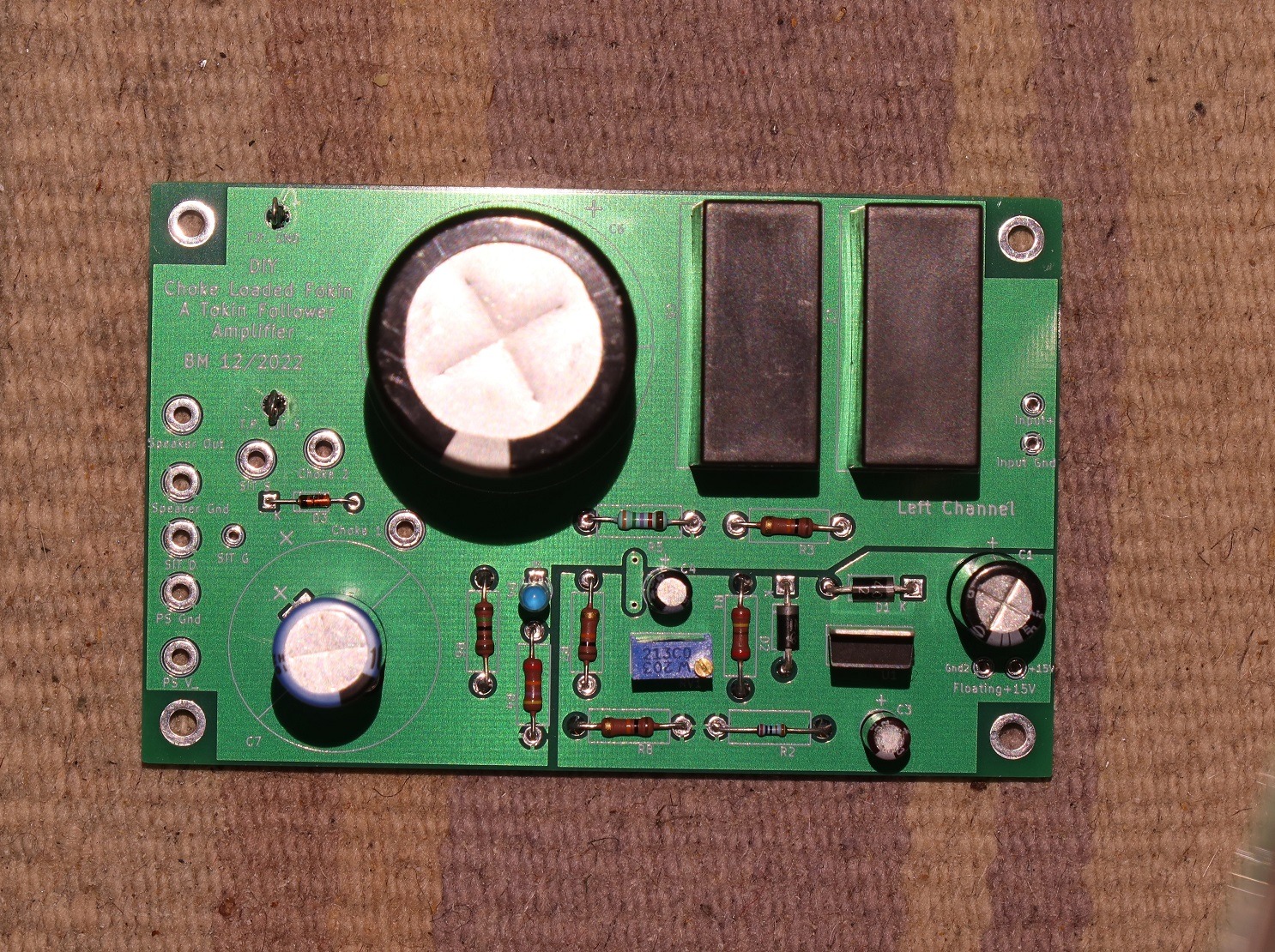

The boards were delivered on Christmas Eve and I finally got them stuffed and installed.
I'm still learning Kicad and trying different things, and that resulted in some silkscreen labels not getting on the Gerber files. I could have discovered the issue before ordering the boards if I had done a more thorough review of the Gerber files - lesson learned. Fortunately, the labels are only missing on one side of the board. So one channel is assembled, the existing power supply changed from V+ to V-, the power supply tested, and the board installed.

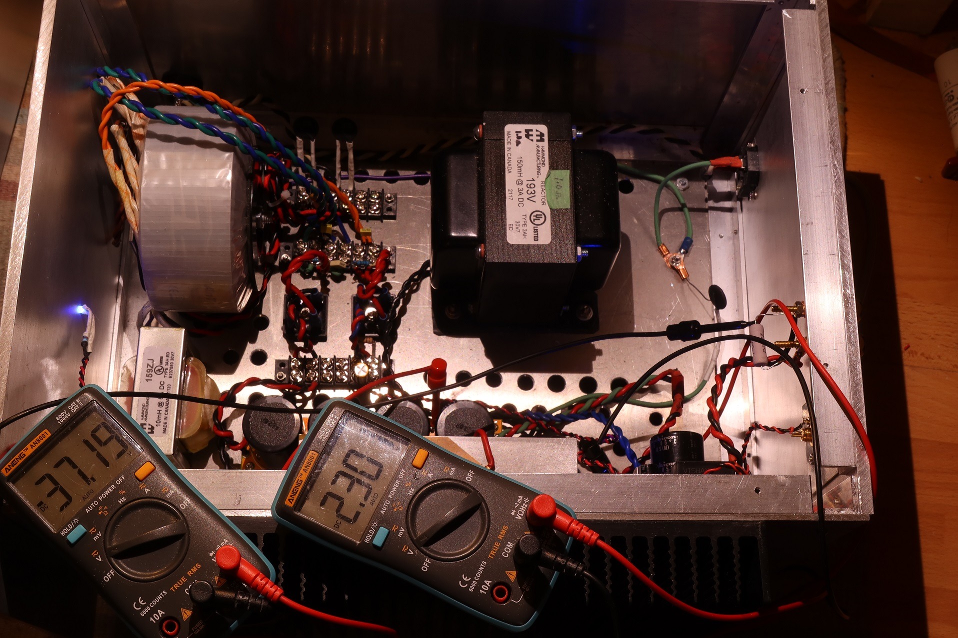

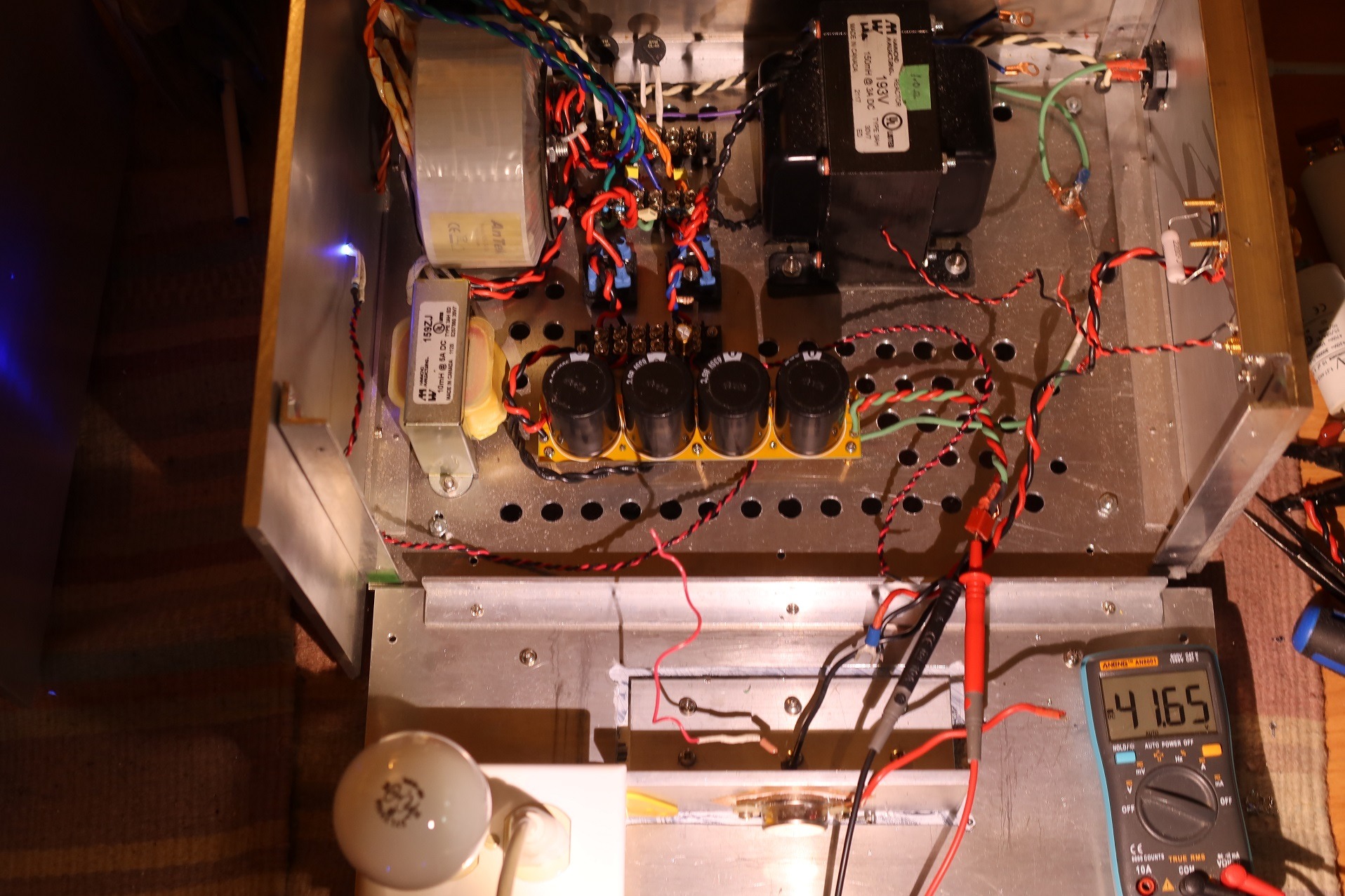

It is now powered up and has been running for about two and a half hours. Currently it is at design Iq of 2.5A, with V- at -37.5V and Vds at 35.0V.
Tomorrow I will do some power and distortion measurements. Hopefully there will be no problems.
Tokin SIT Follower 193V Bias Adjust in progress-V-37.19V Iq 2.3A Vds 34.89V.JPG593.3 KB · Views: 196

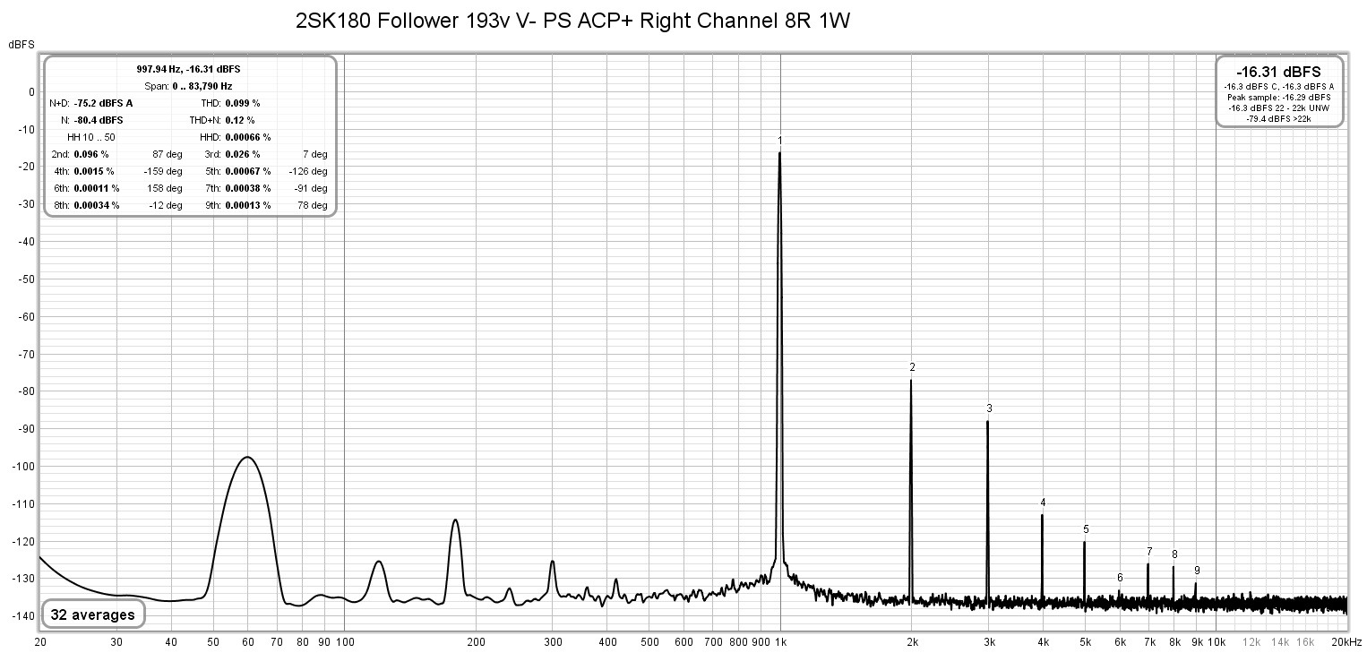

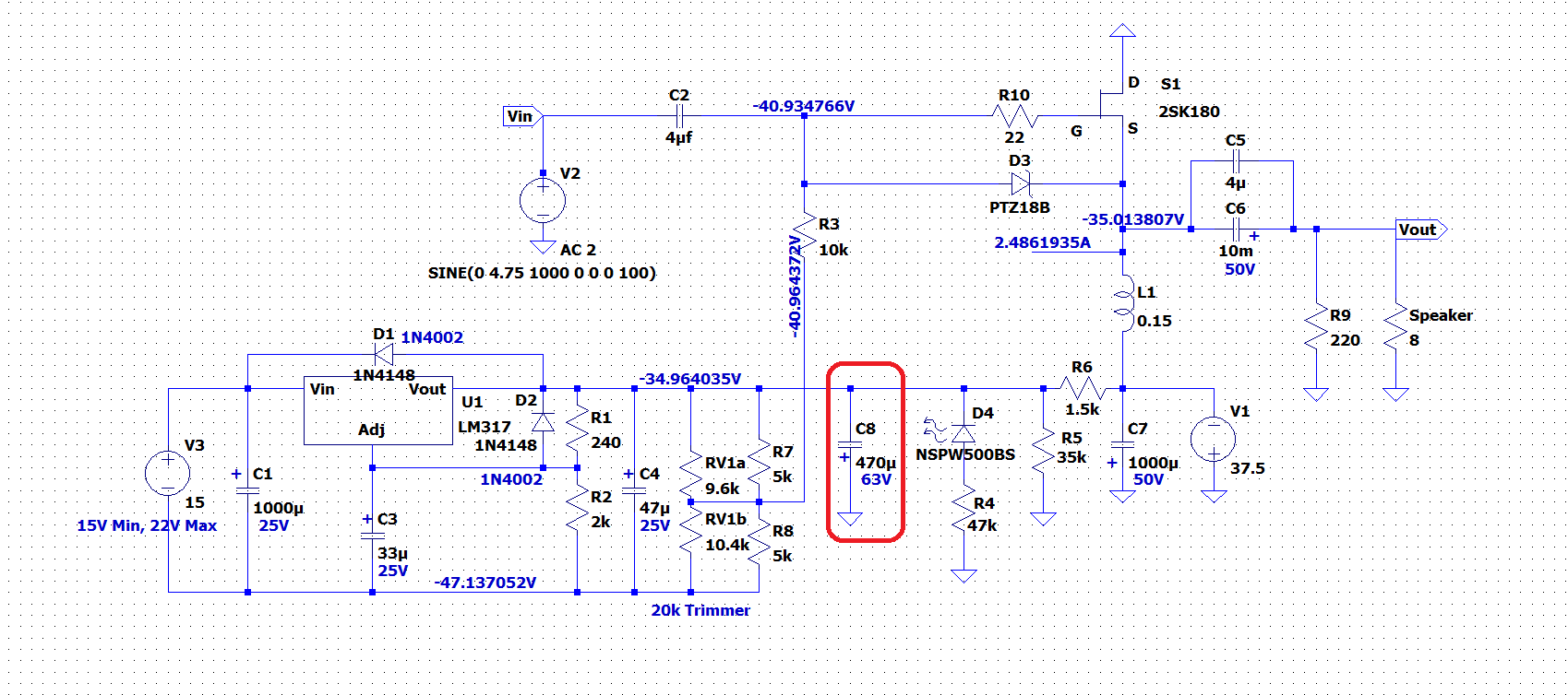

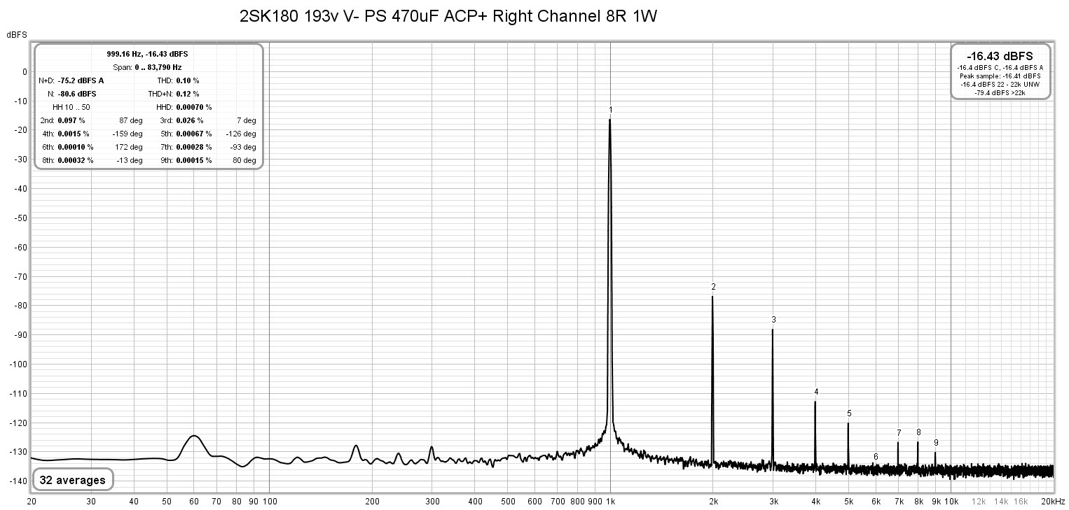

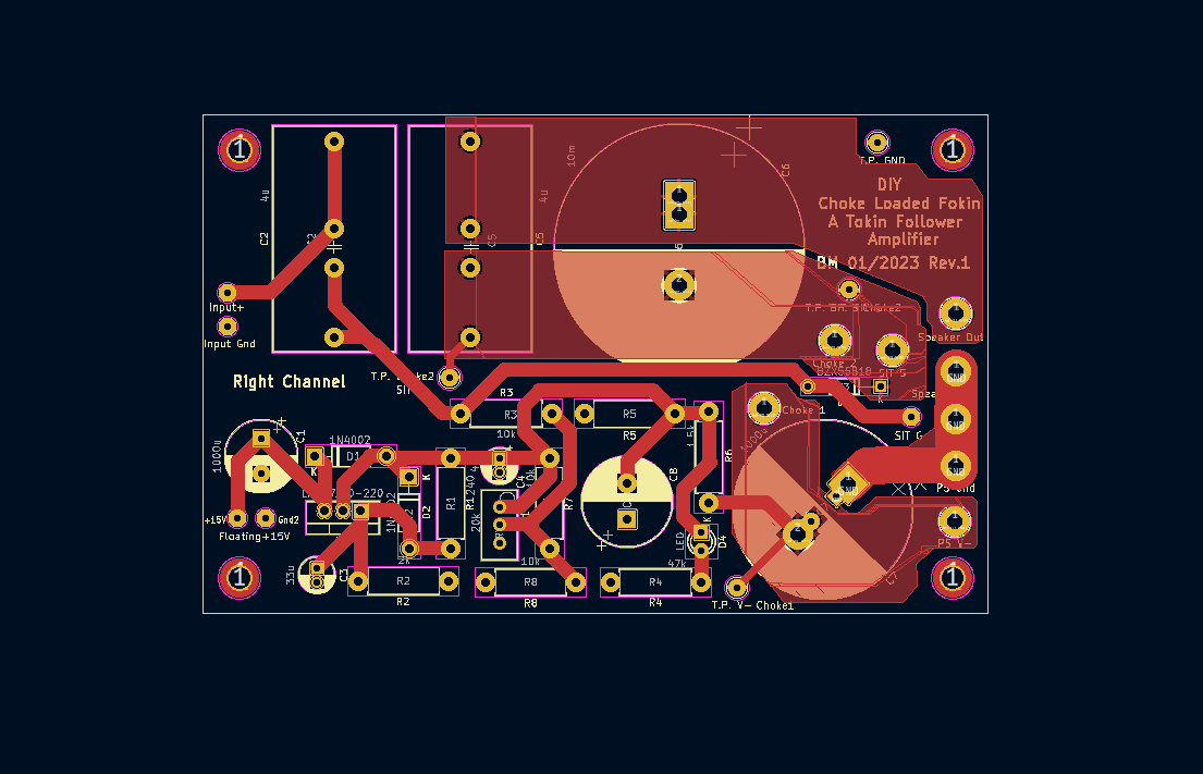

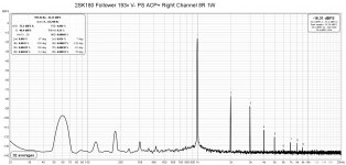

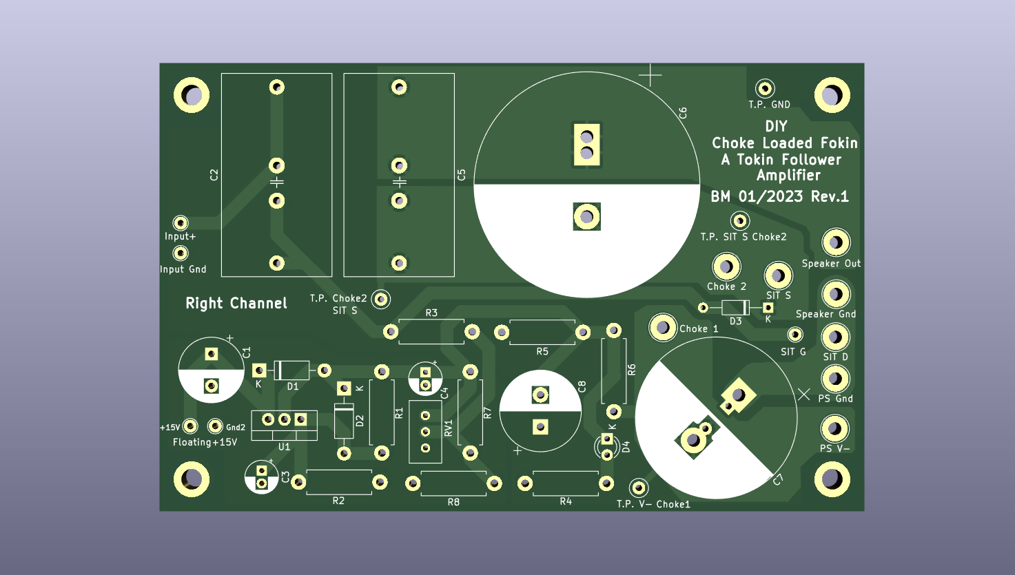

Testing turned up a major noise issue at 60 Hz and 180 Hz. Since I had revised the power supply, I checked it thoroughly but didn't find anything wrong with it. I then turned my attention to the bias voltage supply on the pcb and that was the source of the problem. That all took several frustrating hours but with the addition of a capacitor at the end of the bias supply, the noise is now at a much lower level.
I have revised the pcb and hopefully this version will be the keeper. I'll review it again tomorrow and if I don't see any issues, I will order another five boards.
FFT-before and after, revised schematic and board attached:
2SK180 Follower 193v V- PS ACP+ Right Channel 8R 1W.jpg237.3 KB · Views: 238
2SK180 Follower 193v V- PS 470uF ACP+ Right Channel 8R 1W.jpg234.9 KB · Views: 400
