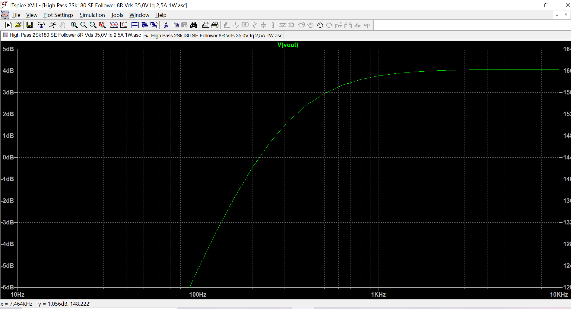

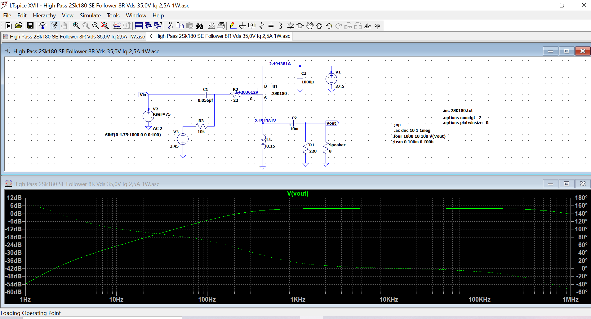

I'm getting hold of a pair of 2SK180 devices with a view to building the design in post #109. I'm assuming the 2SK180 will need to be biased at around 2.5 - 2.7A
I plan to use it to drive a full-range speaker in a Pass SLOB project. I am already working on a MoFo buffer and planned to roll-off the bottom end of the MoFo (to explore if I can dispense with a separate crossover hi-pass filter) by adjusting the the input capacitance and using a smaller choke.
As this is conceptually similar to the MoFo I'm thinking a similar approach should be viable. If I assume a first order Hi-pass CR filter with R=16K (R2, P1 (50%) & R3 in series), reducing C1 to 56nF will give me a -3dB point at about 180Hz. I'll need to see if I can find a suitable smaller value choke to experiment with for a reduced bandwidth implementation.
I'm no EE so will value any observations about this approach. Obviously, the fall back position will be to use a separate hi-pass filter.

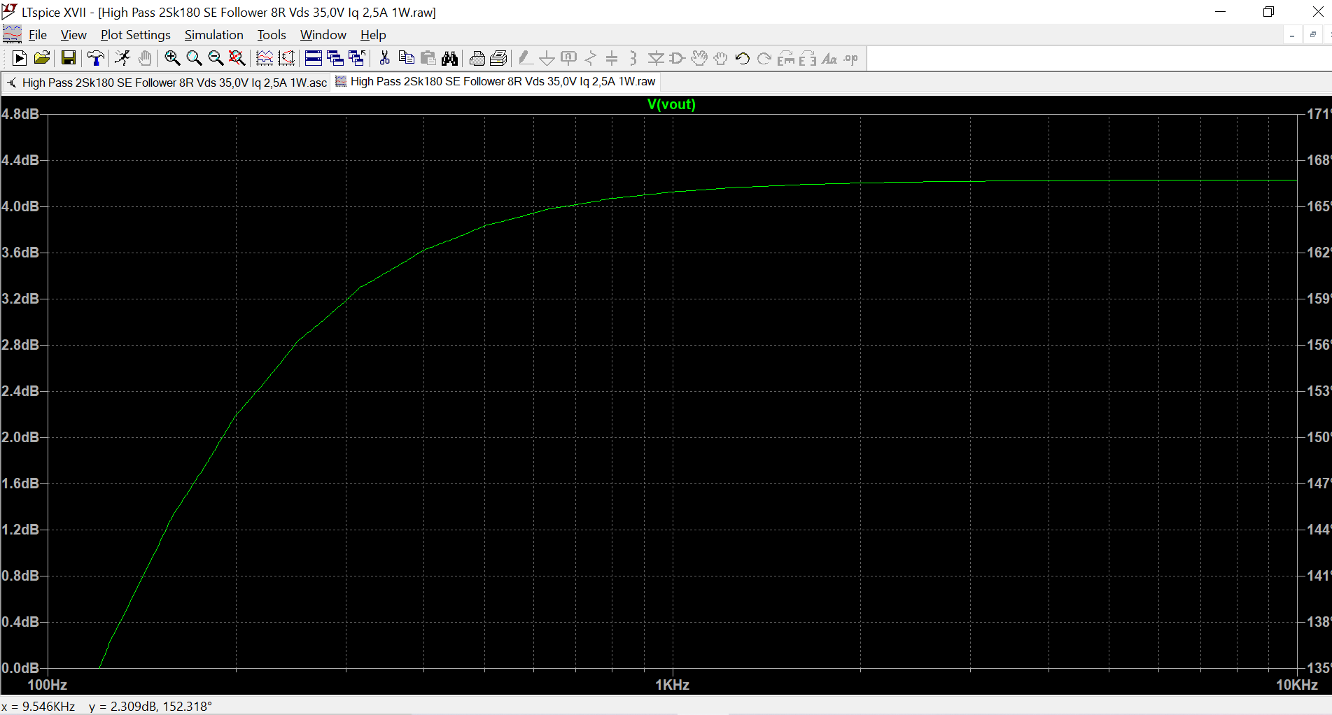

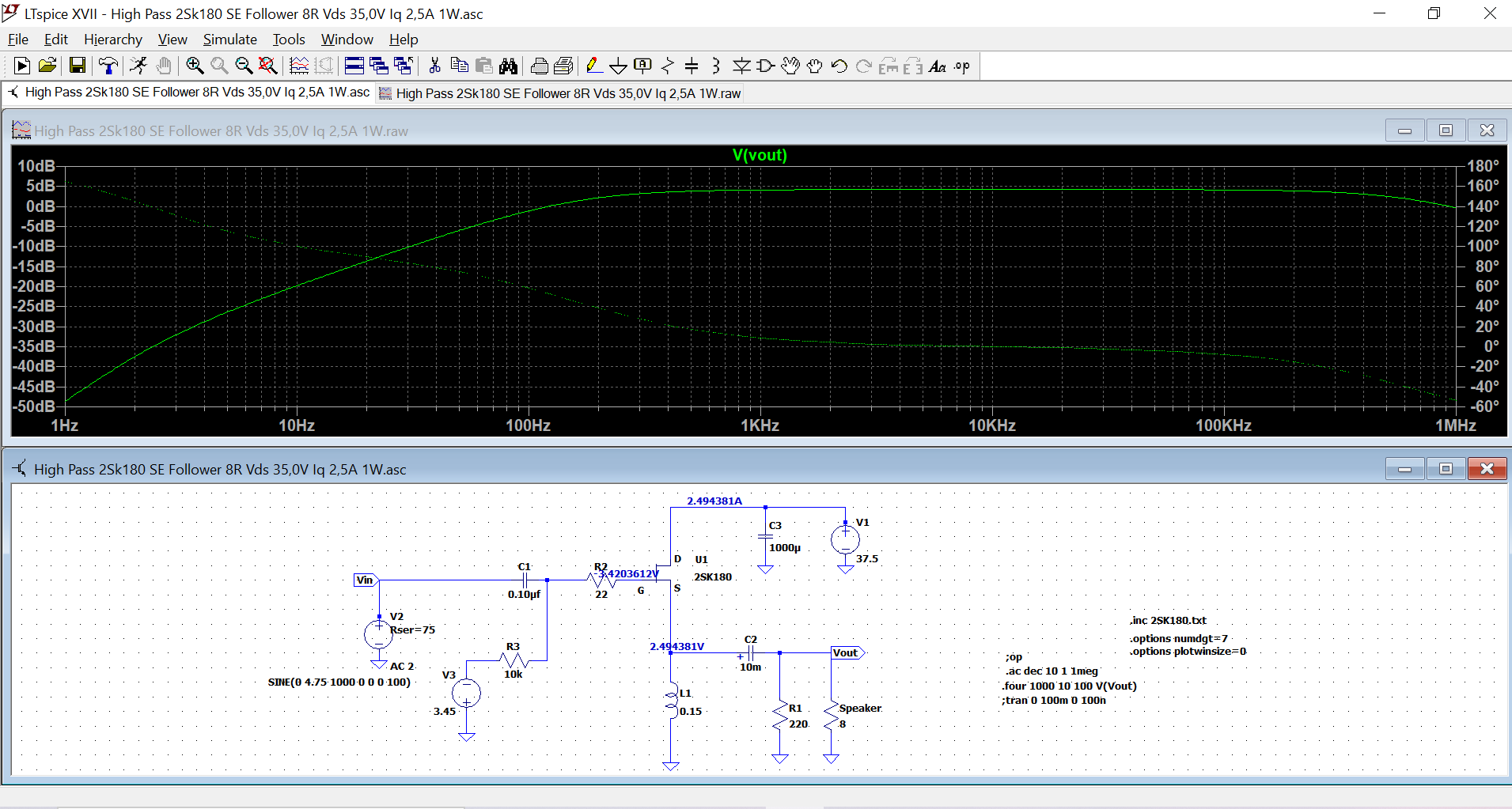

You can experiment with the operating points. I chose Vds and Iq based on my testing of the samples that I had, looking at the power output and distortion profiles.
Choice of choke will depend on how much power you want. The 193V is rated at 3A. If you choose a lower inductance and lower current rated choke, it will affect the power output and frequency response.
If you keep the 193V and the component values, then changing the input coupling capacitor value will change the low frequency response. I did simulations for 100nF and 56nF:
