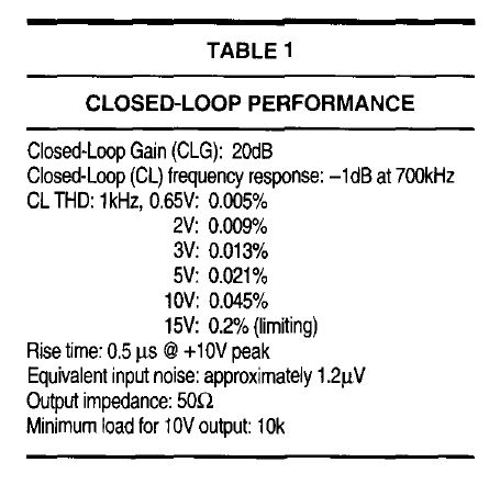

I was reminded that I have a pair of Erno Borbely hybrid pre-amp modules that might make, at least initially, a suitable driver for the follower configuration, see attached screengrab. It's the second of the three Borbely designs featured in Glass Audio 1/98;
https://www.pearl-hifi.com/06_Lit_Archive/14_Books_Tech_Papers/Borbely_Erno/Borbely_on_Line_Amps.pdf
Maybe a good partner in that it also uses 'vintage' silicon in the shape of now rare Toshiba mosfets (which I have).
I've used this circuit before, a few years ago, as the I/V stage of a RAKK DAC and it sounded very good.

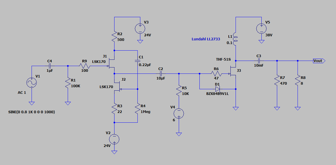

I have been doing much reading, attempting to learn the ways of the sand. I am still rather fresh to diyAudio in general and I am no engineer, so the best way for me to learn is by doing. I like to use simulations as a tool then build and measure in real life. This approach was very helpful for me when learning single-ended class A tube design.
When I started, I would latch on to a design idea or component and then find a way to implement it, narrows the scope of what needs to be learned. I decided I would like to use a JFET buffer on the input of this theoretical THF-51S common source amplifier inspired by Ben's work. I am also a sucker for things that glow and expensive iron, so a Lundahl choke load on the THF-51S (K&K Audio has taken lots of my hard-earned money). The LL2733 is rated at 0.1H at 3.4A with the coils in parallel, 0.85ohm DC resistance. With 2.5A bias, will be higher than 0.1H in reality, seems a good choice.

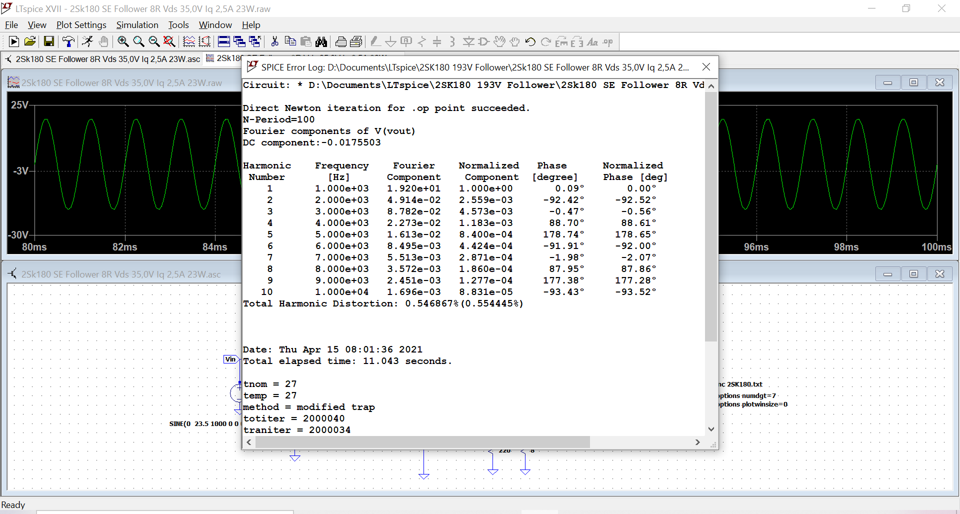

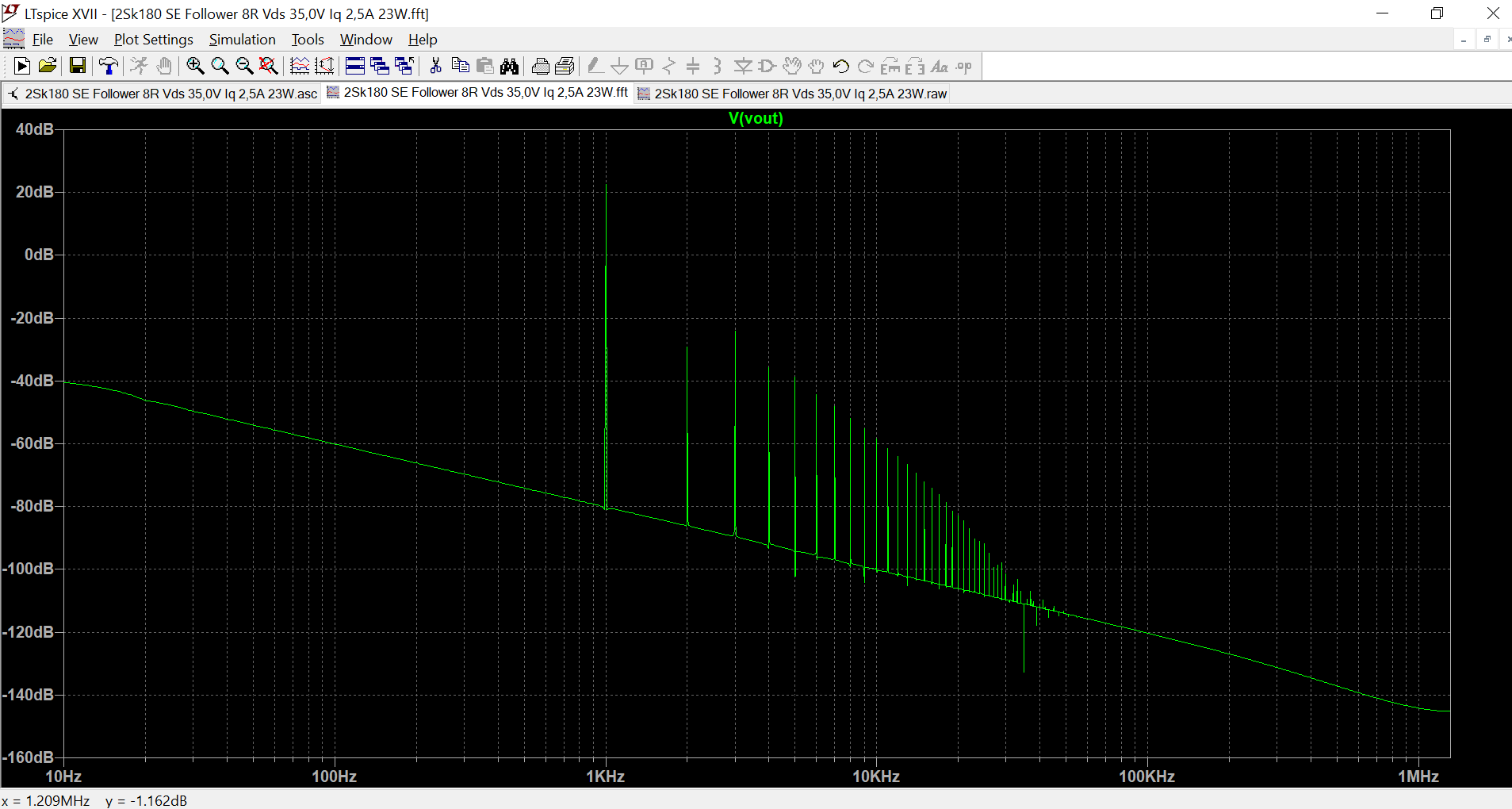

I read in great detail Erno Borbely's exquisite article "JFETS: The New Frontier" in which he overviews biasing and basic circuit design, including buffers. From that, and with the input capacitance of the THF-51S in mind, I though his JFET version of the White Cathode Follower was the best pairing.
Borbely measured a 2.3ohm output impedance from the circuit. In simulation, it measures 4ohms using 2SK170 model (LSK170 in reality). This seems to give very good bandwidth results using the 2SK180 model.
Obviously this leaves lots to the imagination (bipolar supply, bias supply, etc.) and various V+ supply values need to be reconciled, but I think this is the framework from which I will try to design my amplifier.

The Borbely is close enough at 15V, assuming it is V peak.
Thanks Ben Mah. It looks as though I might have a couple of options for a driver stage as I have been following up on the capabilities of the 2P29L tube preamp I'm building (using the Bartola Mu Follower 'Gyrator' schematic). I am trying to get my head around the maths to calculate the output impedance but I'm told that Zout for the Bartola genre preamps is typically well under the 75ohms you mentioned previously. Maths isn't one of my strengths so it's taking a bit of effort!
I tried this circuit about 6 months ago with THF51-S but with 25VAC transformer. Never was able to get a stable bias. Maybe the higher voltage (30VAC) is the key or maybe I didn't have the patience

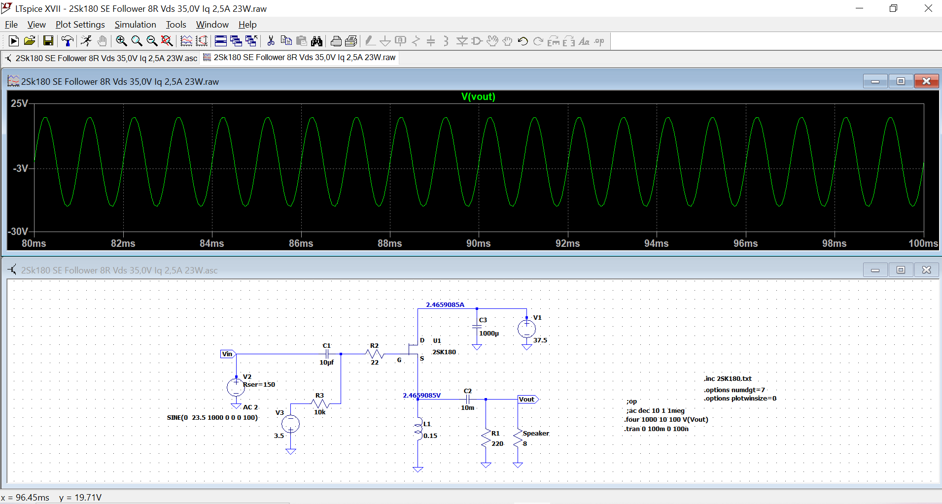

LOrdGwyn,
I like using simulations too, for both trying new circuits and understanding existing circuits. I only started using LTSpice last year and it has been a great educational tool for me.
Since I don't have a preamp or voltage gain section built yet that can drive the Fokin to maximum power, I have used a LTSpice simulation to determine maximum power. It is a not a replacement for testing but it gave an estimate. The following shows output of about 23W or 24W at 8 Ohms.
