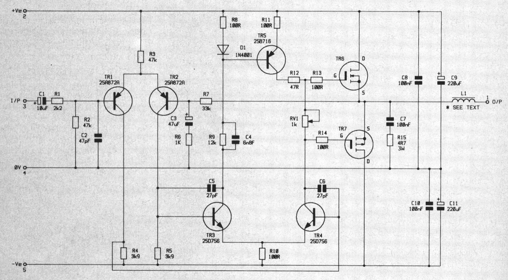

Ah yes I am using the Maplin board which Prasi laid out and I have perfectly matched Hitachi Laterals 1058/162 and struggling to find out the biasing resistor and what bias in voltage term should I set to.
Thanks hopefully others who would have built the same one can chime in.
Thank you, and I using the board from post . So I need to set it to 100mA bias on the 100R resistor. I usually use the voltage side of the DMM for precise bias, so 100R*100mA = 10mV and I hope I got my calculation right 🙂
Let me do thatA, thanks again.
For 100mA bias, use a 10R-0.5W to 1W resistor, set 1 V across it.
V=IR= 0.1A x 10R=1V

There is a small concern about the bias, as it appears to be sensitive to
supply voltage. If the DC supply is constant, no issue, but I expect the
voltage across RV1 to drift upwards with supply voltage.
Thanks Papa, I am using a 22vac transformer which is giving me a very stable +/-34.5vdc. Able to use RV1 to set the bias without drifting so far. But I am yet to do this setup using the 10R/1-2W resistor as Prasi suggested for 1V bias across this resistor.
Using a 10R/2W resistor I was able to set the bias to 1V per Prasi suggestion which makes it to 100mA. Played few tracks and its playing beautifully. My small 120/100/50mm heat sink is barely warm even after an hour of playback. Offset is pretty stable around 5-6.7mV.
Thanks all.

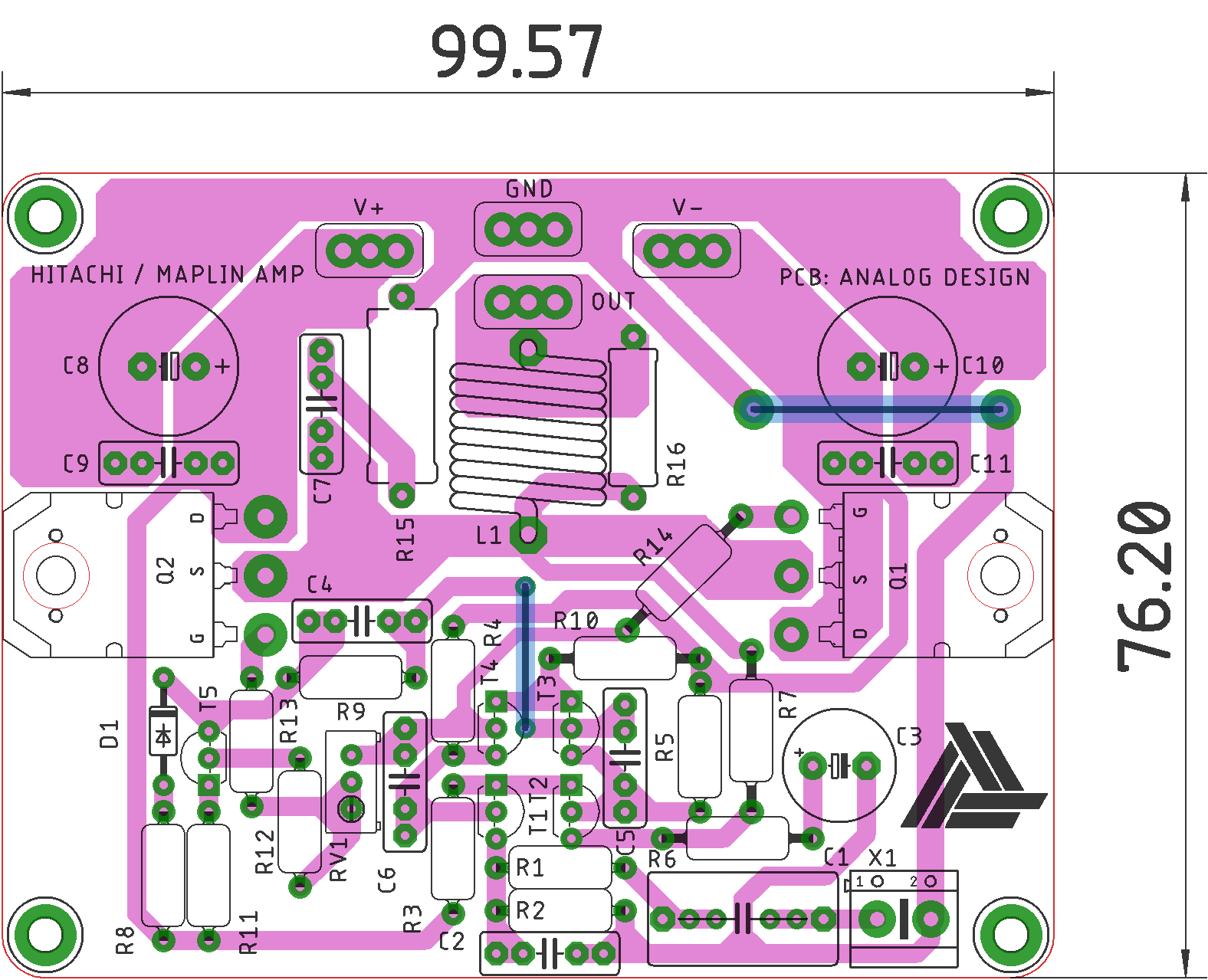

At last found sometime to finish the Maplin and it sounds excellent. Thanks to Prasi for the beautiful layout. I get slight hiss kind of sound which not sure because of my usage currently with closeby AC wiring. I am yet to check with my main speaker setup of Troels 🙂
Few build pics for you Prasi

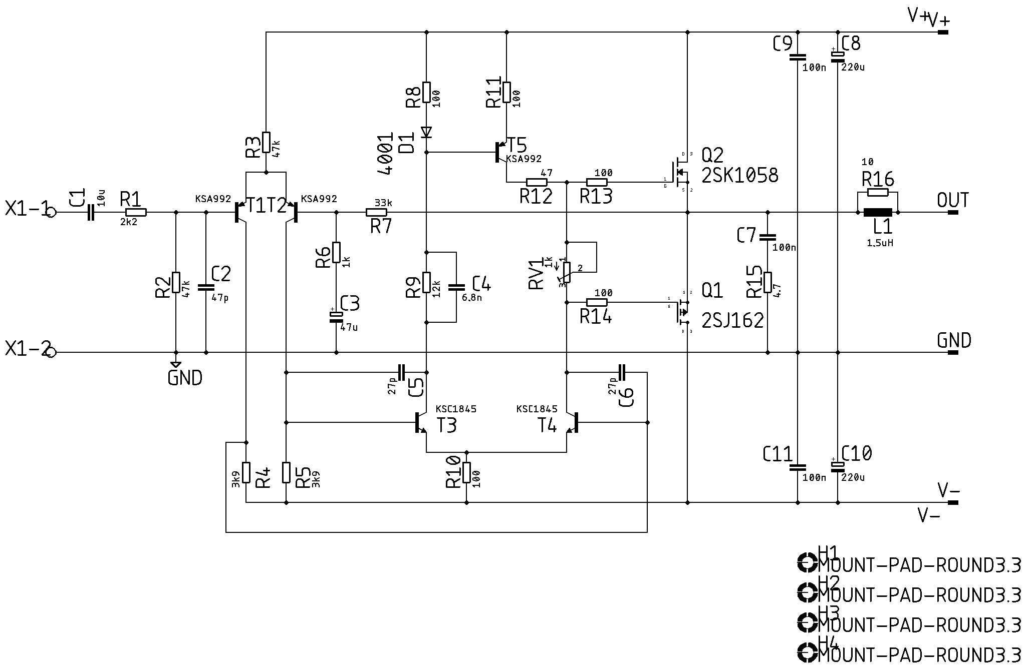

100pf on Q4's base and collector is way too much - 10pf or so is more like it.
Try to slightly increase C4 or introduce a couple of pf over R10. Keep gate stoppers (R3, R6, R13, R14) very close to the gates.

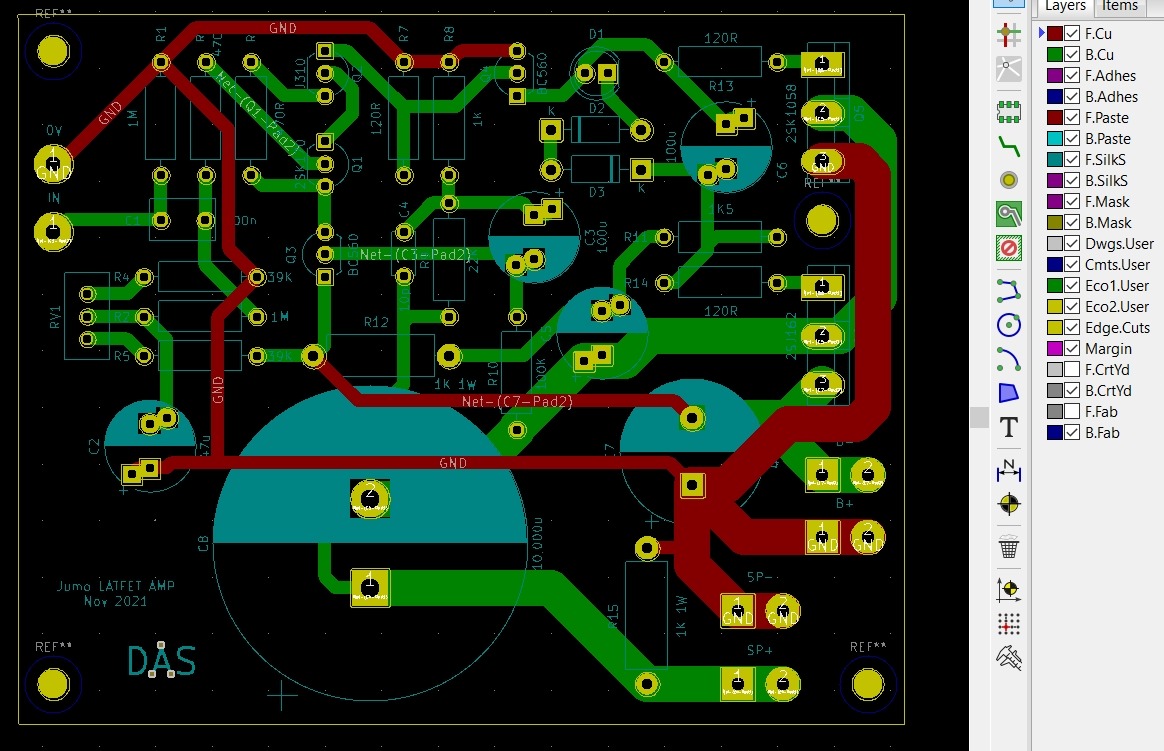

I have this amp running on the bench. I used my own pcb design, which I believe is pretty decent.
I have encountered borderline instability.
Differences from the original:
I used J309 instead of J310 (and 2SK170BL)
R1 and R2 are 499K instead of 1M
P1 = 20K (not 10K)
R13 changed to 249R (although this made no apparaent difference)
Removal of the 10pF cap helps, but to ensure stabliity at all signal levels a miller cap of 10pF or greater on Q4 is needed. I have yet to try the suggested cap from Q4 collector to the R8/R9 node.

Sadly I was not able to suppress the oscillation by fitting 20pF from VAS collector to the feedback point (R8/9 node).
The oscillation is about 2V pk-pk in the MHz region and "rides" on top of any output waveform. Both channels are the same.
I have resorted to 20pF miller cap on the VAS to ensure stablity.

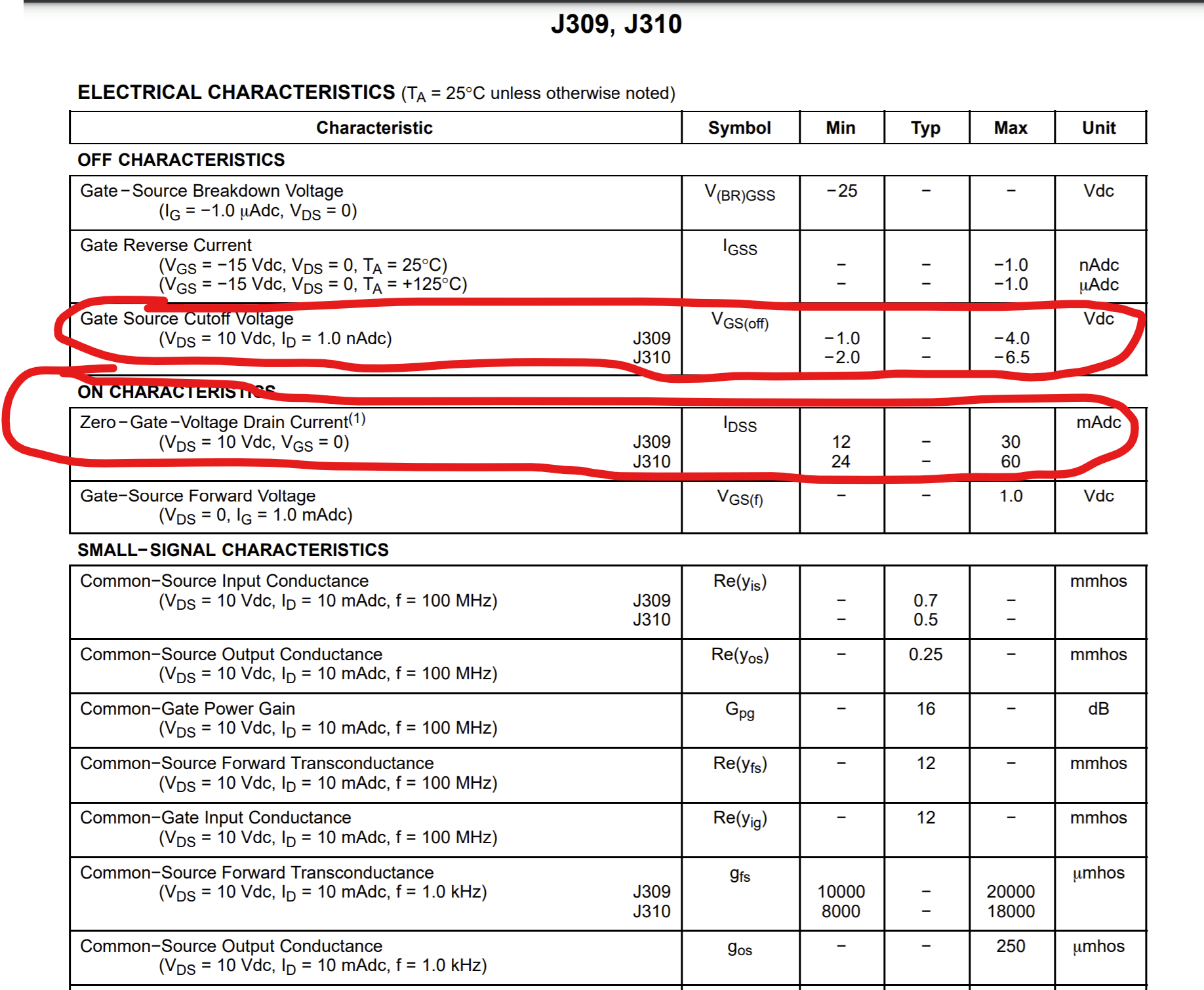

May I ask why the J310 was chosen (not another 2SK170)?
Anyway, I will build the cap multiplier PS next and then proceed to audition the amp.
sorry to hear you're having troubles. is the oscillation in single digit (1's of) megahertz or double digit (10's of) megahertz? wondering if the BF862 is screaming or if the output mosfets are or something else entirely ... care to show construction pictures so we can see things like lead dress, grounding, etc.?
also, did you change the gate resistor values at all?
Thanks Mlloyd. I think you might have identifed the reason for the J310 - it provides a couple more volts of VDS for the 2SK170.
That could be a reason for the instability.
OTOH I don't understand how C4 actualy stabilises an amp. It looks to me like it rolls off the gain of the amp at HF which increases the feedback factor and therefore reduces the phase margin... or have I got it wrong?
Moving the end of C4 to the VAS collector effectively misses the o/p stage out of the feedback loop at HF. I can see how that helps phase margin.

Here is my layout:
