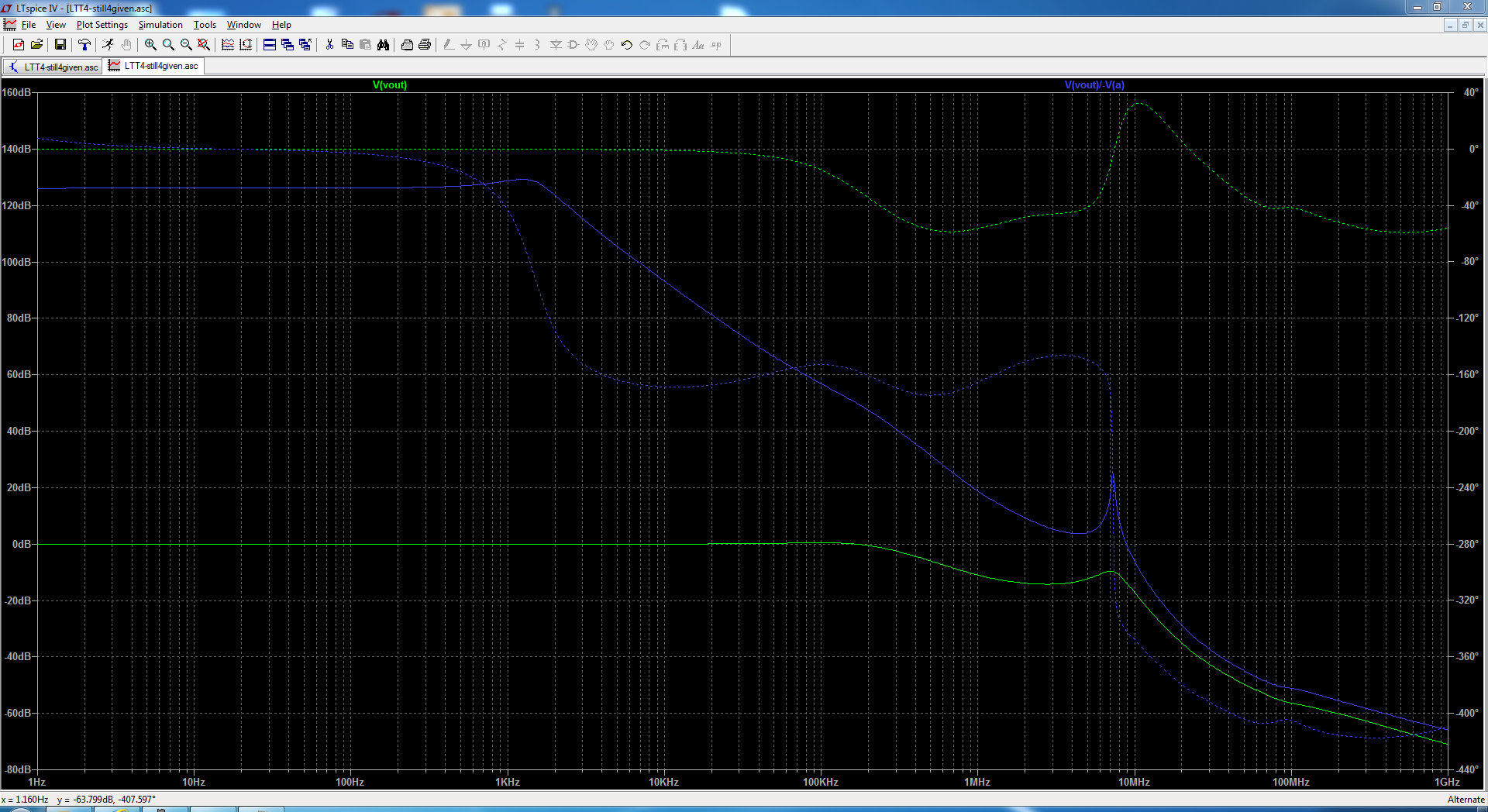

I wouldn't be the least bit surprised if what we really have is a big oscillator, the AC plot looks suspect to me with serious peaking. I'm going to see what altering the compensation values does for this.

I'm concerned about stability now that I have been really looking at it. Absolutely none of the usual stability measures for an EF3 have been implemented. The interesting combination and choices in compensation don't adequately bring OLG down enough before we achieve the conditions for oscillation. I looks like it was some kind of exercise in making OLG as high and wide in bandwidth as possible.
I don't go too overboard with placing a ton of trust in the simulations, but I simply don't see how it can be stable. There are simply too many poles adding up. Perhaps in the real world it might work, but I bet it is on the hairy edge of self-destruction and likely very fussy about components and parasitic elements.
Nothing I do to the existing circuit in spice makes me feel comfortable with it. The 7.5MHz-ish peak can be beaten into submission via brute force, but at enormous 'cost' in potential performance.

Sorry Terry, until a set of boards was available I didn't really look at this design all that closely, you know 'blameless' blah blah blah. I poked about a little but clearly not enough. When it came time to actually think about building it (and seeing you having issues) it of course warranted closer inspection and scrutiny.
I'm honestly now not sure if it will be worth the risk in stuffing the boards since the type and quantity of parts for them won't come cheaply, namely the outputs. That said, it might be possible to simplify the circuit a bit and run it as an EF2 output at a lower voltage. Some strategically placed jumpers to 'remove' un-needed parts, etc...

OS, you have mentioned two lead comps. Look again, we have TMC, shunt and lead. The 22pF from the VAS goes to ground, am I mistaken in calling that 'shunt' or do I misunderstand lead comp in this context?
You are right , the 22 pF goes right to earth (HF shunt).
This is a attempt to "force" EF3 stability .Lower Z at HF is what this does.
Instead of making the EF 3 stable beforehand.
If these were the only PCB's on earth , I would eliminate the CCS LTP
cascode, and just fire this amp up with a single CDOM (68-100pf)on the main
VAS .
The lack of basestoppers on the OP devices is a "big one" , as is
not having the driver/pre decoupled.
PS - I would "fix" the triple ... even if you made the IPS stable/workable ... the triple might still oscillate.
So ..... we have both IPS and OPS "shortcomings". 🙁
