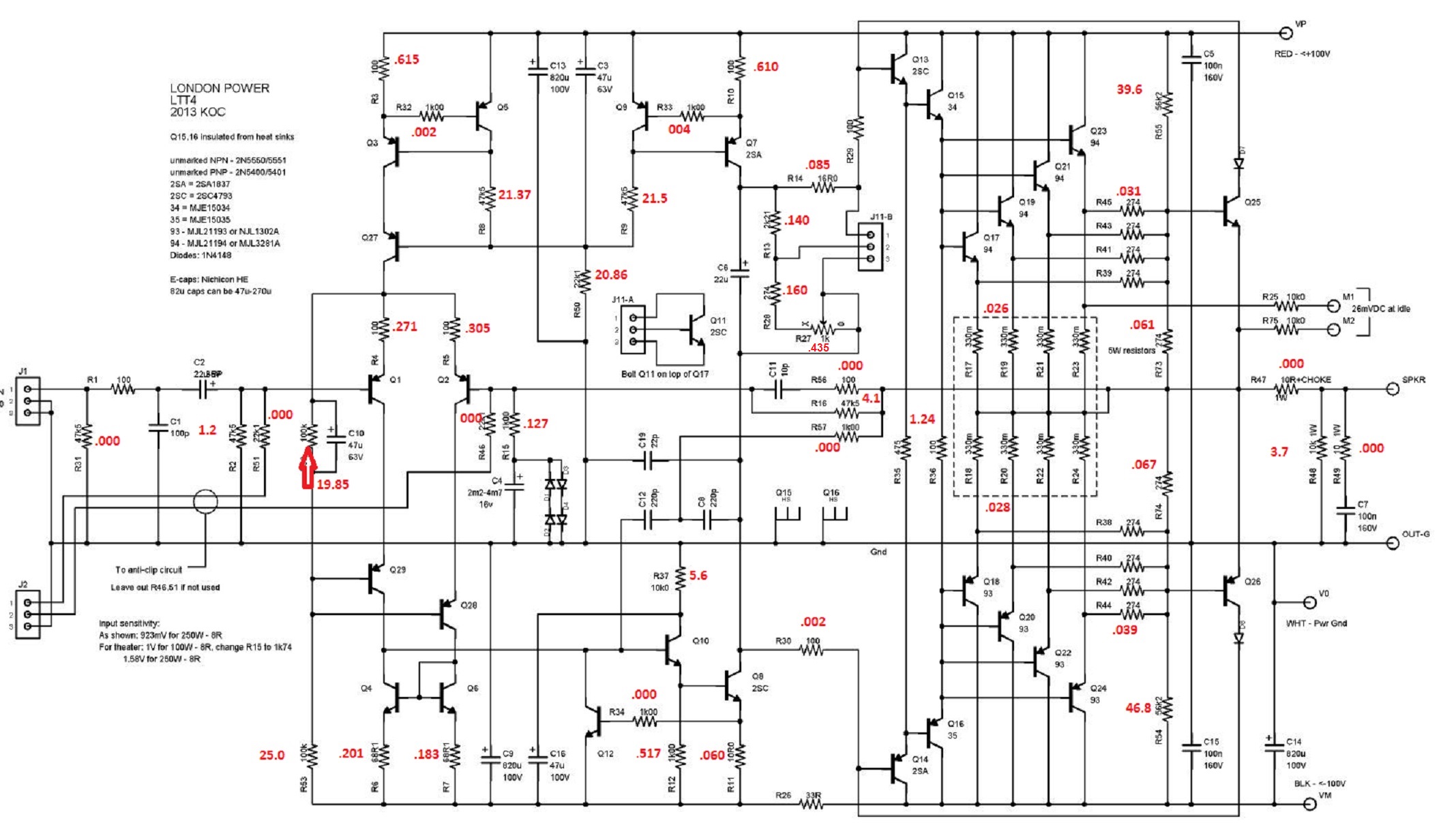

Ahh, j11a matches j11b.
The Vbe multiplier is missing.
The current through the resistor string does not account for the 6mA going from CCS to VAS. Some of it is going through the missing multiplier.
Check the voltages across the multiplier and especially check their polarities. Vce, Vbe, Vcb

What do you mean the multiplier is missing? isn't that Q11? It is right in the middle of the schematic. I did see that I didn't list the voltage drop across the trim pot. It is .435V. I added it to the attached schematic.

EDIT; I am attaching a schematic with voltages for the VBE as well. I noticed I hadn't shown them on the first one.

There's something wrong around the Vbe resistor string, The transistor voltages don't match the resistor voltages. Is there continuity in the connections?
That is probably my fault. I just added the voltages from the vbe this morning. It is likely that the rest of them were taken a couple of days ago and it is possible that the variac was set slightly different. I will sit back down and let the amp warm up for a while and then take all the measurements again. Like I said, the voltages change as the amp warms up.

9.75Vdc across the protecting diodes. Have these blown due to excessive offset?
Note that the VAS & Q8 & Q14 & Q16 Vbe has dropped to just <=0.4Vbe. They are just about turned off.
Q3 has 0.8Vbe. It is turned on HARD. Q23 is turned on even harder.
The Vbe voltages tell you that something is not working.
The resistor currents should give a clue to where the errors may be.

Took measurements for VBE of all transistors and added them to the schematic in green text. Q8 & Q10 looked suspicious so I replace them. No change. Replaced the protection diodes, no change.
Please see attached.
Someone please help me understand where the 9.34V comes from at the protection diodes when one side is R15 with 1.5V and the other is ground?

did you check the board and confirm that it agrees with your schematics?
the 3.57 volts offset tells us that the negative side of the ckt is not working as it should..
Hi Tony,
Yes, I used a highlighter on a schematic and traced every circuit. The only deviation I found was the troubles with the traces at the VBE multiplier and trimpot that have been noted earlier. I believe I have corrected that and now all traces agree with the schematic.
I agree, the negative side is not working properly but I can't see why. Q10 & 12 have almost no VBE at all. I replaced both with no improvement. Q14 &16 have very low VBE so I replaced those with no improvement. I don't want to just keep replacing parts willy nilly. I will soon run out of parts and the boards take a beating. Any help is welcome.

Q8,10,12 and associated circuits needs to be checked, could be wrong valued resistor,
sometimes the color coding could be different from actual readings...
The resistors were not installed by color coding. I measured them. I have triple checked them at this point. Could it be that one of the called out values is wrong?
could it be you installed the wrong resistor in the wrong hole?
you do not need Q12 as yet, you can pull it out of the board in the meantime
and see what gives, that trannie limits base current to VAS in case of overloads...
when everything is normal, you can put it back, same with the Q25, Q26
you can take them out in the meantime and focus on the offset problem...

the new voltages do not agree with what was presented earlier.
Have you changed something else?
Or has the amplifier settled into a different state?
Check again for oscillation, while you are taking your measurements. i.e. does the amp oscillate while your DMM probes are touching the test points?
