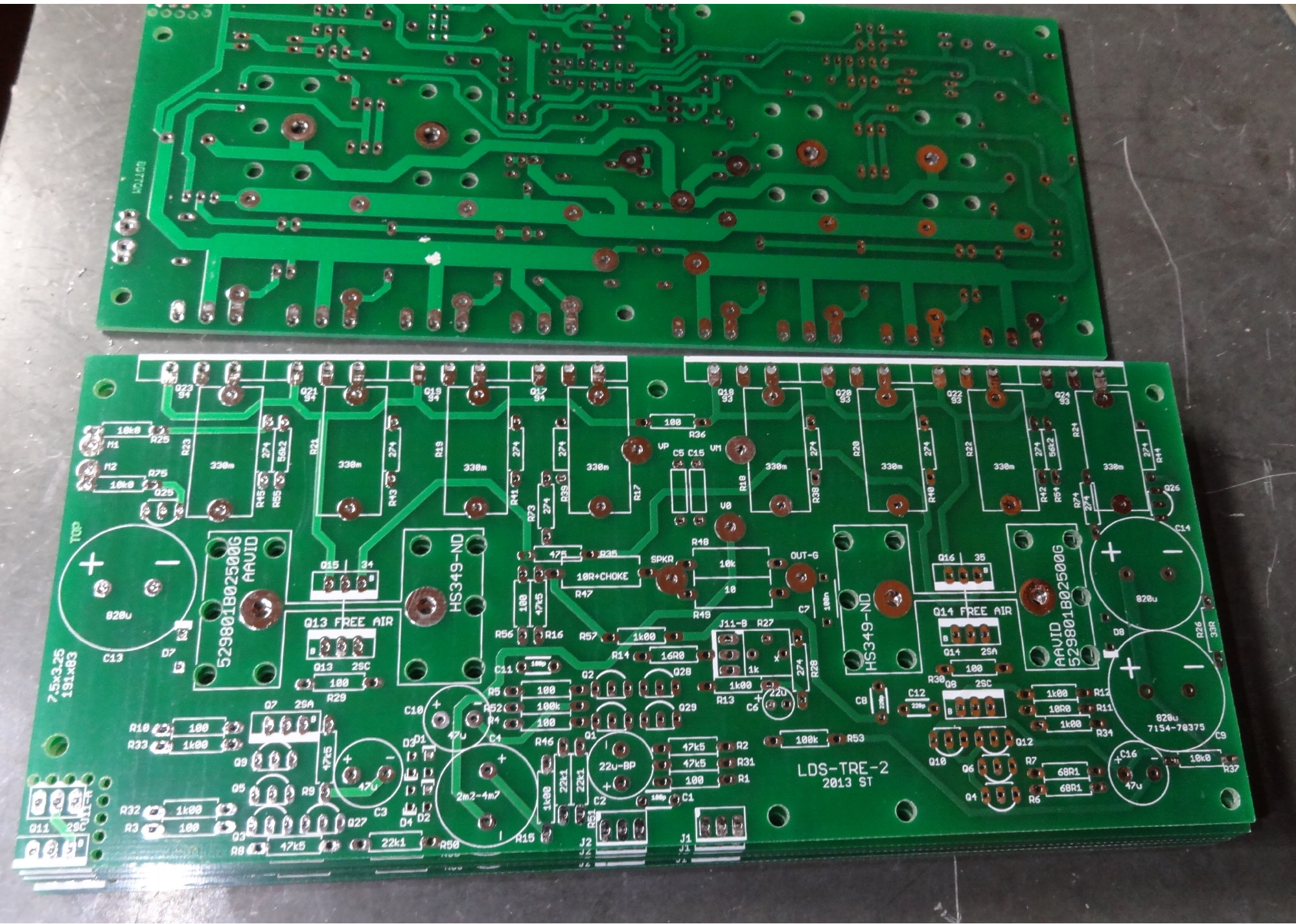

I will have some boards available once I get it tested and proven. It took me over a month to get these.
I'll have to check what they cost me. I'm not looking to make a profit. they wouldn't make just two. I had to buy in groups of 5, which of course doesn't work out for stereo so I bought 5 pair. I figured someone else would be interested in trying the amp too. Let me get it built first so I can make sure it works as is. I should have the rest of the parts first of next week so I should have it playing by the end of the week. Might as well get the bugs worked out first.
Blessings, Terry
Blessings, Terry
