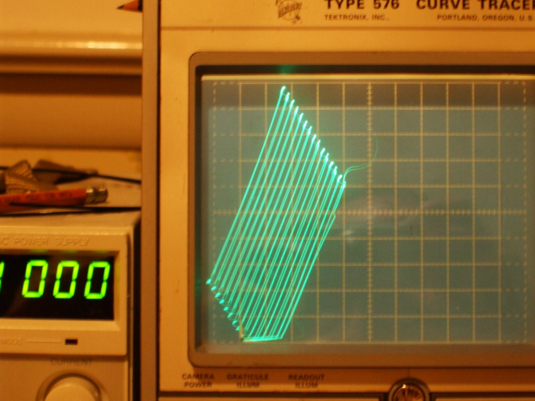

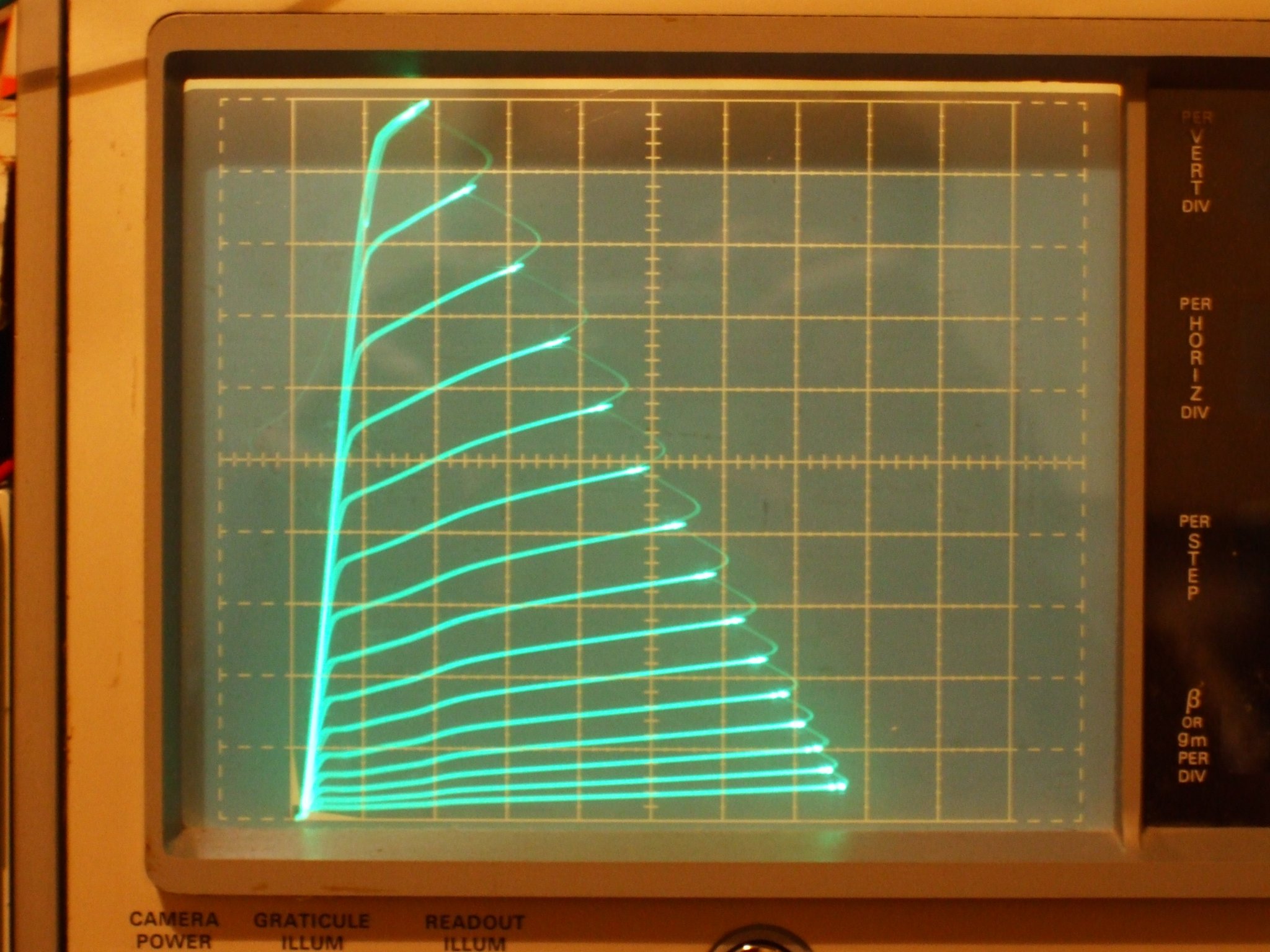

The other "genius" type designs are "tube emulation" 1) Where each output device (which could be a Mosfet too) is constrained (by unusual N Fdbk) to perform as a bigger version of a smaller tube model.
And 2) UnSet where the output device(s) is constrained to operate as a linear triode.
And then .....
a) normal 6HJ5 pentode
b) 6HJ5 with UnSet
c) UnSet and Crazy Drive - ultimate pentode? or CrazyOnSet?
d) just Crazy Drive
