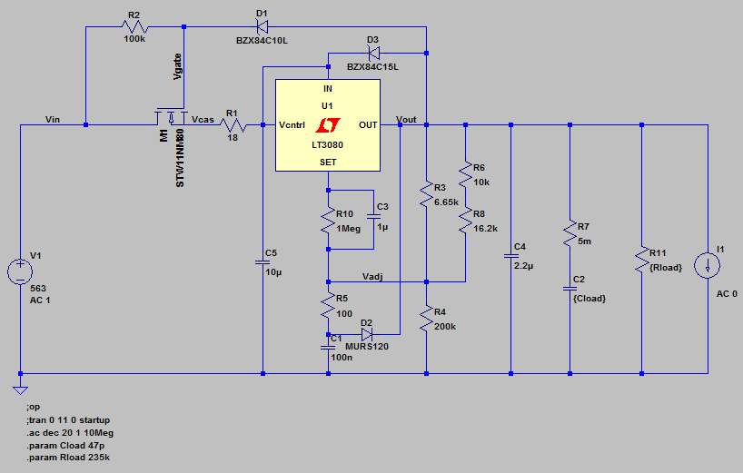

Attached sims rather well. I'm not able to see any difference in the start-up behavior between this and the original circuit. The output impedance is improved (lowered) by an order of magnitude (10x). These are the changes compared to the original BOM:
R4 (pot) = 20k
R5 = 6.65k 1%
R6 = 16.2k 1%
R7 = 1M 1%
C3 = 1uF, X7R ceramic
I still need to test this in practice, but I see no reason why it wouldn't work.
I increased the adjustment range on the pot to roughly +/-7.5 % from the previous +/-5 %. Just to get a bit more margin in case you end up with resistors that are on the outskirts of the statistical distribution of resistance.

My sim says that the regulator has 130 dB of line rejection from DC to 20 kHz and a +20 dB/dec up from there. At 1 MHz it flattens out at 90 dB and rolls off from there. This with 2 mA load current. So in practice, the line rejection is probably limited by things such as parasitic capacitances, board layout, etc.
I deliberately sized the feedback network to absorb both the current required to make the regulator work and the trickle current through D2. If the current in the feedback network doesn't exceed the current through D2, the regulator doesn't regulate properly. The output voltage rises and the line rejection goes to zero.

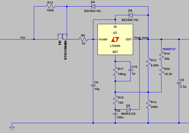

Thanks for posting your results.
I got something very close when I adopted the schematic in your post: 128dB from DC, dipping to 138dB at 100Hz, rising above 128dB at about 15KHz. Sound right? Can you post a schematic showing your source and if there is anything else connected to the right of C8?
Now, I know I'm being ridiculous here. But R12/D4 in the schematic is the weak point in the design for PSRR. Delete R12 and replace D4 with a 10V battery. Simulate, stand back, and catch your breath.
For something more practical, make R12 10Meg and replace D4 with two micropower 5V LT1634-5 in series. 172dB from DC up to 150Hz, rising to 128dB @ 15KHz.
Is it worth it? Well, you get a lot more low frequency rejection (theoretically), and the D2 current steals virtually nothing from the output.
It's fun to be ridiculous! Let me know what you think.
Stare at attached.
You'll have to ensure that the parts would survive during startup, power-down, a momentary short circuit of the output, as well as the high di/dt pulses caused by loose connections in tube sockets, etc. Zeners are pretty rugged. ICs are not...
The other question is if better regulation is actually needed. In my 300B amp, I'm running 525 V DC with 50 Vpp ripple into the regulator and measure 20 uV of noise+ripple on the output. I don't actually know how much of that 20 uV is ripple and how much is noise. I suspect most of it is noise.
Another point is that a zener diode is 50 cents. The LT1634s available at Digikey are $10/each and you'll need two of them. The LT1634s take up more board area as well.

All excellent points. Just raising the possibilities. 170dB - even though it's theoretical, I get the shivers.
Fair enough. Although, you gotta wonder if it's real or if the line rejection of the LT3080 just isn't modeled very well. I know with opamp models, the CMRR is often not handled well as it depends in part on mismatches between the various parts of the opamp. These mismatches are, generally, not included in the model.
Also, the board layout and other parasitics come into play. Few people realize how much 130 dB really is... Never mind 170 dB... 🙂
One could increase the resistor in series with the zener. My sim says the line rejection would improve by 6 dB by increasing R2 (schematic in post 165) from 100 kohm to 270 kohm. Running that experiment would indicate whether the performance of the implemented regulator is limited by the zener leakage path or by something else. Just be careful... You don't want to starve the zener too much.

How about these: Low Current Zeners from ON. Look at the 10 V zener Vz vs Iz (page 5). Nice...! That would allow R2 to be increased by quite a bit, hence, improving the line rejection further.
