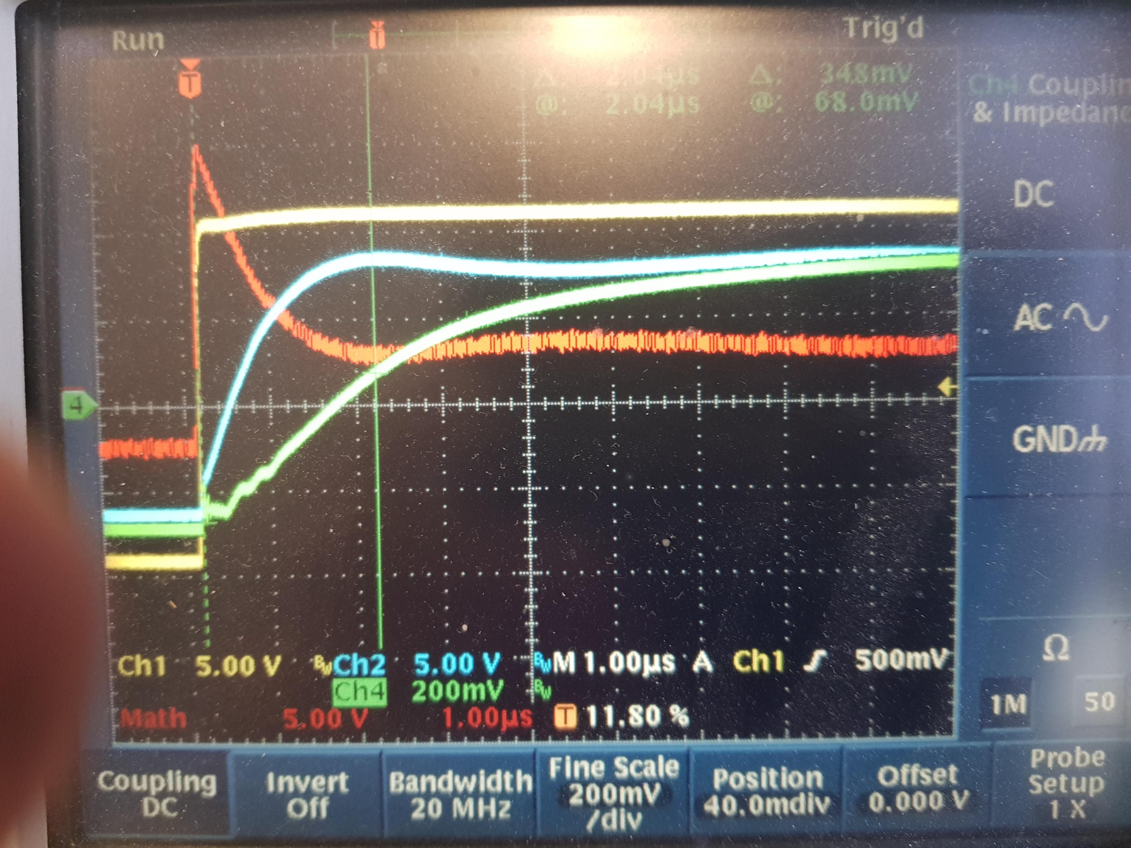

This is the 1650T square wave response. The secondary is loaded with 8R the primary is connected to a signal generator with 2k2 in series as a rough approximation to the plate load.
yellow - source
blue - voltage primary
green - voltage secondary
red - current in 2k2
I'll stop now as it messing up the thread.

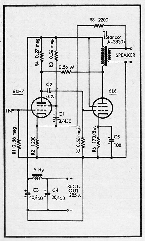

"shunt Schade" is new to me can you send me a schematic please?
The 0.56 Meg resistor from the 6L6 plate to the 6HS7 plate, in the diagram below, is the "shunt Schade" N Fdbk.
(There is global N Fdbk in there too, to the 6SH7 cathode.)
O.H. Schade wrote about a similar series N Fdbk scheme in 1938, using an xfmr. to put some plate signal in series with the input grid.
The shunt case here, using just a resistor plate to plate, has become the more common approach. It requires a current source (pentode) to drive the resulting low input impedance to the next tube. That's the penalty. It linearizes the output tube and lowers it's output impedance, the benefits. Calling it "shunt Schade" is somewhat of a slang shortcut to identify just this specific case of shunt N Fdbk. The N Fdbk combined with the driver gm sets a forward gain, or "Mu", and the resulting plate curves look very much like a high quality triode. Much better typically than the internal triode (using g2 tied to plate ) offers.
Local feedback between grid-cathode

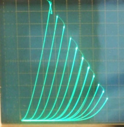

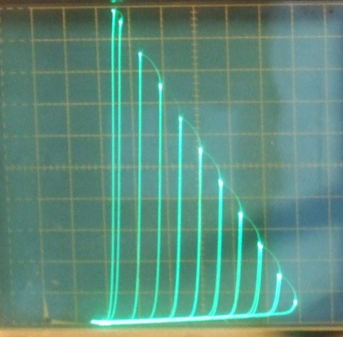

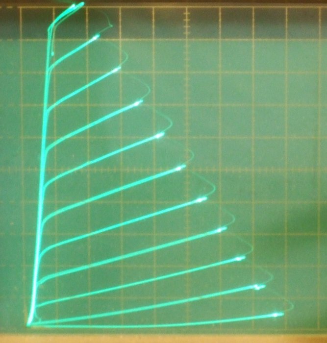

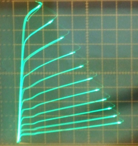

There is also another scheme that linearizes pentodes and leaves them as pentodes. Called 'Crazy/Twin" drive. Second and 3rd pic below show before (grid 1 drive) and after curves (Crazy/Twin) for a 26LX6 Sweep tube. A whole new ball game there. A moderate learning curve there, several threads on it.
The last two pics show a 6HB6 pentode in internal triode mode, and then in shunt Schade mode. The N Fdbk was set -very- strong in this last case, so the curves are not as obviously triode like, but this shows how the "rollover" in the internal triode curves is fixed into equal spacing with very low Rp. Using a higher "Schade" resistor (less N Fdbk) will give nice typical triode like curves (like a typical DHT or 211).

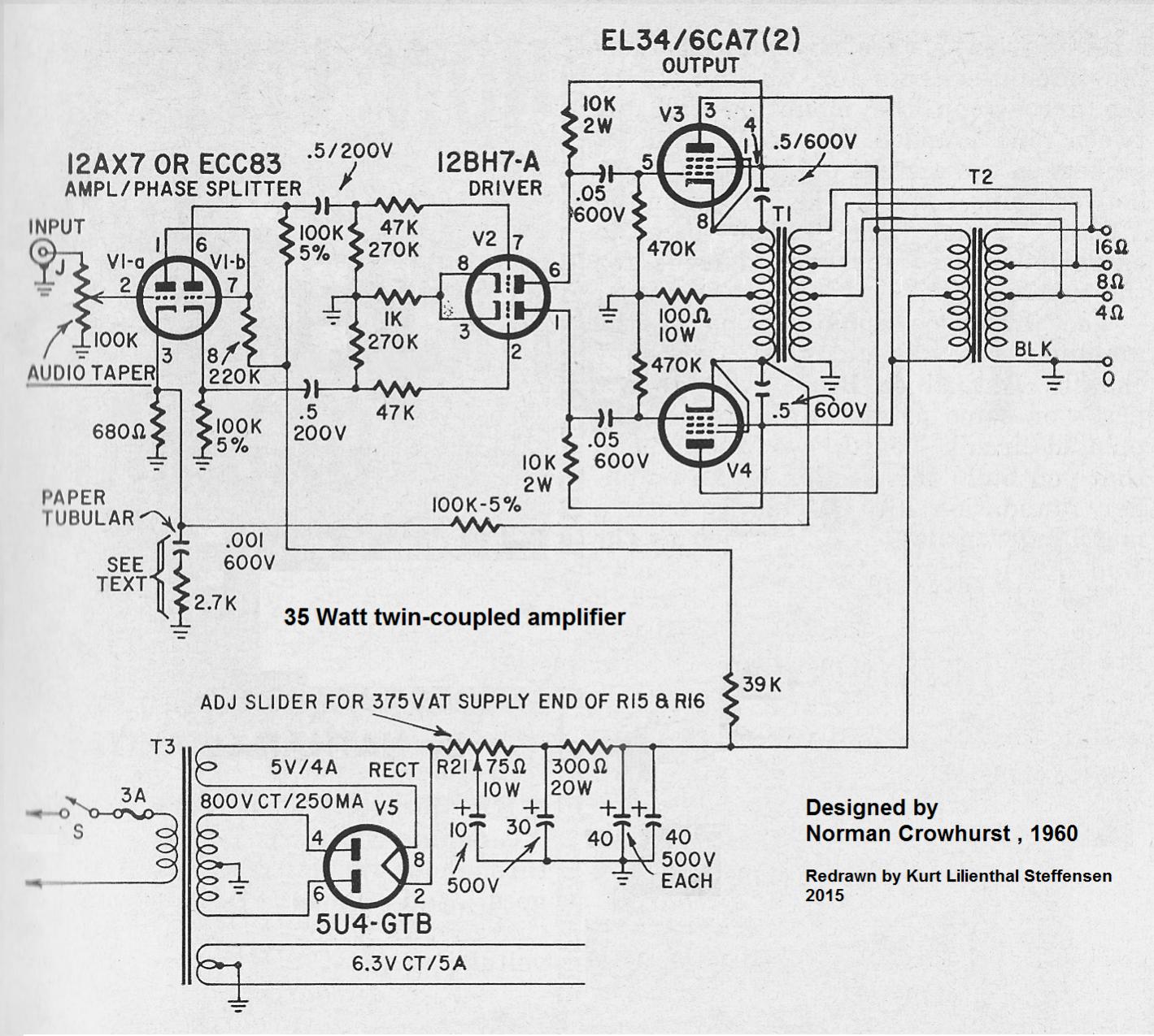

In the RCA datasheet recommend at 1250v Rload=9600
Jeez, at 16K it's time for some drastic measures.
Either use two 211 in parallel, or use two 8K OTs in a N. Crowhurst Twin Coupled design to get 16K. The driver stage design will be from Hell though, a KV drive signal! Could use a beam tetrode, like a TV Sweep, for the driver with bootstrapping for the plate load resistor. That would effectively remove most of the CFB effect at the output stage. 6GF5, 6GE5...
Yeah, that's actually not a bad solution I think. Two cheap OT's and a bootstrapped Sweep tube driver. The OT Watt ratings add up. They each handle only half the AC voltage swings. Make sure to get 16 Ohm secondaries to end up with 8 Ohms when paralleled. One concern to check would be the DC rating of the plate side OT, for safety too.

OH, right, I forgot this has to be for SE.
Surprisingly, the N. Crowhurst Twin Coupled design still works for that too.
Just use two 8k SE OTs, one in the cathode circuit and one in the plate circuit to get a 16K resultant. Bootstrapping for the driver stage load R can still come from the cathode circuit. The Watt ratings of the two OTs add up still. So Hammond 30 Watt SE OTs say, would add up to a 60 Watt SE.
The cheaper Edcor 8K SE only has a 6 Ohm secondary, so won't work here for Twin Coupled.
Gee, Hammond has a 75 Watt 5K SE model too, how about 40x 6197s in parallel for 150 Watts SE output. ($0.33 each) 🙂
Well, 7x 6197s in parallel to do 25 Watt SE. (the GE JAN 6197 are very consistent tubes, almost randomly matched.)
A quite practical solution to very Hi Z primary needs. The OTs will still need a 16 Ohm secondary for paralleling into an 8 Ohm output. (the Hammond SEs have 4,8,16 ohm secondaries) Sufficient DC rating important for the plate side OT still.
