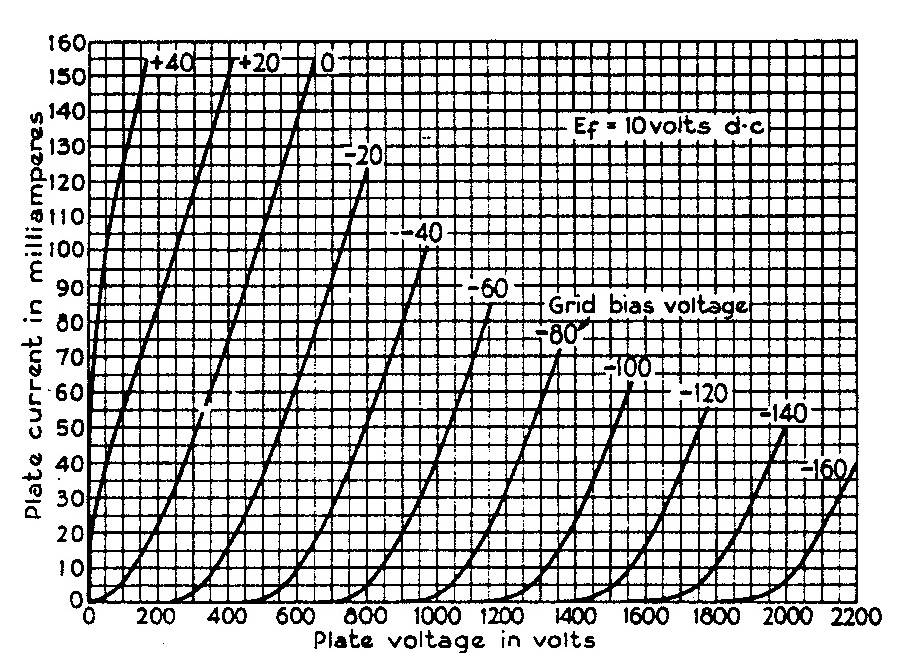

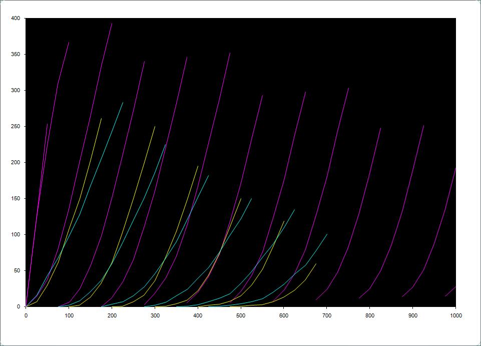

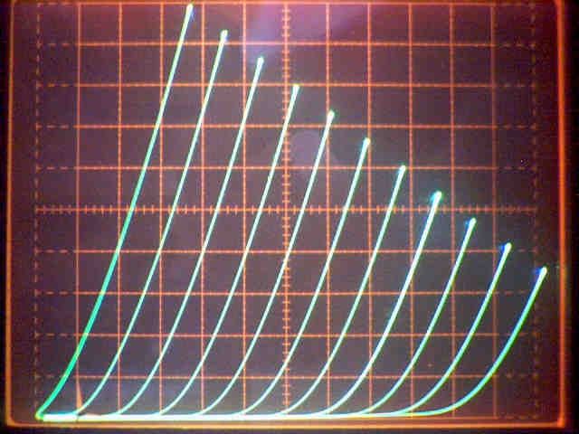

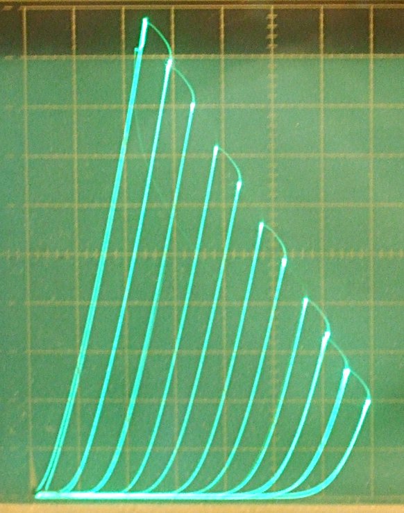

211 has near perfect Triode curves (pic 1 below), 6C33 doesn't compare (pic 2 below).

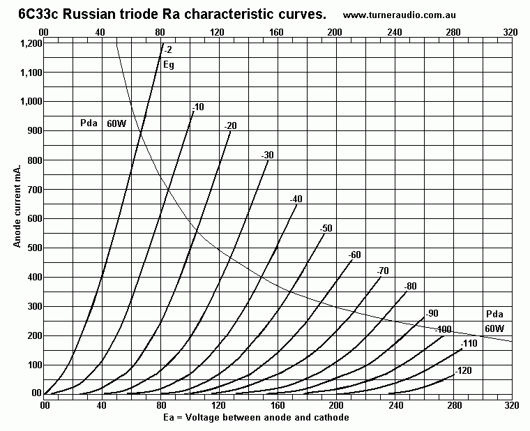

There ARE some ways to get near perfect Triode curves for less $$$ and a more practical OT (lower primary impedance). One way is to use "shunt Schade" on a beam tetrode like the KT88 (pic 3 below and link below) or on one of the TV "Sweep' tubes. This approach gets you a low Rp as well. Not much to complain about here.

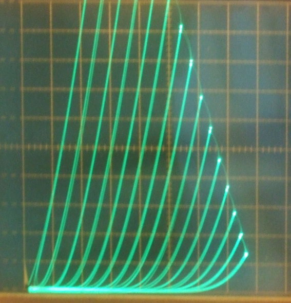

Another is to use a TV "Sweep" that has good Triode curves to begin with. Curve tracer selection recommended here. (pic 4) These unfortunately tend to suffer "runaway" over time. They don't like HV on the grid 2. You could put a cap bypassed CCS under the cathode to protect against runaway damage and use lowish B+, but you may still need to change the tube. (ie, regularly)

Most later development tubes were more optimized for gm than linearity. Their triode mode curves tend to look like the 6C33 curves above. The grid 1 is pushed closer to the cathode to get more gm, but suffers from "island effect" or "inselbildung". (grid wire proximity effects)
There are some exceptions, like some of the green curves above, but not too many. You need a curve tracer to select them besides.
