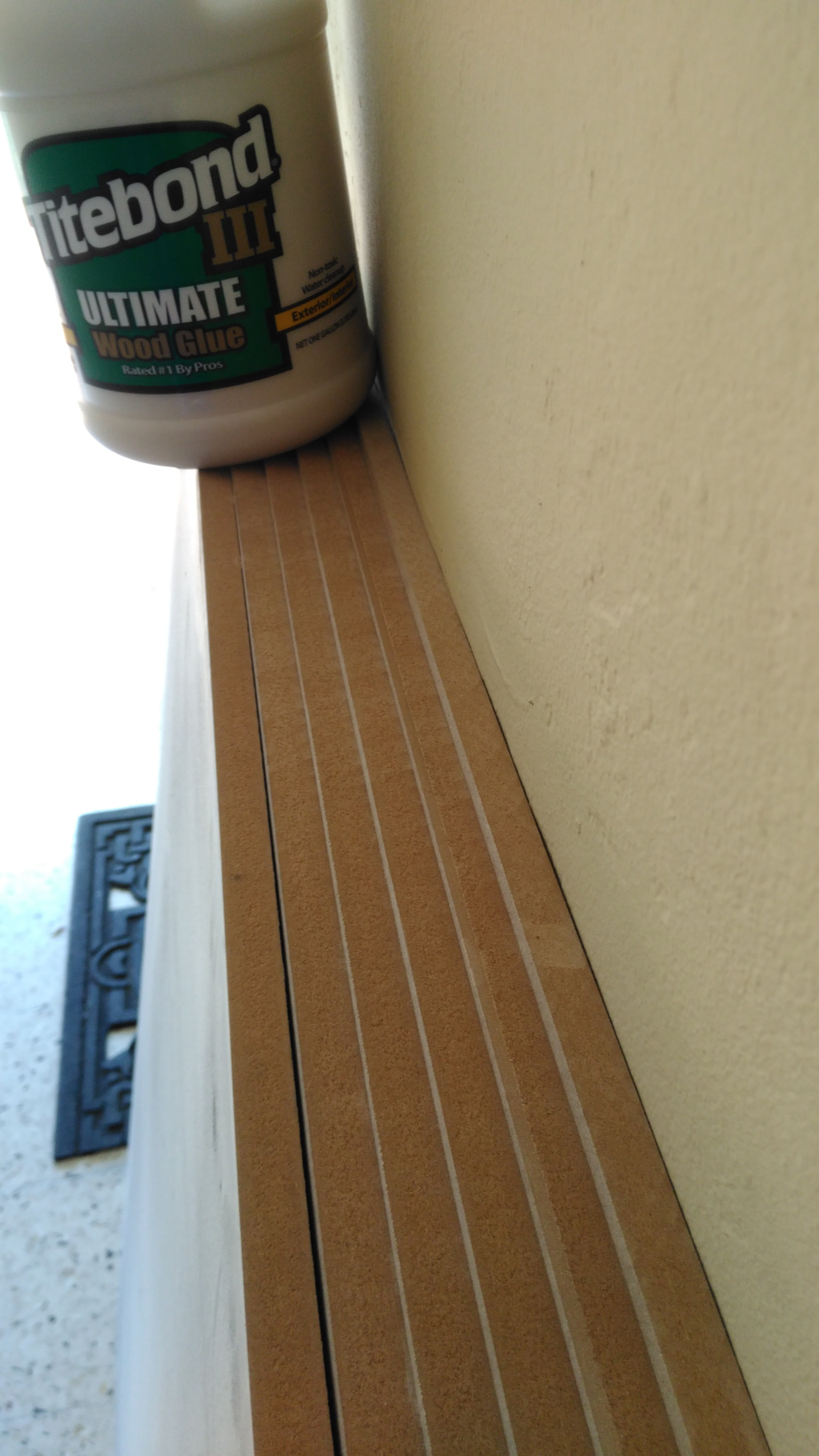

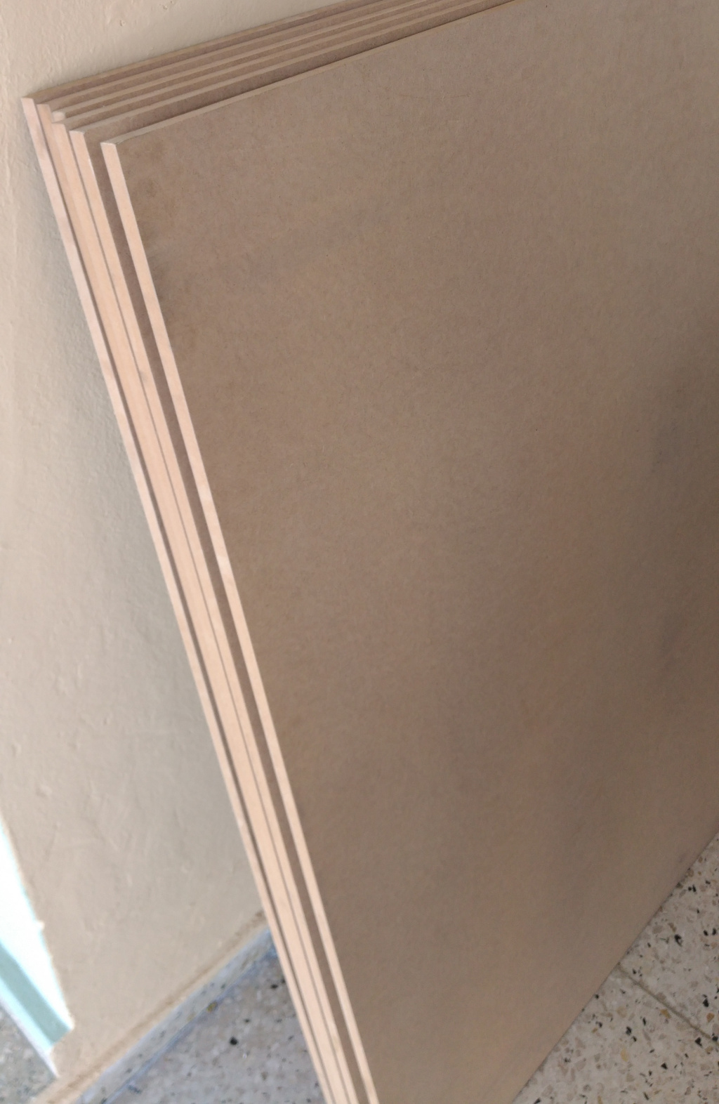

After searching for a moderately priced yet decent looking Plywood with no luck(too many side voids, inner cheap looking etc.), and after ~3 months of waiting, the MDF material finally arrived at the nearest wood shop in 3/8", 5/8" and 3/4" sheets, so I will use it regardless of the dust and weight.😉
At first I was planning on use 1.5" walls and make the boxes 48"H x 24"W x 24"D for an gross 11.5 FT^3.
However I was trying to get an even more compact enclosure(less tall) without sacrificing much volume if possible, and I was able to do so by using double 5/8" sheets to form 1.25" walls(still good with bracing), so the new box measures will be 42"H x 24"W x 26.5"D for an gross 11.8 FT^3, a slightly more that the taller box. 🙂

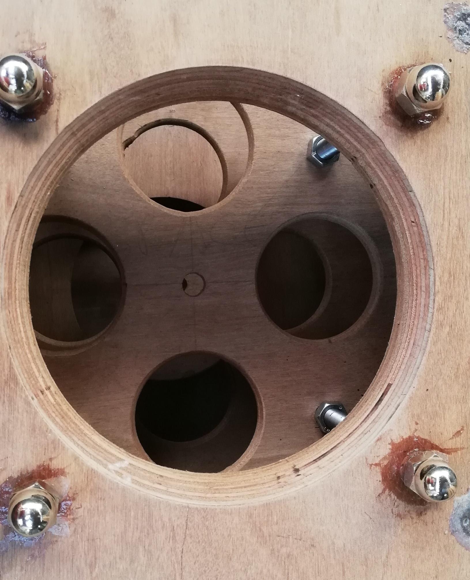

3 years ago I built a dual LLT sub using the B&C 21SW152-8 and I'm still quite happy with it's performance. The boxes are 540L each and have a bottom slot port tuned @ 11.5Hz. I would have chosen a round port if it were possible but the placement in my room didn't allow for that.

Between I've started on this project again as have some time and good weather to work with outside the backyard, to prevent the infamous MDF dust get inside the house.

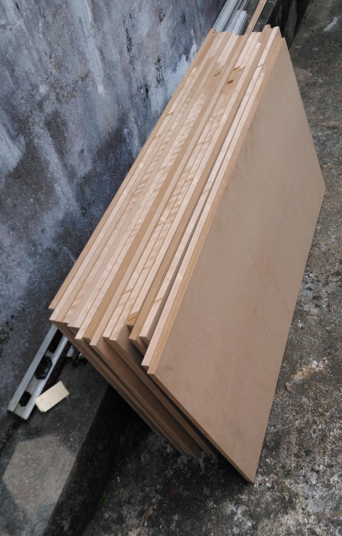

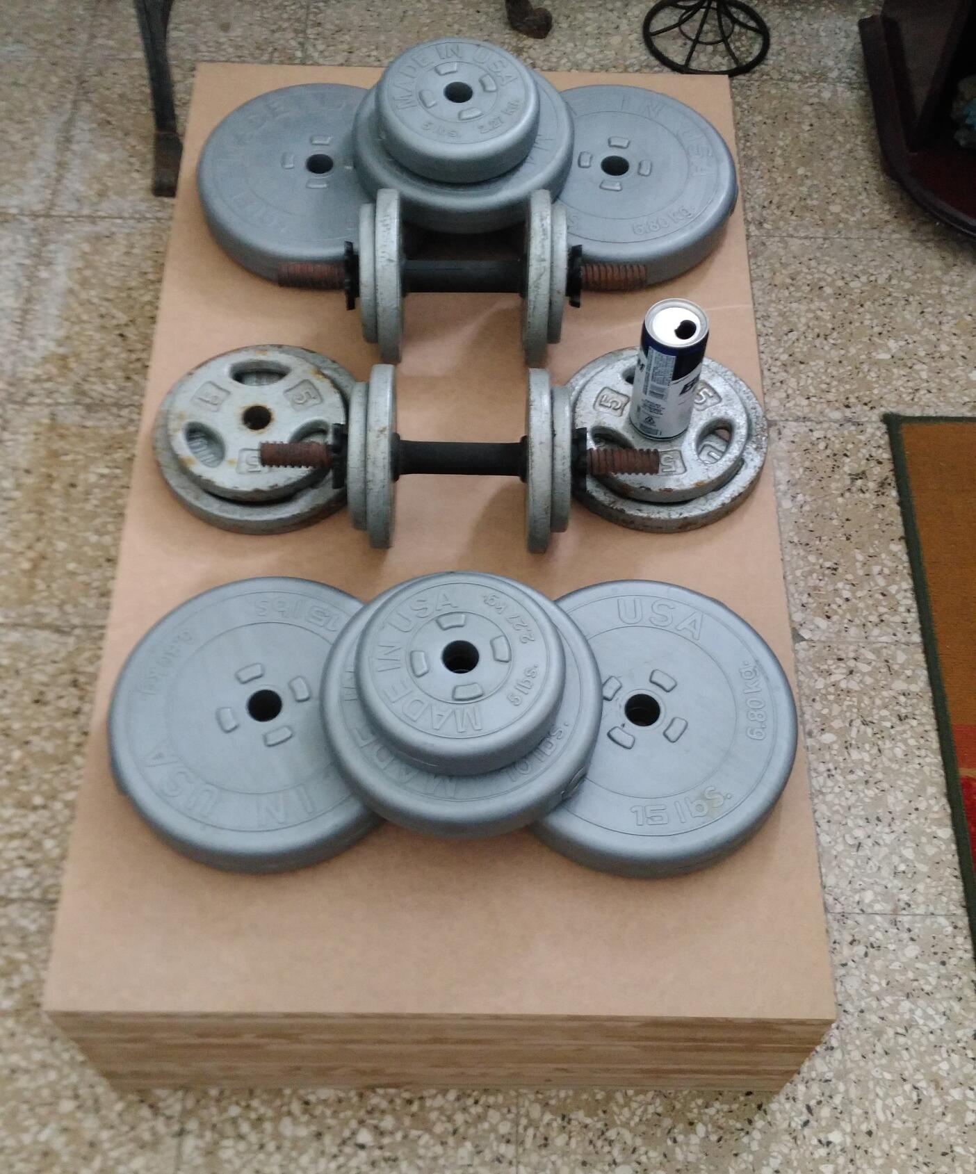

Unfortunately I've had the 6 x 5/8" MDF sheets lying on the wall for quite some time and they developed a small bent as expected😱, so I just did the wall cuts(16 x 42"H x 24"W) and placed them in the floor with about 150Lbs on top to let them flatten again until my spiral router bits arrives.
Hopefully this project will turn out ok as I've never made boxes that big, nor used this kind of speakers for subs before.:wave:
Pictures of the walls cuts(16 x 42"H x 24"W):

With all these weights in the picture, I'm sure you'll do fine with the enclosure. Just be sure to have enough clamps available before you start gluing. My experience is that you can never have enough of them. Also check the glue joints when you tighten the clamps. MDF/wood loves to slide under pressure and before you know it the alignment of the boxes can be off target really fast.

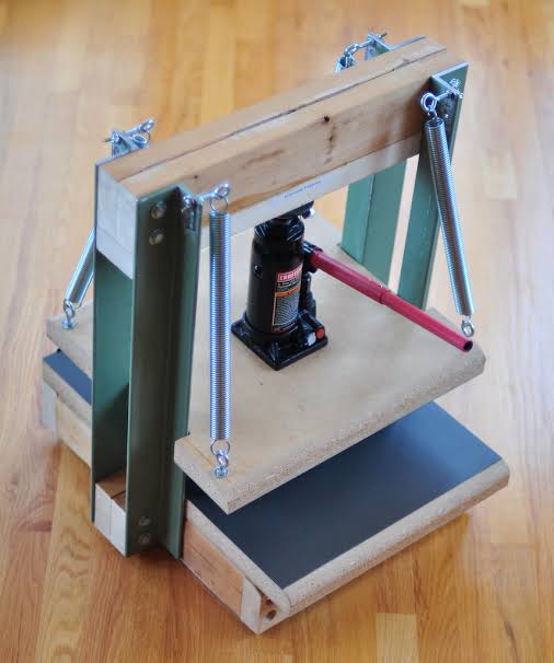

i had laminated my 18mm bb plywood, because i have limited clamps then decided to combine screws and nail gun - lots of them. the trick is to nail on the corner first and clamp it, apply as much as nail you have then hammer it. apply several screws to tighten the laminate
i have seen some of diy laminating clamps using hydraulic jack, looks fun to build if you laminate so many panels

Hi, thanks for the tips on the screws and nails combination, it is definitely another solution to clamping indeed, as long as the finished product being laminated it is no big deal, unlike serious painting finish.
The hydraulic laminate clamping tool looks pretty neat and probably very useful for bookshelves and small speakers projects indeed, though for big panels it will be more challenging.

that clamping station is just the beginning, it can be expanded into bigger one. use H beam steal as the structure then you can use 4 up to 8 hydraulics which can laminate 1 sheet of ply 😀
i almost bulid that station but then ended with more practical solution, if you have this as a business then it's a good investment but if just a hobby like me then nail and screw is enough

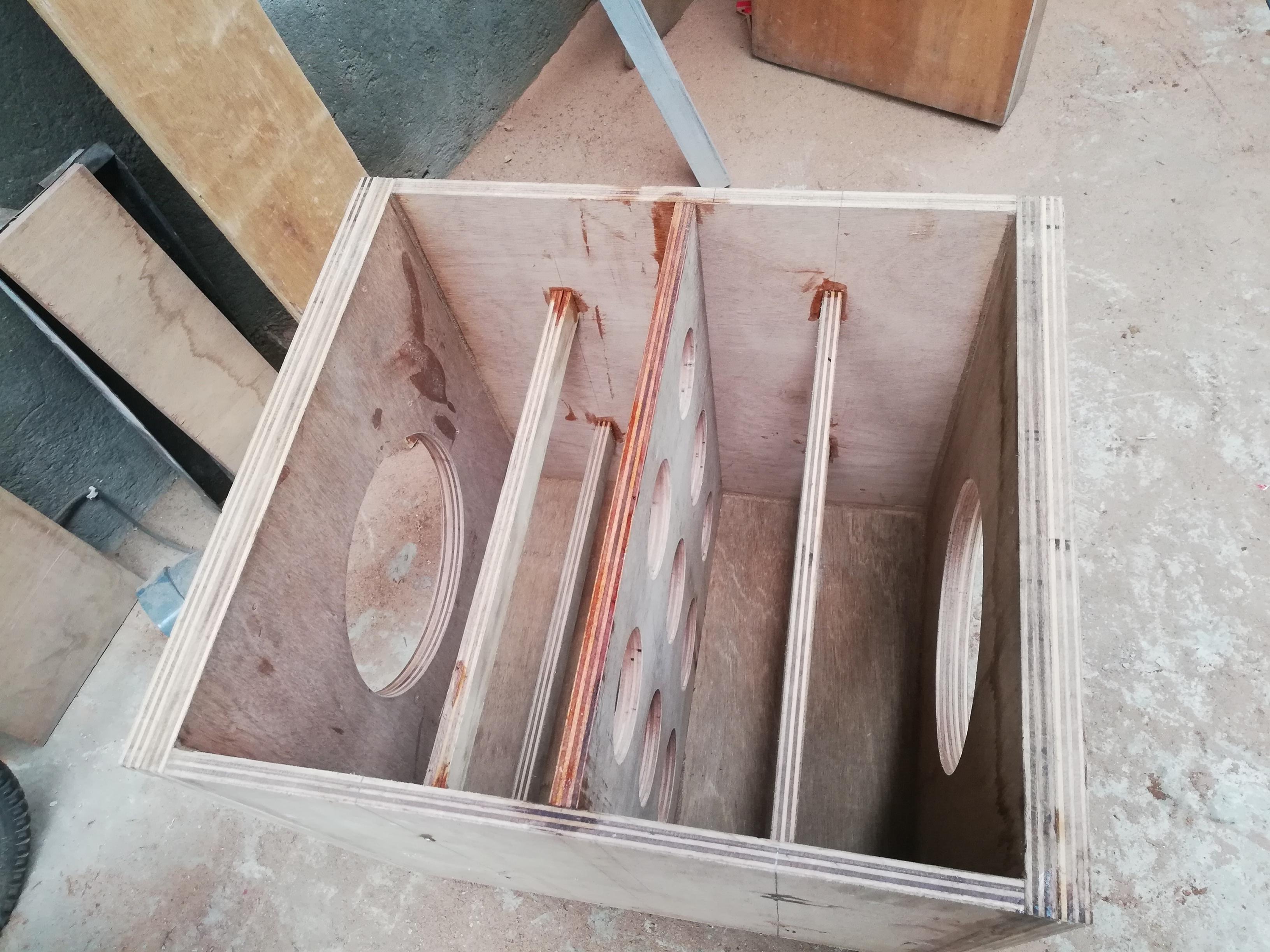

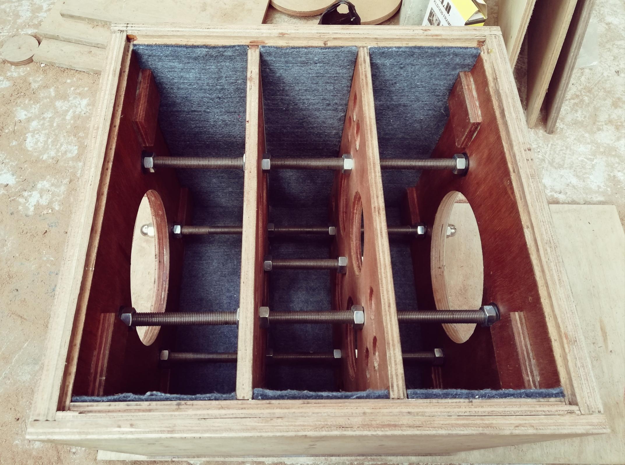

because you are building big driver, another crazy idea that i used on my 1st subwoofer build, braces are locked with 4 of 20mm threaded rods. 1st build was always idealistic but my 2nd sub is more simple

Hi, yeah the clamping station definitely can be scaled up to bigger needs, but as you've said for a hobbyist like me too, I'm fine with old fashioned screw/nail solution.🙂
But oh my!..., and I was thinking I was being overkill, but that multiple 20mm threaded rods as bracing are definitely more than enough stiffness 😱, indeed seems the first serious sub build is an kind overkill experience for most, lets see how this second ones will turn out after finished and measured.:scratch2:
