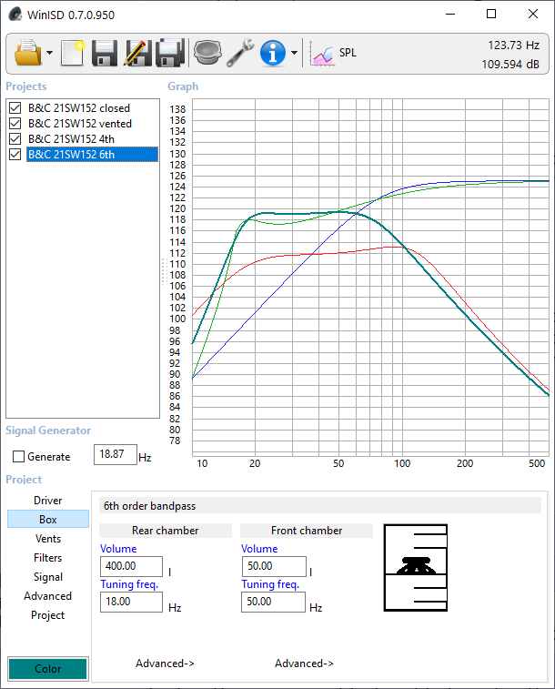

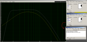

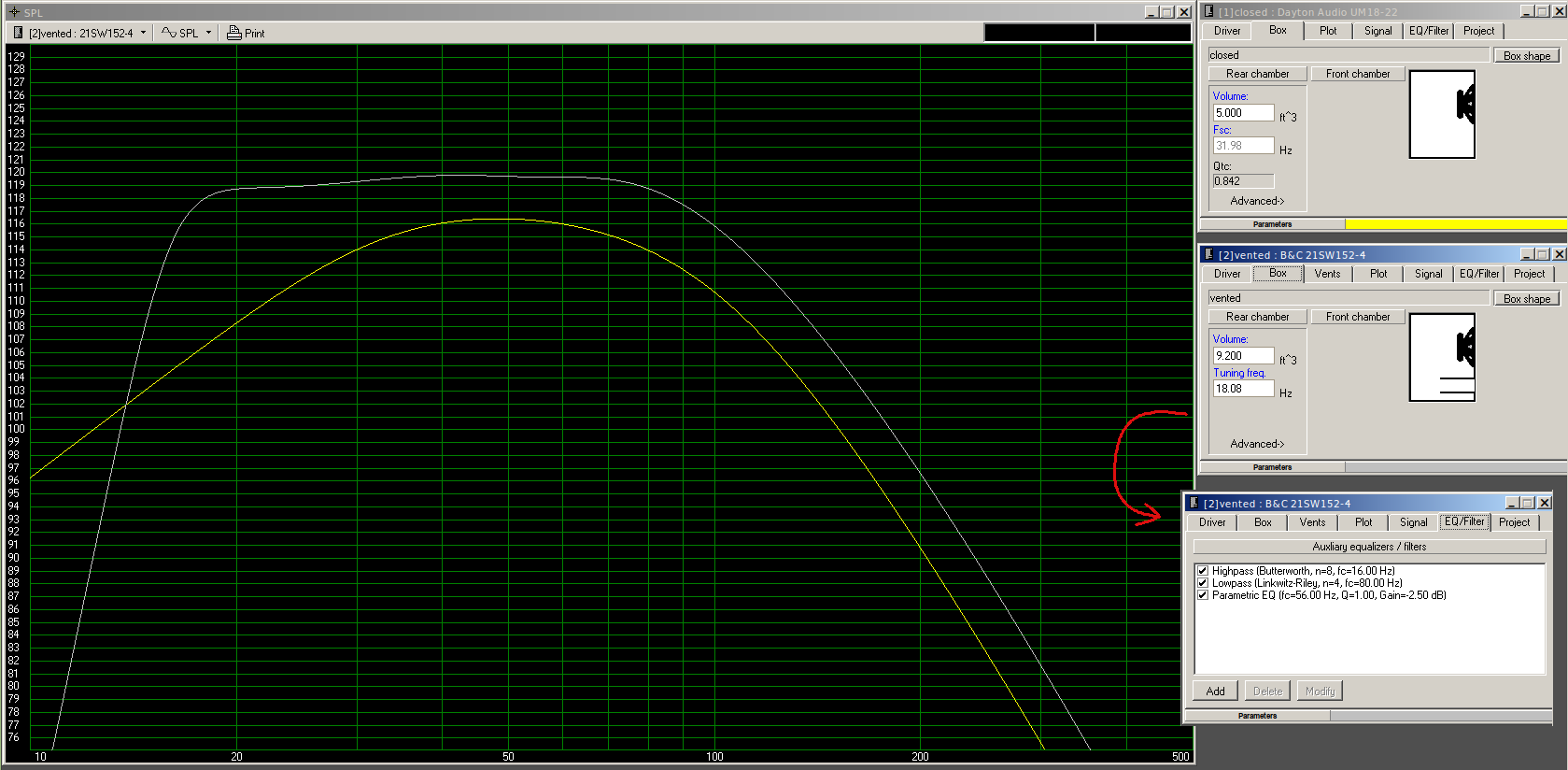

For reference here's the WinISD model with the port cut to 33", in comparison with my current UM18-22 sealed:
Expected usable frequency response after EQed:

You could reduce the port clearance to just 2" from the top without reducing the area of the port inlet, audible noise/compression would be no problem.View attachment 954094 View attachment 954093 View attachment 954095
... a port clearance of just 4.75" from the top, this seems too close for an 8" dia port and may ran into audible noise/compression.
So my solution so far is to sacrifice 2" from the port and make it 34", this will bring a port clearance of 6.75" from the top with just a tad higher port tune, still non ideal but I hope experienced users ports position/clearance may chime in, since I've read that the rule of thumb is to give a port clearance as big as the port diameter.
The reason for the "rule of thumb" is a port clearance less that a port diameter will effectively begin to lengthen the port, lowering Fb while also virtually reducing cabinet volume.
The port within 3" from the back wall and the brace structure ring you depict surrounding the duct do the same.
As Josh Ricci wrote about his 21SW152-4 build: "The target tuning was 28Hz, but the proximity of the vent opening to the back wall of the cabinet lowered the effective tuning to about 25Hz instead. "

...guess it will be fine as the initial wanted tuning was around ~17 but had to raise it a tad due the wanted box size, so that's a relief since this is for 99% music playback.
OTOH that port wall proximity effect effectively lowering cab internal volume is another compromise.

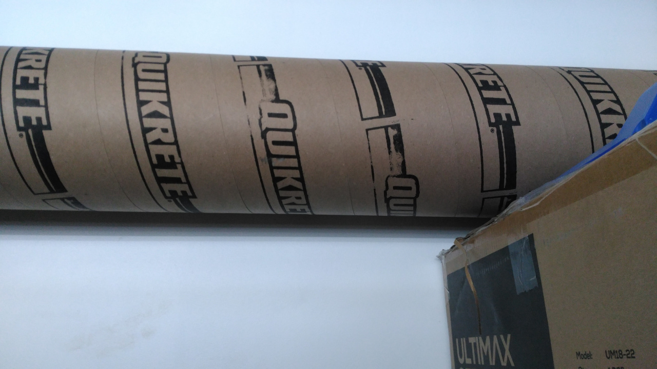

Another quick update!
I just decided to paint the cardboard tubes both inside/outside to increase the ports longevity and to protect it from those bugs who like cardboard, I've used standard oil-alkyd black enamel and applied them a generous coats.
Here is the reinforced tube edges after the wood glue dried up, looks like a half rubber gasket.
Here are the tubes drying up, and I'm in the making of the port/brace section template made of a 1/4" PVC sheet for routing, more to come.
