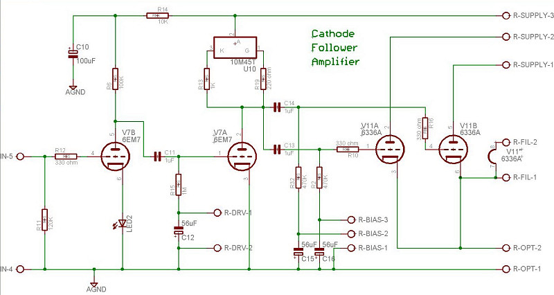

I haven't had the time to draw up the complete schematic so I am posting a screen shot of the Eagle schematic. I adjusted the component values to reflect the components that I actually used when I built the board. These may not be exactly optimum since they were based on the first available part that I could find when I decided to build the board. So far the only ones that I want to change are the 56uF caps on the bias lines. These are too large causing very slow response when adjusting.
How do you connect this board up? First up, the heater of the 6EM7's are not shown. They are connected to a 6.3V winding on the power transformer that should be biased to a small positive voltage. The 6336's each need their own floating heater winding. These tubes draw 5 amps of heater current each! As shown in the schematic each winding is tied to its respective cathode. This is to avoid H-K breakdown issues with tubes like the 5998A that has a 100 volt rating. In my testing, I simply connected each of these 3 filament connections to the filament jacks on the lab power supplies. One side of the 6EM7 winding was simply grounded.
The "R-Supply-3" terminal was connected to my Knight power supply which was maxed at 400 volts. Previous testing with the big power supply showed best results at 450 to 500 volts to insure maximum drive voltage. "R-Supply-1" and "R-Supply-2" were connected to the Fluke power supply through 10 ohm resistors so that I could monitor the current individually by connecting a $4 DVM across the resistors. I ran the 6336's at 275 - 300 volts. Higher voltages made more heat, but no more power. Other tubes will require lower voltages.
"R-DRV-1", "R-BIAS-3", and "R-BIAS-2" were each connected to a 100 K trim pot that is wired across a - 100 volt power supply. This allows individual bias adjustments from 0 to -100 volts. The OPT goes to the OPT terminals, and the input should be obvious.
I plan to design an automatic bias circuit, so I purposely left bias circuitry off of the board. A simple linear power supply is being designed also, but a SMPS is planned. All will wind up on my web site when they are finished.
Initial power up:
Set all bias pots for full -100 volts. Attach a DVM and scope (if available) to pin 2 of the 6EM7. Turn on the power supply for the driver stages (6EM7) ONLY. The voltage at pin 2 should be roughly equal to the supply at this point. Reduce the bias pot for the 6EM7 until the plate voltage comes down to about half of the supply voltage plus 30 volts. If a scope is connected, apply a signal and adjust the bias for the maximum undistorted AC voltage.
Turn on the power supply for the output tubes. SLOWLY reduce the bias voltage on one section of the 6336A until it begins to draw current. Repeat on the other section. SLOWLY raise the current on each section until the desired current is reached. I ran each section at 100 to 150 mA when I was testing one channel but I had to back this off when I ran both channels to keep my power supply from smoking!

Conventional wisdom, and the data sheets for most of the "regulator dual triodes" ties the two grids together (with seperate stoppers) and uses individual cathode resistors of sufficient value to equalize the current through the tube sections. I have tested a bunch (hundreds) of 6AS7's and 6080's and found considerable differences between the two sections of the same tube. Some tubes require resistors in the 240 to 300 ohm range in each cathode to get the currents close. The requred resistance value rises quickly as the plate voltage is increased.
The 6336's were happy with smaller values, but this observation was based on only about 10 tubes. One tube required 100 ohm resistors for equalization. I have not done much testing with other tubes.
If resistors of this size are added in series with each cathode a considerable amount of output power will be dissipated in these resistors. The resistors would also cause the output impedance to increase. They could be bypassed with capacitors, but these capacitors would be required to pass the audio signal at currents that could approach one amp! A single capacitor wouldn't do, and any electrically good solution would be expensive.
I decided on the solution shown above to avoid individual cathode resistors. The amp has only seen about 10 hours of use with the same (very well used) 6336's installed. It has been completely stable with very little bias drift during this time. It should be noted that changes may be needed as time goes on.

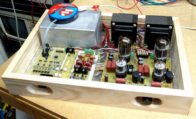

The last two months have been rather hectic due to a demanding schedule at my day job, and a serious project undertaking ( a very unique cathode follower amplifier). It was submitted to this design contest:
http://www.circuitcellar.com/microchip2007/
I am sure that they have never seen anything like it, and I doubt that anything like it exists! The deadline for the contest was yesterday, and I just made it. Now I can get back to some more leisurely experimentation.
I designed a vacuum tube amplifier that uses a DSP chip to dynamically adjust the power supply voltages in real time. This can be used to drastically reduce the dissipation in the output tubes. The amplifier shown here produces about 40 watts per channel from 5998 tubes. 6AS7's will work at a slightly reduced performance. The signal path is ALL TUBE and the tubes ALL OPERATE IN CLASS A1! All tubes operate well within their ratings.
I have discovered a lot of information that I did not konw about tubes, and distortion production. I am sure that most tubeheads will never welcome a DSP powered tube amp even if it makes mad power at 1% thd and still has tube sound, but the principles that I have learned can be applied without ANY SAND!
My dissertation for the contest went over 50 pages, so I am going to take a welcome break from the computer keyboard, and then begin documentating all of this stuff for the web site. I expect that there will be some new amplifier designs based on this technology in the future, including a previously mentioned 200 WPC P-P cathode follower.
