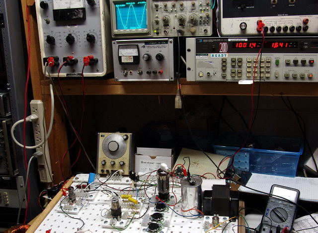

It works. Some twiddling with all of the knobs, and I get a nice sine wave on the scope. I tried tube current from 80 mA to 200 mA, and I tried several combinations of load impedances. The best results happen with a 4 ohm load on the 16 ohm tap on the transformer. That should work out to a 750 ohm load on the tube. The little UBT-3 transformer didn't like this too much, and I figure that I was loosing several watts in the OPT.
Power at the onset of clipping was 9.1 watts. The distortion is related to tube current. At 5 watts output I get 4.8% distortion with 80 mA of tube current. At 150 mA the distortion drops to 1.6% and at 200 mA the distortion is 1.1%. The output impedance is under 1 ohm, which is mostly OPT losses. The voltage drop on the primary was not nearly as severe as the secondary when switching from an 8 ohm load to a 4 ohm load.
I listened to it (in glorious mono) for most of the afternoon with both of my "8 OHM" speakers in parallel on the 16 ohm tap. The sound is awesome, solid bass, crystal clear highs....... I found that 80 mA sounded just as good at 200 mA except for some bass heavy music (Pink Floyd).

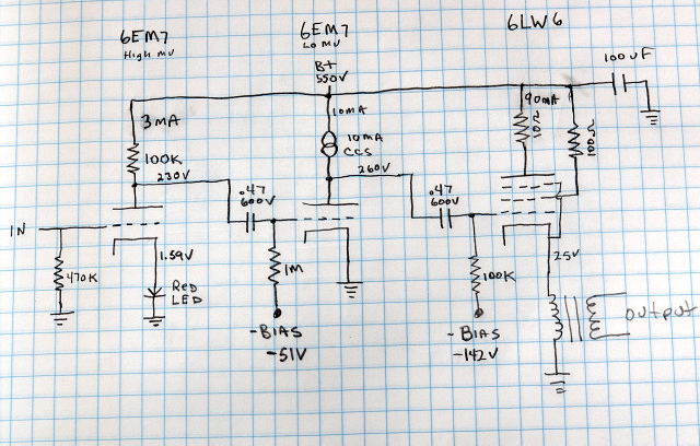

I suppose someone is going to ask for a schematic, so here it is. Before anyone rushes out to build this, let me explain a few things.
The driver is pretty straight forward. The input tube is the high mu section of a 6EM7. Just about any tube with enough gain will work here. Adjust the load resistor and tube current to match your choice.
The second stage requires a tube that can operate linearly at low plate voltages, and not explode as the plate voltage swings up to the supply voltage. The sweep tubes made for vertical (frame) output duty work well here, so this is why I chose the 6EM7. A 6DR7 (9 pin) will work well also. The CCS load is the key to developing a lot of voltage swing. A choke load should work also, but good chokes are not cheap and the CCS chips are.
The output section requires some thought. I used a 6LW6 sweep tube because I know how much abuse they can take without issue. The screen grid rating is 275 volts, I ran it all day at 550 volts. The plate dissipation rating is 40 watts, I had it at 80 watts for about 2 hours, and up to 100 watts for brief testing. At 80 watts there is no hint of plate or screen grid glow. At 100 watts the plate gets a dull red glow after about 2 minutes.
You need to choose a tube (or parallel combination) that can take this for extended time periods, you also need to plan the chassis for some heat dissipation.
Am I going to build one of these? Yes! First, I need to find a bigger OPT. Then, I plan to do some further testing. See those empty sockets, I plan to fill them up! I haven't decided which tubes yet, or just how much power it will make. I probably will settle for a reasonably powered SE cathode follower, but I plan to build an insanely powerful P-P cathode follower if all of my other circuitry works out.
I will do more testing on this circuit, and post updates as I find out anything useful.

I´ve been thinking about building something like this for quite some time now. Possible tube candidates would be PL519 (perhaps more than one per channel) and a choke loaded 12B4A as driver stage.
With a few low Rp output tubes in // we could get away with a very low turns ratio in the OTP, possibly an autoformer if we can live with a fraction of a volt DC across the speakers.
I took this concept to its extremes in my latest project; 4xPL504 per channel working as cathode followers with only a ~0,5H choke as load, ie SE OTL. Sound is VERY good with the right speakers. Connecting the speakers to (imagined) centre taps on the chokes would change the load seen by the tubes and probably increase output power and the damping factor big time, but then it wouldn´t be OTL anymore...:/
By the way, PP cathode followers would work great with autoformers in the output stage since the DC offset would cancel.

Well, since I´m going to build an amp with 6AV5GA (Sylvania)soon perhaps this topology would be the way to go?
I will be using Hammond 125DSE output transformers, let´s say I wire them as 2,5K/8R with the secondary in series with the primary (auroformer) and feed the output tubes with about 250V plate-cathode and draw 70mA through the whole thing.
Together with a driver stage that can can deliver all the required voltage swing this should be up for 3-4 good sounding watts, maybe more.
Accordning to Sylvanias datasheet 6AV5GA can handle +-200V peak heater-cathode, so I think it would be possible to feed both channels from one heater winding which is referenced to ground.

When I set out to build last Saturdays experiment, I reached for my trusty old 6AV5, and thought about what I was going to do. I was planning to (and I did) explore the upper end of the power spectrum, so I put bach the 6AV5, and grabbed a 6LW6. These things laugh at power levels that would melt a 6AV5, I was running one tube at 190 mA and 525 volts. That is about 100 watts of dissipation.
This experiment proved that the concept is viable and that the 6lw6 is almost indestructable.
After looking over the test data, it seems that I was loosing about half of my power in the mismatched OPT. I need to experiment with a choke, and a resistive load bank.

Today I revisited the cathode follower test circuit that I posted earlier in this thread. I could only get 9 watts out of that amp during testing even when I cranked the tube dissipation up to 100 watts. That just isn't right. I suspected my grossly mismatched output transformer, which turned out to be the correct assumption. I was seeing almost 400 volts peak to peak across the primary, but only 9 watts out. With almost 300 ohms of DCR, all my power was just heating up the transformer.
So in order to find out what OPT I need, I eliminate the transformer, and test the amp without it. My normal procedure is to replace the OPT with a choke, and a parafeed cap, without the OPT. I then place power resistors in place of the OPT and experiment with the value to find the optimum load for the amp. If everything is connected to bench power supplies, you can adjust the plate voltage, the tube current, and the load impedance until you get exactly what you want. Then replace the resistor with the same value OPT. No load lines necessary!
I dug out a 55 pound choke that I have been saving for my SE OTL amp. It is 2 Henries at 2 Amps, with a 6 ohm DC resistance. I tried several different loads, and found that a 500 ohm load resulted in 30 watts output with the tube on the edge of redness. That is more like it. I settled on 600 ohms for the best balance of power, distortion, and tube life. I can get over 20 watts with conservative tube current, and 28 watts with the tube at 80 watts of dissipation. Without the limitations of the OPT you can measure the amplifier circuitry itself. Frequency response is 20 Hz (limited by the choke) to 95 KHz. Distortion is 0.9% at 5 watts rising to 5% at 28 watts.
Knowing this, I reached for the first transformer that I thought would get me 600 ohms. It is a Plitron P-P toroid OPT rated at 400 watts. I am using it in parafeed configuration, without a cap. The DCR of the choke is so low that I only have 2 volts across it, so I don't need a cap. I still get 28 watts, so the old OPT was just not working.
I have been listening to it for most of the evening, and it sounds good, too good. The best transients of any amp that I have built. Spooky real! Now I am going to need to buy some good 600 ohm SE OPT's because I just have to build one. The toroids are destined for a big P-P amp, and the chokes are just too big.
