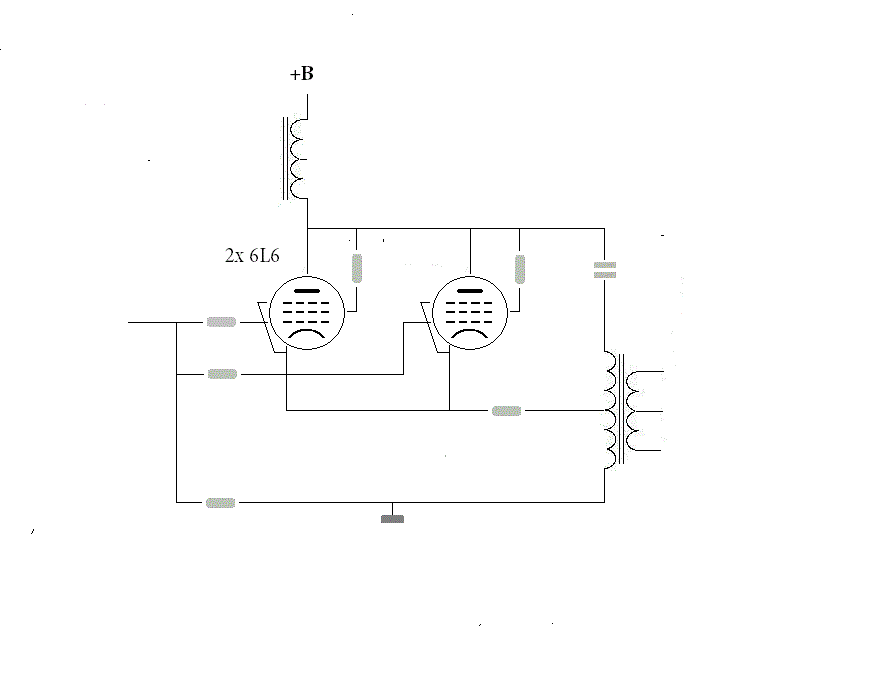

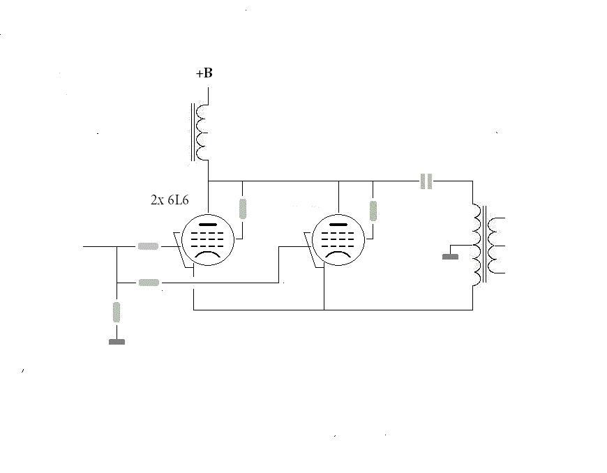

Here's another idea using two halves of a 6SN7 (choke loading the second) and a 6L6GC for a little more power:
Using a VR (could also be a 0C3 or a resistor) to drop some volts above to keep the 6SN7 plates in the second stage well below the 300V max. They will swing above that with signal but that's typical of transformer coupled output stages, so I'm hoping it isn't a problem here.
I wasn't really optimistic about the ability of the 12AX7 to swing a full 200V ptp with 300V B+ in the previous schematic.

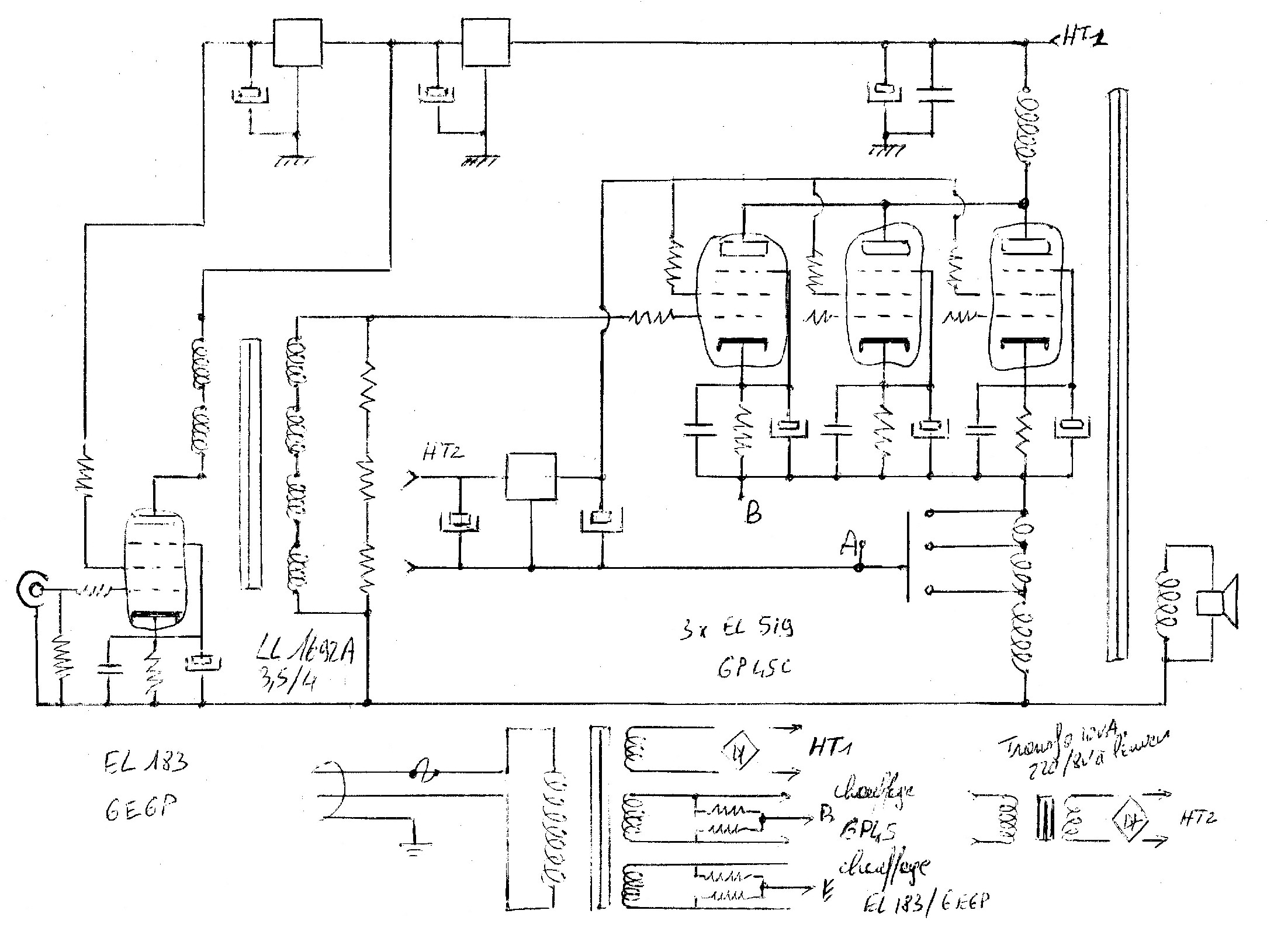

I now orient myself towards an intermediate transformer (LL1692A en 3.5/4) charging a penthode input
With a 6E6P and also for a distributed load 50 - 50 for the output transformer (decrease of the swing) .
This circuit in 2 stages remains simple (thanks to Yves Monmagnon)
I am currently testing the penthode and pseudo triode mounting for the power tube with a 6P36C (el500) and I get + - 5w
It remains for me to obtimize the impedance of charge of the 6P36C before going to 2 x 6P45S (EL519) in // and to obtain 20w easily
Stay tuned
Yann

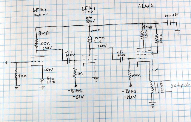

In 2008 Tubelab created a very impressive cathode follower power amp. It is extraordinary that it produces 25W from 550V at 100mA, achieving 50% plate efficiency!! It is on his website as 'Minitron' and is a masterpiece of modern design here:
Cathode Follower | Tubelab
He used a dissimilar triode, 6EM7 as first and second stage, and a large TV sweep tube (6LW6) using a 600:8 OPT.
Personally, this is the best cathode follower power amp I've ever seen, and it uses some modern IXYS CCS chips which operate at very high voltage with efficiency and reliability.
George has done some wonderful amps over the years, and is incredibly passionate about his work. I hope he continues with this work in his retirement!

Still at it, albeit with a rather slow start. I had to move everything about 1200 miles, and we got 3 weeks notice to move, so about half of my stuff was sold, given away, or tossed. What did go with us was hastily tossed randomly into unmarked boxes. There are still things I can't find after two moves and two years, and I'm not sure if they ever got moved. I did however find that cathode follower amp PCB pretty much intact, so it will see some power sooner or later. I did learn however that the 6LW6 doesn't like being triode wired on anything over 350 volts of B+. It will work for a while then run away and melt.
