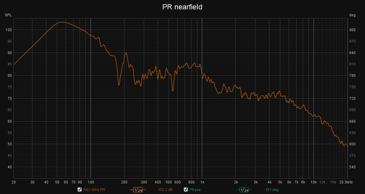

Wow! It looks amazing! Is that a giant passive radiator on the back? I'm wondering how low can it go. Would you mind doing a nearfield measurement? And how does the bass sound compared to common bass-reflex speakers?

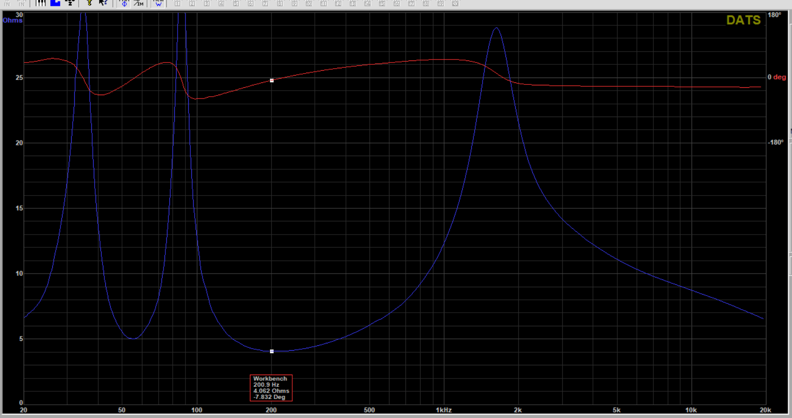

I notice jeff uses 4ohm drivers. Questions:
1. DId you use 4 ohms?
2. if you drive xover from a single amplifier can driver impedances pose any problems to the amplifier with both drivers at 4 ohms?

Why do you ask - you running tube amps? Just use an amp that is stable at 4 ohms and of sufficient power for the speakers rated sensitivity… job done.tktran303,
Do you know the lowest impedance? I not sure you know if so don't push it aside.Why do you ask - you running tube amps? Just use an amp that is stable at 4 ohms and of sufficient power for the speakers rated sensitivity… job done.
Check out the graph of the woofer, it doesn’t drop beneath 4 ohms
http://sbacoustics.com/wp-content/uploads/2020/02/5in-SB15CAC30-4.pdf

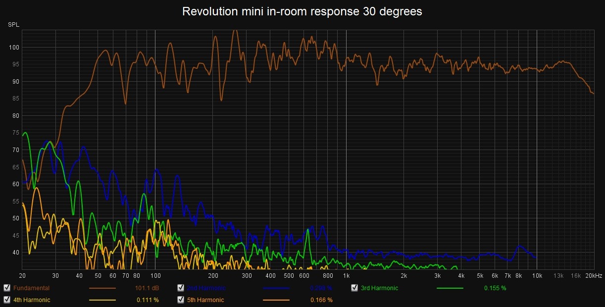

I can confirm that although both drivers are 4 ohm nominal, the complete speaker system never drops below 4 ohms:

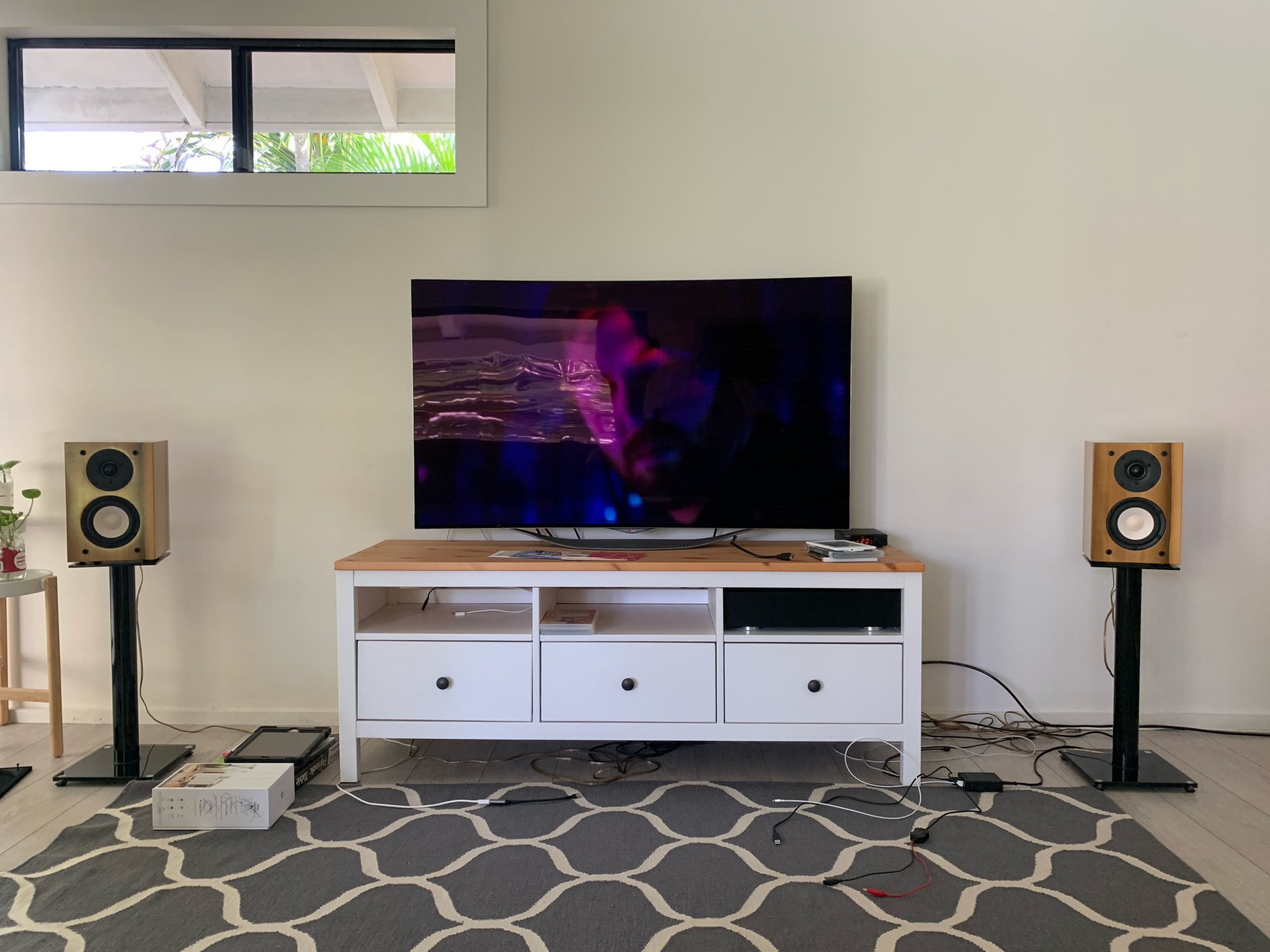

Depends the size/dimensions of your room, and how you like to listen. In my previous room 4x5m room with the speaker baffle 50cm from the front froom it was a was a good match:Whats the best listening distance, aka sweet spot, for the Revolution mini?
My current (2022) room is 4.8m x 6.4m x 3.2m.
My speakers are along the 4.8m wall, 2.4m apart, baffle 0.5m from the front wall.
When I place the Revolution mini in this room, it's clear it cannot play at live levels (eg. nightclub, pre-Covid, remember those?) with the assistance of a subwoofer:

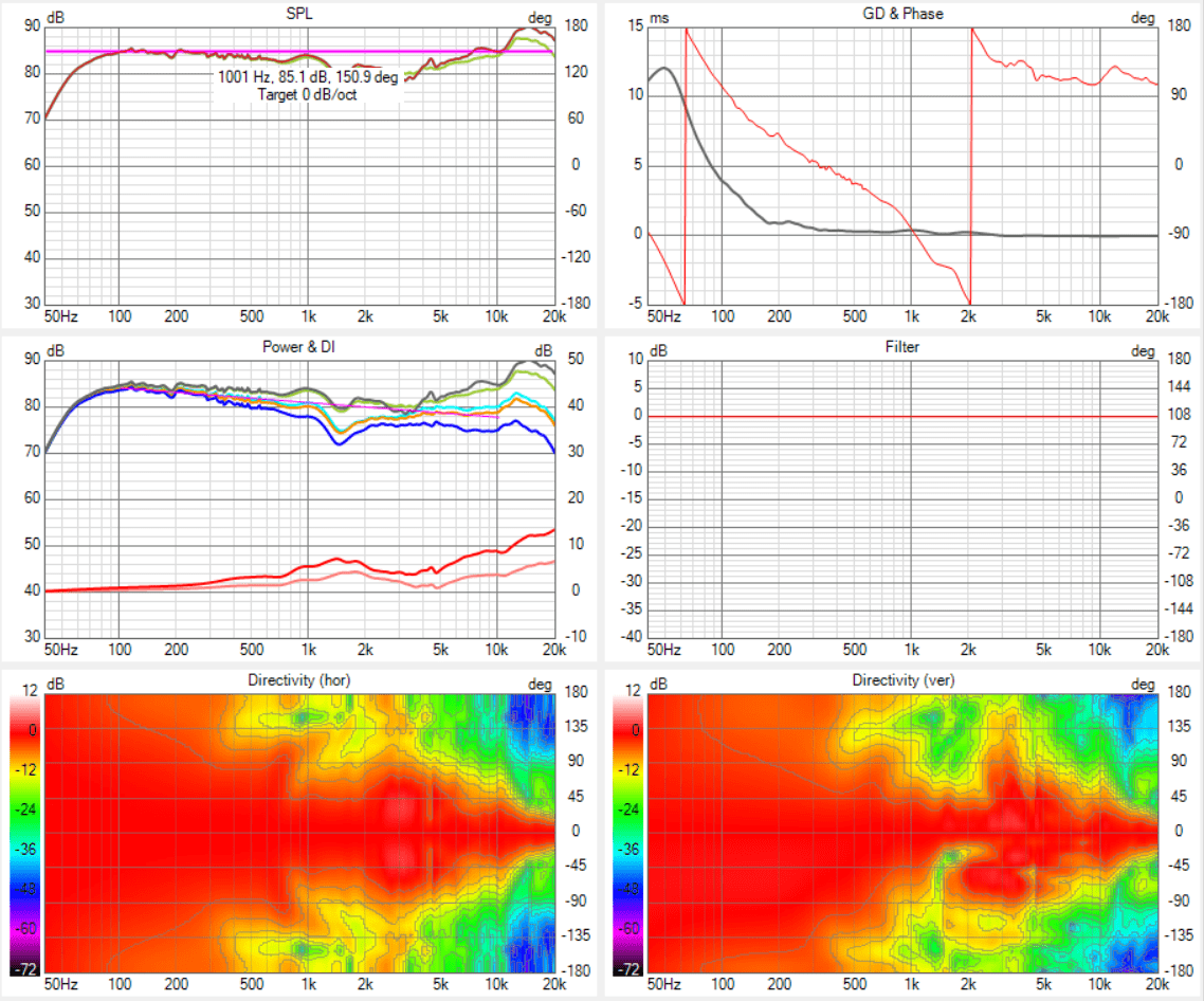

Edit: Measurements in CTA2034A standard (50dB scale) in original post.
PS. To do justice to Jeff's design, the original Beryllium dome (and complete spinorama) is in the works...
I'm bumping this thread, and am interested, @tktran303, in any results with the Be tweeter as well as whether you've continued to enjoy these. As may be the case with some of JB's other designs, the quantitative measurements seem just OK (big scoop from 1-6K, directionality just OK and could suffer at the high end if the Be tweeter is tamer up top), yet the listening experience is described as great including great imaging.
