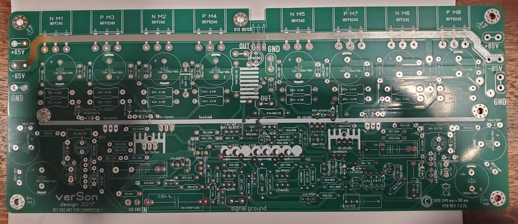

I do not have intetion to offer any more PCbs for this amp, but here are gerbers for 200W CFA board, balance addin board and PS regulator board.
Have a nice time building and enjoy listening this powerful amplifier.😉

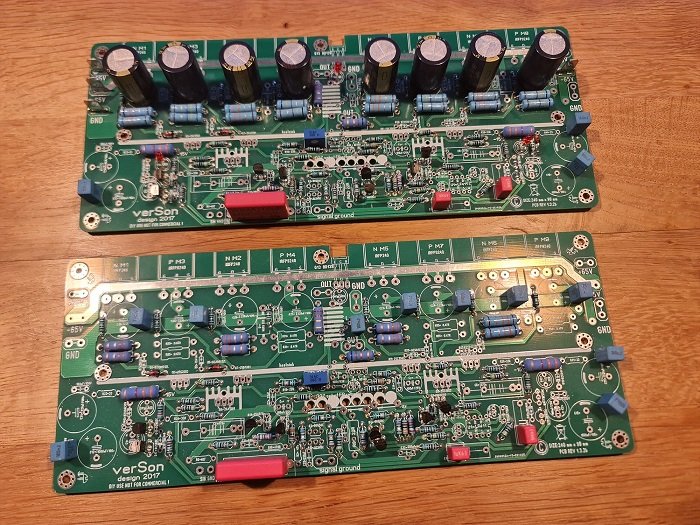

..link please.For sale 200W version. Boards are not finished as you can see on picture. Reason-moving to Dadod A-class variant.
