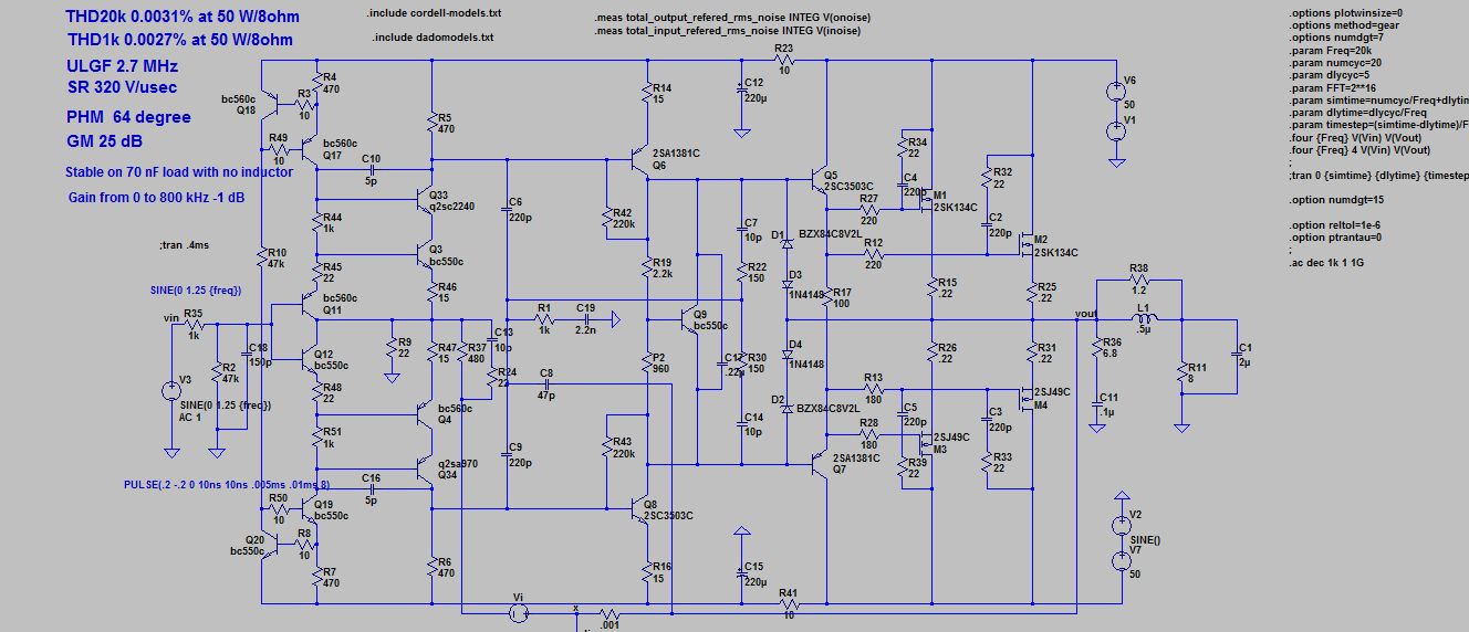

Good result dadod! Very low distortion, fast.
What's the bandwidth?

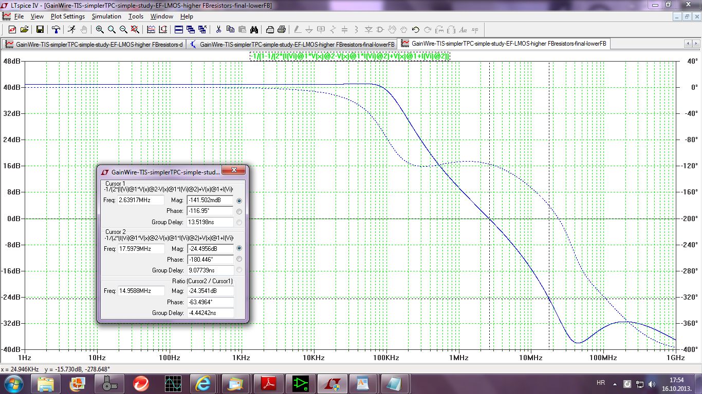

Without input filter 0 to 6 MHz and with input filter 0 to 600 kHz.
Probably better to filter it a bit down.
Loop Gain bandwidth 0 to 15 kHz with 80 dB, 70 dB at 20 kHz.
BR Damir
It was not possible to simulate correctly slew rate because of protection zeners, after removal all was as it should. I am not sure if zeners from LTspice library are OK.

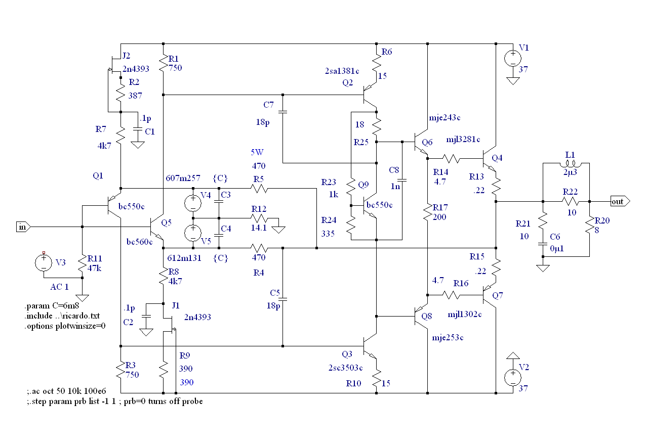

Post the ASC for #500 and I will demonstrate.
I grovel at your feet.
Thanks...
What you have sent doesn't quite match #500.
C7 is connected to the Vbe multiplier.😕
Presumably this is an error and it is intended to match #500?
Best wishes
David
I've been playing with various compensation schemes in the dark cos I haven't got the right tools.What you have sent doesn't quite match #500.
Both versions are valid and would benefit from a closer look using both
- the 'inner loop' probe between R13/15 and R4/5
AND
- the new 'main loop' probe which I'm hoping you'll show us.

Yes. Mea maxima culpa 😡Are you sure?
It looks to me that one side is Miller compensated and one side is Output Inclusive.
I remember from dim & distant 'real life' that doing something yucky like this didn't really cause problems .. but its a symptom of fudging by the unwashed masses rather than correct design .. which is what Holy 'pure Cherry' deserves 😱
I did it on a 1975 Hitachi style circuit with LTP input like Fig 7.14 of Cordell's book but simpler as is my wont. 🙂

Bob, if you are lurking, I think Q5 in that pic should be diode connected rather than Q6 in the current mirror.
________________________
Actually more like Self 4th ed Fig 4.21 where he pontificates on the evils of this circuit ignoring its good points. This is actually one of my favourite VFA topologies if 1pp zillion THD isn't essential.

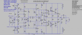

Here is CFA amp with low FB of 32 dB and it’s flat up to 100 kHz. Distortion is going up, of course, and harmonics slop down monotony. Some people say that this should sound better then high feedback and lower distortion but with not so good harmonic distribution. The amp is very stable, with no output inductor and up to 70 nF at the output. With output inductor of 0.5 uH only(John Curl maximum allowed value) it is stable on all reasonable capacitances.
BR Damir
BR Damir
I would class that as as a high performance amplifier:
Distortion at least 2 orders of magnitude BELOW other signal chain element distortion levels (speakers, vinyl, room acoustics, ear etc)
Good slew rate performance
Monotonic distortion spectra
Good gain and phase margins
I have concerns about matching the OPS mosfets and C10/C16 impact on PSRR, and the TIS collector base resistors - but, I think overall this design has some solid benefits.

I don't think that the matching is going to be a problem, laterals from same batch are quite matched. C10/C16 could be removed they dont influence stability, but PSRR simulation shows no difference with or whitout them. PSRR is about 56 dB at 100 Hz and going down to 48 dB at 10 Hz. Good cap multipliers for IPS could better PSRR.
Regarding TIS local feedback resistors, I simulated whitout them and with differente resistors values. Without them lopp gain is 70 dB but distortion spectra is not so good. Value of 220 kohm gives 32 dB of feedback and much better distortion spectra and not so high distortion. Don't forget that this amp is very stable and 0.5 uH output inductor is more then enough if any is needed.
BR Damir

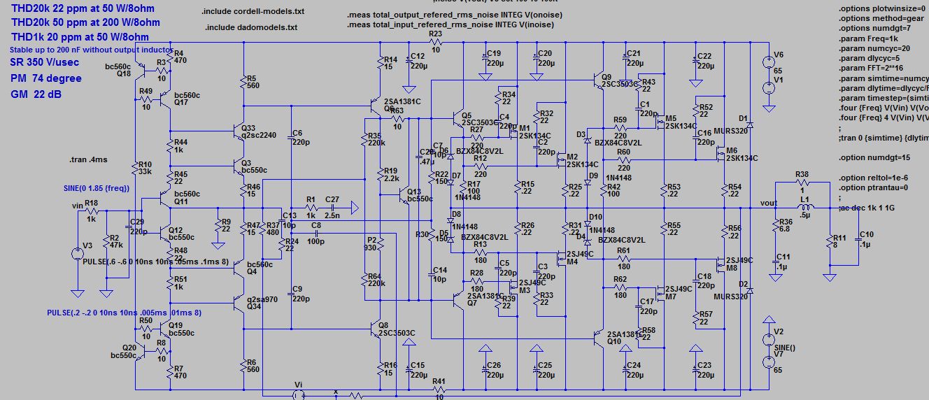

This is my final 200 W/8 ohm, 400 W/4 ohm CFA amp. It is not of extreme low distortion, but it is very stable, even to 200 nF load with no output inductor. It's no to simple I admit, but what the hack, simplicity is not my peace of cake.
BR Damir
BR Damir
- 200W MOSFET CFA amp
