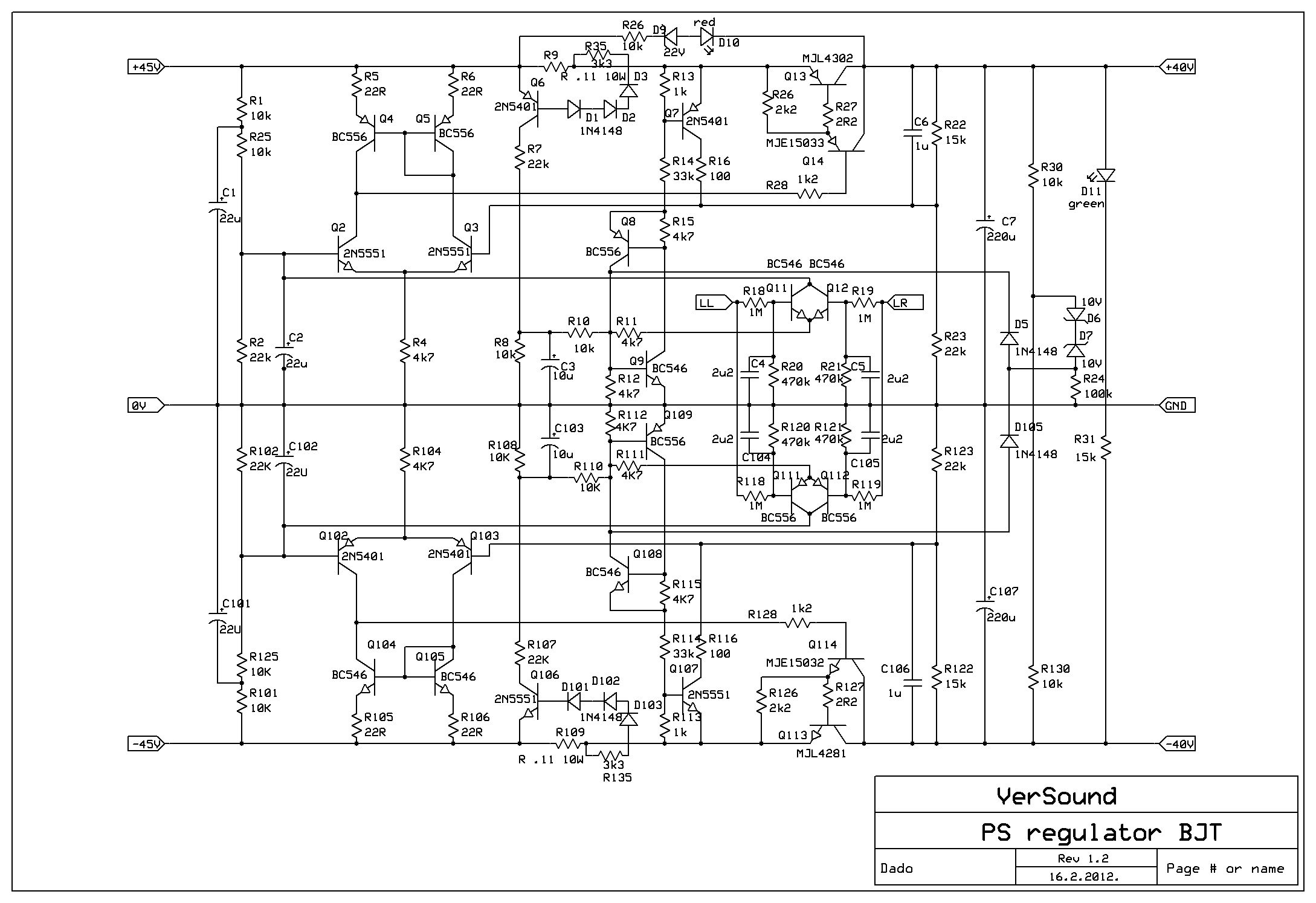

I have a little concern about the gate protection zener diodes that, in an unfortunate event of output being shorted to GND, there could be large current going through them as well as through the driver transistors that may result in these devices being driven beyond their maximum limits and getting destroyed. Could this be a real issue?
I suggest to use my power supply with cap multiplier and all needed protection like I used in my TT amp, but with higher voltage of course.

David, but then here is the best combination of both worlds. I hope it will put some peace between two confronted parties.
BR Damir

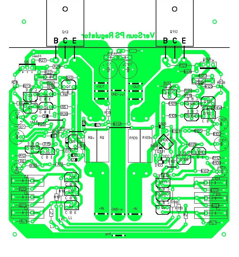

Is there a layout for this schematic?
This is the layout for presented regulator schematic but this is enough for 100 W amp.
For 200 W amp input voltage for the regulator shoud be increased to +- 70 to 75 V, resistors R23 and R123 changed to 20 Kohm, and output serial transitors doubled or even tripled(Q13, Q113).

How would you arrange this PS circuit into a +/- tracking regulator. Seems just a few changes are all that is needed. Tracking or MS (Master-Slave) regulators are much better for power amplifiers. IMO.

If I cross connect feedback resistors to the oposite polarity instead to the ground then a +/- tracking is better but not much. Could you give me a hint how to make better tracking?

Can I propose a PCB layout based on 0805 and larger SMT passive parts? The much smaller size of the components allows for a compact placement, and I was able to put in a high frequency local Zobel network per individual MOSFET. I haven't had a chance to simulate it yet.
The PCB has a size of 202x79 mm^2, it conveniently accommodates a solid state speaker relay fired by a photo voltaic device under the control of a DC detection circuit. An external 12VDC supply is needed for the relay. This relay circuit can be opted out by shorting out two solder jumpers.
In the upper left corner of the layout, a breakaway piece carries the feedback resistor chain. This part can be attached as a daughter card on the bottom side of the main PCB where the output inductor and the star GND connector sit with two 2-conductor pin headers.
Electrolytic caps for the OPS has footprint for either 16mm DIA (1000uF/100V) or 22mm DIA (3300uf/80V).

I am impressed with your skill, very nice layout and then with SMT.
I would like to suggest something:
1. Insert input polypropylene cap in the input, 1 uF is high enough value.
2. Insert a trim pot of 200 ohm parallel to the R15, R23, then change those resistors from 15 ohm to 18 ohm, this to trim output DC offset.
3. Q5 and Q6 should be for higher voltage as almost all power supply voltage is on them.
4. Q11 and Q16 should have own smal heath sinks as thy dissipate 1.7 W max.
5. Q17, Q20, Q22 and Q23 should also have own small heath sinks, max dissipation 1.2 W.
6. Electrolytic caps for the OPS don’t need to be of so high value, max 1000 uF is more then enough.
7. Resistors R51 and R52 use 33 ohm instead 82 ohm.
8. Put one jumper between R42 and R46 midle point and feedback input point, in this way one can decide to use high or low feedback and decide by listening the preference.
9. R88(R9 in my schematic) should be of 1 W.
I did not look to carefully the layout, but I like the name(Meistersinger after Wagner opera??) and will be nice if you add my name as designer.
It will be very exiting to compare this SMT layout and trough the hole one that Chris will present soon.
BR Damir Verson

Thanks for the feedback, dadod. I'll look into all your suggestions. Sorry for leaving you name out by accident, my bad ~~ I borrowed the layout from another Meistersinger (a VFA) I am working on that has the similar OPS and solid state relay layout. And yes, it was after Wagner's opera. This year happens to be his 200th birth anniversary.

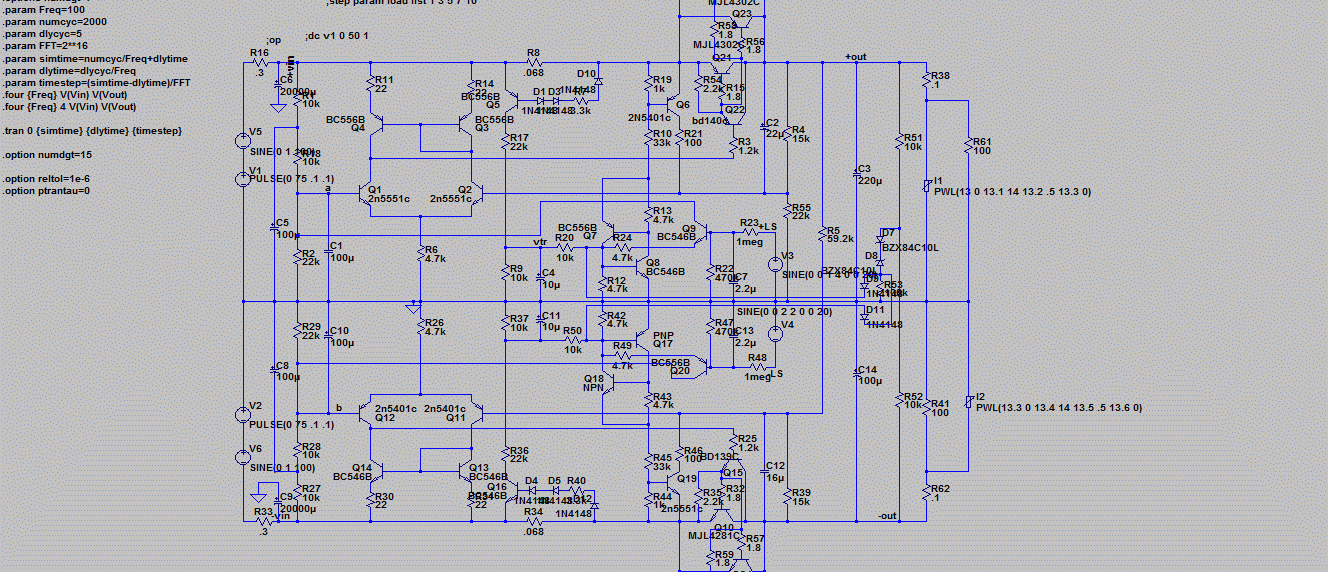

Here is Power Supply Regulator with tracking similar to rsavas design(tracking part). I tried first what I thought could improve the tracking(cross connection of the feedback resistor) and the result was better than with no tracking but not much improved. Than I simulated Richard suggestion and still I did not get satisfactory result, so I tried rsavas master slave approach and here is the simulation. To simulate how good tracking is I introduced a current pulses in the positive and negative side with quite low frequency of 3 Hz. With normal music current fluctuation(AB class amp) it should behave even better.

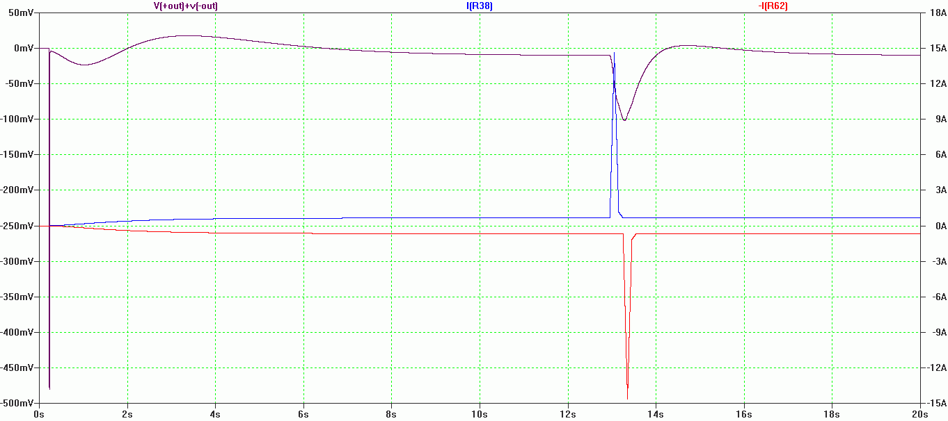

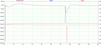

Than I simulated Richard suggestion ...

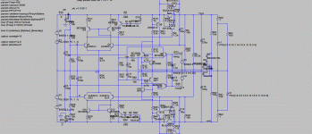

Sorry to say that but my simulation shows no different what's so ever with and wihtout a cap across + and -. I simed with 10 Hz and 100 Hz of dynamic loading.
There is still problem with picture upload so I can't upload my simulations, could be that I simulate wrongly.
