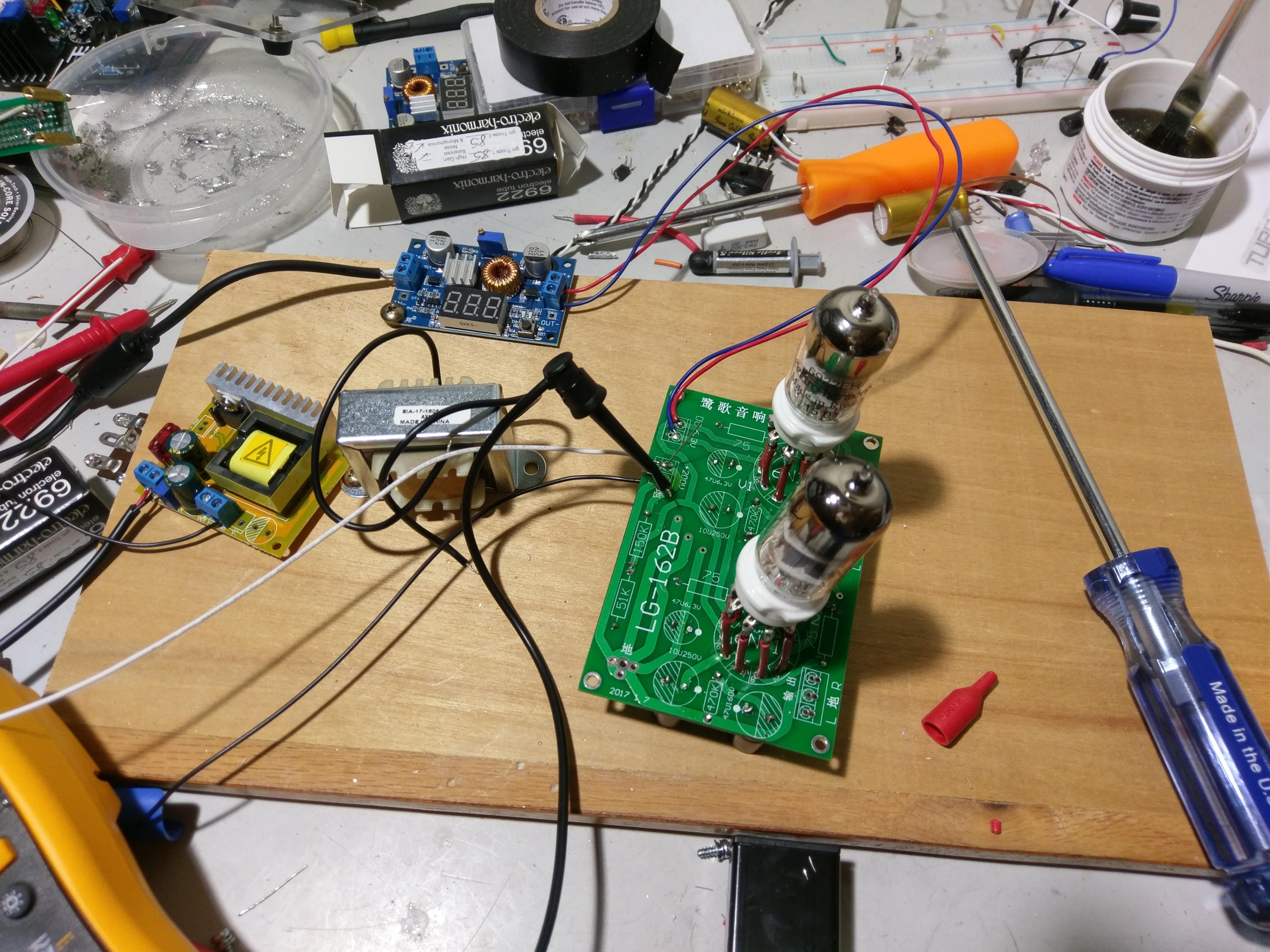

On the present board I'm working with, a dual 6922EH tube headphone amp, I'm using this device with a 24V 1A DC power supply in this device you recommended. It can't seem to keep the charge up.
It uses a 200k resistor to grounds in the form of a voltage divider for floating the filament voltage to +50
Here is also a picture of this setup, and the 1H inductor is not connected.
