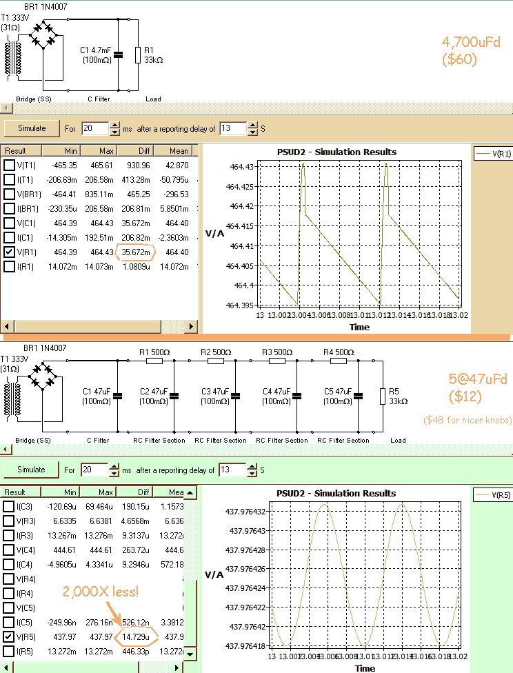

An old rule-o-thumb for picking the first filter cap is 1uFd per mA. 13uFd!! Yes you "can" get 4,700uFd. But the same amount of stuff will build hundreds of smaller caps. And you get a LOT more filtering with a C-R-C-R-C-R-C-R-C chain than a C or a C-L-C-R-C chain.
The multiple added uFd do not just add, they *multiply*. Like from a 6dB/oct 1st-order filter to a 30dB/oct 5th-order filter.

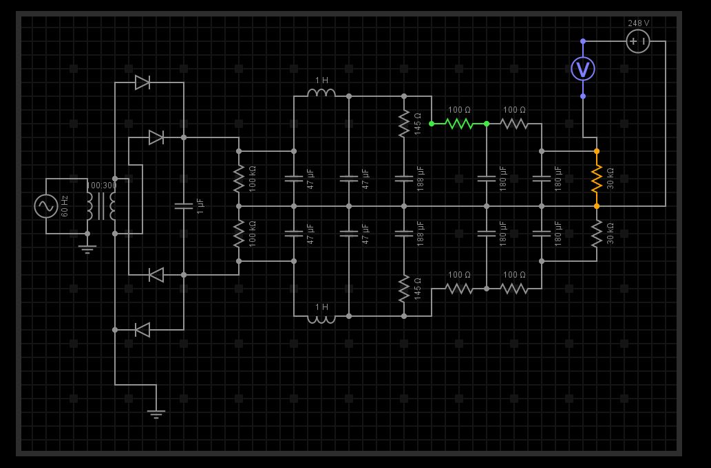

So I approached this with two or three things in mind:
1. Bigger caps = less ripple and more stability
2. Just get flat B+ voltage to the tubes and everything will be fine
3. There's no kill like overkill.
Came out with this:
- Learned massive inrush of current is bad as a result
- Learned PSUs need to be balanced for their loads
- Learned I've completely not predicted the load properly
- Learned electricity is like water in a pool, and there are many considerations to make in high voltage power.
- Learned I need to make one of them safety light bulb things first.
- Learned circuit simulators are primitive.
- Learned how to use LTSpice!

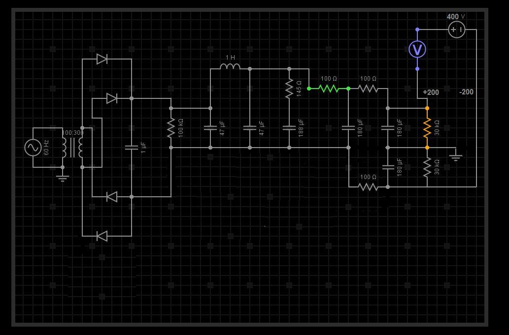

I see, so throw a voltage divider in at the end and connect it to ground. K!
Thanks.

Sorry but you started with the wrong foot.
* You bought a center tapped 382V transformer meant for a 2 diode "full wave" rectifier but show it connected to a bridge rectifier, so actual VAC is 382 and rectified volotage on first cap will be scary 540V DC.
* Not sure why you chose *huge* (should I say impractical?) 4700uF as the first cap value.
Yes, it *will* work there, same way as a 200HP electrical motor will run your bench drill press. (hint: usual value is 1/4 to 3/4 HP).
It will also take such a long charging pulse (during which it looks like a short) than it might even blow the 1N4005 diodes.
* given such a huge capacitor and light load it will amount to negiglible ripple to begin with,so there is not much need for the filtering inductor ... which also won´t do much in any case, just calculate ripple values before and after it.
The following RC cell will work nearly as well, and is more reasonable, from a practical way.

You can rest easy there sir! I haven't bought a single thing yet. Haven't I agreed as much already, that these aren't great ideas?
Yes, this PSU is for a pre-amp. I do have some other designs for PCBs for which I will have to design other PSUs for.
Although I won't be using a large capacitor, I did experiment with a mosfet connected to a voltage divider, which toggles a relay. Now the relay was in front of the buffer cap, to switch between a high current power resistor. This would slow down the voltage draw until it passes a certain voltage, then it would charge as normal.
But again, that was too large an input cap.
When I look up that transformer with the 380CT, the spec sheet says 380 Red to Red. Yeah, that would be bad for a single rail B+ of 200v. But it'll be fine for a dual rail supply. I agree that the diodes are not up to the task. I meant those to stay under 300v.
Now with ripple, the problem I'm targeting is, I don't know how to figure out what ripple reduction to target yet.

JM, I'm not sure I would call the single 4,700uFd design "negligible ripple".
Using near-ideal parts I get 35mV ripple, and a really ugly waveshape. With some assumptions, this may be 10mV ripple on first plate and 1,000mV (1V!) on the third plate.
With realistic part and wiring parasitics it will be worse. Past some point, over-kill is money down the toilet.
To add to my many-small-caps point, much less uFd can give 2,000 less ripple, for a small loss of DC voltage. (Less loss with choke.)

Seems that, other than the choke + cap causing an oscillation, they're extremely effective at attenuating ripple.
