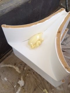

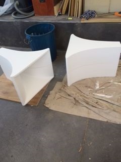

Expanding foam added to cavity.

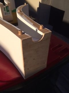

Rear ply board added near throat.

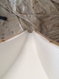

Putty added to new half circle area for smooth transition from driver.
1.4 inch to 2.0 inch horn adapters sourced from Cannonsound (P-Audio).

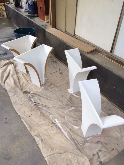

Such a lot of work!
Yeah boy! It's why I switched to big rectangular WGs and my daughter's Play Doh to morph the throat from rectangular to round, but mine were normally behind a huge 'grill', so just needed them to be a no frills flat/matte black.

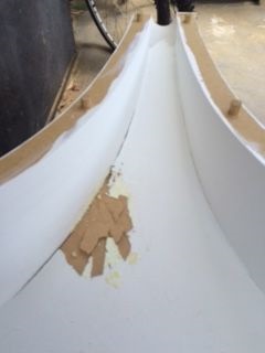

Ha. When I woke up this morning, one of the horns had partly split open due to the expanding foam. Good one.
Bummer! Great stuff, but really good at blowing assemblies apart. I use to make small three point hydroplanes and the first time I poured in the two part styrofoam, didn't heed the warning, just mixed it by 'eyeball', then watched it blow itself to pieces. Darndest mess I've ever had to clean up! 🙁

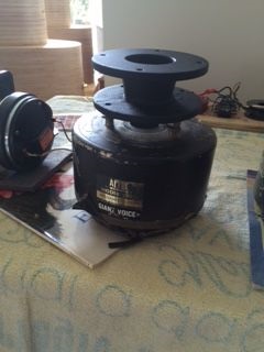

Tomorrow, I pick up my pristine 290 phenolic drivers...looking forward to seeing how this project comes together.

sux! there is some low expansion foam sold in the USA, but not sure if even that would have saved the day. 🙂

Sanded and puttied damaged section following expanding foam blow out.
More work on the throats...now nice and smooth, with profile almost perfect to the horn flare.
Got my Altec 290 "Giant Voice" phenoloic drivers from Altec guru, Ray Pearson...ye ha.

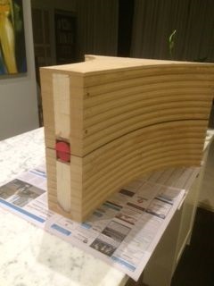

Cut holes for horn adapter.
Tomorrow I'll join the horn sections, then finished. Happy.

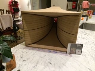

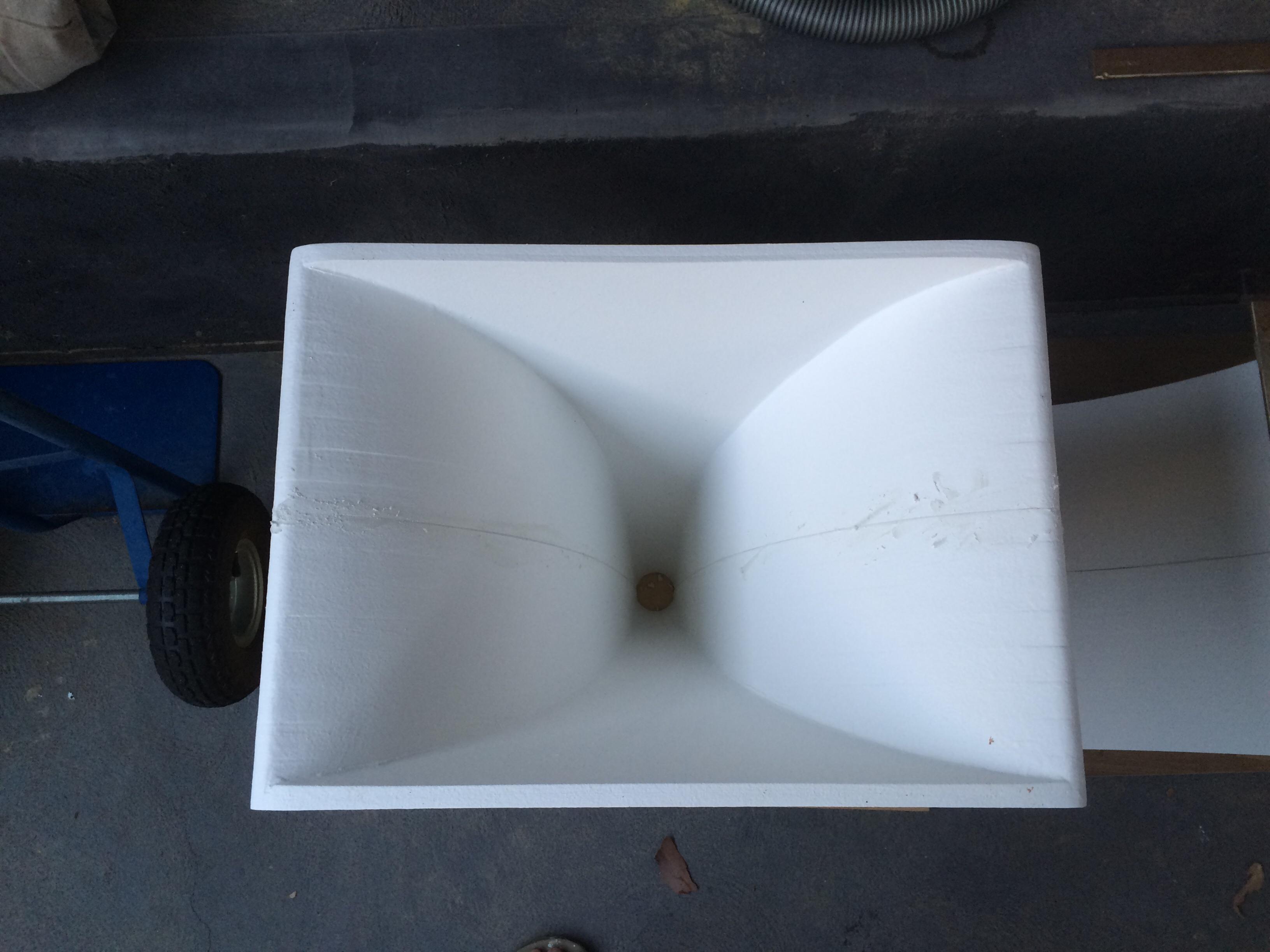

Putty added to inside join.
Nice! Those look to be about the same dimensions as the CLS RH60's I have. I recently spent a few weeks evaluating a bunch of big radial horns and they came came out on top. Really sound great with Altec 288 or 299. Very hard to fault. About the same size as my 180 hz round tractrix horns but better LF loading and upper end power response.
