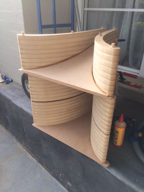

I'm hoping with xover at 300Hz, any negative effect from a 'sharp edge' won't come into play, given the horn's 200Hz Fs...
Sorry, doesn't work that way, the larger the horn, the lower in frequency/'stronger' the reflections back to the throat 🙁, so a higher and/or steeper XO is required to weaken them. That, or add a foam 'plate' gasket similar in concept to the one used on the Altec M19 or horn extension like me and a few others have done to create a diffuse terminated mouth. In retrospect, this option is probably should only be used where the horn is set back from the front of the cab.

Kolbrek finds that LeCleach cut short (at 90 degrees)(also with tractrix being similar) affects more than just the low end. Here is the link. Lots of sim results to sift through.I'm hoping with xover at 300Hz, any negative effect from a 'sharp edge' won't come into play, given the horn's 200Hz Fs...
Yep, guess I should have added that the lower in frequency, the wider an eigenmode's [reflection's] bandwidth [BW].

I'd make the flat expansions as solid as is possible. I have used a gypsum based compound acquired from pottery supply houses to fill spaces like that... actually expands slightly as it cures, ends up ROCK hard (harder than concrete) and could be molded in place and painted if one wanted to (the stuff I used has a color that is close to maple or pine, maybe a bit more yellow/brown shade). Of course you can use it between two surfaces also, and/or mold it and then use an epoxy or other adhesive to hold it. Also this adds mass...

FWIW, I bonded cement backer board to the big 1803 size WG's I made to replace the stacked 511s. Don't know if they were as heavy as a tar filled one, but were sure plenty heavy and sounded super dull when struck with a ball peen hammer, so resonated well below its passband. Not pretty of course, but the system was always behind a room height screen, so cometics be d@#$%&! 😀
If it had been a requirement, then a thin 'skin' of marine grade flexy ply could be added.

More gluing today. All 4 'halves' now prepared. Tomorrow I will start painting insides. Next weekend I collect the 290's.

Looking forward to reading what you get out of them. I've had a hard time getting 290 drivers all they way down to 300Hz. Maybe your big mouth horns will do it.
As WE proved, even a 1" throat driver can do mid-bass at high SPL if the horn's big enough. If memory serves [debatable nowadays], it takes a ~192 Hz flare frequency to do 300 Hz with authority, though for a HIFI app/4th order it can be up around ~243 Hz with these phenolic loaded 'bad boys'.

I used the 290s on an Altec 803 horn and felt that 300Hz was a stretch. 500 Hz was more comfortable. With some EQ and a 4th order high pass, sure, 300Hz could work.
Here is my advice. Forget where you want to cross over, cross it where it works the best. That is not easy advice to follow, but I've found the results to be best.

The reason I chose 300, is because of goal to get CD performance in that range. Most/all other systems have cd from 500, unless using WE SATO style horns. I've had Azura, Yuichi Altec and other horns, all 500 hz min, hence this special project.

Fingers crossed that it works out. A solid 300Hz needs a big horn. Measure and listen to sweep in that area. You'll hear the distortion on sine waves if it's there.
I run the 350hz round tractrix with the JBL 2441 and it does not work well below 700hz....to my ear.

Tractrix don't start loading until a 1/2 octave away and one octave to 'get up on the pipe' [properly load a driver], so 400 Hz is probably the best it will do, though once shelved to HIFI SPLs maybe 350 Hz. 'Hope springs eternal' 😉
WRT low end distortion, one 'trick' is that these normally came with a loading cap, so removing it and damping the rear cover real good will help same as with the 1" format drivers and if you want to experiment; then based solely on hearing tests I got some pretty impressive improvements by swapping the rear covers for stuffed TLs on a pair of 802Ds way back when.
Reduces power handling of course, but gives a much lower Qt roll off slope Vs the normal peak, then 'falls off a cliff' response [1.2 or 1.4 Qt?] that demands an XO point somewhat above its sealed cab Fb, though no clue if it will get you to 300 Hz.

For starters, I'll use MiniDSP, so I can add eq anywhere to see if it sounds good with 300hz.
I understand the horn's Fs has a part to play...and the tractrix profile that Bear talks about.
At the end of the day, I'll get near 300, maybe 350....which will be a great outcome.
I want to beat Avant Garde (Trio) at their onw game, but not having to use a paper driver in the large horn.
If this 200Hz DIY model doesn't work, I'll buy an Azura 160Hz model, with 1.0meter diameter mouth, and 90cm deep....all the way to 1.4 inch throat. That should do the trick.
