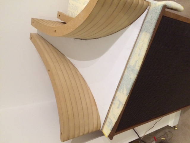

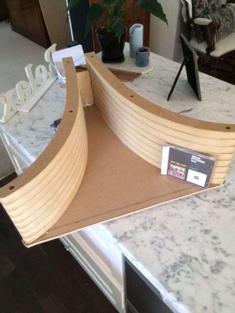

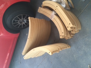

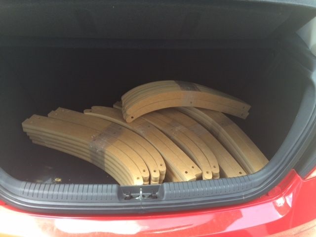

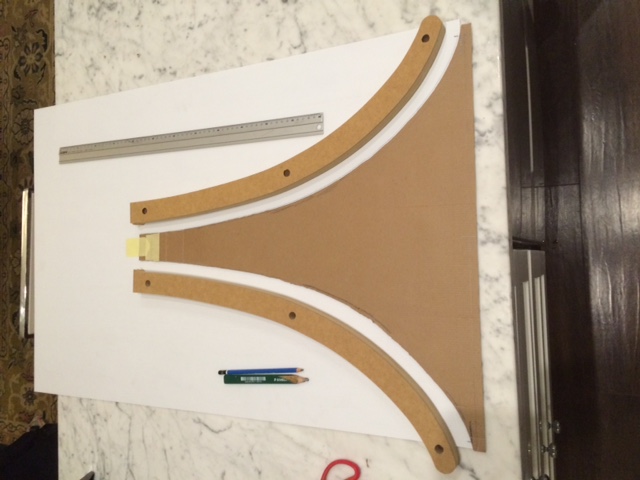

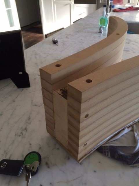

OK, I've ditched my kirfing MDF horn project...and today I collected 68 individual pieces of CNC'd 25mm MDF horn flares....with mouth 600mm wide....and axial length 600mm.
I'll laminate these using 12mm dowel.
Then decide to finish by applying thin bendy ply or MDF for painting or staining.

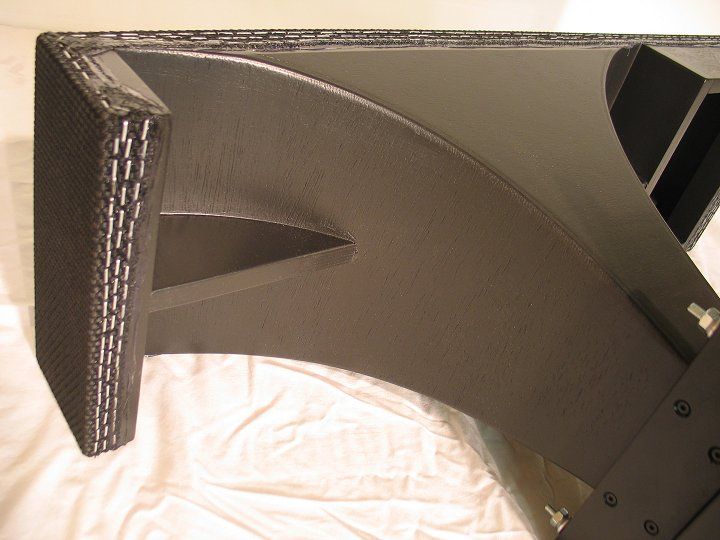

I'll decide if I "angle" cut the horn side sections to create a traditional horn shape...or keep as is, then add a flat top/bottom piece....a bit like the attached pic of a Klipsch horn (Volti).
Angle horizontal horn sections will be made in thin cardboard/MDF to create tricky shape first.
Driver is the famous Altec "Giant Voice" 290 phenolic model, which is designed for low freq...hence the 200Hz horn cut off. I'll test with 300Hz using active xover initially, then quality passive later. Goal is 300Hz to 3,000Hz...which is comfortable range for domestic setting.

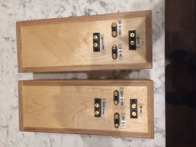

Lew, Yes, pretty close to finish the Beyma 3 way...just finished xover boxes will bi-wire/bi-amp inputs. Spray tweeter horn to be done.
Looking good!
I don't understand the mid-in/mid-out and treble-in/out, though. Could you please explain? I was expecting one pair of input posts and 3 pairs of posts for treble/mid/bass.

Lew, the bass is active, so it is bypassed from the passive Xover box.Looking good!
Dual inputs for mid/tweeter to cater for bi wiring/amping if required.

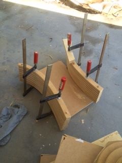

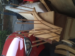

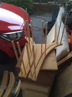

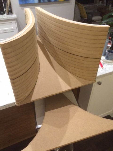

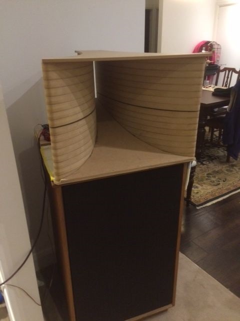

200Hz Tractrix horn getting glued up, adding horizontal angled piece, sound deadening. Driver is famous Altec "Giant Voice" 290, crossed at 300Hz. Ignore 'crack' in the side walls...two sections not yet glued together...to be painted inside first.
So, you've gone with a tractrix expansion left/right and top/bottom a conic (flat) expansion??
Also L'Clerch showed that these horns work best without the edges terminating suddenly... fwiw.
_-_-bear
_-_-bear
Thanks Bear...yes...though I had to worry about overall size...otherwise, I would have used large roll-over for all edges. I'm hoping with xover at 300Hz, any negative effect from a 'sharp edge' won't come into play, given the horn's 200Hz Fs...
You'll also need to convert from the square opening to a round entrance for the 1.4" driver exit to meet... don't forget about that too!
Are you sure you have enough mouth area to reach 300Hz?
Guessing to my eye, looks like ur on the edge... of course testing will tell for sure...
I'd make the flat expansions as solid as is possible. I have used a gypsum based compound acquired from pottery supply houses to fill spaces like that... actually expands slightly as it cures, ends up ROCK hard (harder than concrete) and could be molded in place and painted if one wanted to (the stuff I used has a color that is close to maple or pine, maybe a bit more yellow/brown shade). Of course you can use it between two surfaces also, and/or mold it and then use an epoxy or other adhesive to hold it. Also this adds mass...
Sand would work too... better than fibrous materials. That would work nicely, you'd need a good fill on the bottom...
Very nice construction!
Hope it sounds terrific...

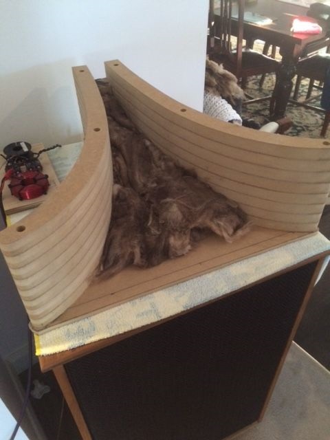

Thank you for your thoughtful feedback.

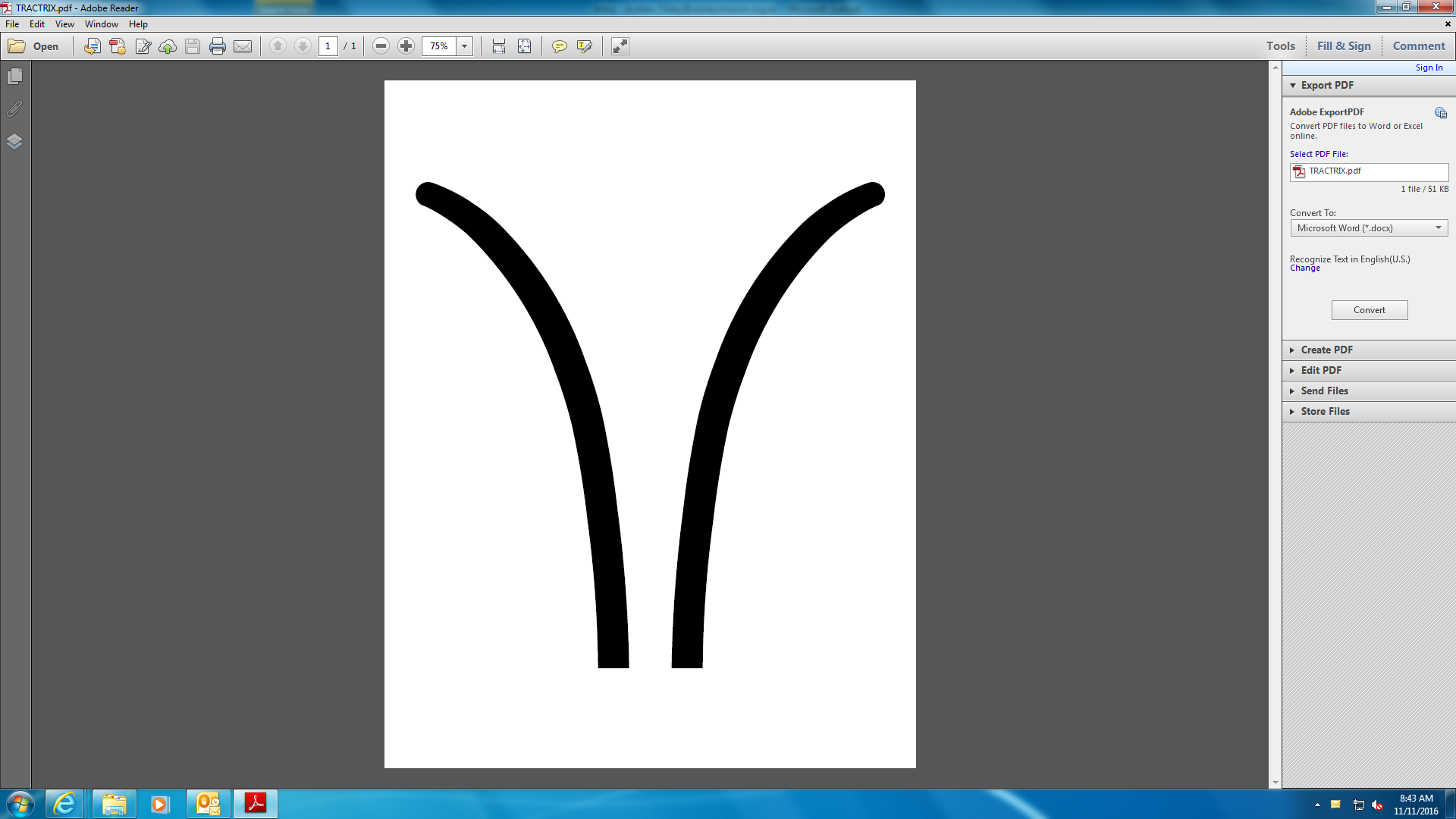

I'm using the attached spreadsheet for the tractrix profile....taken from Volvotreter web site.
Tools – Volvotreter Homepage
The mouth size is an accurate conversion from circular to rectangular (identical cm squared).
Re the sound deadening...yes, I concur. I'm not happy with the current "knock test" on the angled horizontal board...too empty sounding. I will pull out the wool felt and add expanding foam or sand.

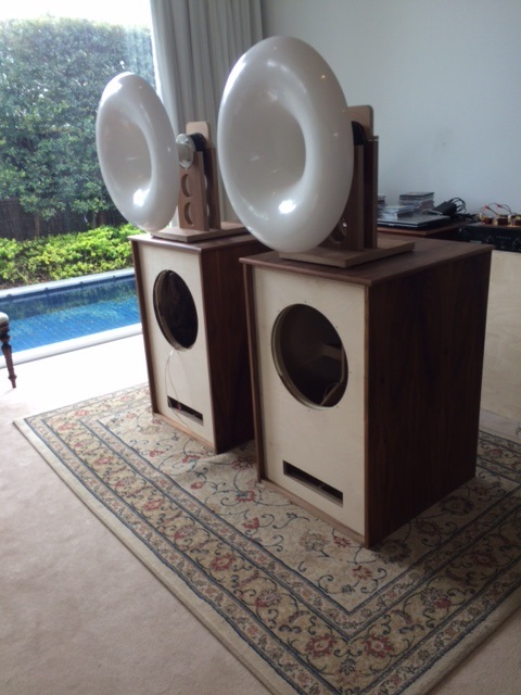

Yes, I am aware of the need for throat adapter...I will use standard Altec 1.4 inch to 2.0 inch....not unlike what I used for my Walnut conical horns (one inch to two inch)...see pic.
