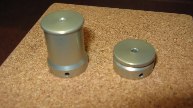

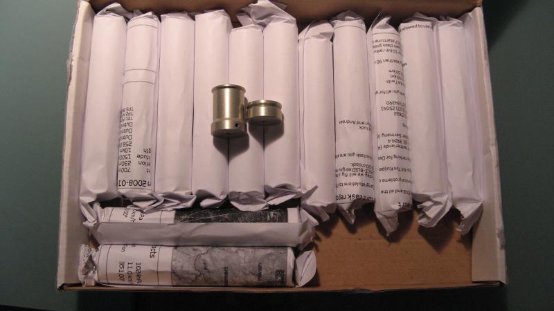

UPDATE:
I received the pulleys. Well boys, they are looking gourgeous. They look like pieces of jewelry, not pulleys. Very impressive work.
Thanks a lot Greg for your contribution to this GB.
Tims to start packing kits now...
Have a good weekend.
One thing about the pulleys is that the hole size is very close so warm the pulley up to install it. You can also heat it a little to remove it from the shaft. Aluminum has a high rate of thermal expansion so it doesn't take much.
Thanks Greg for the info. I'll joint that into the FAQ sheet.

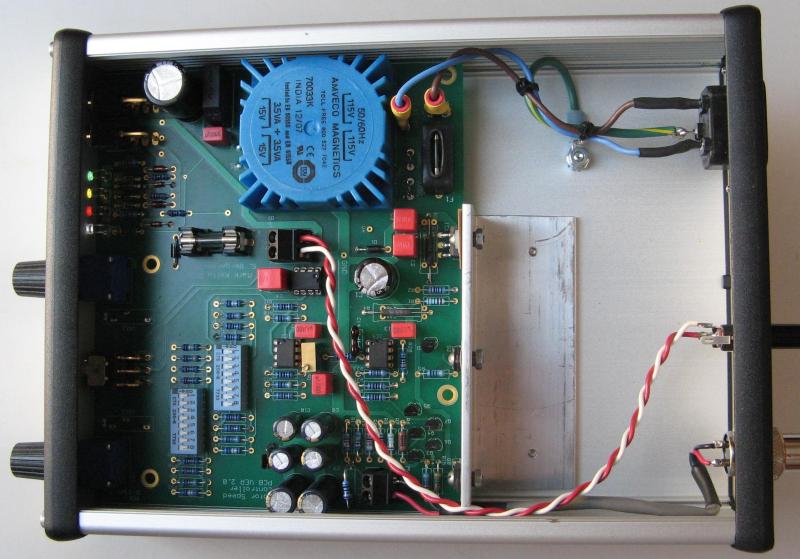

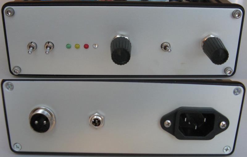

I completed Fishead prototype, see the inside picture. This is an illustration on how it can be mounted into the proposed Hammond enclosure.
I should be able to contact the members that paid for the assembled PCB this week too for shipping and final cost adjustments.
