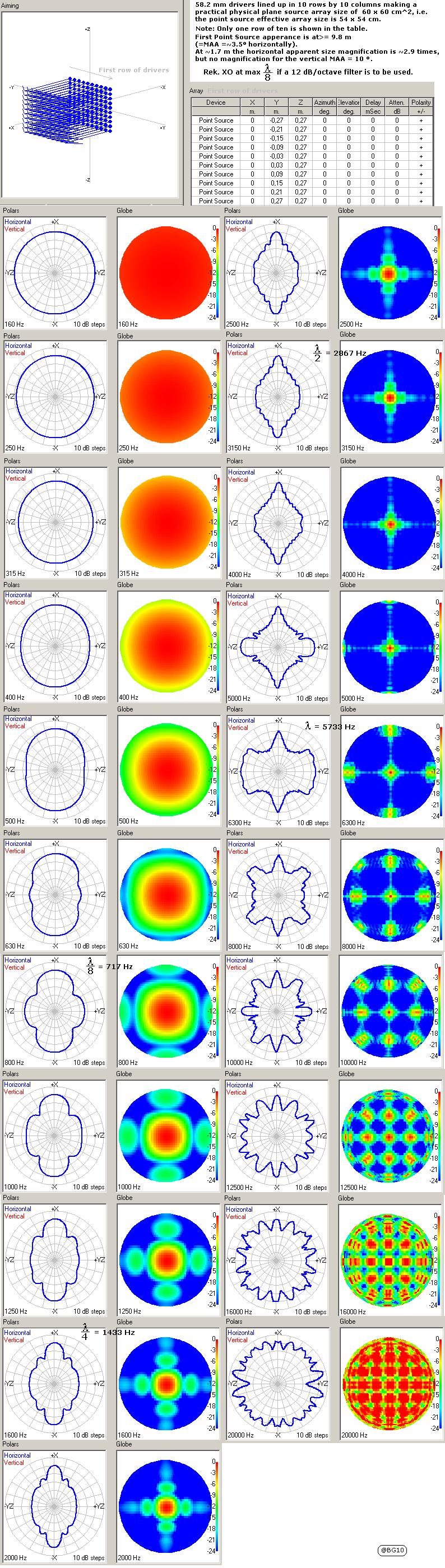

graf, I don't understand why you like the 10 x 10 idea so much...
why do I like the idea? generally for the same reasons all proponents of multiple drivers arrays like it - much lower distortions of any kind, better sensitivity, better power handling/less compresion etc.
why I prefer this square array idea to the idea of long line array?
because of the time domain, there is much better integration of individual driver's output in time domain than in case of long line array, much less delays resulting in much less smear in time response
to some degree it is probably a matter of subjective preferences but it remains an undisputed fact that many listeners speak unfavourably about phasiness and/or bloated imaging of long line arrays
I am concerned with what I can read for example in Dr Griffin's paper:
http://www.systemsolutions.co.za/Tech Zone/Line Array White Paper.pdfNonlinear Impulse Response - Inherent problem with line arrays
I think that indeed this significant smear in time response can be responsibe for this alleged phasiness and as to bloated imaging it can be the result of rather unnatural acoustical excitation of the listening room due to multiple delayed reflections off the floor and ceiling
we have to remember that such an array is not a real line source, it can simulate some characteristics of a line source but unlike in the case of a true line source there are those multiple singular reflections off the floor and ceiling
just my hypotheses of course
have you looked at the polar response WRT frequency? Do you like what you see??
I don't.
me neither, and I not only looked at - I even posted some measurements of 4x4 square array above in this thread - and yes, off axis response is a nightmare but they are generally very directional and probably all this horribly coloured reflected sound is below the level of direct sound enough to be audibly harmless as such
all I know is that the people that have tried it - like it
perhaps it looks bad but it doesn't sound bad?

graf,
The idea that the image is "bloated" in a large line array I do not think is correct.
I have not experienced this at all... perhaps the converse is true, the image in a "normal" system is highly compressed?? Something to consider.
A 4x4 array is not the same as a 10 x 10 array by any means. The 4 x 4 is perhaps within a range of somewhat acceptable in terms of polar response.
IF you are going to make the case for the 10 x 10 array being "good on axis", then the same thing can be said for the vertical array - get on the center line axis! 😀
Anyone listening to a large vertical ESL can tell you that the idea that sound is perceived as "smeared" because of the long vertical axis being equally radiated is simply untrue. It just doesn't sound that way at all.
Your array if I remember the picture is supplemented by an HF horn - so your array is mostly operating in the region where it tends to more or less look like an omnidirectional (ok, half space) source... the long line array can operate satisfactorily up to a much higher frequency.
I am not talking about an idea but about reported observations of both sceptics (for example Linkwitz) and supporters (for example Dr Griffin writing about "Sound Bloom Caused by Unequal Vertical Sound Path Lengths Between Drivers and Listener in Near Field for a Flat Baffle" and the resulting need of line tapering)
I can understand that, exactly therefore I say "to some degree it is probably a matter of subjective preferences" but at the same time "it remains an undisputed fact that many listeners speak unfavourably...", doesn't it?
not really, not that one I have experience with, picture and measurement above in this thread
but on the other hand polar response is not a goal in itself, it is the final sound and it probably depends ultimately on combination of many factors, and it could be probably in this case of 10x10 - perhaps high overall directivity makes uneven offaxis response harmless as such
of course, but the smear in time domain is greater in case of 1x100 and perhaps this is the source of problems reported by some listeners
that is my point
let me repeat what I have already said - large vertical ESL is true line source, long array is not and it makes the crucial difference from the time domain perspective

graf,
You did not address the key point I made about your 10 x 10 which is that you apparently roll it off and switch to a horn of some sort.
I understand what others have said about the line array and time smear. It may become evident when the HF output of a given driver is flat out above some frequency starting at 5kHz and going up... dunno. Otherwise I have not experienced the same subjective auditory impression myself - so far.
No, I have not built a 10 x 10.
others, not a 10 x 10 in particular.
Would you please state what size drivers you are using and what frequency you are rolling them off, and at what measured acoustic slope that works out to be? I am curious.
I did a quick read of Dr. Griffin's paper. In the main it merely recapitulated things that came before. I'm not sure that it breaks any new ground. A good overview for sure!
As far as what other people have said in various published places, their opinions may or may not be correct. In the past the "orthodoxy" of the time has ended up being rather wrong...
There are ESLs that are made up of an array multiple smaller cells - like some Sound Labs products... I never ever heard any "time smear" from them... thinking back. So, while it is possibly an issue, I remain skeptical.
As far as the issues surrounding the alleged lack of horizontal energy from the 10 x 10, again the question remains what frequencies you are running at?? Low enough and the shape of the array becomes moot and meaningless... only when you start getting higher does it come into play in a serious way.
And, imo, the "sound bloom" issue is actually a non-issue. Standard "point source" approximating speakers can create an unnaturally small soundfield in many instances. Although properly set up the soundfield of a stereo pair should not be "small" or "short" especially at moderately loud listening levels and above - imo, of course.
Also, from the time domain perspective the line array and the single source vs. long ribbon or ESL have no difference. If you have a radiating source some distance from the center point, you have it period. It can be an edge diffraction for that matter. There is a difference in terms of comb filter effects due to the physical difference in spacing between radiating sources at frequencies HIGH enough for that to take place. Dr. Griffin mentions this clearly.

for SQ reasons or rather for misinterpreted simulated results reasons? 😉
anyway, thanks for those graphs! 🙂
what I can see in them is that the directivity is very high from around 500 Hz and up, just as expected
and at normal listening distance of around 300 cm the sweet spot would for single listener but not that tiny - around 50 cm wide, enough for single listener's enjoyment
a bit of surprise for me are butterfly patterns above 5 kHz, it may be that te sound of such an array when driven full range could benefit from putting some absorption for those highest frequencies at first reflections points, no problem at all though, it is easy to absorb such high frequencies
best regards!
graaf
