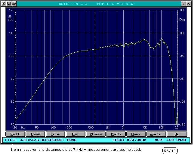

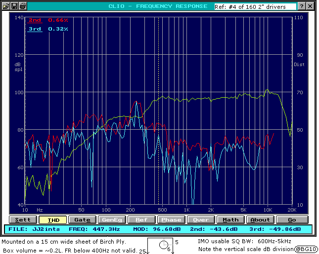

anybody have an actual freq resp curve for those drivers??
didn't see it on PE's site...
thanks

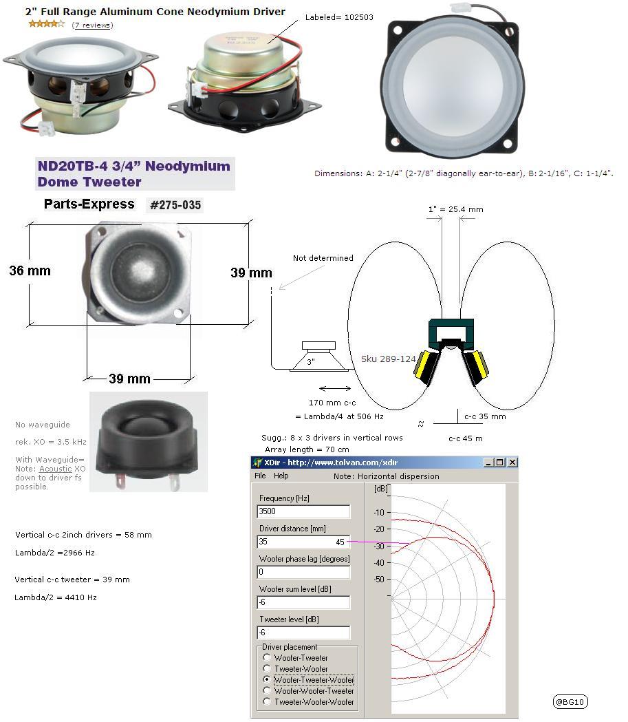

Hi Bear,
Good ideas, 🙂 See my pictures:
b
Ps. b = bjorno= Björn in Swedish = bear
Spherical Array

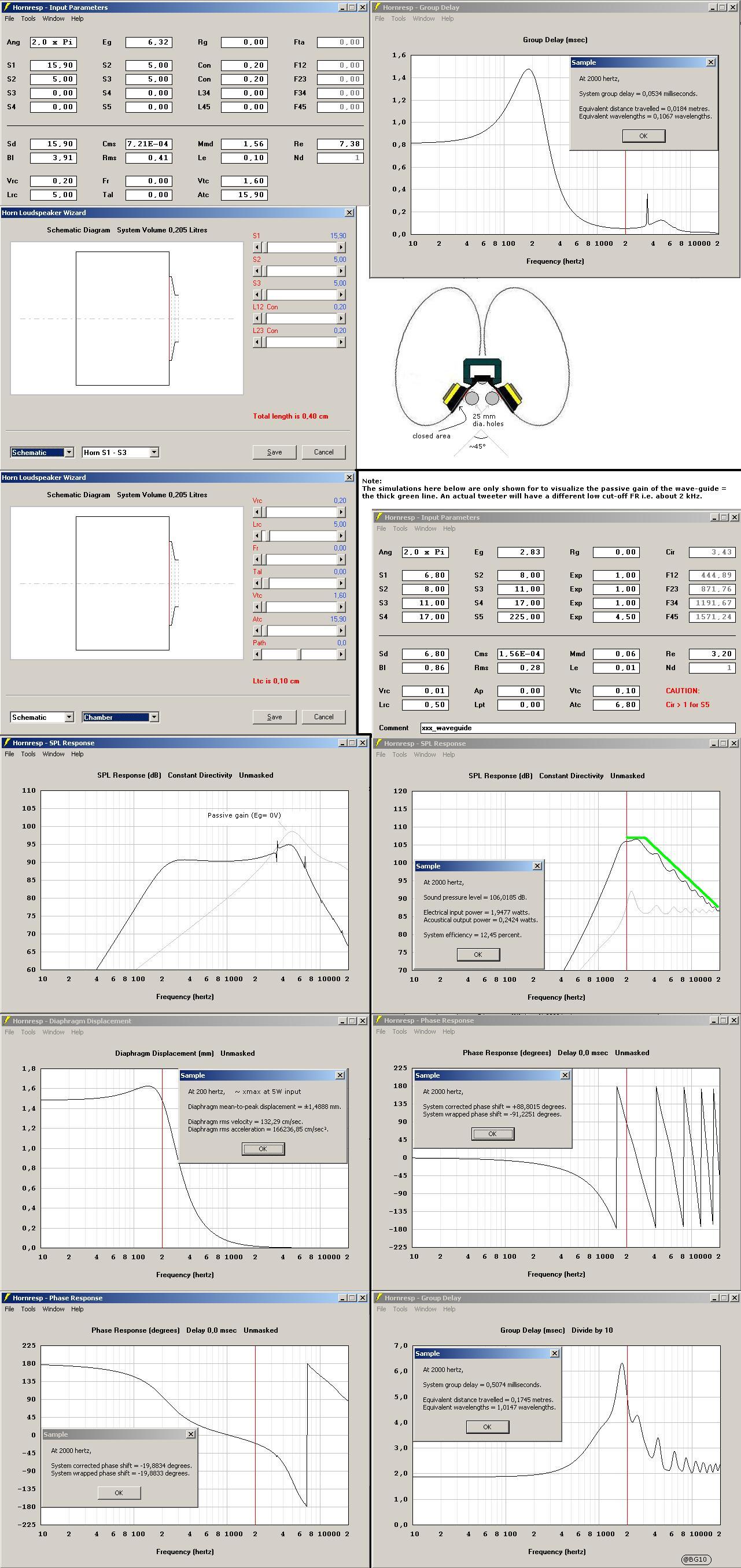

bjorno bear, the eliptical baffle will have significant effect as a horn/wavguide thingie and will need to be measured, I think it will prove to have boost where you don't want or need it.
_-_-bear
Agree,Here is proof showing you need to filter but the result can IMO be good if tweeked out. 🙂
b

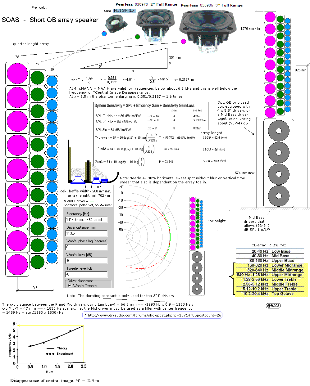

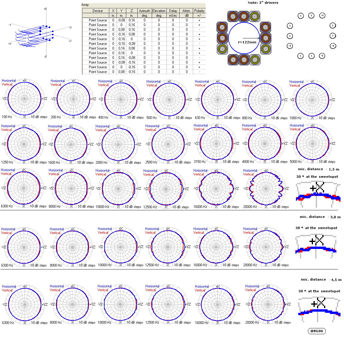

Another vote for spherical array
Hi, Ben:
I'm jumping in a bit late here - was hesitant to suggest a quasi-spherical array, being unsure if the omni-directional concept had fallen out of favour. But since other members have also suggested it, I dug up this copy of an old article in support of the idea. What do you think? The carpentry could indeed become a bit tedious. If I were you, I'd start with just a pair of these, leaving ample drivers left over to build other designs for comparison.
Wilf
Hi, Ben:
Wilf

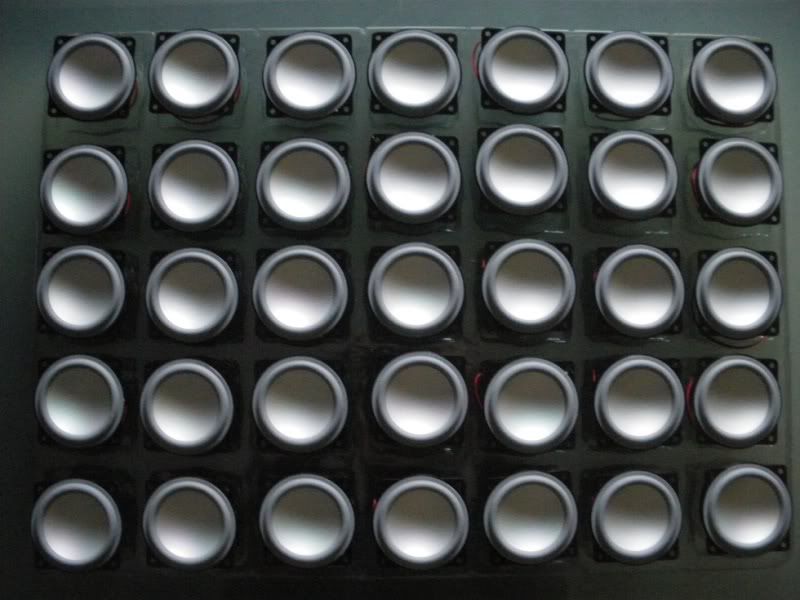

Not 2 mins after my previous post the courier arrived with a crapload of drivers 😀
pics to come.
pics to come.
Only 1 box arrived today, I get the rest on Monday.
They were poorly packaged and 4 were damaged.
Here's 5x7 in their tray
10x10 really is a lot of drivers isn't it? lol
graff, the problem I have is that a wide N x N sized array always has known characteristics that get worse with rising frequency - so why do it??
It's been done, investigated and explored.
You can go back to find Dr. Bose's original work, you'll see that he ended up making a corner into a spherical surface (at least he did that) with multiple drivers.
The problem is that with rising frequency the driver becomes more directional, so you get awful effects that vary with frequency when you make an array that is N x N wide.
THAT was the purpose of my post....sizes for optimum performance would need to be calculated, but the horn/waveguide loading of this many drivers would hardly be a bad thing, if done correctly. If gain could be had down to say 200-500Hz then a large high efficiency woofer (15" alpha?) on OB, similar to the MJK type, and crossed to the waveguided focussed array, COULD be very good regarding wide band CD operation. At least that is what i would believe. Gedlee would be the one to ask on this i would think.
Your dimensions are WAY too small to work at 200Hz, or even 500Hz.
take a look around at the physical size of horns or "waveguides" that work at the frequencies you're interested in, and you'll see what size you need.
There would be no benefit whatsoever unless the driver you selected basically rolls off below some point around say 3-4kHz, so then the "horn" loading would bring up the lower response - otherwise you'll have to throw away the gain you get to get a flat response.
Why do you want "CD" (a really bad term - do we mean Constant Directivity or Constant Dispersion, geez... and what does that really mean - I hate those terrible terms, so non descriptive!!) in the first place? By making a line source, you already have very uniform dispersion in the horizontal plane at frequencies below the point where the wavelength starts to get close to the inter driver dimension and the driver's size... all you have to cope with the xover point you pick and then the highs... which in reality is not a big deal when you go to listen to a line source.
