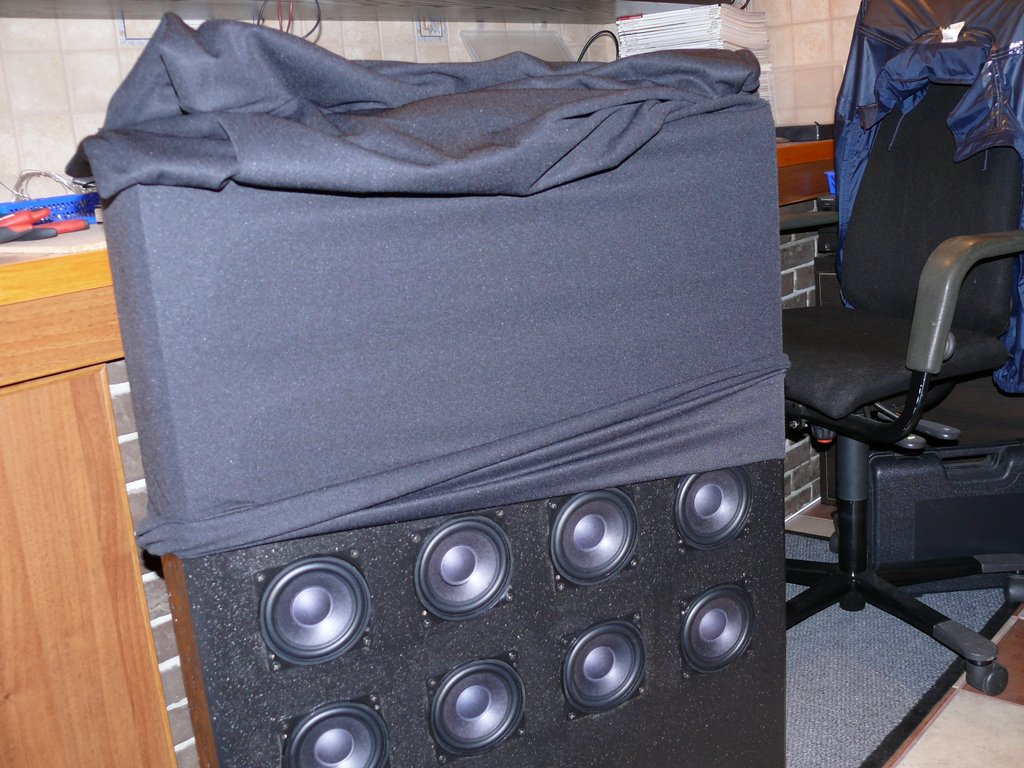

the measured was an array of 4x4 four-inches driver, an array of comparable dimensions as would have tightly packed 10x10 array of two-inchers so smear in time domain should also be comparable
first image is the array

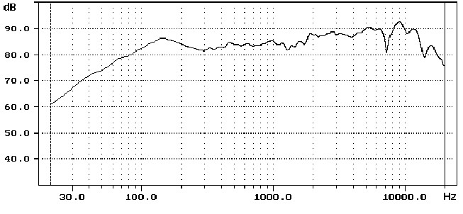

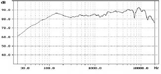

second is frequency response of individual driver as published by the manufacturer

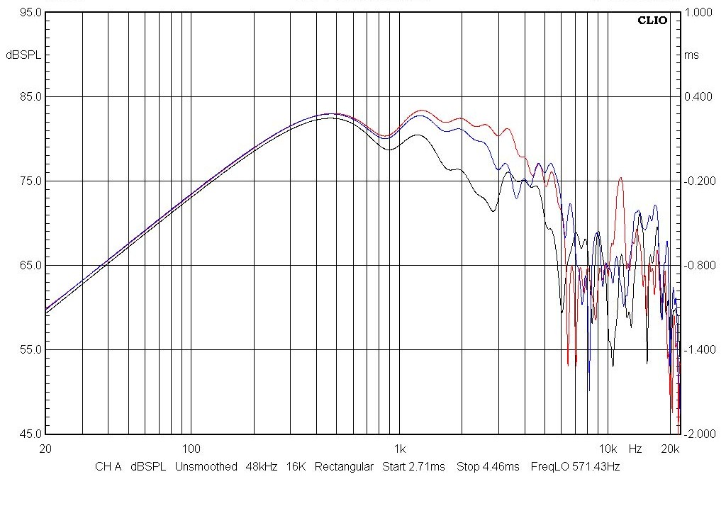

third is frequency response of the array measured in axis and at the listening distance of 2.5 m
this is CLIO plot labelled "unsmoothed", the +/-2 dB wiggles are due to uneven sound wave path lenghts and interference

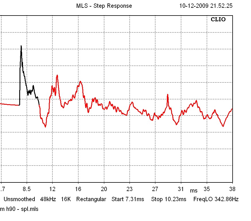

forth is step response of the array also measured at the listening distance of 2.5 m but it is slightly off axis (at the height of 90 cm), floor reflection can be seen I believe

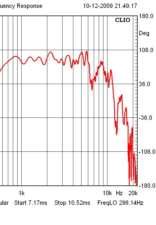

image attached is fr of 4x4 array - red on axis, blue at 15 degrees, black at 30 degress off axis at 1 meter
