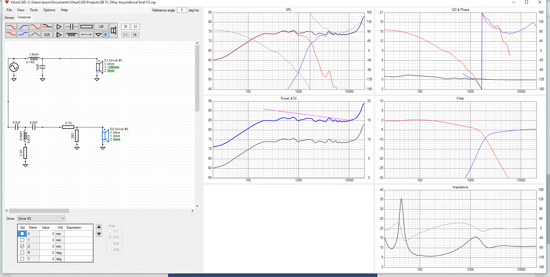

Hi All,
So I've simulated the crossover with just 16uf on the woofer. It comes up well with some minor adjustments to the tweeter circuit, but my only concern now is that the crossover point is up at 1750Hz. That's pretty close to the upper limit for this woofer and also the crossover limit for the driver centre to centre distances. I'll give it a go, nothing ventured nothing gained.

Unless the acoustic centers of those drivers are aligned, I'm pretty sure you should be entering some value ( as an offset ) into the "Z" line found beside each driver ( unless you've already entered a driver delay somewhere else within this software ).

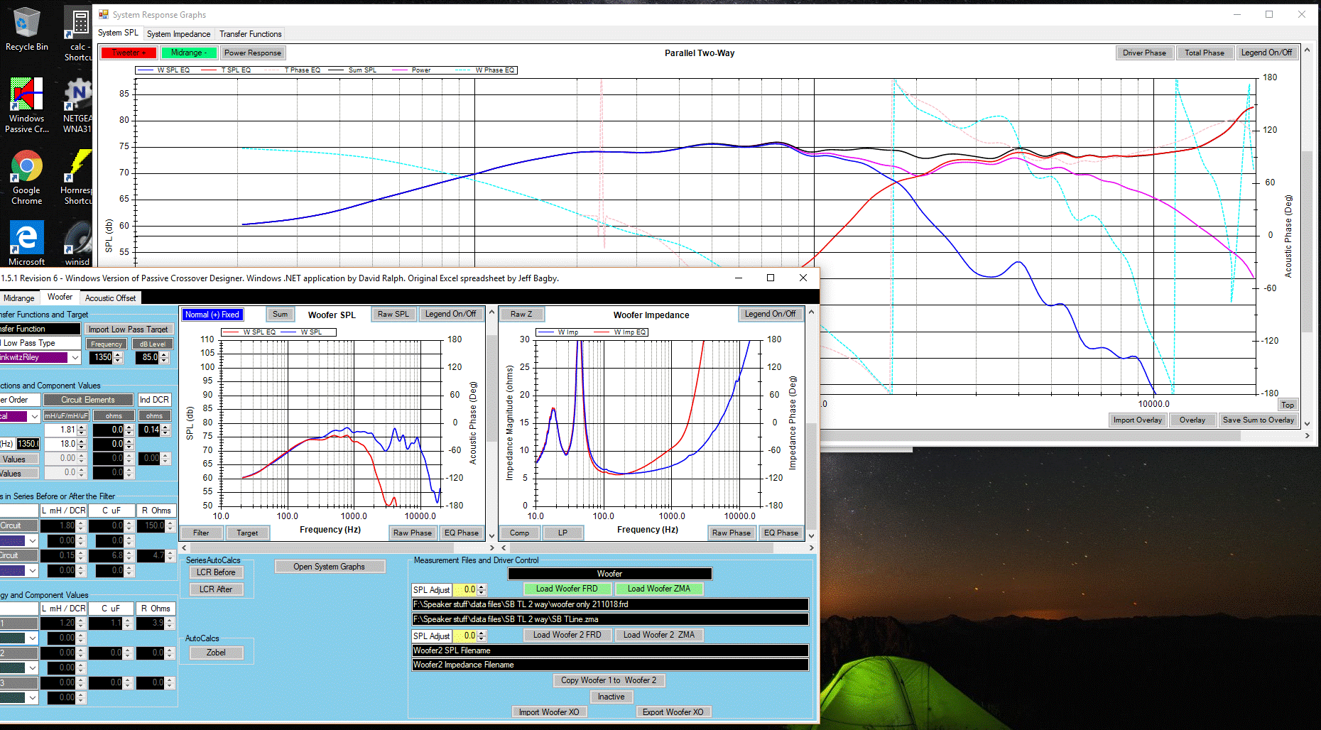

Your woofer breakup at 4KHz is showing in your simulations. I'd deal with it.
And what about that +9dB from 10-20KHz ?
I’ve positioned the speakers so the listening angle is 30 degrees off axis. The 10-20khz is dead flat at that angle. Also I can’t hear that high anyway.
I’ll post the screen shot from winPCD with the latest crossover and then accept comments.

Very nice woofer you are using so please let me interfere. As Zvu pointed out, this driver has break-up issue at 4 kHz which need to be treated with LC trap at 4 kHz in order to to complete the design of a good sounding metal loudspeaker. The low-pass acoustical slope need to resemble flat descending line at the area of break-up.

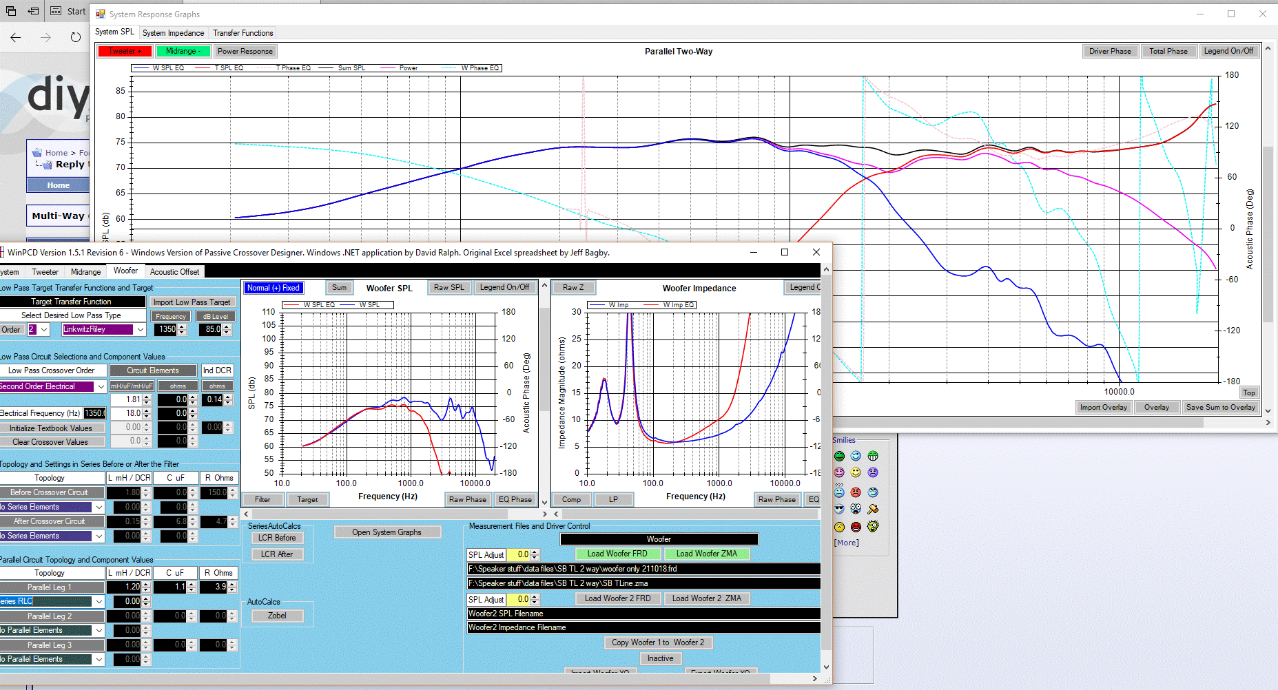

Hi All.
This is the screen shots of the crossover with and without an LCR trap.
For a 3db change in the 4khz peak, the response only changes by 0.5db
If someone could show me a better way to tame the 4khz peak, please do.
Cheers.

Use a small capacitor to bypass the woofer coil. Anything from >0,56uF, look at the response and adjust accordingly. It will create almost bottomless notch at breakup frequency when you hit it. Then connect resistor in series with that small cap until you get flat response.
Does this cap need to be high quality like a Jantzen superior Z cap, or will a greencap do?
I've simulated the response in Virtuix CAD and a 0.56uf cap works perfectly with 33 ohms.
The transfer function has a bit of a knee at 5khz where the rolloff tapers off from LR6 to LR2, but still 36db down from reference SPL in the higher end.
The 4khz breakup is now at least 30db down from reference SPL instead of 25db previously.
