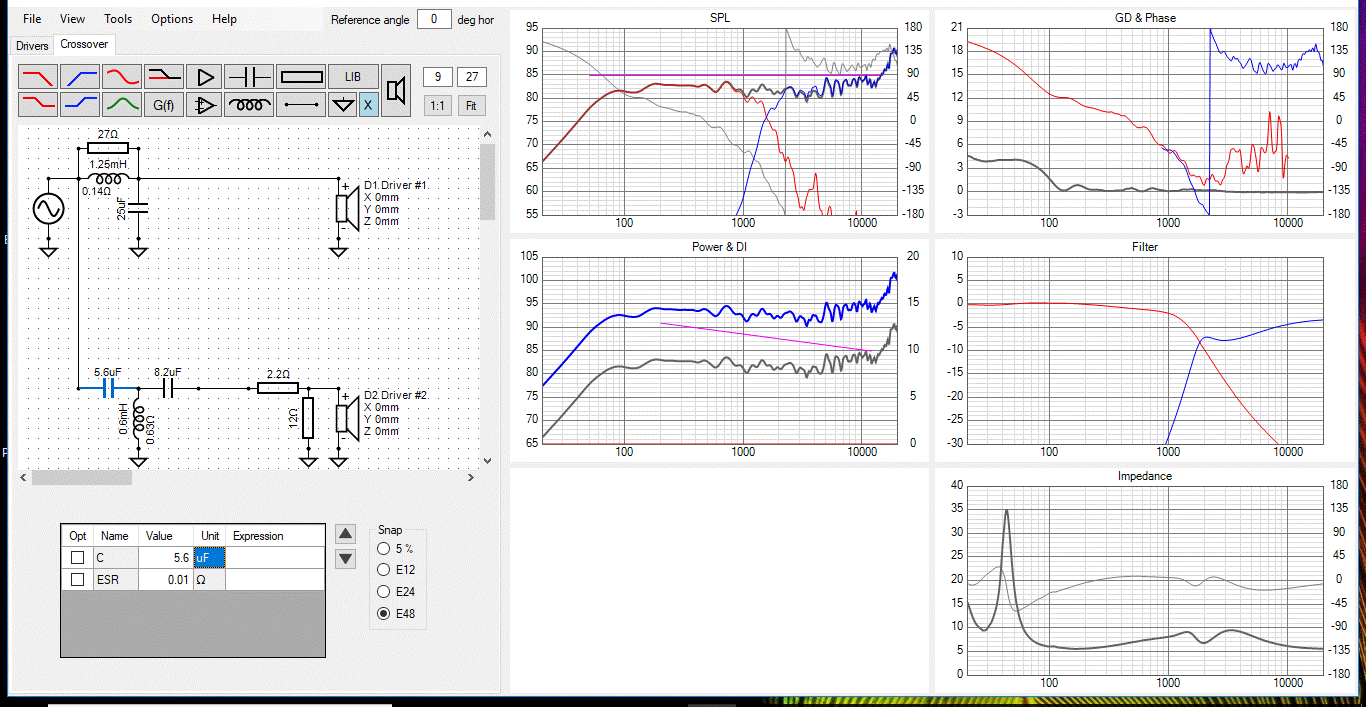

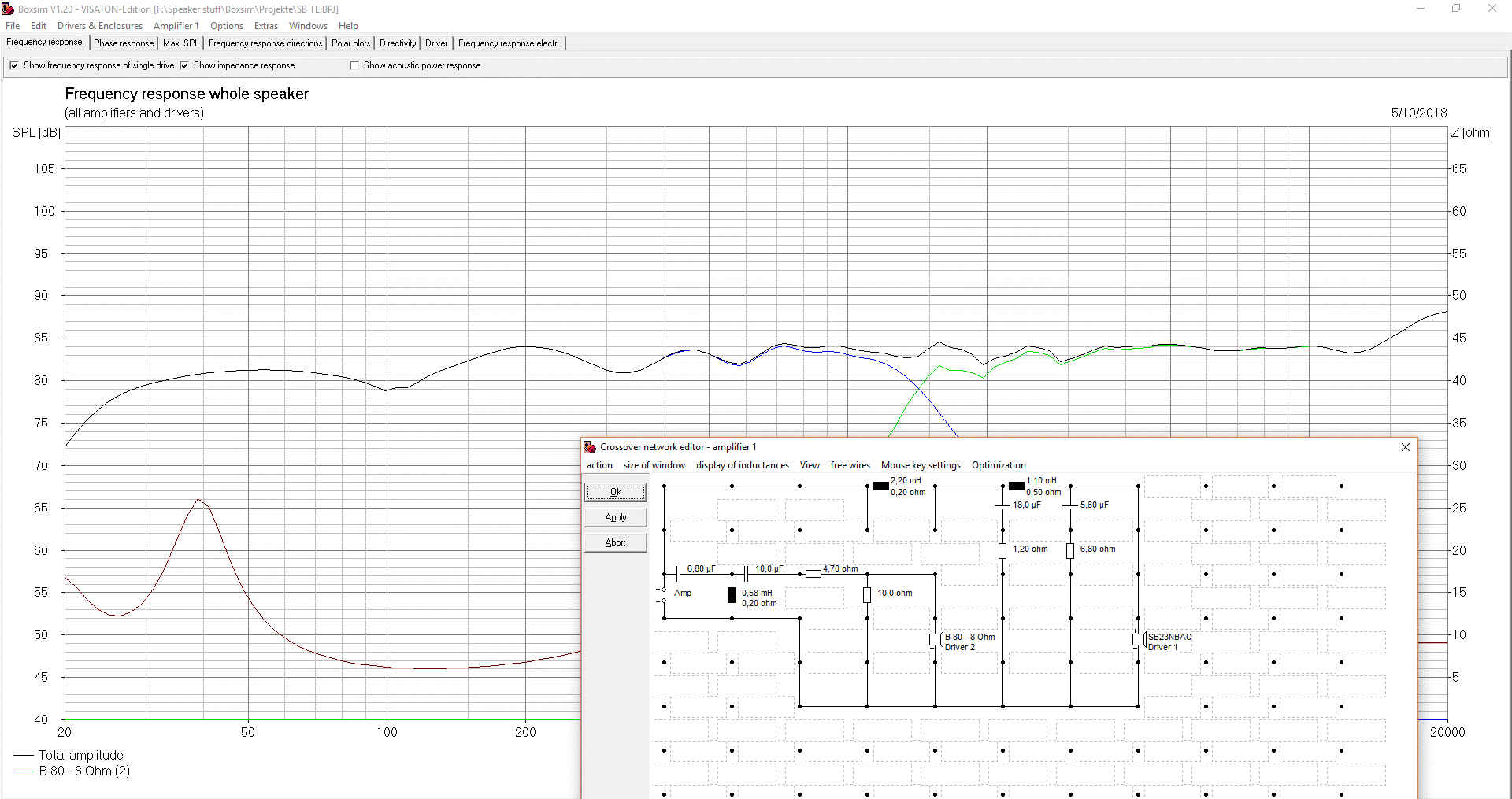

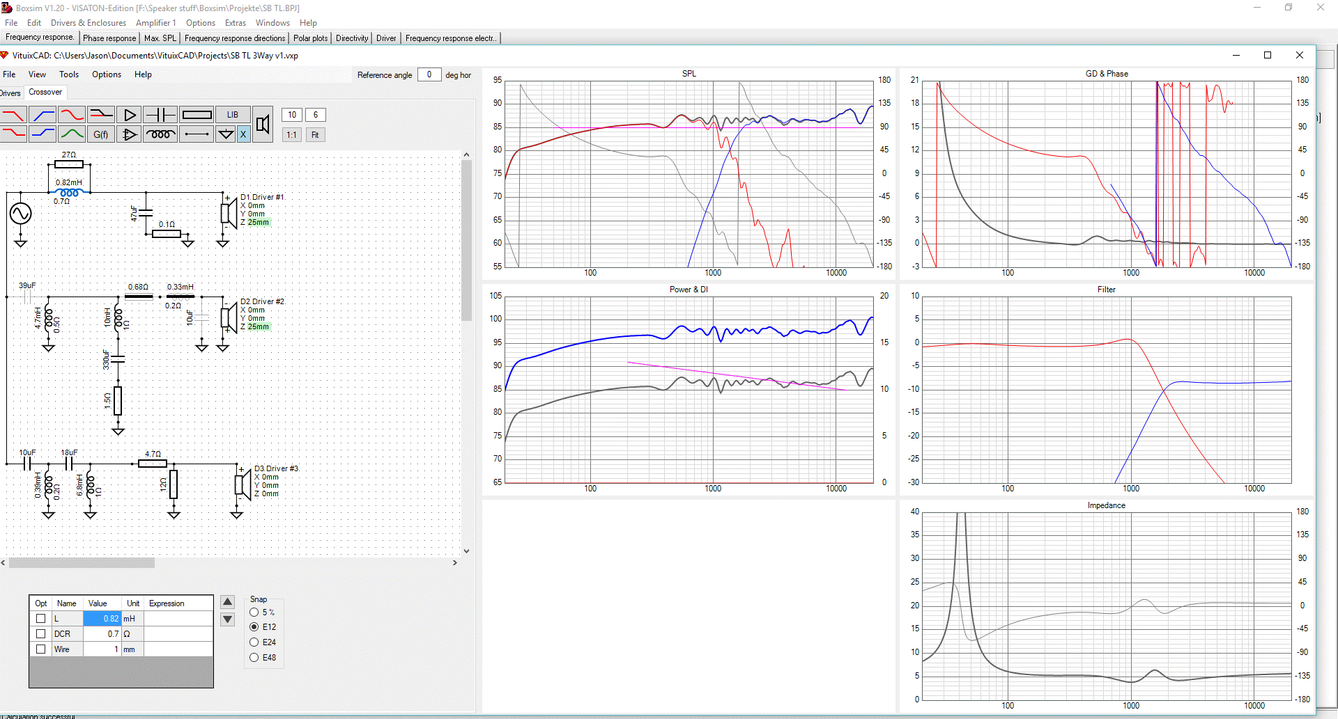

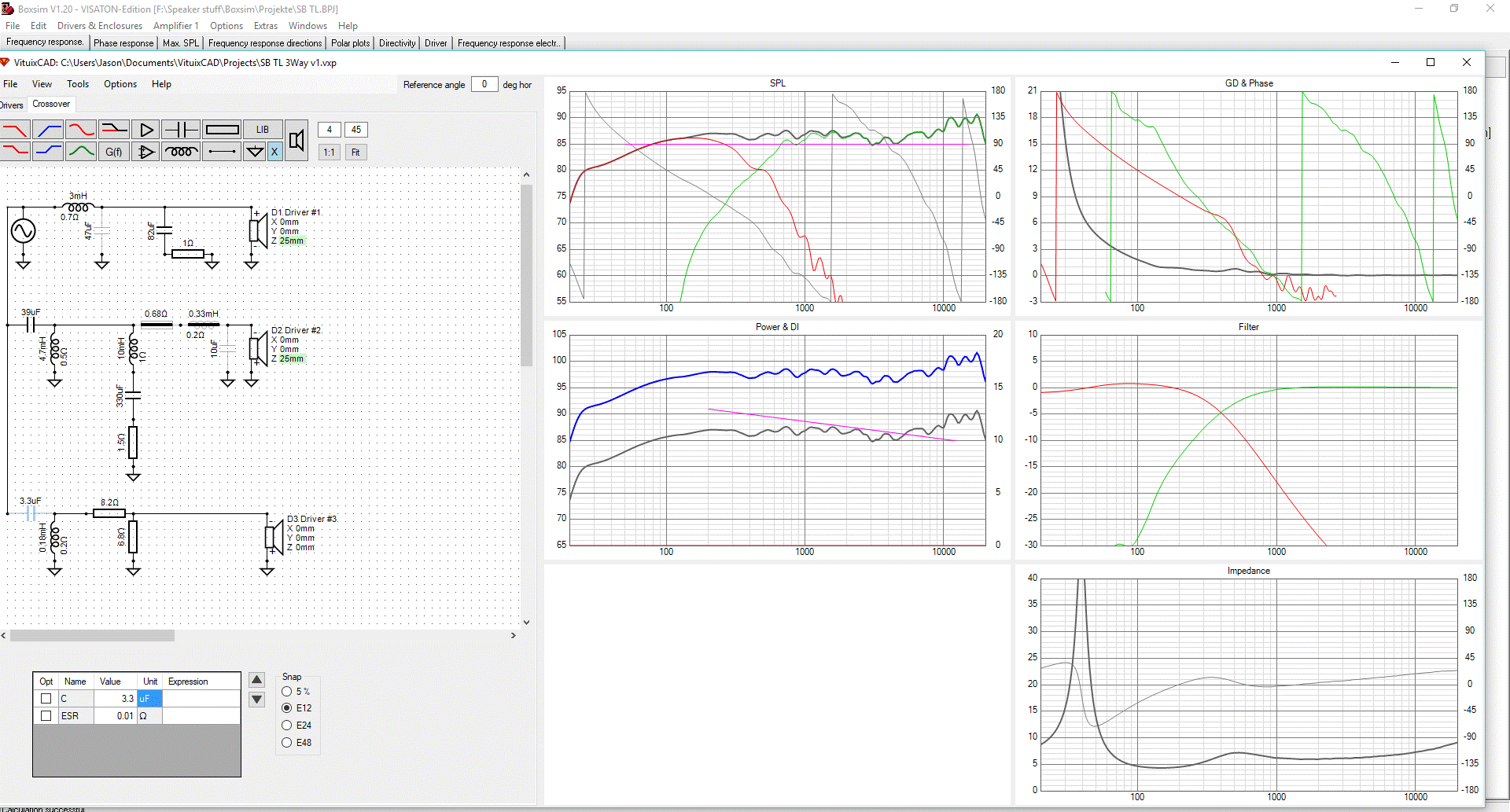

Hi All.
I have some baffle data now and have mocked up a crossover using the SB29 tweeter as a 2 way. To my ears it just doesn't sound quite right.
Attached are some screen shots of a few scenarios with the B80 as a wide band, B80 and SB29, and just the SB29. The SB23NBACS driver requires way too many components to pull it into line with the 1.1 - 1.2K crossover.
As I haven't purchased the mid drivers yet, I can only go on published data. I even had a go at Boxsim (a fav of system7) today and it's not too bad to use, although get conflicting results using the same frd and zma files.
All crossovers look OK, but what do they sound like?????

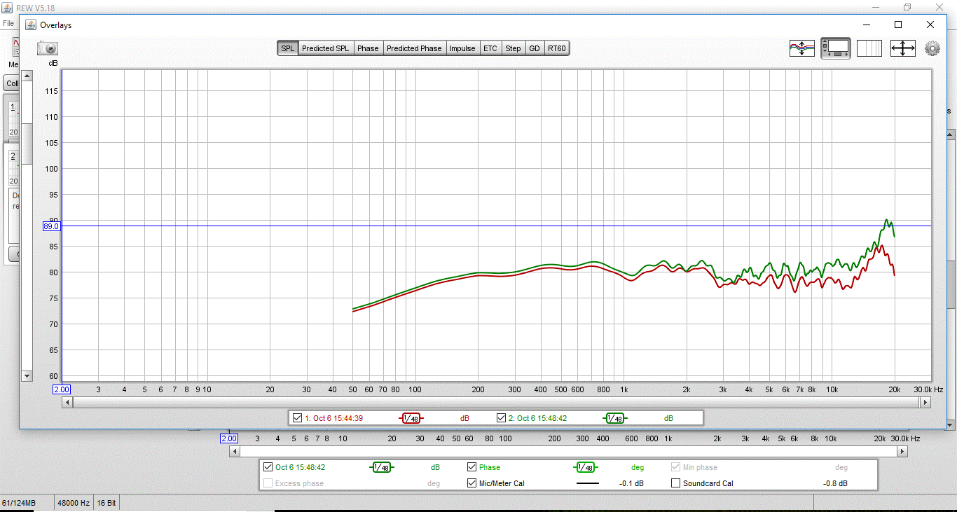

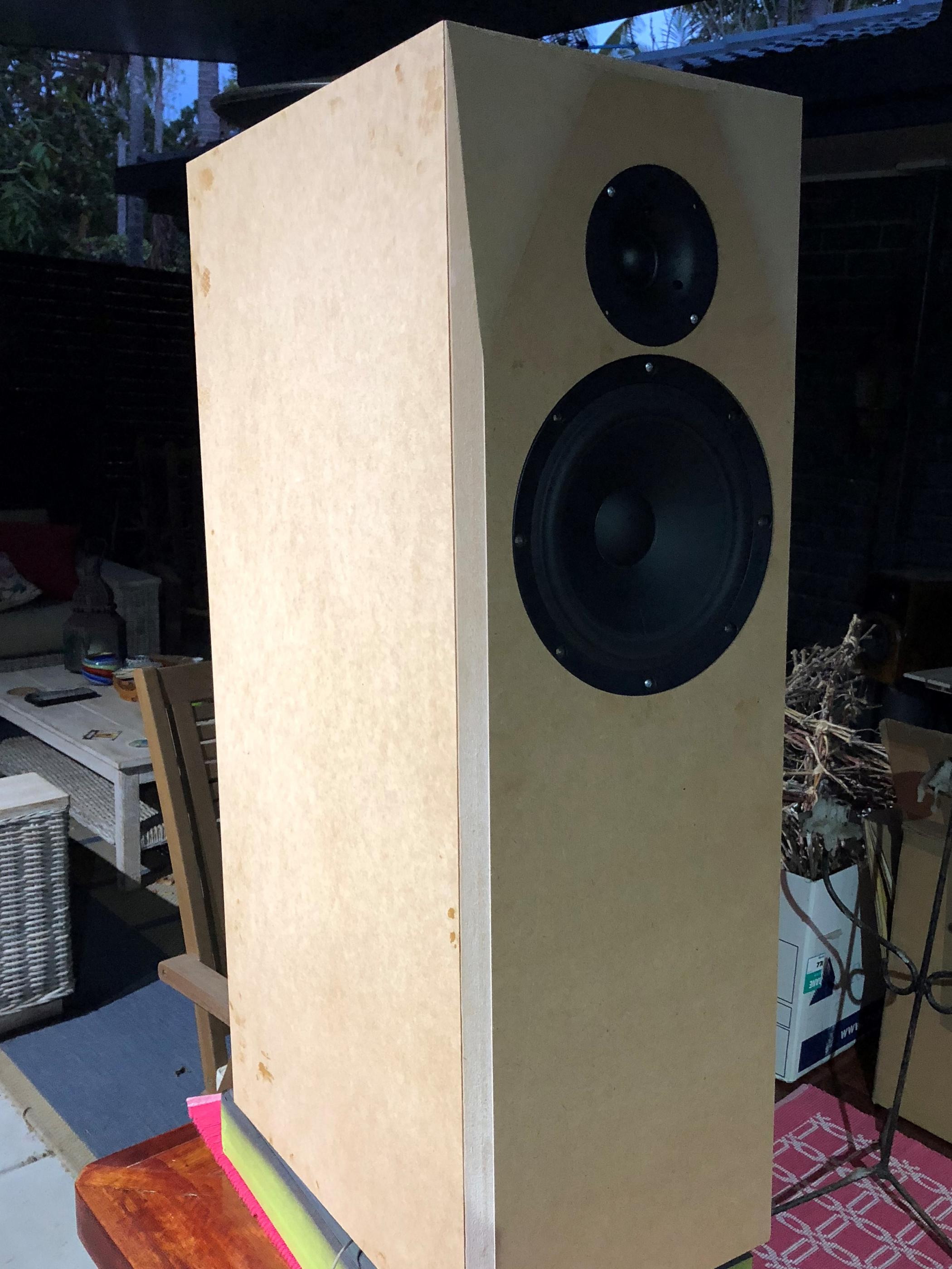

Hi all.
I've managed to get one of the boxes to a semi completed stage and get some actual data. I have a question about baffle faceting and diffraction that I hope can be answered by someone who knows more about it than me. There seems to be some diffraction at 2 and 4khz, could this be due to the top chamfer?
I'm aware of the wavy response down low. It's due to the unfinished T line.
Attached is a pic of the baffle and a mock up crossover using Boxsim.
Cheers

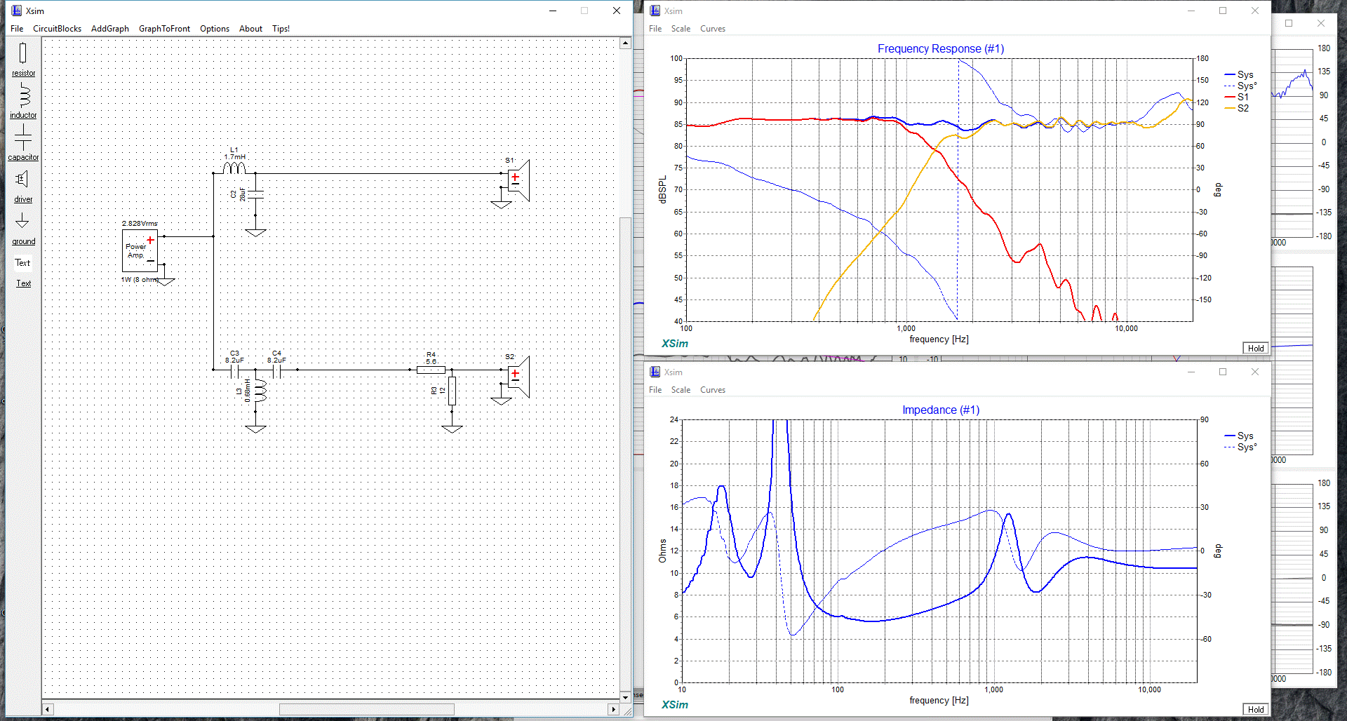

Hi all.
I've been doing some crossover work and have run into a couple of issues with some of the simulator software packages.
What I did was put the same data into 4 different packages. Win PCD, Xsim, Boxsim, and Virtuix CAD. I created a crossover with 2nd order electrical for woofer and 3rd order electrical for tweeter. Ran the optimiser in Virtuix CAD and Boxsim and they both came up with different results.
Attached are some screen shots of the programs.
I also created a mockup crossover and took some measurements in REW. Also attached with on axis and 30 deg off axis response.

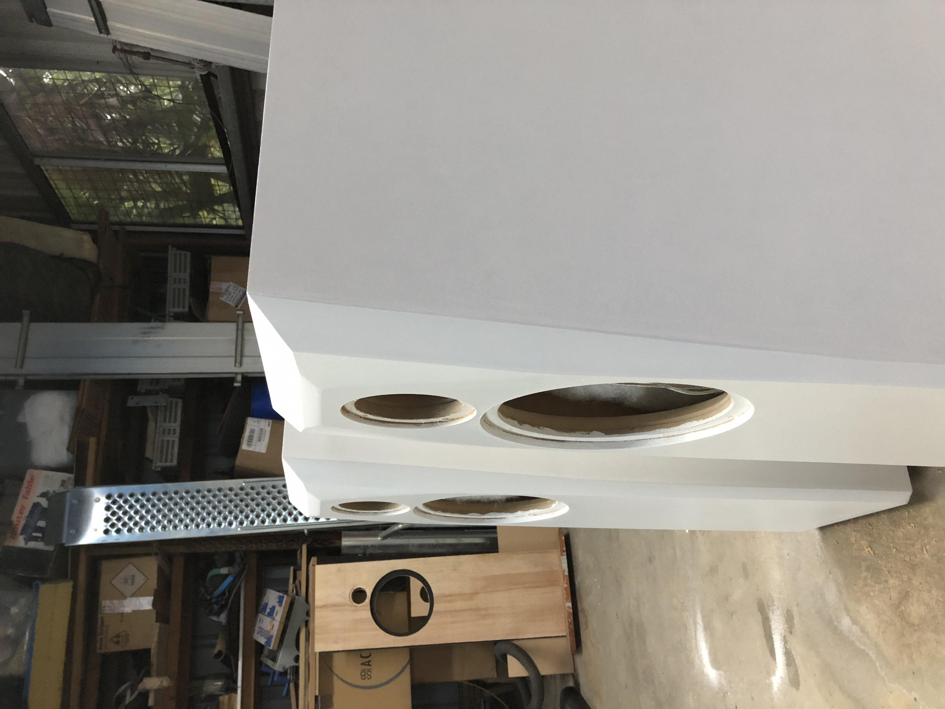

Just an update on the progress of the boxes. Both are now completed and have 2 coats of primer sealer applied. I managed to make up a jig and chamfer the front panels better than I did first time around. The tweeter data looks better now. Attached is a pic of the boxes and current crossover simulation with actual measured data. The bass hump is from merged data from the terminus. It's not really that pronounced.

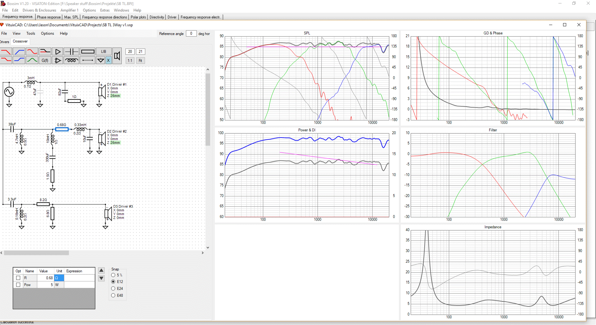

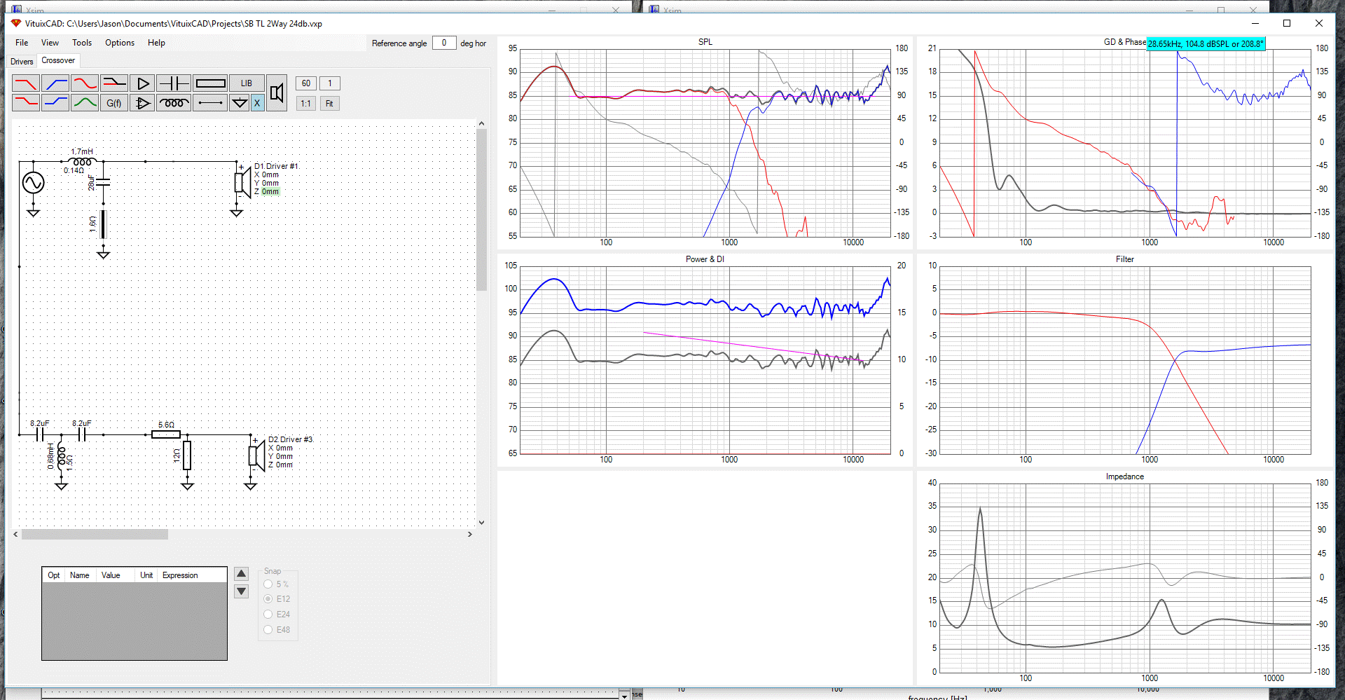

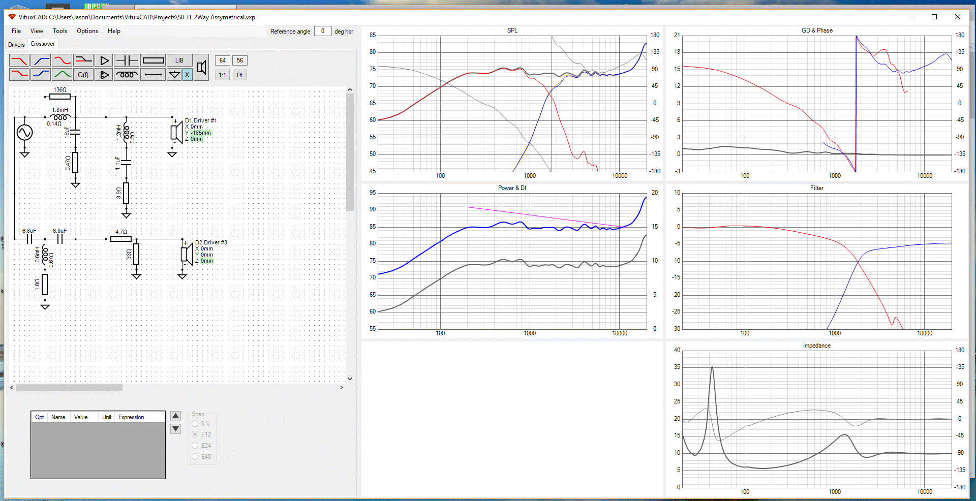

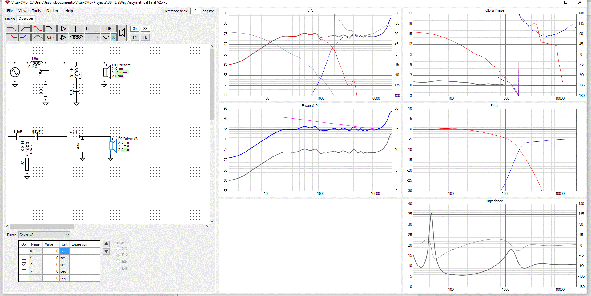

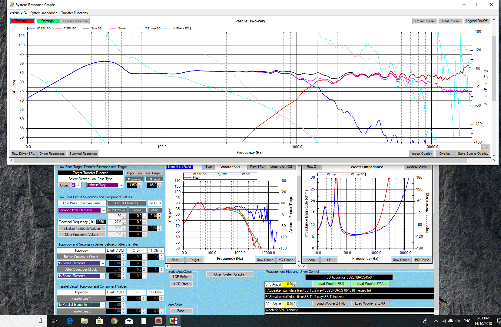

Hi All,
Sorry about yesterdays post. It contained an incorrect screen snapshot of some of my original data. It certainly doesn't look like that now.
I now have two versions of the crossover that I'd like some feedback on from those here with way more knowledge than me. I'm not sure if the 4K breakup has been tamed enough in the first one.
First version is a take on the Seas TRYM woofer circuit (thanks System 7), and the other is all my own. Both tweeter circuits are the same. Crossover point is 1630Hz with a sharp null when inverting tweeter polarity.
I believe that I'm getting real close to a finished product.

Both designs seem to have very similar responses and shapes. As you say they both give sharp nulls which suggests how close they are. I think it would be difficult to hear the 4k output as it is 25 or so dBs down. I guess it is time to listen and tweak if needed. I imagine that you have the basis of something good with either one. An even simpler 1.8 and 16uF might not sound to bad.

Thanks Raymondj.
I think I have enough components to put together the crossover in the first attachment, and already have the 2nd one mocked up. I've been testing it with just the radio on my receiver and it definitely sounds like a single point source. Very well behaved. Deep bass, articulate vocals, mellow mids, and crisp but not bright highs.
I'll run a sim when I get home from work with just the 16uf cap on the woofer and see how it all correlates.
Pity I have already purchased some components, but they were mainly for the tweeter network, as it seems solid. The simpler the network the better in my books.

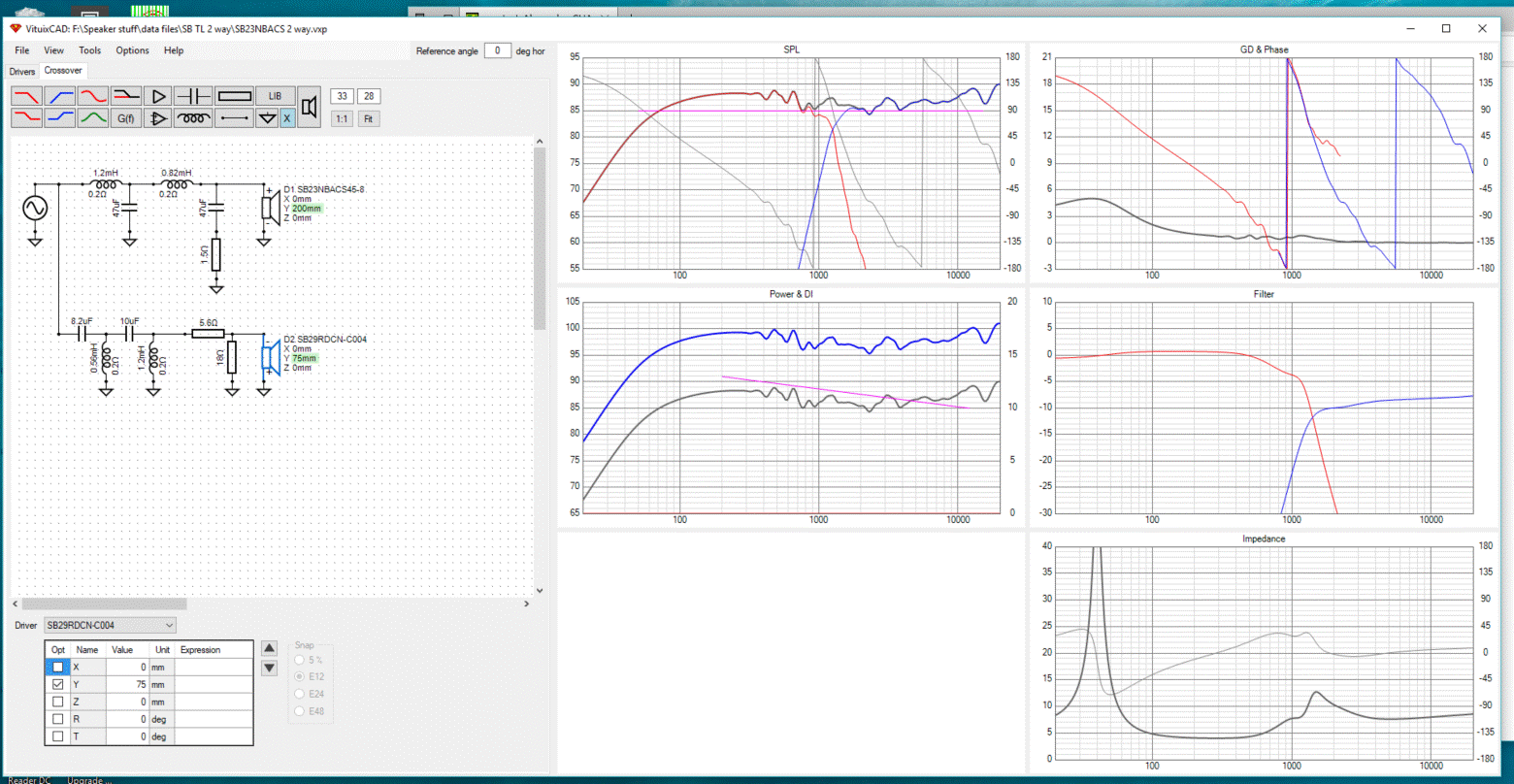

Hi eg92b16a,
It's good that you have some extra components. I can guarantee having come this far you will try your circuits and then decide which is best. In the end you will prefer one and it will only be possibly 0.5-1.5dB different from the others. Once you are happy with the bass, you might concentrate on listening to the treble and listen and measure that with just one value change. I haven't read the whole thread can you do responses for 30 and 45 degrees of axis as ideally these should be gently decaying in a smooth fashion.
