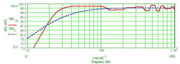

I modeled your 8:1 tapered TL using your T/S measurements, first with a stuffing density of 0.3 lb/ft3 (5 kg/m3), then 0.5 lb/ft3 (8 kg/m3) and have attached the two predicted anechoic system bass response curves (red lines). As always in speaker system design there are compromises, like trade offs between f3 and response smoothness.

The line overall length is 1.9m. Sd1=800cm2 and Sd2=100cm2. The driver is located 30cm from the closed end. The filling is in the first 1.4m of the line at a density of 5kg/m3. Now that I know this level of fill is considered “light”, I’ll have another go with a density of 8kg/m3 to see the effect.

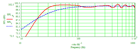

I get it now. 4db ripple is fairly substantial in the 200 - 500hz range and we need to smooth it as much as possible without sacrificing the bottom end response.
I'll have another go with a 10:1 taper and 10kg/m3 fill and play with the driver location to see if it can be tweaked some more.

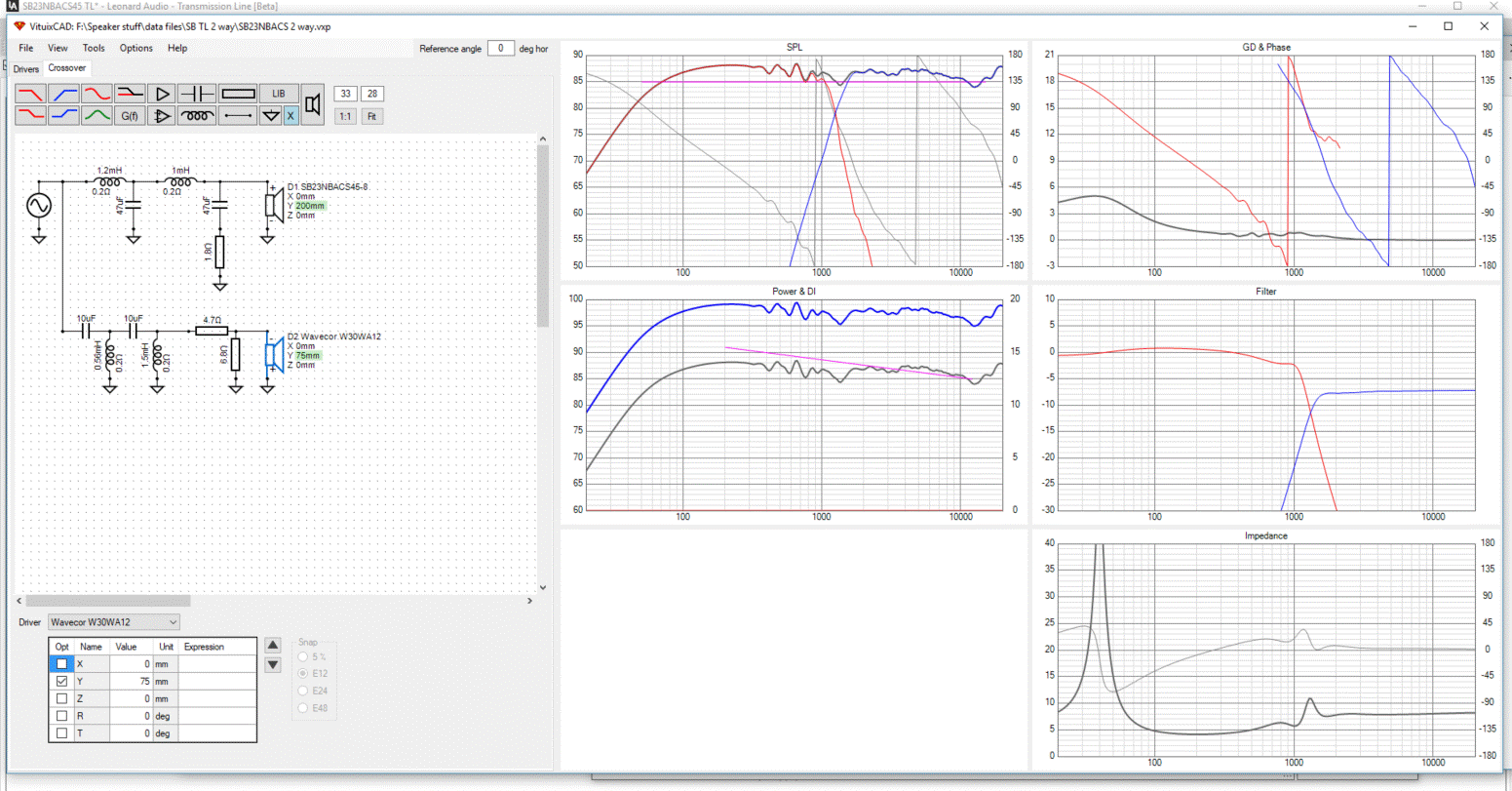

Here's the response with the wavecor tweeter. Crossover is approx. 1250Hz.
It looks good as well.
Those values seem odd to me. Where are these measurements from? Wavecor: homepage?
SB: traced?
Have you incorporated baffle diffraction/baffle step and phase?
Otherwise nice project idea

The original response was traced from hificompass test and then baffle diffraction added, and then incorporated into the crossover.
