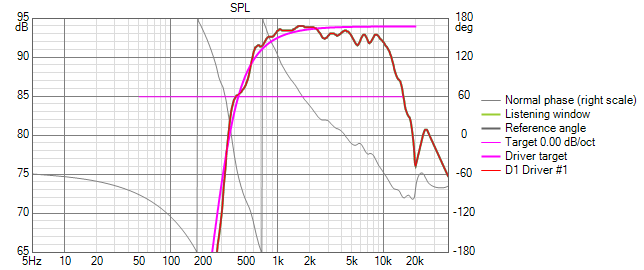

I see what you mean, but in reality the crossover in my system wasn't targeting a symmetrical 6th order LR.
Rather, the process was:
1) set LP to 6th order LR acoustic @500Hz (6th order electrical topology required to achieve this)
2) set HP to 2nd order electrical, and adjust corner frequency and "shape" so as to obtain -6dB @500Hz AND the best achievable phase match when the horn is physically positioned with some workable front-to-back offset relative to the woofer (i.e., acoustic centres not aligned).
It just so happens that, given the natural roll-off of the unfiltered driver+horn (approximating a 4th order HP @300Hz, but transitioning to an even steeper quasi-6th order at even lower frequencies)... the acoustic HP transfer function ends up resembling a 6th order LR.

They are VCad sims but using actual measured individual frequency responses.Hey, quick question. Any acoustic measurements? (non VCad i mean. They all appear to be sims, or am i misunderstanding them, thx.)
Complete system measurements in room are compromised by room acoustics, so less illustrative of the design per se.
I first simulate the summed response, varying the offset until the best phase match is obtained.
Then, I measure the impulse responses of the filtered woofer and driver+horn from the listening position, keeping the same fixed "time of flight", and I post-process the two impulse responses to limit the frequency "window" to the crossover freq.
The resulting "filtered" impulses should then overlap. If they don't, I measure their "distance" D (in milliseconds), and move the horn to the front or the rear accordingly.
Then, I repeat the measurements to confirm, and proceed to make further offset adjustments as needed.
Sounds complicated, but it's really rather quick and straightforward once you get the hang of it.
The actual electrical HP is approx. a 2nd order Butterworth @650Hz, and the horn is a hypex with a cutoff = 300Hz. So the driver is well protected from overexcursion - at least at domestic levels ... and that includes occasional brief 110dB peaks ;-)BTW, I think your 500Hz XO point might be a bit borderline, the HF driver working quite outside of its comfort zone when pushed and the horn loading already fading out?
