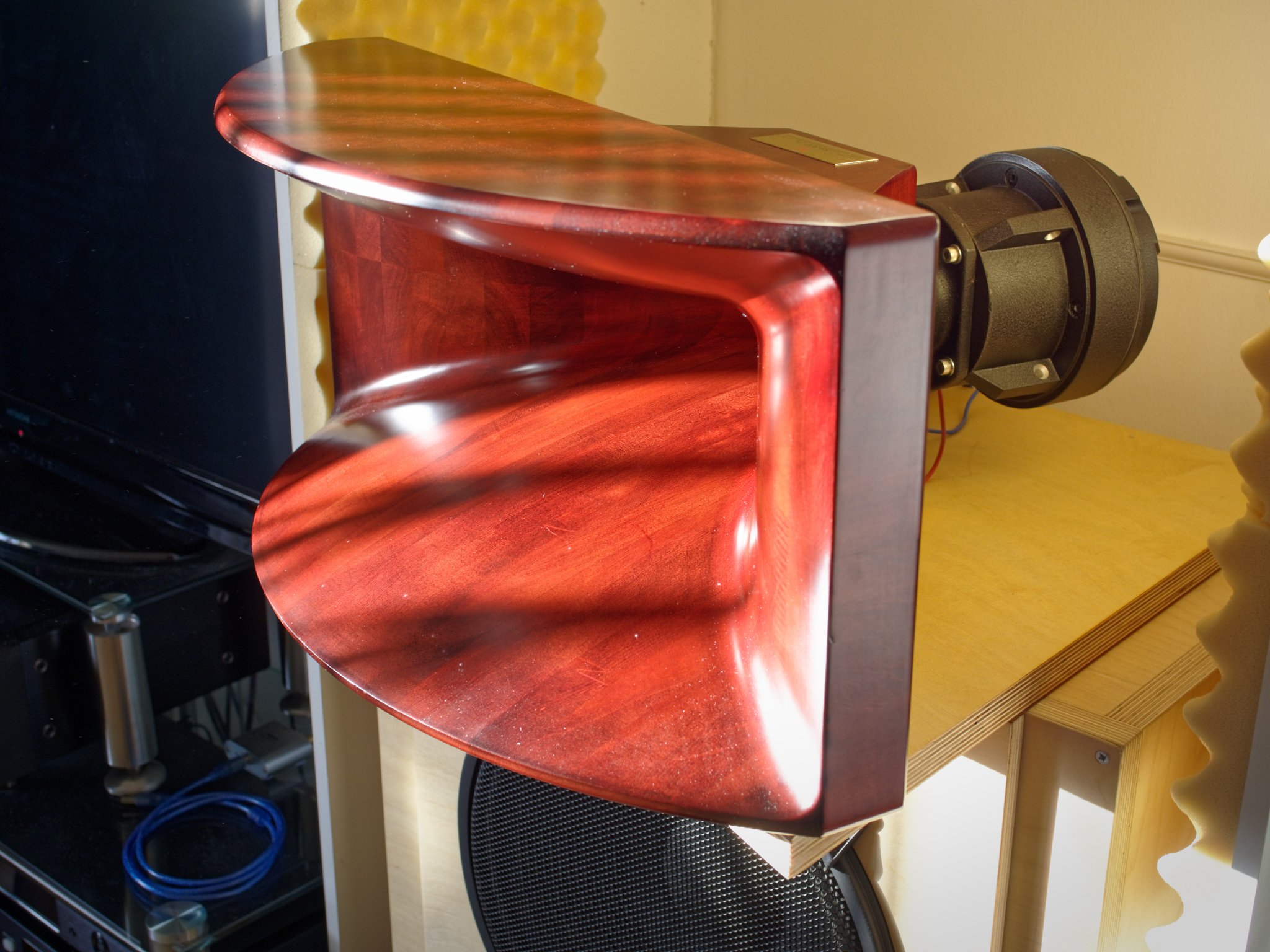

As the title of the thread suggests, this is essentially a "classic" two way "large format monitor" speaker, comprising a 15" Woofer and a large-format compression driver mounted to a horn.

- THE HORN is NOT a typical modern PA-style "constant directivity" waveguide (rapid-flare expansion, poor low-frequency loading, sometimes nasty diffraction slots in the older designs...), NOR is it a "vintage" component (e.g., Altec multi-cells or classic "sectoral" horns a-la 511, etc.).
Instead, it is a Yamamoto SS-300, which is a sophisticated evolution of a classically-derived hypex radial horn, but with a smooth profile devoid of any sharp corners, any discontinuities or diffraction-inducing steps along its expansion, and a smooth round-elliptical throat adaptor whose expansion parameters are perfectly matched to those of the JBL 2450 driver used. It is also carved out of a solid block of Japanese cherry wood, thereby killing virtually all internal resonances. Its "raw" frequency response is very smooth and extended from approx. 300Hz to over 15kHz (-6dB), with useful output to 20kHz. A mild "hump" centred around 2kHz is taken care of by means of a passive parallel-RLC trap.

A few pictures to illustrate the finished product below.

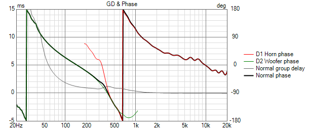

It works exactly as intended. I.e., the asymmetrical crossover slopes work in tandem with the unfiltered "raw" driver responses AND their relative physical offset to arrive at the desired phase match over a frequency range centred on the crossover frequency.Beautiful!
How does the horn offset work out with respect to delay and the crossover?
See phase measurements below:
I agree. I find them gorgeous, too, and I'd wanted a pair for so long.Wow, that horn is beautiful. Nice work.
Alas, they're also almost 4 grand! Each.
Ouch.

However, instead of using a passive crossover, I did it using a bespoke active analogue crossover, with individual HP and LP filter slopes and "shapes" of my own design.
Both.Simulated or measured IRL?
Simulation (using individual gated measurements for the two unfiltered drivers) shows "cleaner" phase traces down to lower frequencies, while filtered measurements from the listening spot are limited by in-room reflections. But both are in agreement where it matters, i.e., around the crossover frequency.

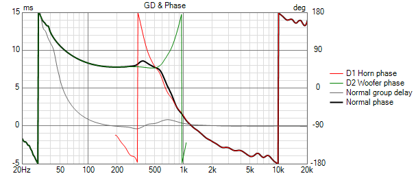

Sorry - deleted my reply post because I messed up the quick simulations. Will repost the correct results asap.Yup. I use this myself (reverse polarity and horn mouth close to baffle front). I don't think I can hear the polarity reversal. Just saying it is worth trying. If you do try, I would be curious to hear your impressions.

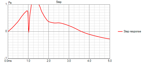

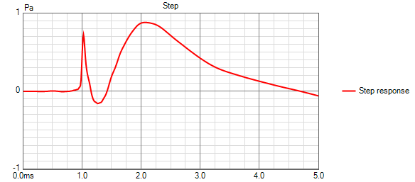

I simulated what happens, and it does NOT look pretty.What happens if you reverse the phase on one of the drivers and move the horn back half a 500Hz wave length? Is the mouth of the horn then behind the baffle?
Essentially, you can still get a phase match, but ONLY exactly at the crossover frequency. The two phase traces then DIVERGE wildly as soon as you move even slightly away from that frequency. (This causes ripples in the Frequency response, too, by the way.)
The Step Response is also negatively affected BIG TIME.
1) original crossover (+/+ polarity)
2) opposite polarity crossover
Overall, I'd say it's a MUCH WORSE result, and not worth pursuing for just the sake of being able to push the horn back.
