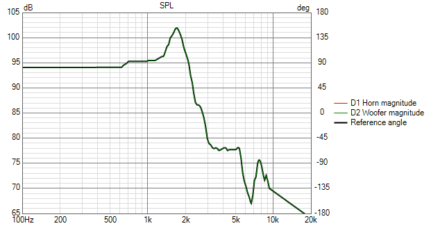

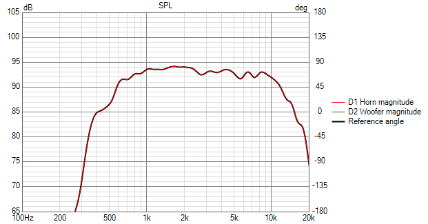

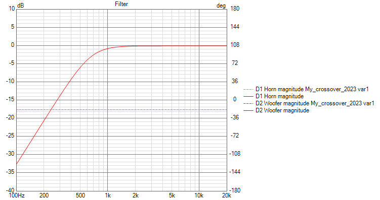

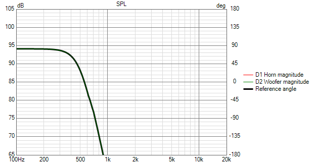

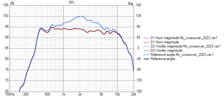

A few graphs below:

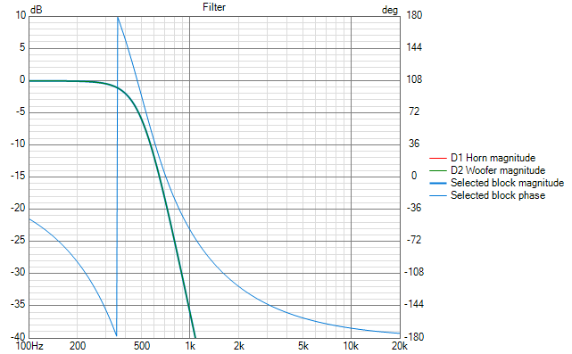

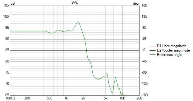

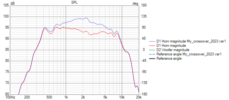

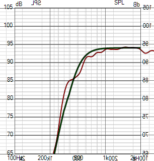

1) "raw" Woofer on axis
2) "raw" Woofer 30deg off axis
3) Low-Pass filter transfer function
4) Filtered Woofer on axis
5) "raw" driver+horn on axis (with and without passive parallel-RLC eq contour network)
6) "raw" driver+horn 30deg off axis (with and without passive parallel-RLC eq contour network)
7) High-pass filter transfer function
8) Filtered driver+horn on axis
Thank you. How close was your mic?
Any chance you can show us a combined response showing 500 Hz, with and without phase reversal?
Btw I like the gentle slope downward you achieved on the compression driver response. I bet it sounds nice and non fatiguing. Too often the presence region is over emphasized. Thanks for sharing 🙏.

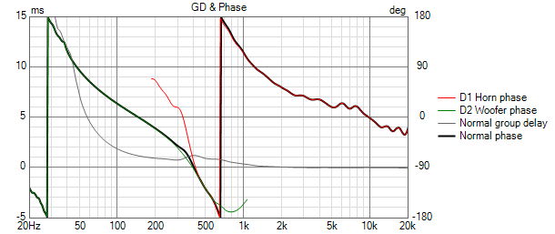

See phase measurements below:

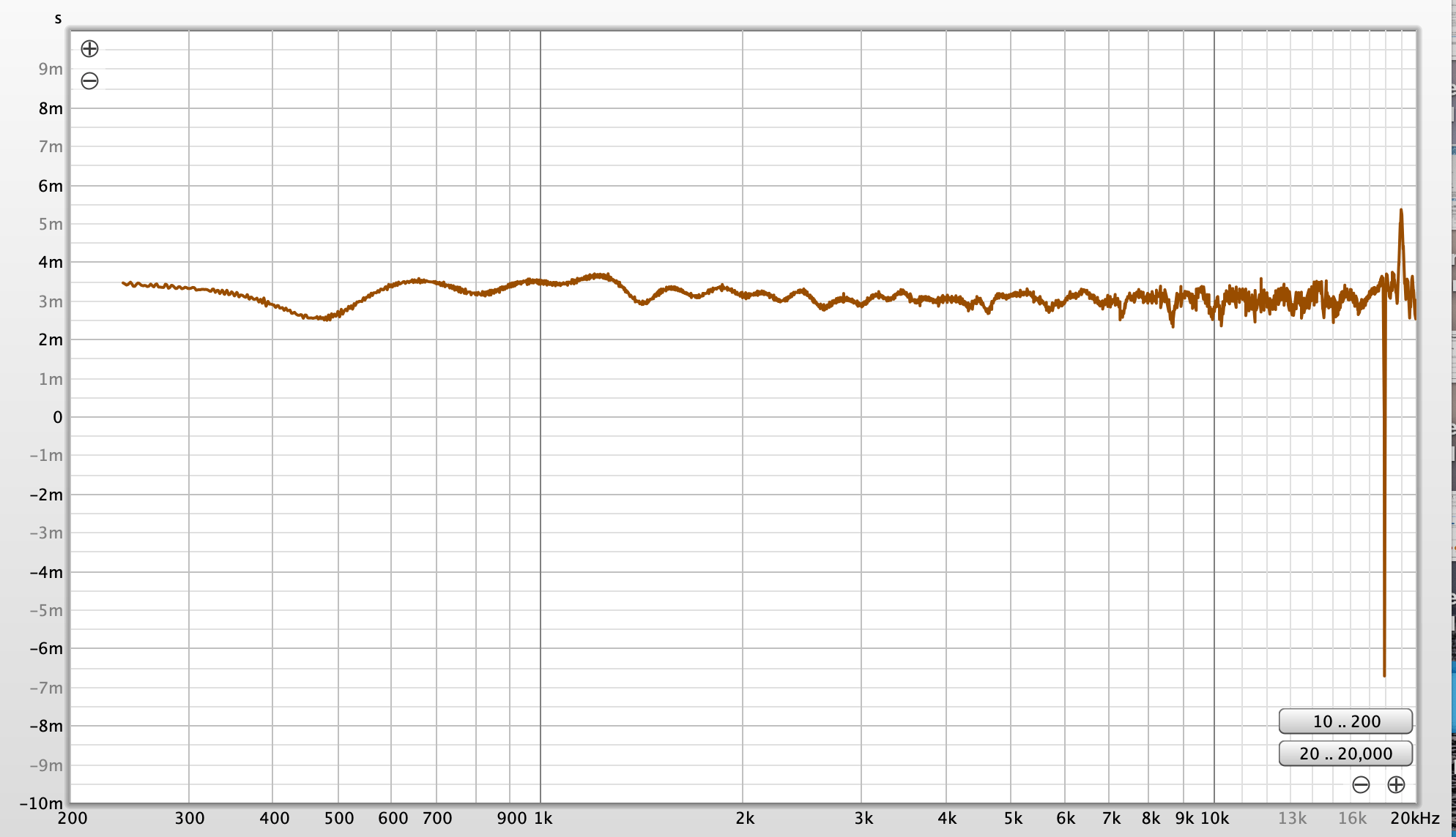

Attached is the unfiltered group delay measured 24 in (60 cm) in front of my speaker. Doesn't look too bad?!
I am not showing the imperfect step response (woofer leading edge starting ahead of CD spike). Yet the speaker sounds quite nice IMO. And how many real speakers have a nice step response? I confess that my left brain warns "not optimal." However my right brain is in bliss.
Looking for views on this, or another filter topology that works better in practice (factoring drivers roll off and such) for two ways like ours.

Assuming that you are not actually listening to the system from 60cm away, the real group delay from your listening position will be different (trigonometry!)Attached is the unfiltered group delay measured 24 in (60 cm) in front of my speaker
The best way to estimate GD at listening position is to model/simulate it in software, calculating the summed response (woofer + driver), setting the driver offset set = real offset at listening position, determined by impulse measurements.
I cannot see an asymmetric crossover in Marco's measurements (flipped the woofer plot and overlaid it with tweeter plot). Looks like textbook LR6 to me:PS: KSTR, I am intrigued by your post. You do realize that our crossovers are not symmetrical? (woofer is delayed through a higher order filter). Can you elaborate on what we can do better?
Maybe you mean the electrical filter responses? But those are completely irrelevant, they are just dialed in to whatever is required to arrive at the acoustic target and have no value in itself. BTW, in my whole life I never got one of the textbook electrical filter functions with one single and obvious exception, that is two identical fullrange drivers used as woofers and tweeter to audibly study crossovers.
