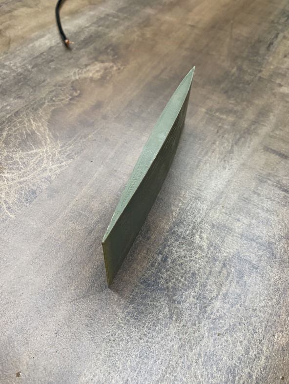

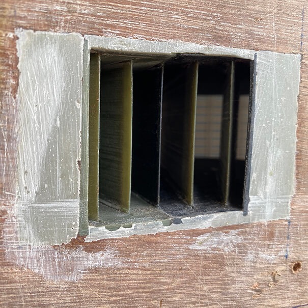

Many thanks for the photo. I can imagine how difficult it was to assemble the PLA parts especially for the throat region with the fins inmcluded. Congrats for the nice work.
But the fins are not as sharp as a knife as it maybe would have been possible using metal or hard wood. The fins are also quite thin especially at this side to the driver. But again, nice work with this material!
By looking at the frame around the throat region. Are you sure that there was no leakage?

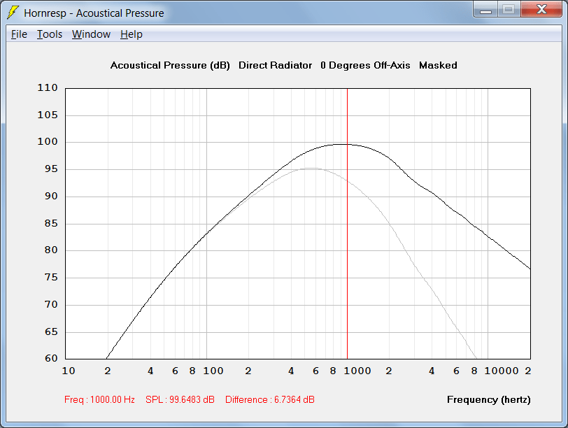

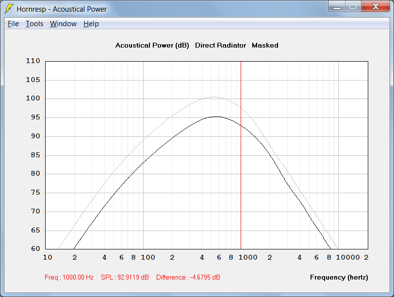

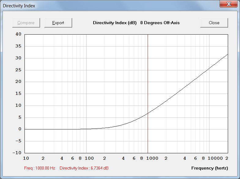

Hi Don,
Not sure if there is still a question in there for me to answer, but perhaps the following may be of some interest 🙂.
Attachment 1 compares the power response of a loudspeaker radiating into half space or a solid angle of 2 Pi steradians (grey trace), to the power response of the same loudspeaker radiating into free space or 4 Pi steradians (black trace). This example shows that power response is dependent on solid radiation angle.
Attachment 2 shows the on-axis directivity index of the same loudspeaker radiating into free space. At 1000 Hz the gain due to the narrowing beamwidth is 6.7364 dB.
Attachment 3 compares the above free space power response (but now a grey trace) to the free space pressure response (black trace). In this case the pressure response is equal to the power response plus directivity index. This example shows that pressure response is dependent on directivity beamwidth.
Google 'power response vs pressure response' if you would like more information...
Kind regards,
David
