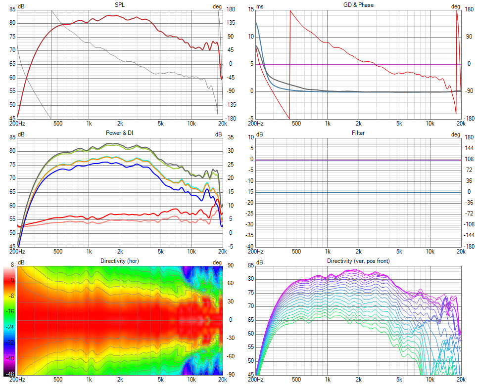

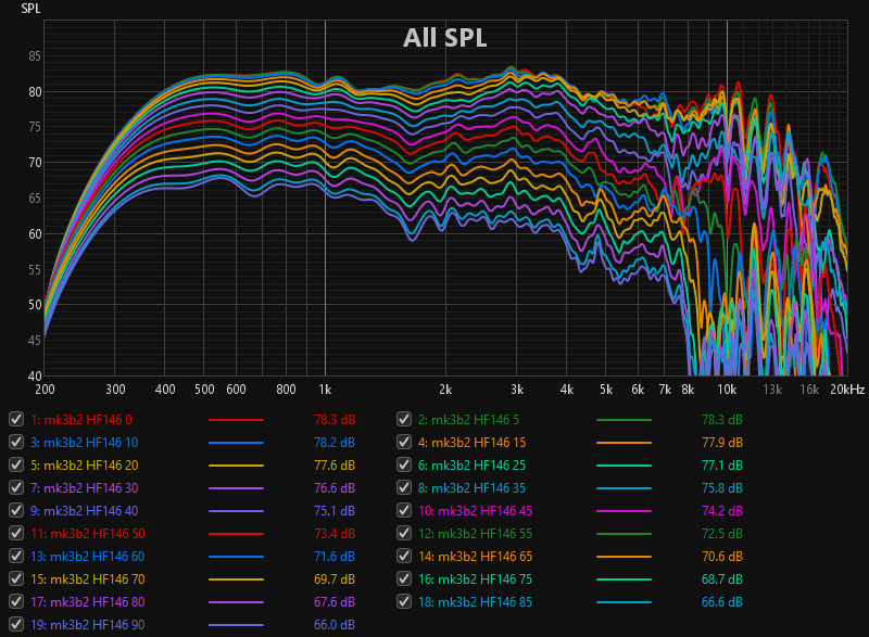

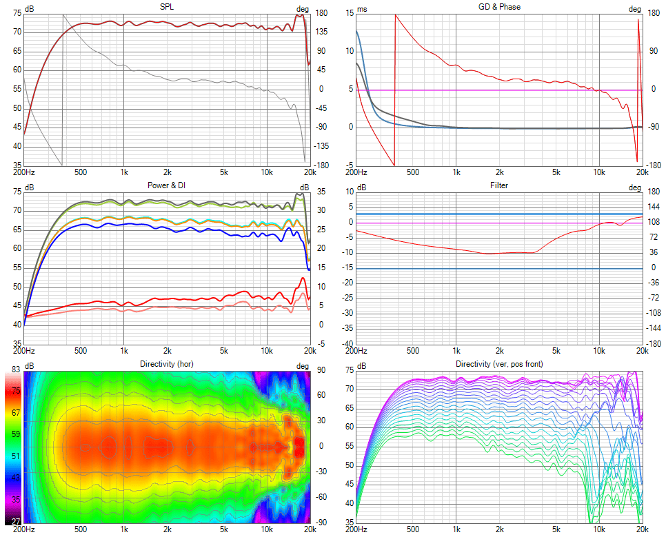

I'm confused about your off-axis angle numbering. The graph says -180 to 180° but the data look more like -90 to 90°. Also the DI comes out suspiciously low. Did you really measure the full circle, front to back, or just the front hemisphere?
Thanks @mabat for pointing this out.
We realized that @WetFartz got a little confused with the rotation setup.
So what he has actually measured is measurements from 0 degrees to 90 degrees in steps of 5 degrees instead of 0 to 180 in steps of 10 degrees

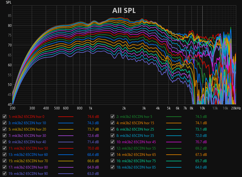

Corrected raw measurements for Rosso 65 CDN-T

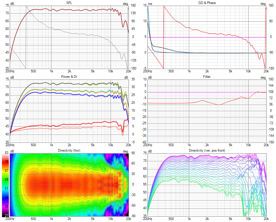

Normalized directivity plots and unequalized responses for the Rosso driver

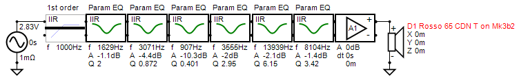

Responses with a bit of passband shaping EQ

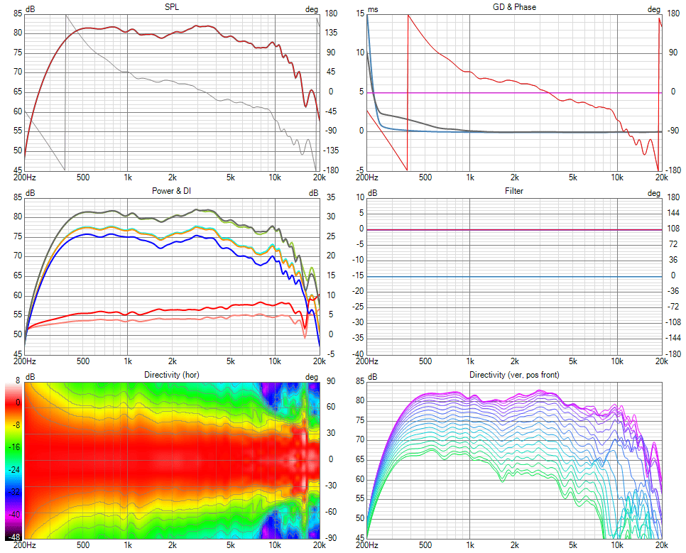

Corrected raw response for the HF 146 (measured today)

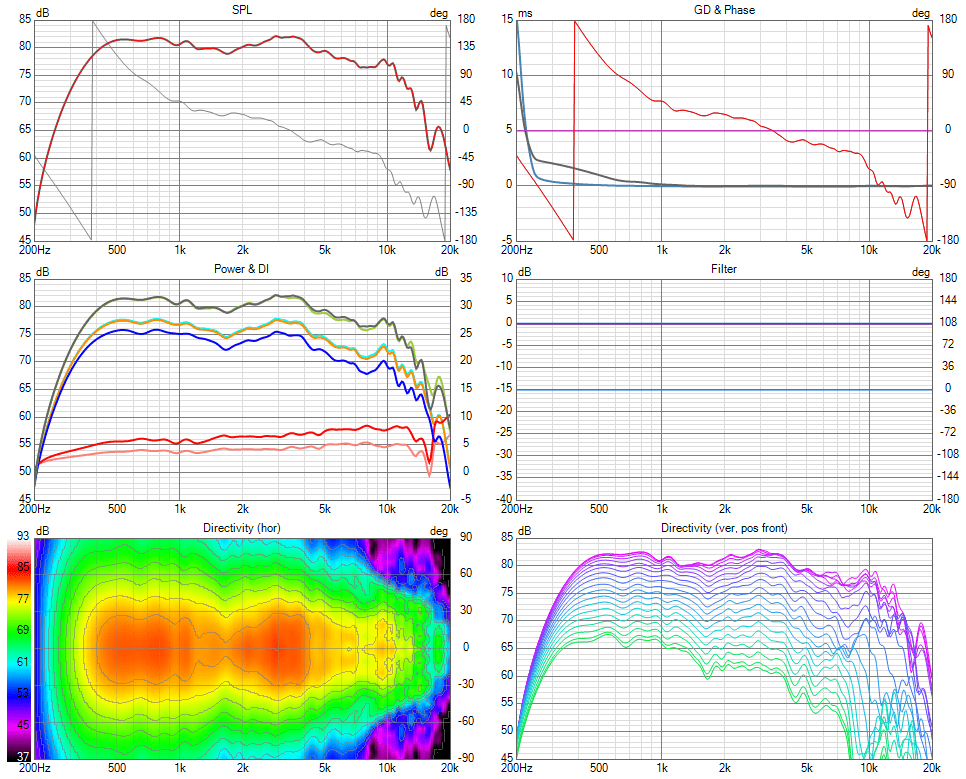

Vituixcad plots for unequalized response (reference axis is 15 degree off axis)
Response with a bit of EQ
Equalized response Comparison between HF 146 & Rosso 65CDN-T (EQ applied on both with 15 degrees off axis as reference axis. This doesn't make much sense but just posting for fun.. 😀

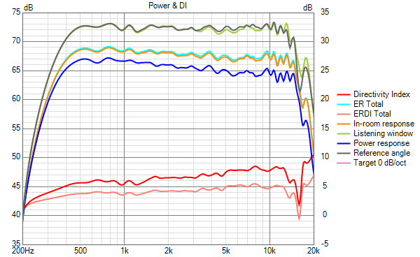

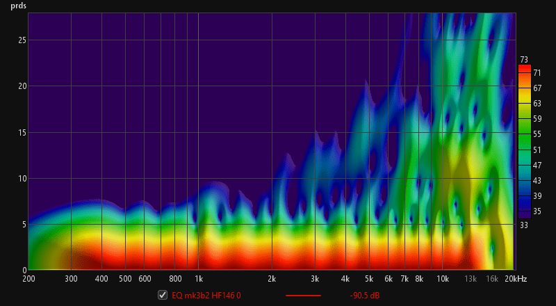

HF146 axial response (0 degrees on axis response) flattened using REW Auto EQ
Corresponding spectrogram

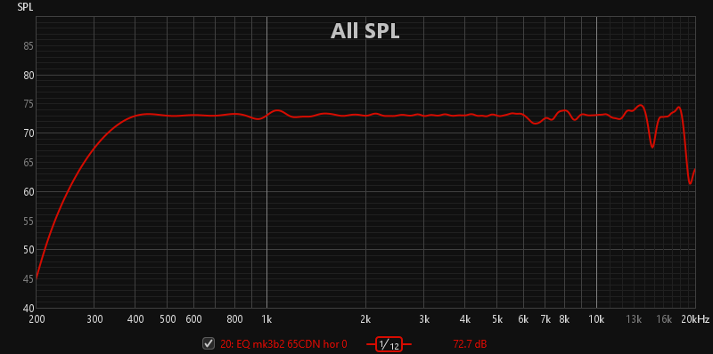

Rosso 65CDN-T axial response (0 degrees on axis response) flattened using REW Auto EQ

Were specific vertical measurements made or are these mirrored horizontal?
To me it indeed seems that above 7 kHz (where the input wavefront doesn't remain flat enough anymore) a lot of the energy is trapped inside and around the fins (it can even circulate). There's no reason why there should be so much stored and slowly decayed energy below the driver's break-up. I just can't help myself, this seems to me as a dead end. Would be interesting to see it without the fins.
I dont know about the stored energy part. It could even be from material used for construction..

It surely will. But even now it's lower than what it's supposed to be (roughly by 3 dB), even if it was axisymmetric with the polars shown - I guess that's given by the way VituixCad calculates this when it doesn't have the full-circle data. It's nothing wrong, one just have to be aware of this.The overall DI will rise more towards high frequencies when the vertical is included.

How much EQ are you applying in the spectrogram charts (>10K) as this can lift the noise floor as well. In some cases it appears as much as 20dB. Is there an EQ curve? I'm assuming you did this after the measurement was taken.

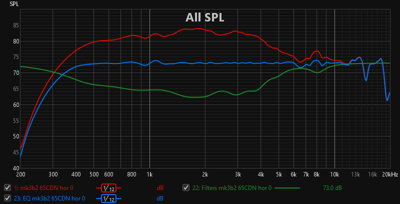

@DonVK : When I used REW autoEQ, I selected the target response in such a way that it will cause cuts mostly. So yes, as you said there are even 10dB cuts at places. Here is a plot showing the actual response, filters, and the EQed response

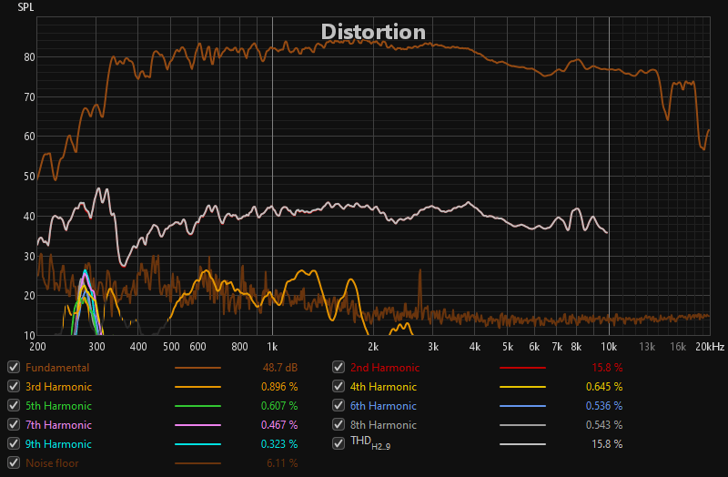

I thought that some SNR reuction might have happened with this but I thought we are high enough above noise floor so never checked it yet. How do we know how much SNR we have in the measurement?
Here is a plot showing the noise floor & distortion componenets from the above on axis measurement. It seems like we still have more than 60dB of SNR (only comparing with noise floor) above 4kHz
